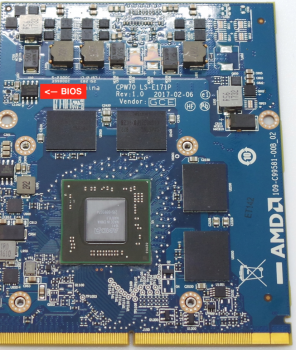

Buy this WX4170 as long as is has a BIOS chip on board (take a look at my picture).
Without a chip these cards are of no use in an iMac currently. The system will not even power on using a card w/o BIOS chip installed. Nick already wrote that soldering the chip onto the card needs a resistor network, too. So it is not a job done by a casual solder iron user like me.
From a quick review done today, most WX4170 cards on the market are intended for HP Zbook17 and don't have the bios chip on board. Considering that, I strongly suggest that the note from @Ausdauersportler ("Buy this WX4170 as long as is has a BIOS chip on board ") should be included in Post #1 of this present thread. I think it did previously by making a reference to Dell cards.
Is my understanding OK ?

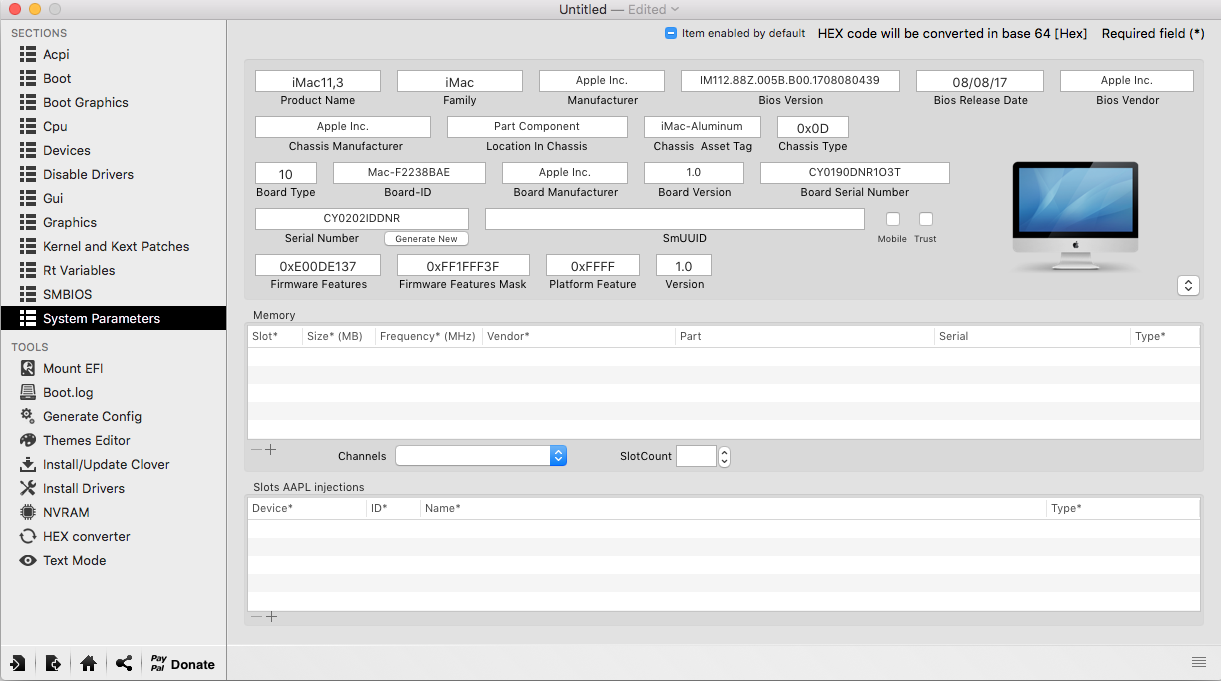

good job guys!
but i have a q:
why not simply do it in sbmbios injecting via clover/opencore, instead of patching directly the kext?
is doable on hackintosh i don't see why it wouldn't be possible on real imac

good job guys!
but i have a q:
On a real Mac you run a very high chance of bricking your EFI/Bios by it writing the incorrect (serial/UUID/MAC) values entered to the private NVRAM section. You also run the risk of your iMac being Blacklisted from Apples iMessage/iCloud servers.
It's a big NO NO and is actually why we prefer Open Core to Clover.

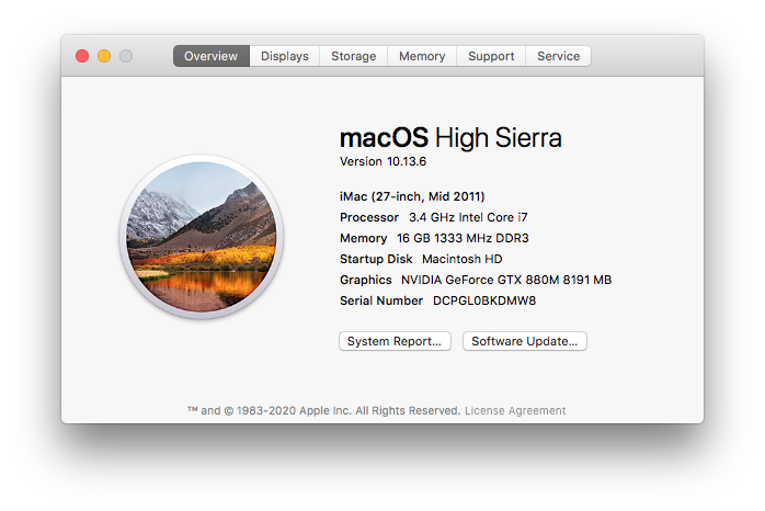

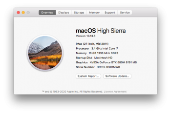

Happy to report I completed my swap this morning. I thought I didn't need to remove the motherboard, but after opening it up last night I realized I needed to.
2011 27" iMac w/ 6970m to 880m kepler gpu.
Lost the normal things, brightness control, boot screen etc, but had picture immediately without flashing any new VBIOS and running default macOS Graphics Driver.
Heat sync needed some grinding to make room for the 880m, but nothing crazy. Used the x-bracket from the 880m.
FYI for anyone worried about this being too much work, if you're tech savy it's just a matter of patience. This was my first time working on a computer so it was a bit time consuming as I labeled every cable and took pictures of everything.
Happy to answer any questions since so many folks on here helped me take the leap.
