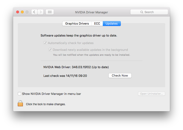

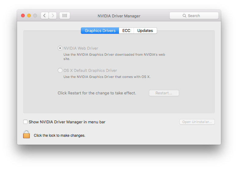

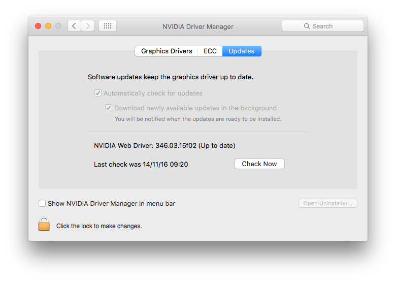

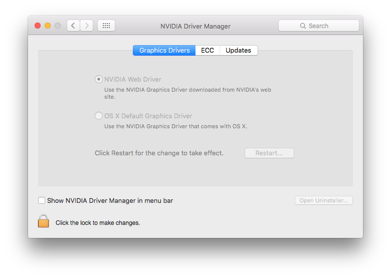

I finally figured out why my GPU is not working properly. GPU-Z unveiled that it's running at 135MHz, VRAM at roughly 200MHz. As GMacUser stated in this post I'm not the only one facing this problem. I checked the VBIOS and it seems as if the drivers are not able to switch the 770m into a more powerful setting. Now I'm going to create a modified VBIOS in the next couple of days to proof this theory.
In the meantime it would be really interesting to see how other systems perform with GpuTest - especially the ones from @Thecoretechreview and @flszen as they use a 770m as well. When I run FurMark Benchmark on 1024x640 I'm getting daunting 5fps. Would be nice if you could grab your GPU temperature as well.

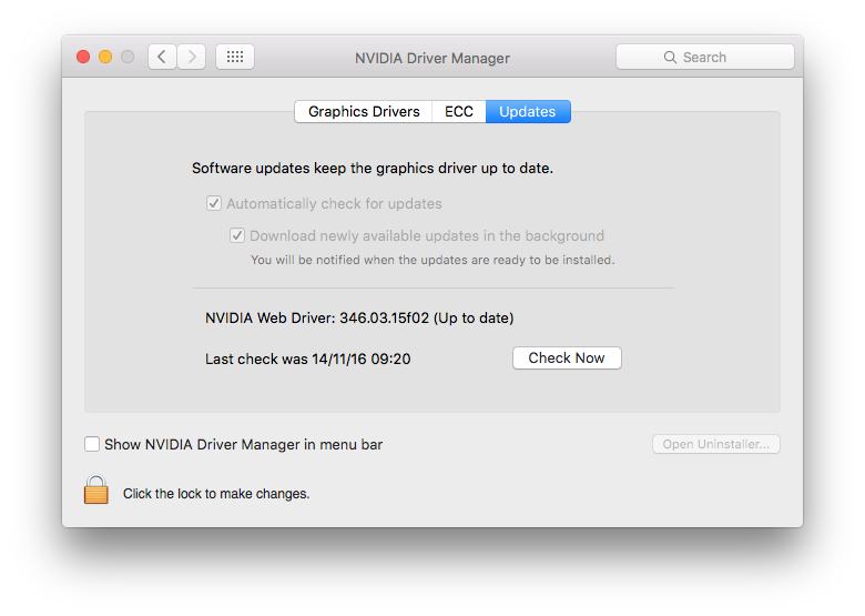

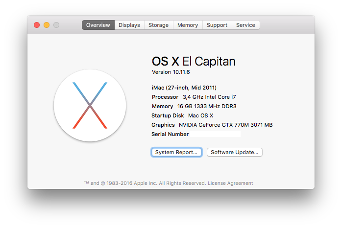

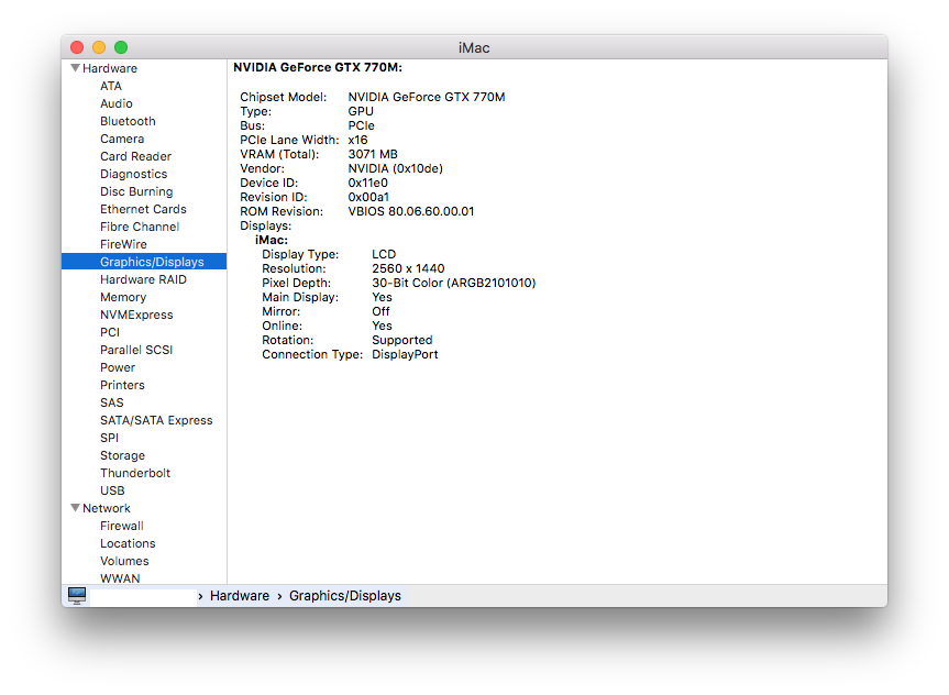

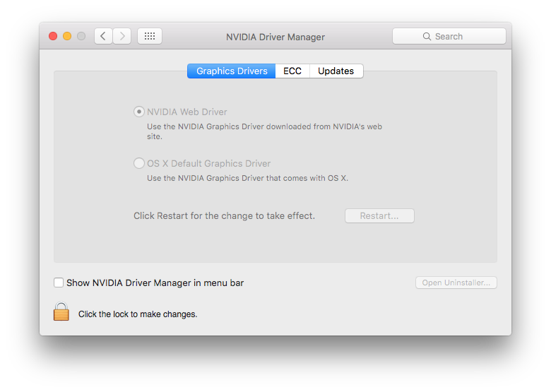

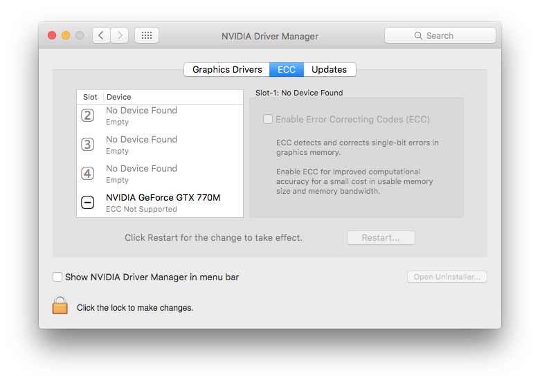

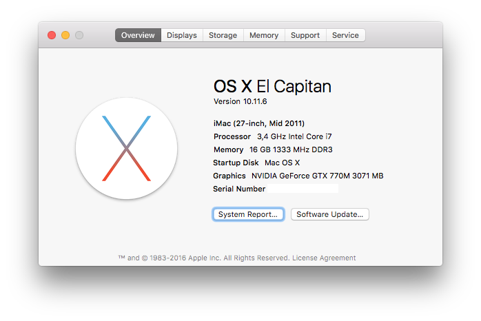

I just wanted to get back to you. Good news first: my upgrade to a 770m was successful. The system boots as expected with the known drawbacks. I use Shades to dimm the screen in darker conditions. The results are not as good as the real brightness control and I definitely wouldn't activate it during colour critical work. It's still fine to reduce the brightness by up to 50% without having too washed out images.
I realised though that my systems seems not to use the graphics card properly. Playing Youtube videos shows a significant jump in CPU load. I also benchmarked my system with GpuTest with, well, horrible results. Has anyone an idea how I can activate the card in my system? It seems a bit weird as it recognises the card properly. Latest nVidia Web Driver is installed as well.
@flszen: As you are using an 770m have you done anything special to get your system working or was it 'just' plug and play? I recognised that your VBIOS differs from mine.

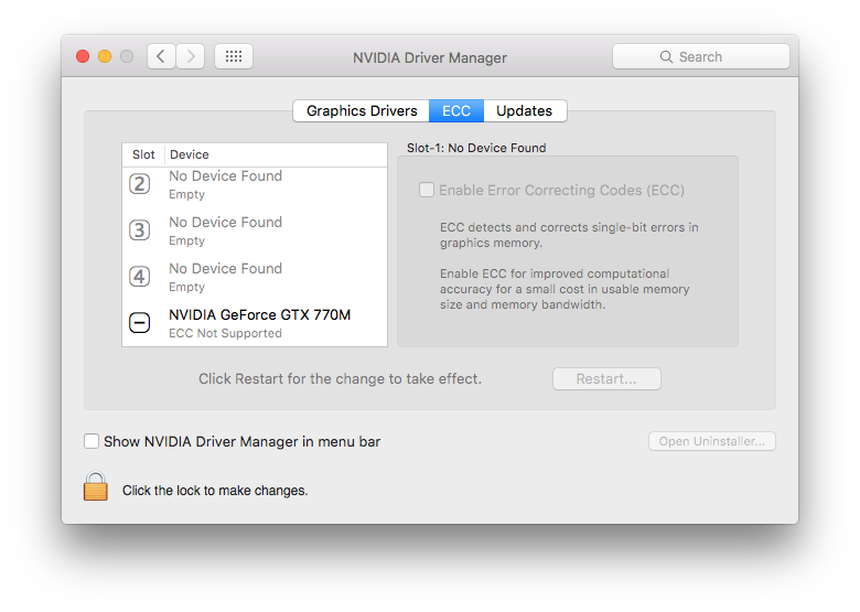

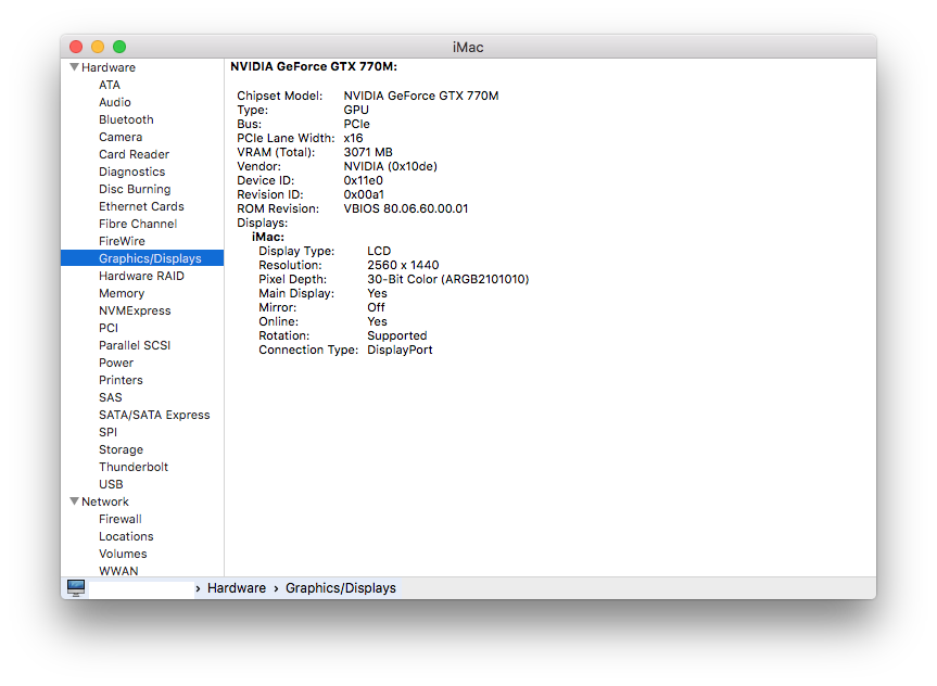

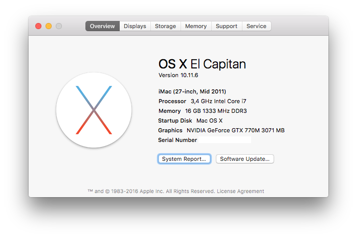

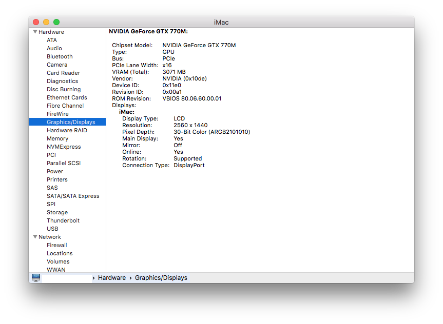

View attachment 672050 View attachment 672051 View attachment 672052 View attachment 672053 View attachment 672054

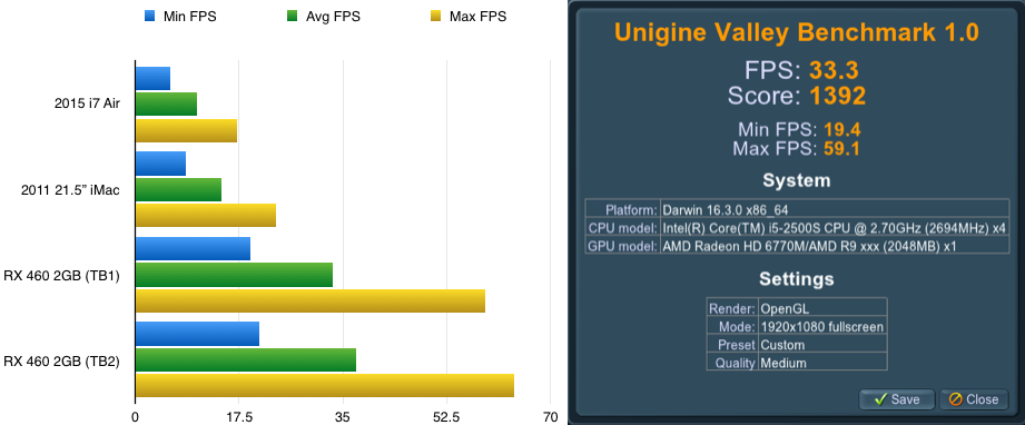

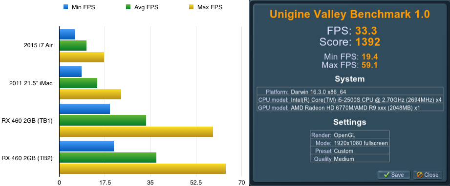

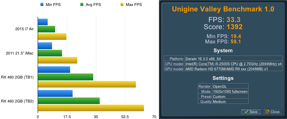

Just dropping in to to report eGPU success using an RX 460-2GB on my mid-2011 21.5" iMac with Sierra 10.12.2. Preliminary tests with Uniqine Heaven and Valley at 1080p medium suggest ~8% frame rate loss vs Thunderbolt-2 with this card. This did require kext edits to enable IO-PCI Tunnel compatibility and only provided graphical acceleration to an external monitor, but I was already using an external monitor as part of a dual display setup.
I don't think this helps the majority trying to work around faulty GPU issues, but I thought it was an interesting alternative for those of us watching the thread in hopes of simply finding a way to gain some extra performance.
Edit: Internal display acceleration also works for windowed applications which are started on the external display and then dragged to the internal. However the performance loss when doing so is high (>30% frame rate loss TB1).
Great! The only sad part is the one that won't work with internal monitor. For me it's crucial that it work with 27 iMac internet monitor (mid 2011), and that it work bootcamp for windows 10 too. I can stay on El Capitan for a little longer...
