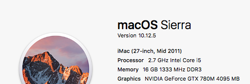

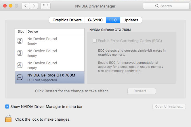

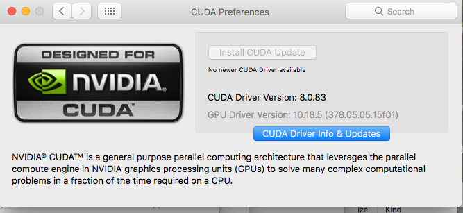

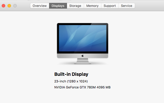

Hi Guys
I need some help
So I managed to install the gtx780m into my iMac mid 2011 27".
As of right now, I'm replying from my mac remotely connected via VNC from a pc I have setup prior to installing the graphics cards. As I can tell, everything boots up normally without any issues except for that I am unable to see anything on the screen - completely blank screen. I can hear the booting sound come up and thats pretty much it
My iMac has registered the device as a visible graphics card (i'll share the screenshot bit later) and I have installed the necessary Nvidia graphics cards driver
I have tried to perform the following steps below but am experiencing the following issues
1. To disable SIP
I cannot login to the iMac remotely when its in recovery mode. How do I alternatively login to recovery mode to disable SIP?
2. Updating the AppleGraphicsControl Kext
I managed to find the board-id but I am unable to modify the kext file to 'write out' from it. I get the following error -
[ Error writing /System/Library/Extensions/AppleGraphicsControl.kext/Contents/ ]
Can anyone share their experiences with this fix or how you've gotten around it?
I have had a look on the web and found the following link to update kext file using Lilu and NvidiaGraphics fix kexts but that didn't work out. I also tried using the Multibeast installer with the UEFI module but that didn't fix the issue with the blank screen -
https://www.tonymacx86.com/threads/...-imac-15-or-imac-17-system-definition.183113/
If anyone could give me a hand that would really be much appreciated. I am almost there but literally in the dark

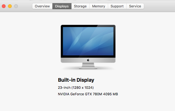

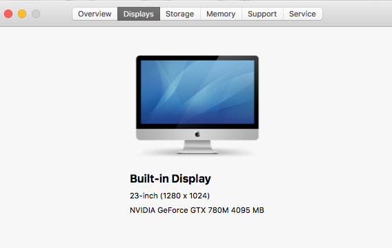

Another funny thing I noticed was that the screen registered as a 23" screen instead of a 27".. does anyone know why this is happening? I assuming this is due to the drivers or kext setup?
Some screenshots

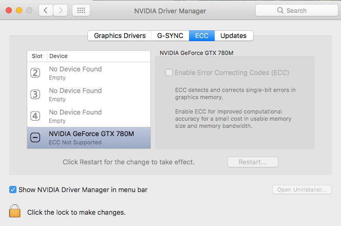

Hi Guys
I need some help
1. To disable SIP
Some screenshots
View attachment 706162 View attachment 706163 View attachment 706164
What it worked to me to get into recovery mode is, at the moment I turn on the iMac, I press the next startup keys command + option + O + R

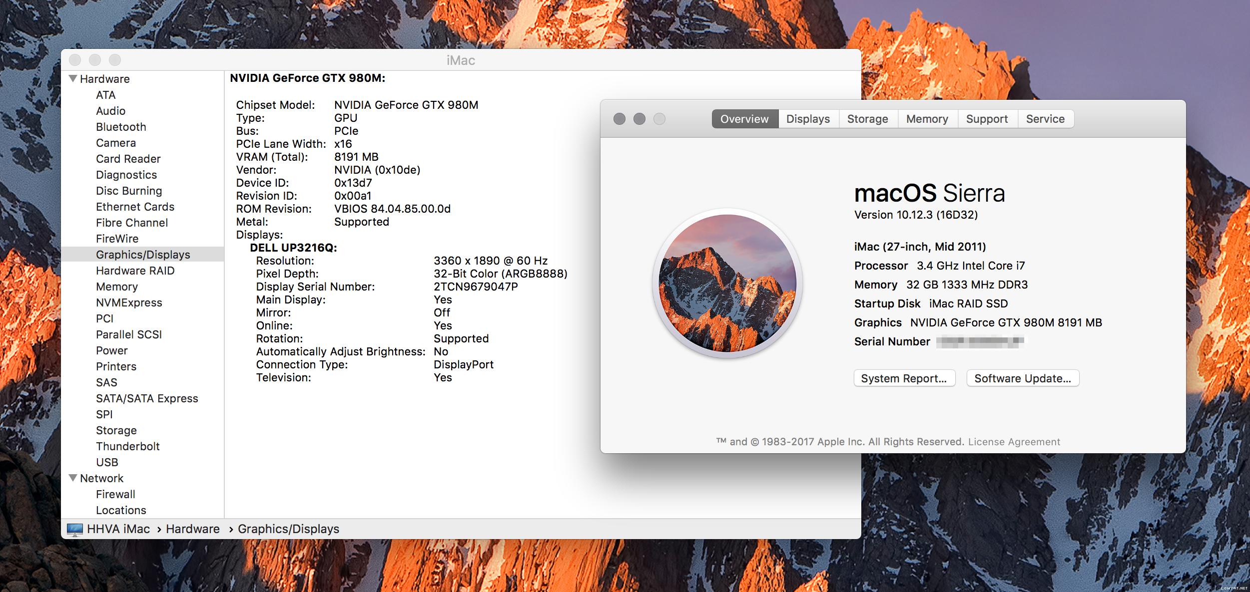

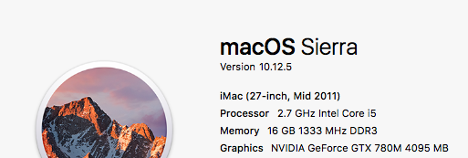

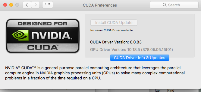

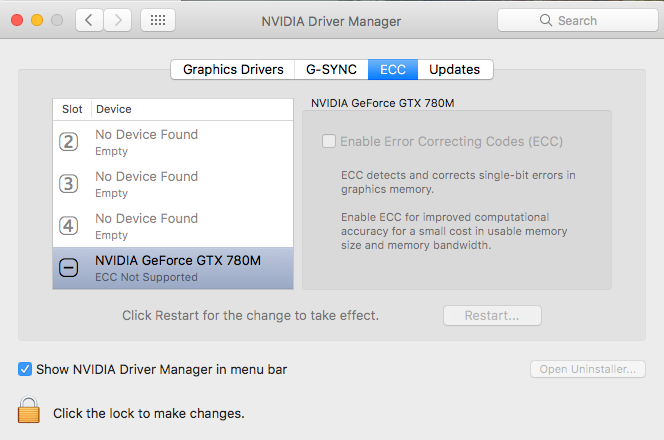

Hi guys, after a while waiting for me, finally arrived the new GTX 780M graphics card yesterday, I would like to start up but before I want to be sure that everything works in my iMac mid 2011 (EMC 2429) macOS Sierra.
@Lost Heaven could you tell me what to do after the hardware installation of the graphics card?
Thank you!
Thank you!
There's really not much to do after a successful GPU installation on the macOS side: if it works, it works. I guess you can configure the Nvidia web-driver software to your liking and install one of the pseudo-brightness control apps available on the app store. That's it. Maybe install a graphical intensive game or application and do some benchmarks, letting them run for a good while while keeping an eye out for the GPU's temperatures with a monitoring app. This will let you know if you applied the thermal paste correctly.

Well, I now have 3 dead iMac 2011. All miss a suitable graphics card..
My first try was a NVIDIA GeForce GTX 670MX. I modded a heatsink and the iMac boots - but of course without a bootscreen. I can login via ARD, but the main screen is dead, so I guess the display routing is wrong. The 670MX was not that expensive (I bought it about a year ago for $120 for a dead 2009 - which magically recovered and works till then with its Radeon..) and at least it works via ARD.
https://www.techpowerup.com/gpudb/1413/geforce-gtx-670mx
3GB RAM and a GK104 isn't that bad for $120, I guess it's from a Dell.
10.9.5: Boot loop with Apple NVidia drivers crashing
10.11.6: Boot loop again. I installed the Web drivers and it boots - even with Apple drivers enabled (which seems to be the default). It detects the NVidia with correct model and RAM size, but no display enabled (neither internal nor external with mDP to DVI adapter). With NVidia drivers enabled, I get a boot loop again until I reset the PRAM several times.. weird.
Kernel Extensions in backtrace:
com.apple.AppleGraphicsDeviceControl(3.12.9)[21580824-E82E-371E-8FEE-B213B71B5C58]@0xffffff7fa75bd000->0xffffff7fa75c3fff
com.nvidia.web.NVDAResmanWeb(10.1.1)[F7B82BA6-ECC9-3FF9-8ACD-9841C0A2448B]@0xffffff7fa7b84000->0xffffff7fa7e63fff
Once up again, same as without the Web drivers, prob. I didn't need them at all and the vanilla system also needs several PRAM resets..
Graphics/Displays:
NVIDIA GeForce GTX 670MX:
Chipset Model: NVIDIA GeForce GTX 670MX
Type: GPU
Bus: PCIe
PCIe Lane Width: x16
VRAM (Total): 3072 MB
Vendor: NVIDIA (0x10de)
Device ID: 0x11a1
Revision ID: 0x00a2
ROM Revision: preset 1.0.0
Displays:
Display:
Resolution: 1280 x 1024 @ 60 Hz
Pixel Depth: 32-Bit Color (ARGB8888)
Main Display: Yes
