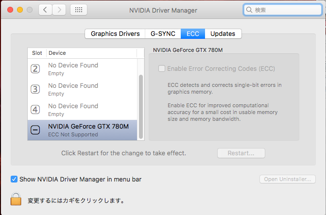

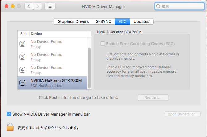

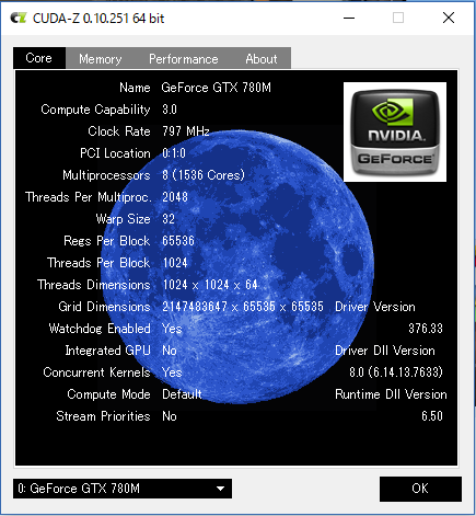

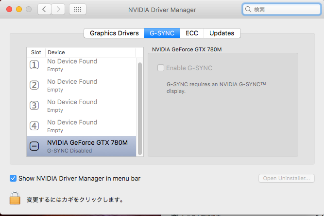

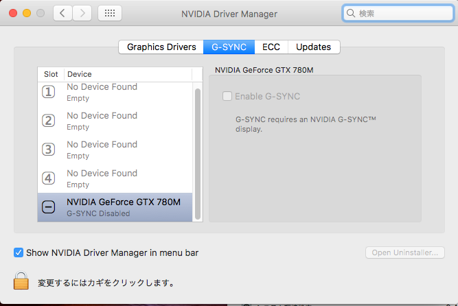

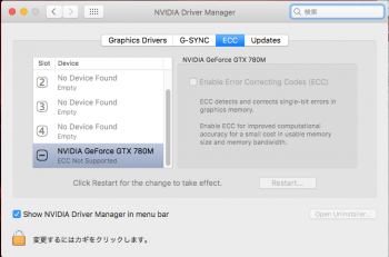

I was trying to find what is the problem on my Mac.
You guys have idea what is the status of attached screenshot?
From iMac, my 780m is detected, but slot information incorrect. (it should be on slot 3)
It's working perfectly on bootcamp@windows 10.
from iMac with nVidia driver manager

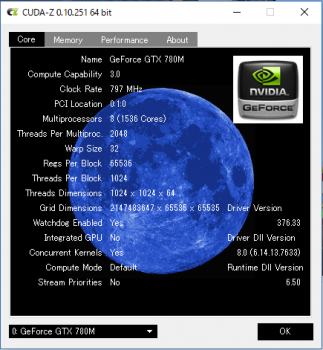

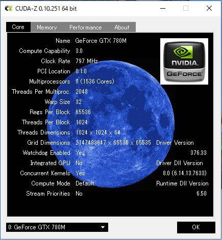

from windows, cuda-z status.

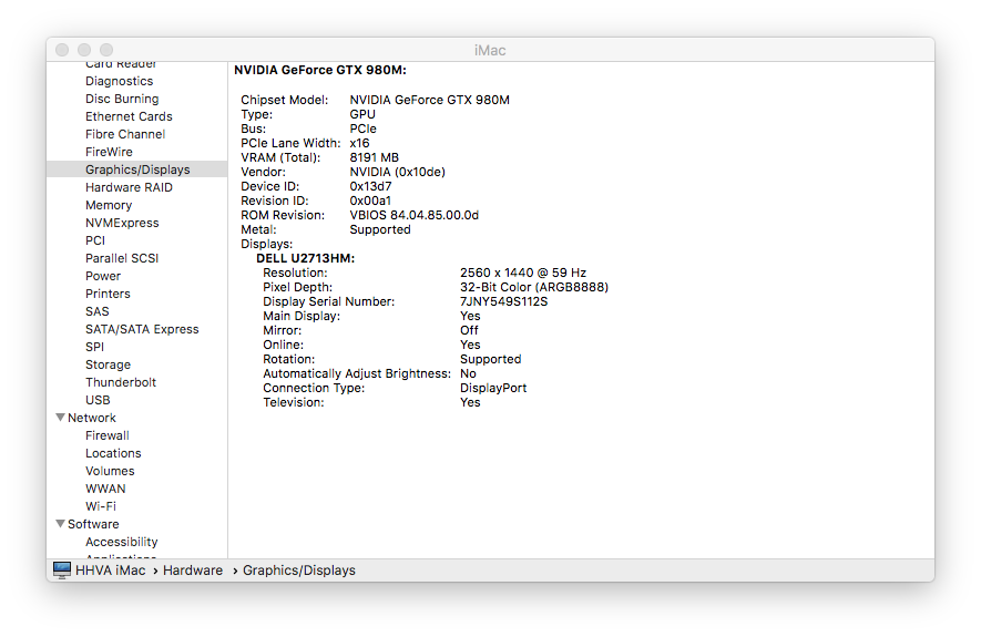

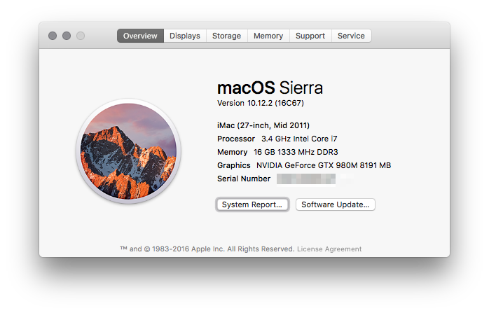

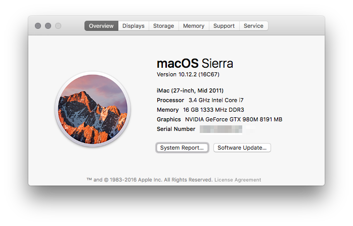

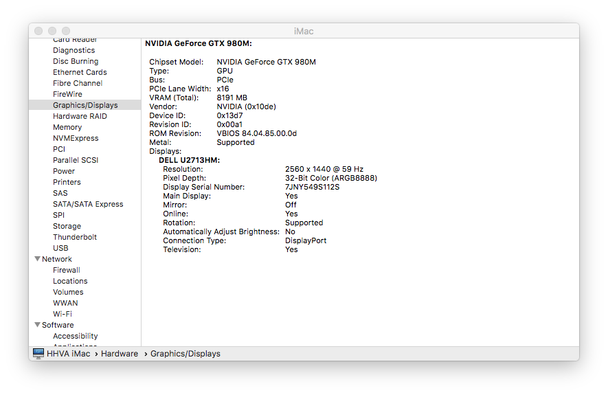

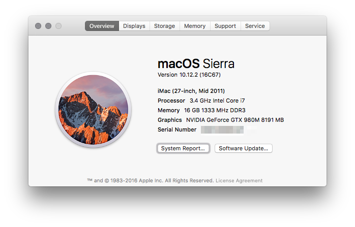

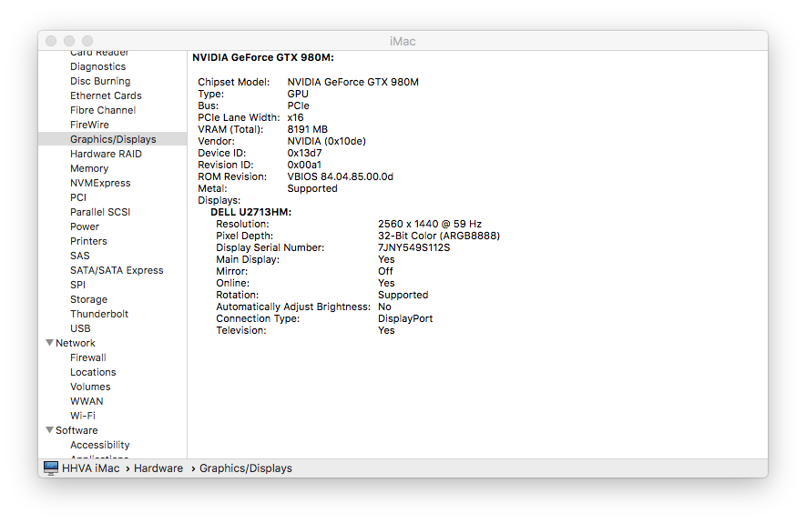

Received the GTX980M today and installed it on my iMac 27" 2011. Had to do some mod on the heatsink coz the capacitors are much bigger than the GTX780M. Sadly it only works on external display, not the main iMac display. Any ideas how to enable the main iMac display guys?
View attachment 683218 View attachment 683219
mhafeez Did you ever got your internal screen working with the 980m? I am thinking of going this route too.
Sorry prodigyman due to insufficient of time I'm still haven't got the chance to do the research or fresh installs on my iMac but I'm still using the gtx980m with my external monitor for my works. I'll let you know soon.
No worries, let me know how it goes when you can. Thank you.

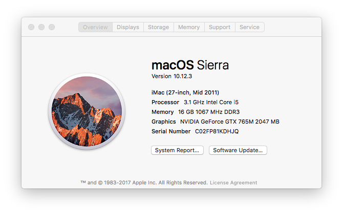

Has anyone tried the GTX 765M or GTX 860M yet?
Yes. I installed a 765m in my 2011 27-inch a couple of days ago. Works fine; no boot screen, no brightness control and no second monitor. I've enquired over at Netkas to see if anyone had an EFI ROM that I could flash it with. Still waiting so if anyone has any ideas, I'm all ears.
