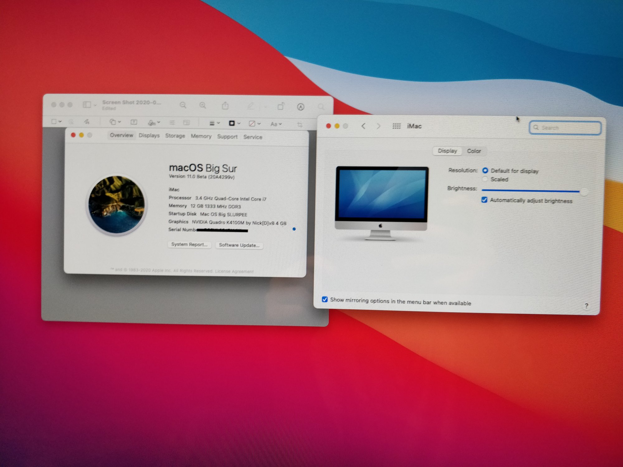

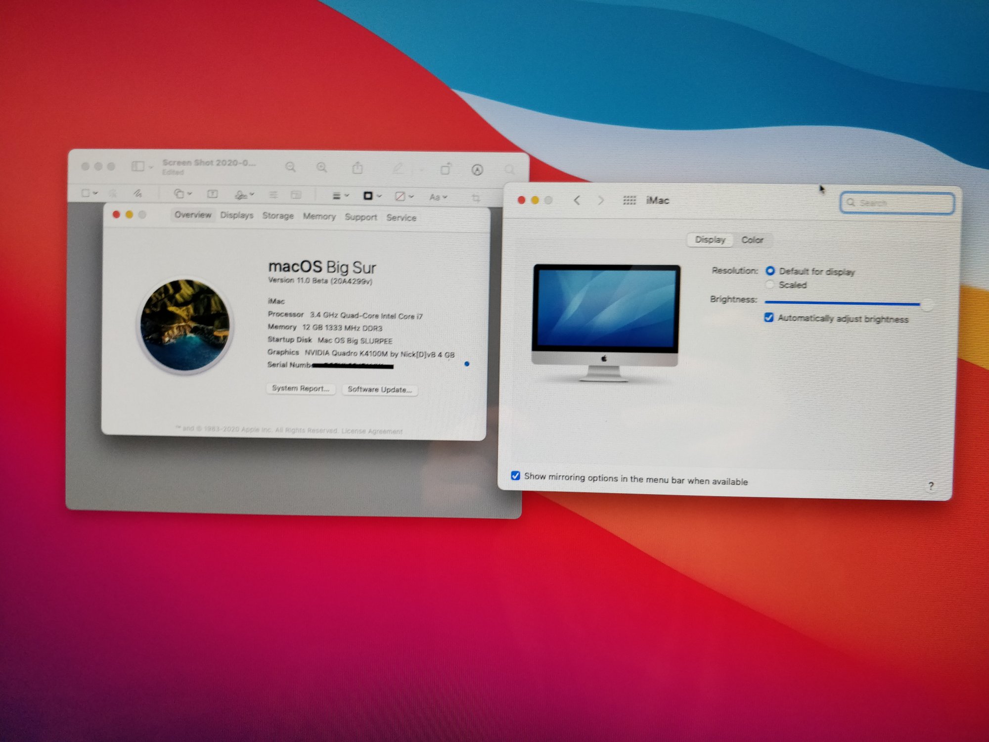

I am able to boot Mac OS 11 on a 2011 iMac. I see the IOsurface and AppleIntelCPUPowerManagement.kext is still there. So maybe the hd3000 Kext will work. I'm booting over USB 2.0 so everything is slow at loading. Nvidia Kexts are still there for Kepler.
Backlight Kext needs to be reworked for Mac OS 11.
Full brightness isn't correct anymore.

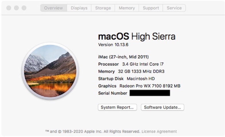

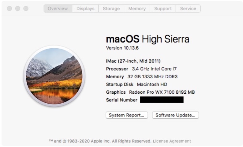

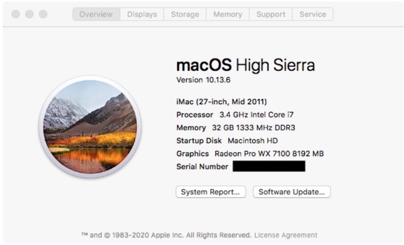

NOTNICE (and anyone else interested)... I recently discovered something about this quite by accident. As I previously wrote a couple of days ago I was able to get my 2011 iMac 27" working with a WX7100 by following the updated Catalina Loader guide posted by @Ausdauersportler (Post #7323). After shutting the iMac down and removing the OC USB drive in preps to make the PolarisBoost mod, I started the iMac up without the OC USB drive inserted. To my surprise, the iMac started up without issue directly to my desktop. The screen remained black until a couple of seconds before the desktop appeared. Everything has been working normally in this fashion without the OC USB drive inserted after multiple restarts. [Note: I have not yet made the PolarisBoost mods for the sleep issue...and I can confirm the slowdown problem exists on my machine. My Valley score and FPS were cut in half after waking form sleep].
So, to make the long story above much shorter, I am able to successfully boot into the latest version of High Sierra without using OpenCore despite the fact I used the GOP VBIOS to flash my WX7100. Unfortunately, I don't have a full technical explanation to offer.

Is this with the AppleGraphicsControl.kext installed? If so, this is normal
It is with the AppleGraphicsControl.kext installed using the file from your previous post (#5887). Thanks @highvoltage12v!

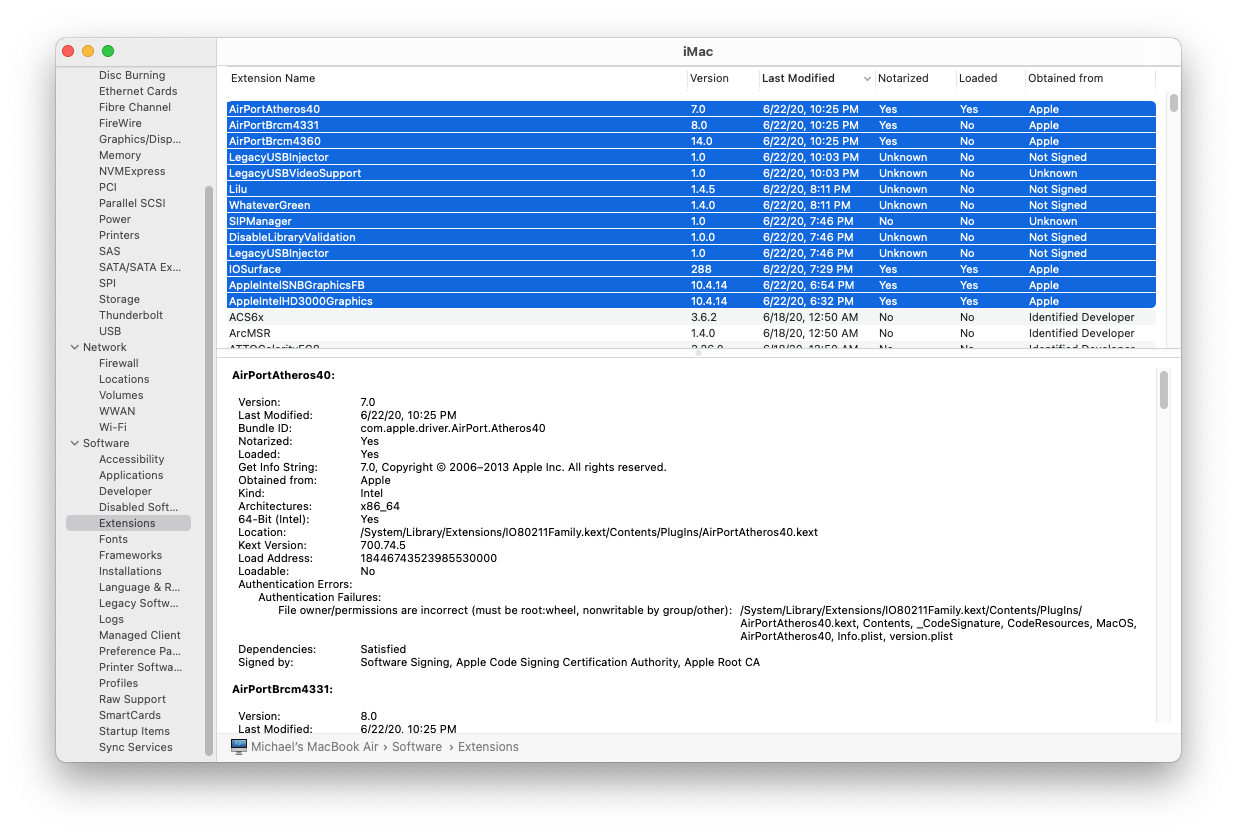

I'm quoting my message from the Mac OS 11 thread here. It's mostly good news. Just don't know how to get non Apple Kexts to load, most likely an OpenCore issue.
Thanks for this! I at least have hd3000 Airport and HDAudio working now, IOSurface was able to remain stock, no replacement needed. Going to test sleep now.
We have working sleep! I know that this is such an early beta and things will change, but at least it works!

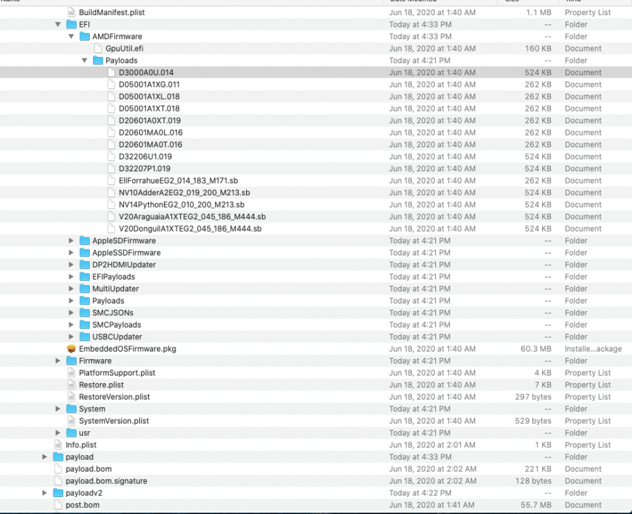

Also there are some EG2 ROMS in OS 11 worth looking at. I'll have to dig them up for everyone.

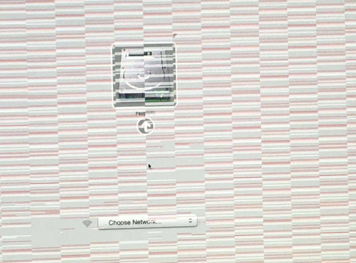

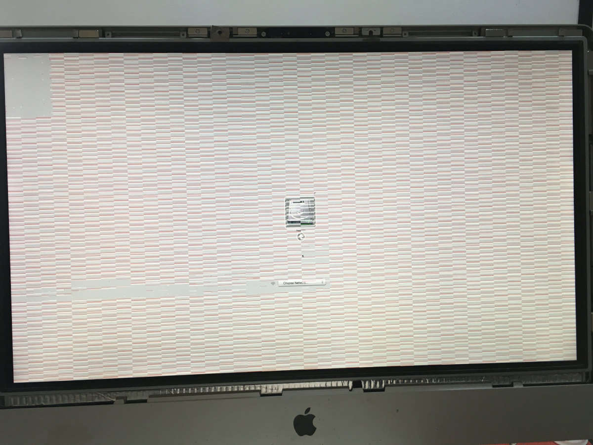

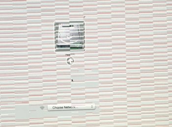

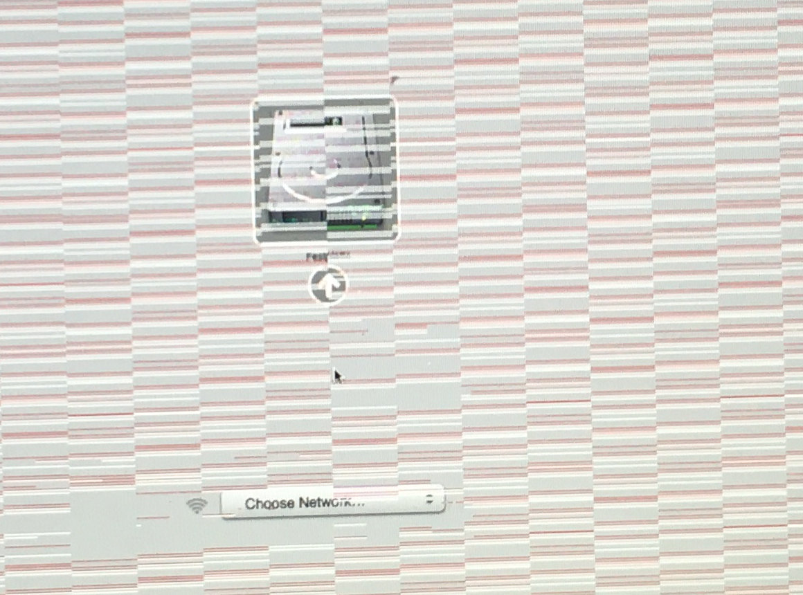

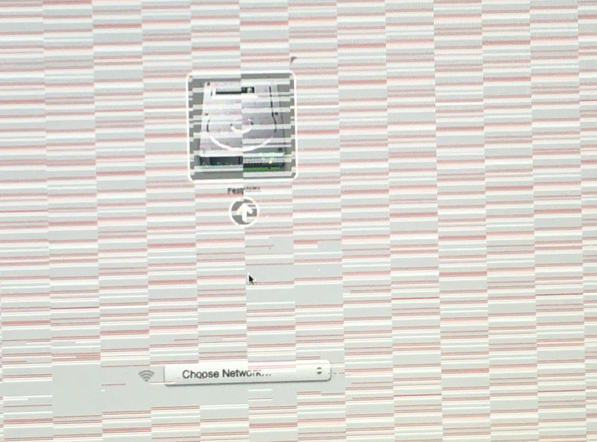

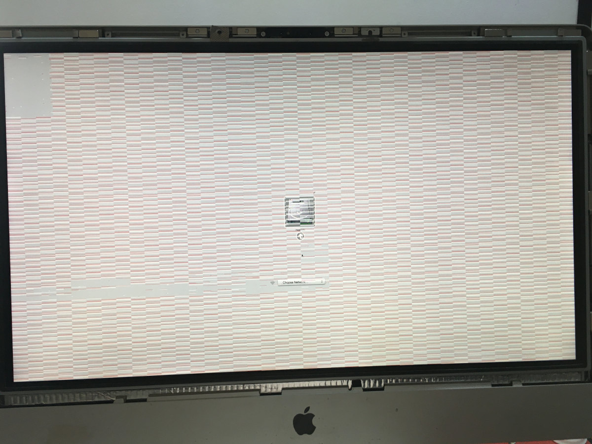

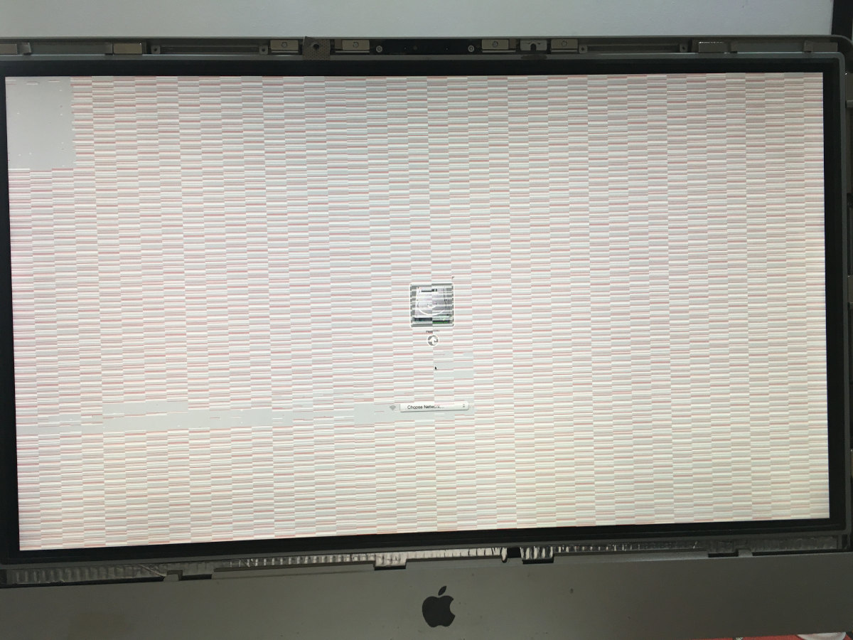

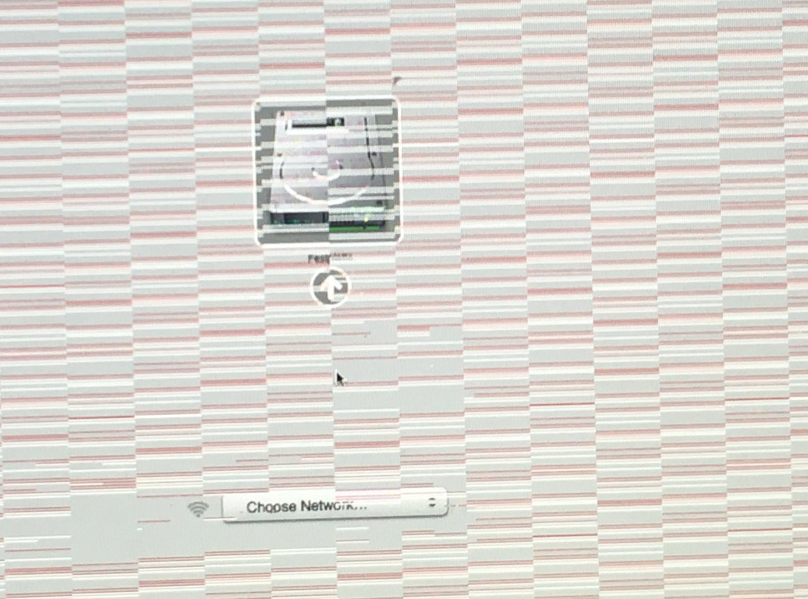

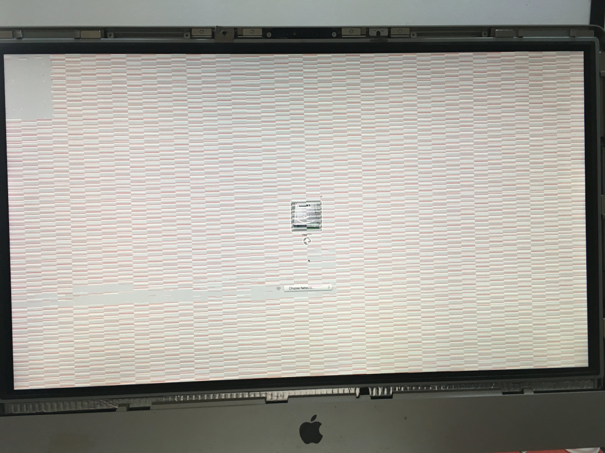

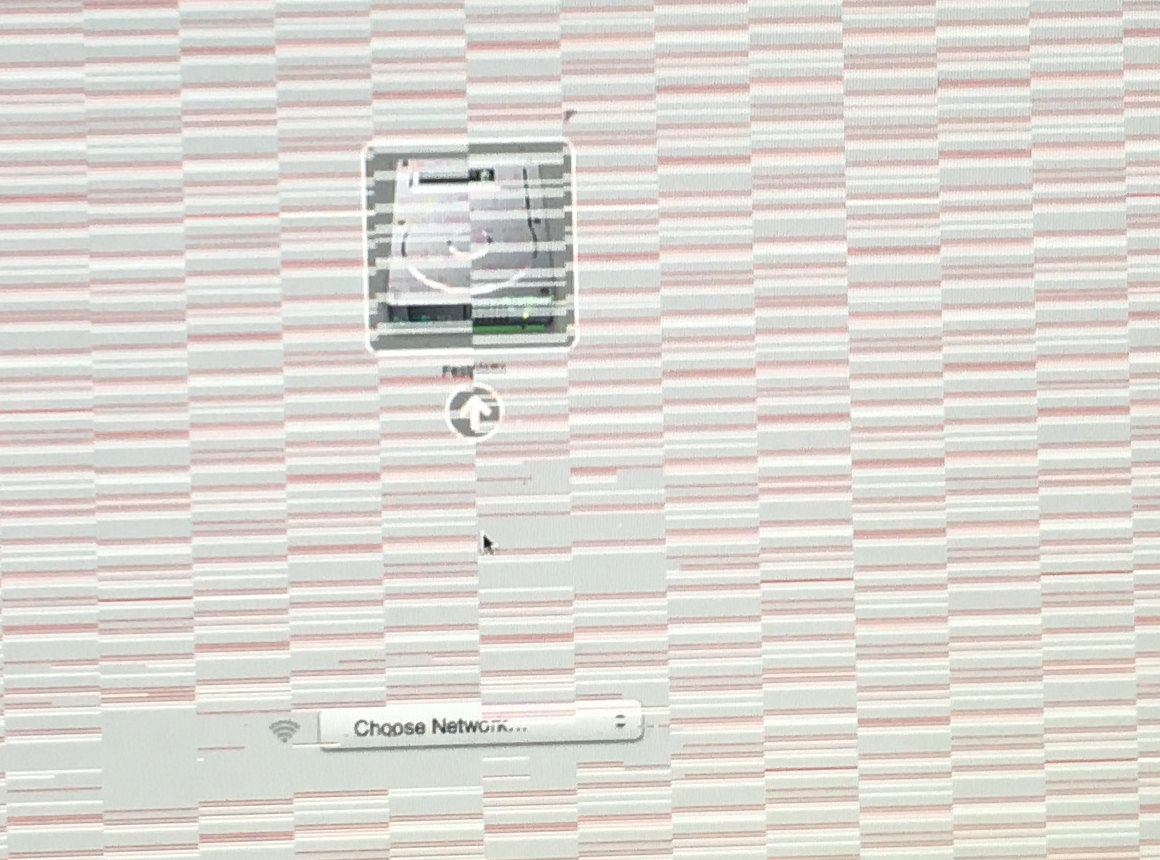

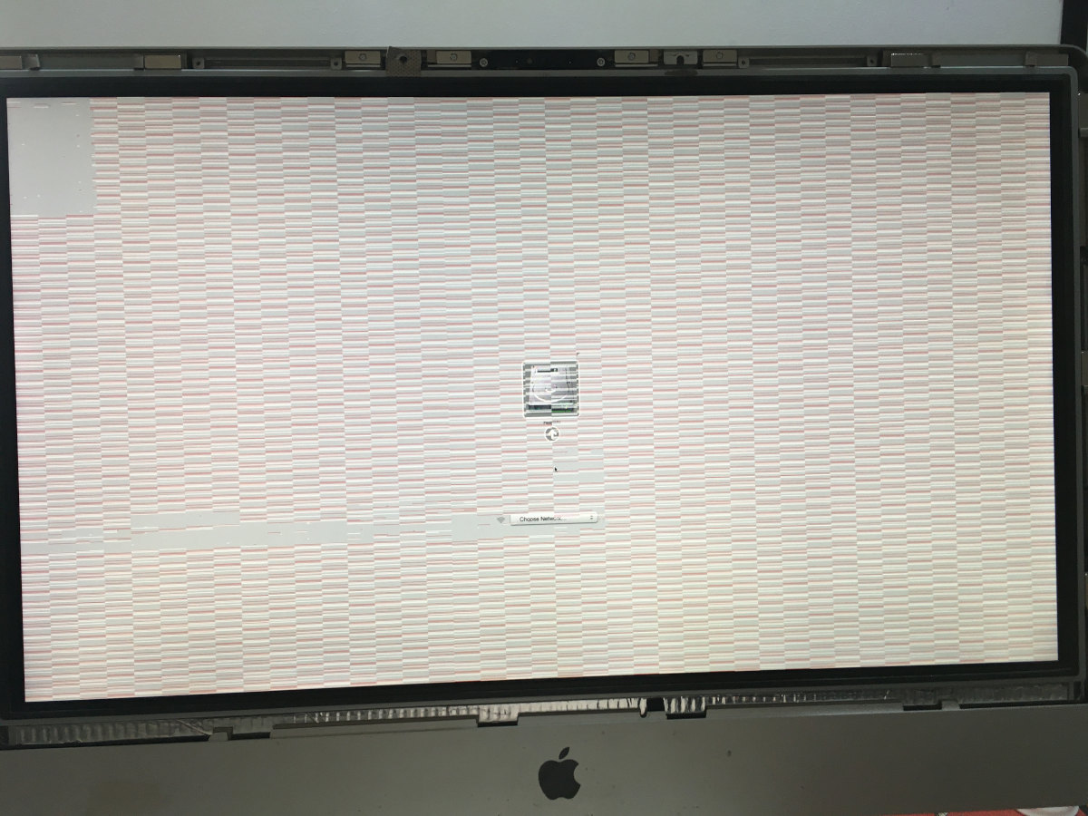

What could this be? GPU or VRAM? This is a picture of a flshed GTX 780m, it worked for some time and at a sertain paint it just did this.
looks to me like bad vram perhaps.
I hope/presume you also cooled the vram chips on the backside, like I did with my GTX765M mods.. ?
I highly recommend cooling the vram on all chips if possible btw..
I don't know if the RAM were cooled or not, this is not my card. Hmmm could even be a 860m. I planned to make some RAM-Cooler for my K1100M an GTX765M i got here. Do you have come pictures of it? How thick is your coolingmod?
Til today i did not changed RAM-chips on PCB's. I will see to find some on fleaBay.

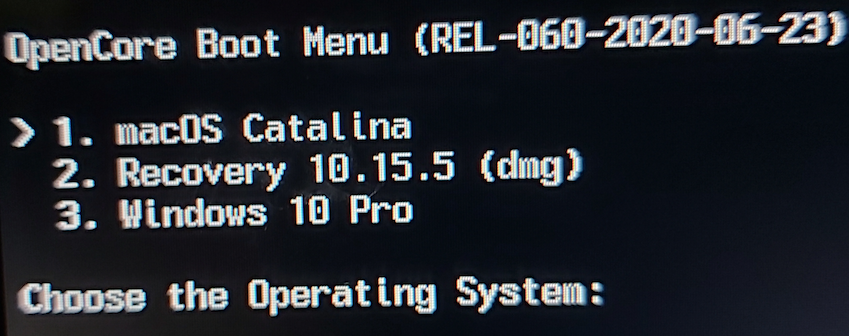

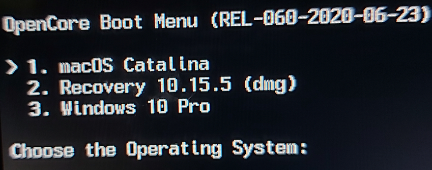

2. Native brightness control is available for the Quadro K1100M and K2100M as well as the AMD cards using a combination of custom VBIOS and OpenCore. See this post for information about using OpenCore. A guide to using the provided OpenCore disk image by @Nick [D]vB has been written by @herrdude on THIS POST.

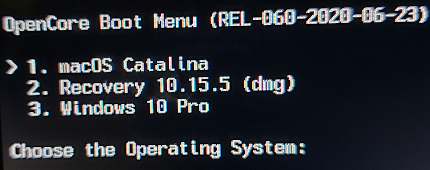

opencore say update is available...Can we update it or should we leave it?
You can update the Lilu and Whatevergreen, but updating OpenCore within the Catalina loader is still a riddle not really solved.
If you want to test we are happy to hear the results 🙂

Yes, this is no problem and well known. But we use for a good reason the Catalina Loader installed on an external device. If something is going wrong or you want to experiment on the settings you simply build a second SD card and have the fall back by hand.
