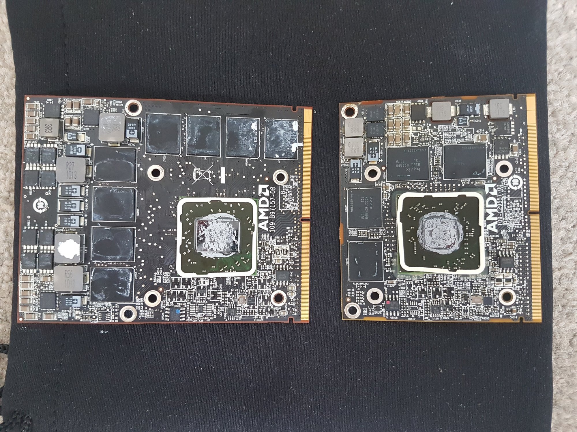

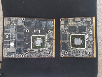

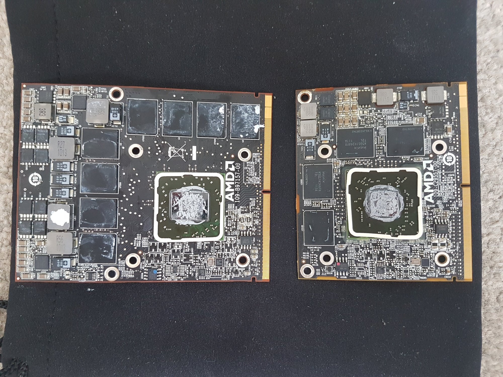

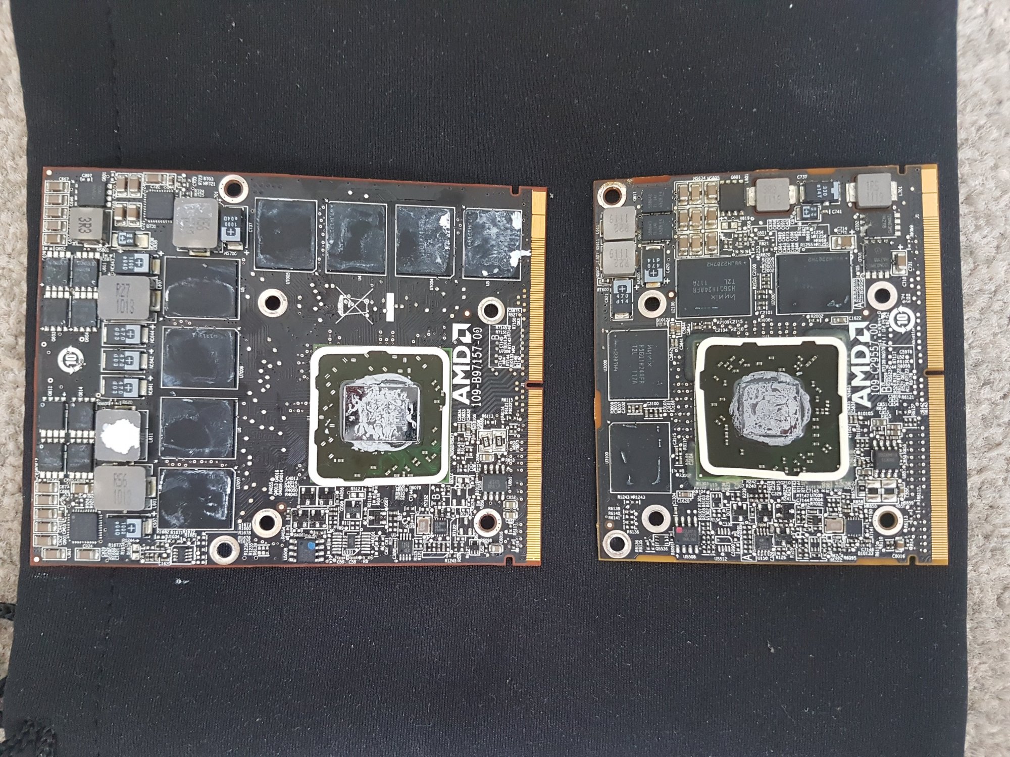

Sorry to ask the question again @herrdude and @Ausdauersportler, but are you sure? I've finally opened up the iMac, and it doesn't look like the AMD card from my 2010 27" iMac will fit on the heatsink of the 2011 21.5" iMac - here are the two cards side by side.
Left one is a HD5750 iMac 27" 2010
right one is a HD6750 iMac 2011
Yes I know (as I've pulled them from both these machines!), my question is because a few days ago I asked - before I had taken apart the 2011 21.5" iMac - whether I could replace its old busted HD6750 with my old HD5750. I was told that it was possible as they were both MXM, but perhaps I was not 100% clear that they were not from different sizes' iMacs.
Just to check, there is no way this will work no?
Is my only choice a smaller card like the K1100M or K2100M? They're not so easy to find outside of US/China...Or perhaps baking the card, but the 2011 iMac (unlike the 2010) is such a pain to dismantle that I'd rather not have to do this again if it's not a permanent solution.
On the 21,5" only the smaller cards will fit, if you don't want to modify the case and remove the 3,5" hard disk. On the 27" both, small and bidder cards will fit and work. The HD5750 will also work in the 21,5" 2011, but you need to modify the internals a little.
Thanks a lot for this - the 3.5 drive is getting replaced by a 2.5 SSD anyway, but I'm not sure I want to modify the case (or how I would go about it anyway). I don't suppose anyone in the UK/Europe has a spare K1100M/K2100M they're willing to sell then?

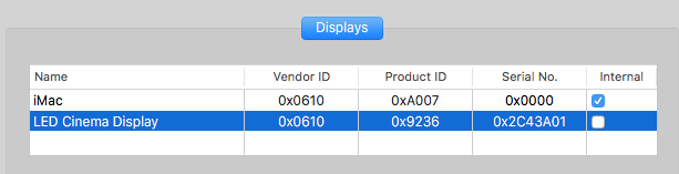

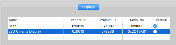

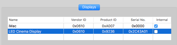

Hi All, I have a question regarding external displays - I have K1100M on iMac 27 2011, running Dosdude1's Catalina Patch, custom bios and OpenCore loader all working fine, when connecting to an external HDMI monitor, the mini-dp to HDMI cable works fine, graphics shows.
However when used with Apple's LED Cinema Display (27-Inch)(non thunderbolt), I can only get Bootcamp Windows to show up on the Cinema Display. When in Catalina 10.15.4 (With OpenCore or not), the Cinema Display remains undetected (either from OpenCore or not). When in High Sierra with or without OpenCore, it works fine.
This is really strange as it is only Catalina that it is having problem with.
Any one can shed some light? Thanks.
I have pinned down the problem that:
K1100M is indeed dual-mode, supporting both HDMI and Mini DisplayPort signal.
High Sierra, with K1100M, iMac 207 2011, Custom Bios, OpenCore or not => Outputs successfully to Mini Display Port, 4k @ 60 hz
Catalina with Dosdude1 patch, with K1100M, iMac 207 2011, Custom Bios, OpenCore or not => Doesn't output to Display port, only output via Mini-DisplayPort to HDMI signal, 4k @ 30hz max using MDP=>HDMI 2.0 Cable.
Does any one know how I should work out what went wrong? It appears that the OS was loading some module that prevented DisplayPort output.
