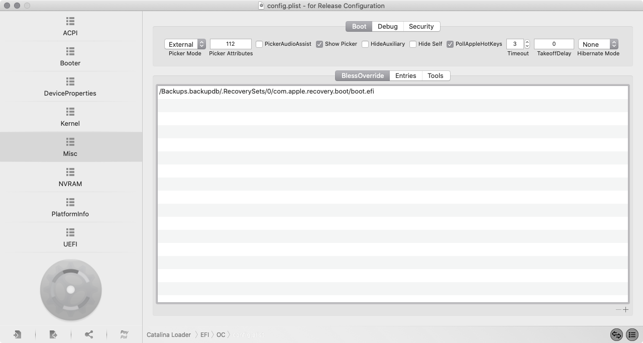

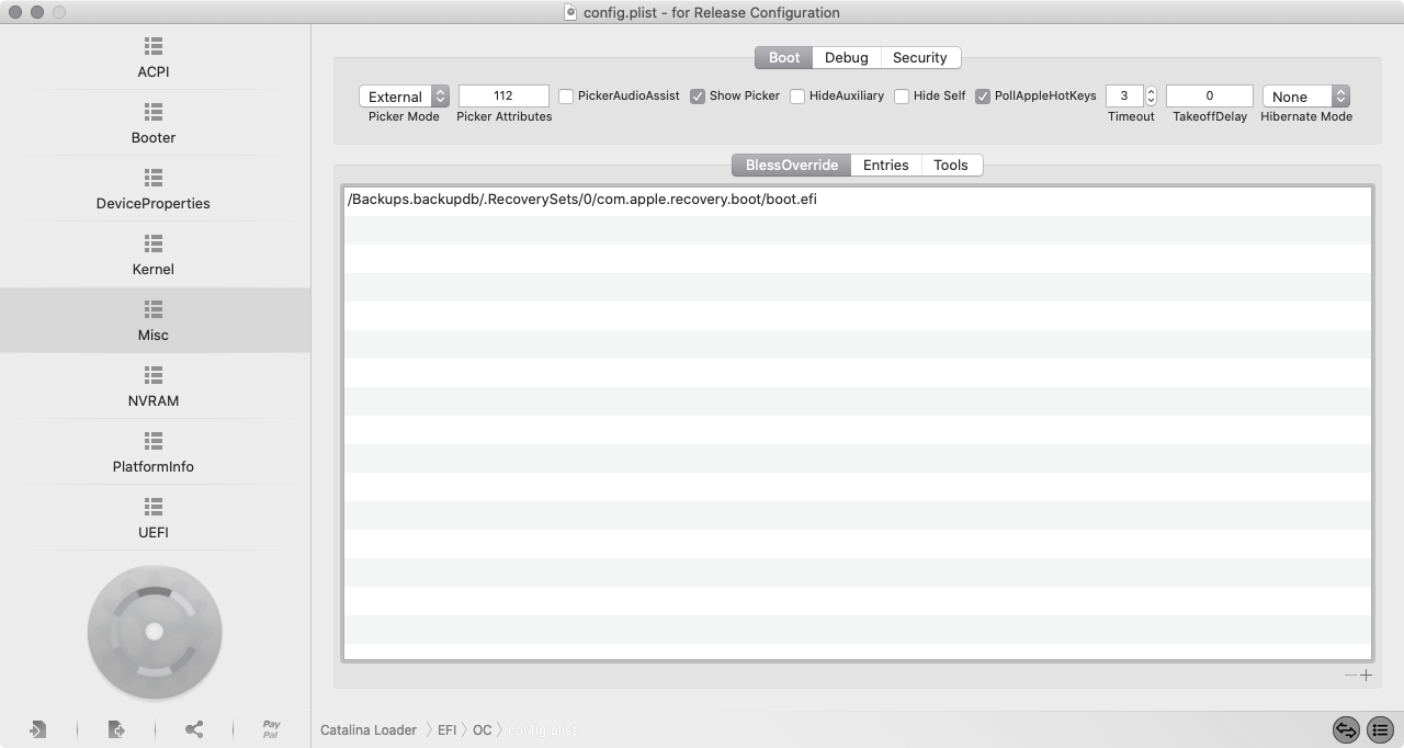

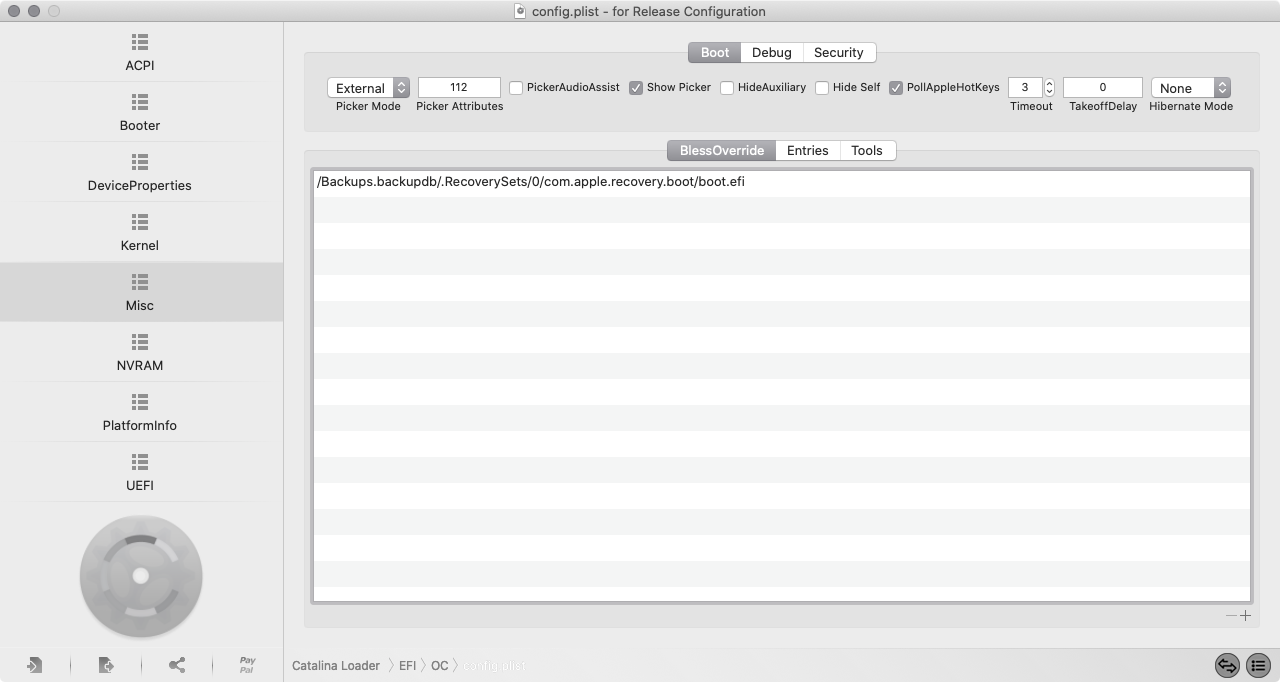

what do I have to config to get
A) Catalina Bootloader to pick Macintosh HD by default
B) count to 3 and boot A)
C) hide "Catalina Loader" from my Desktop
so I can enjoy a "vanilla experience" as much as possible.
thanks 😀
