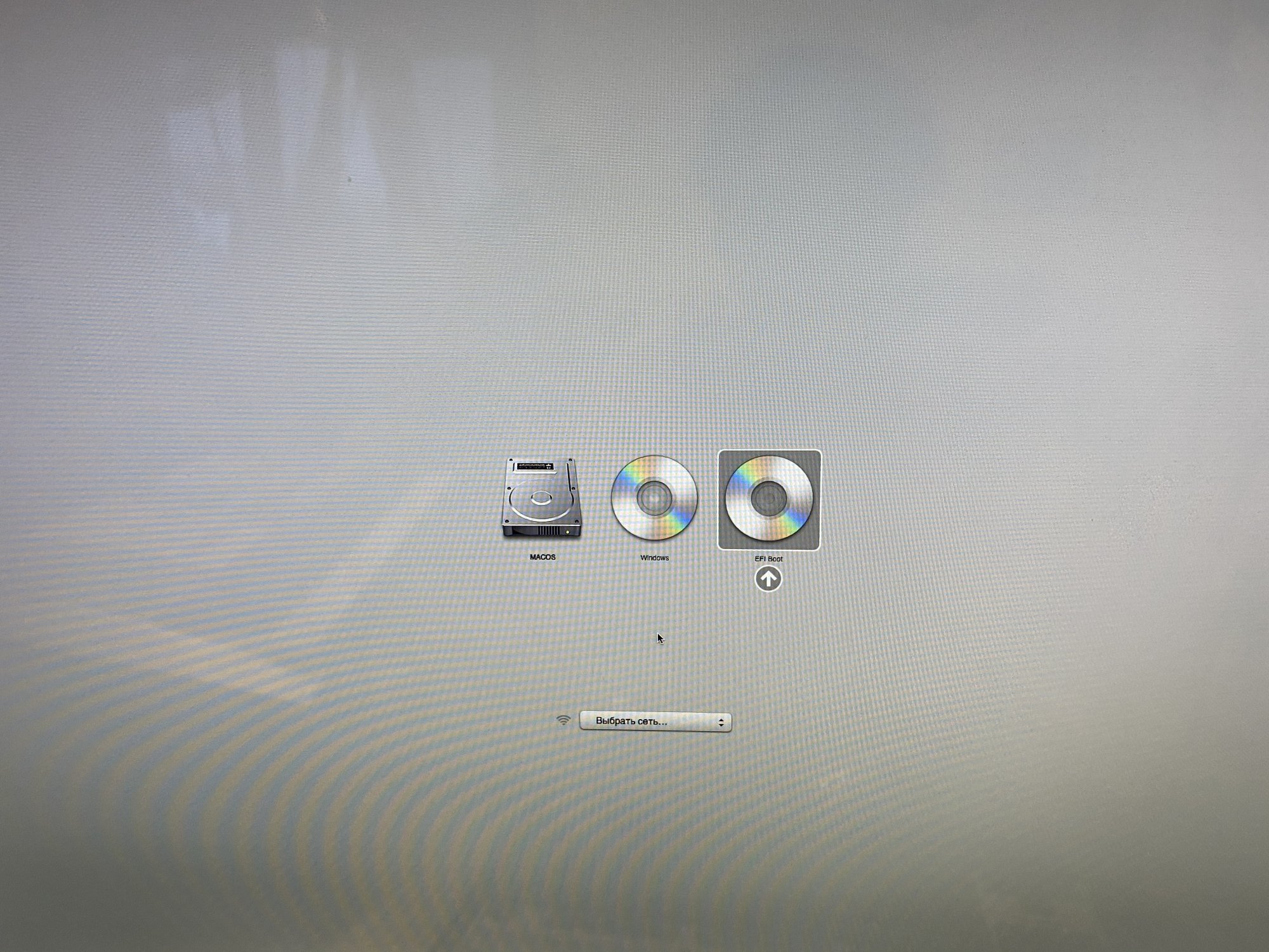

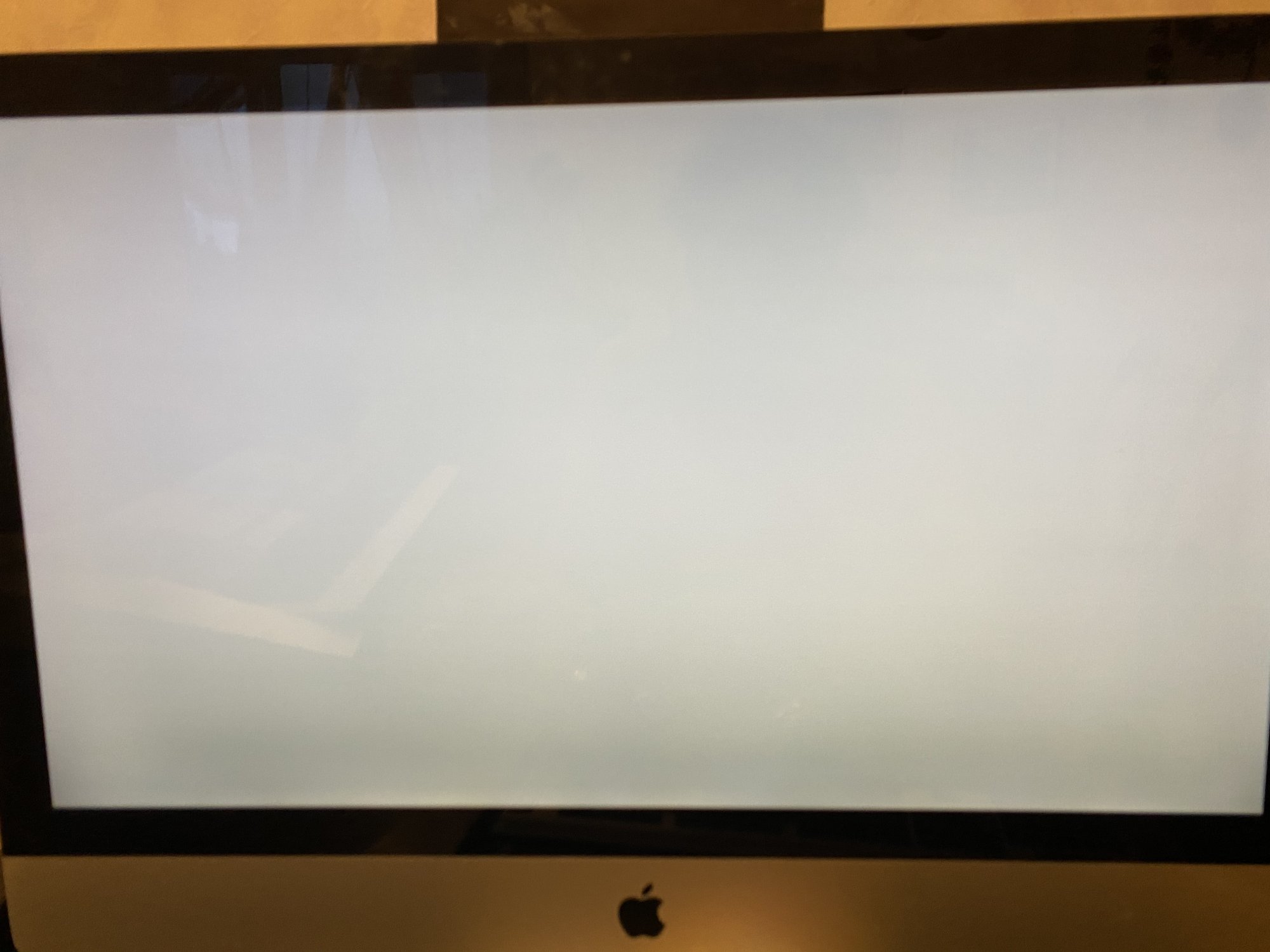

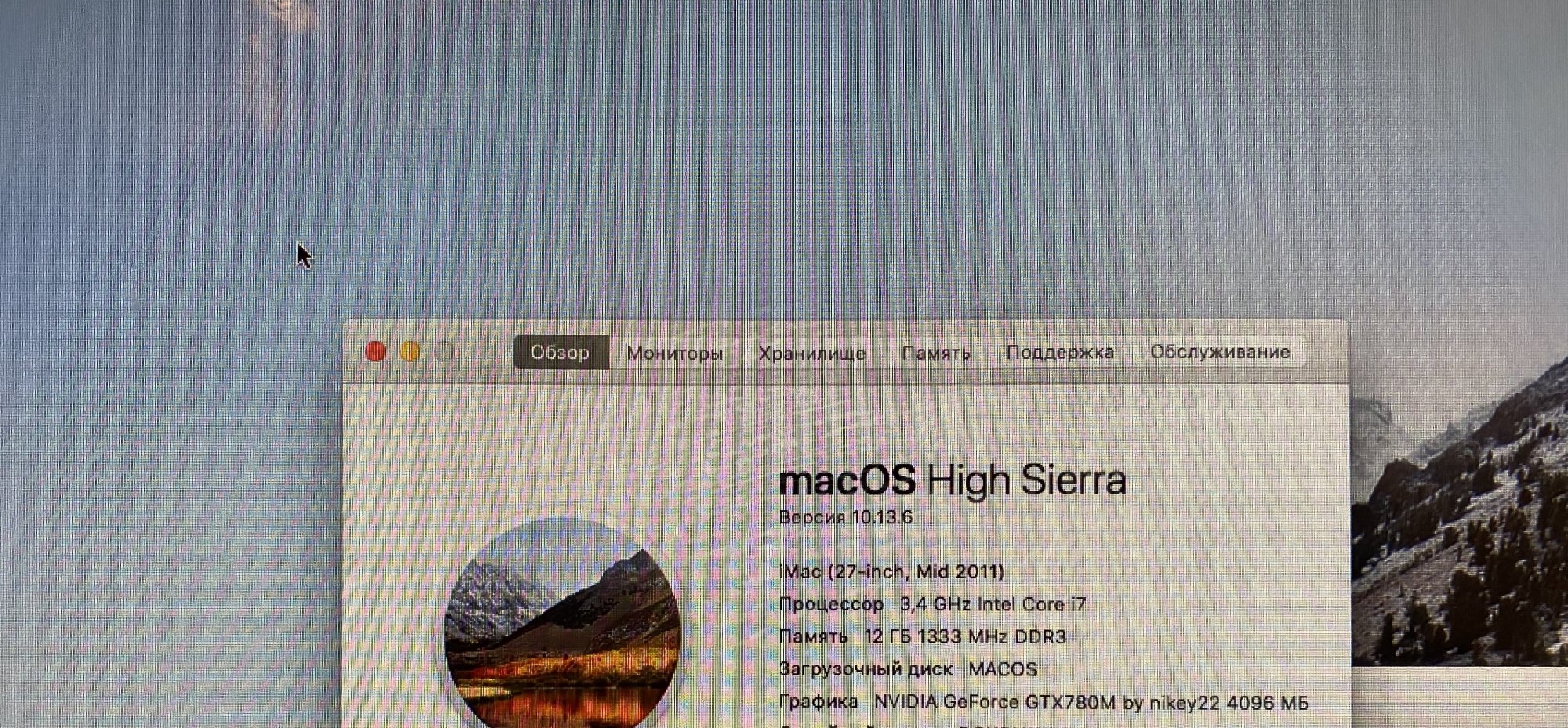

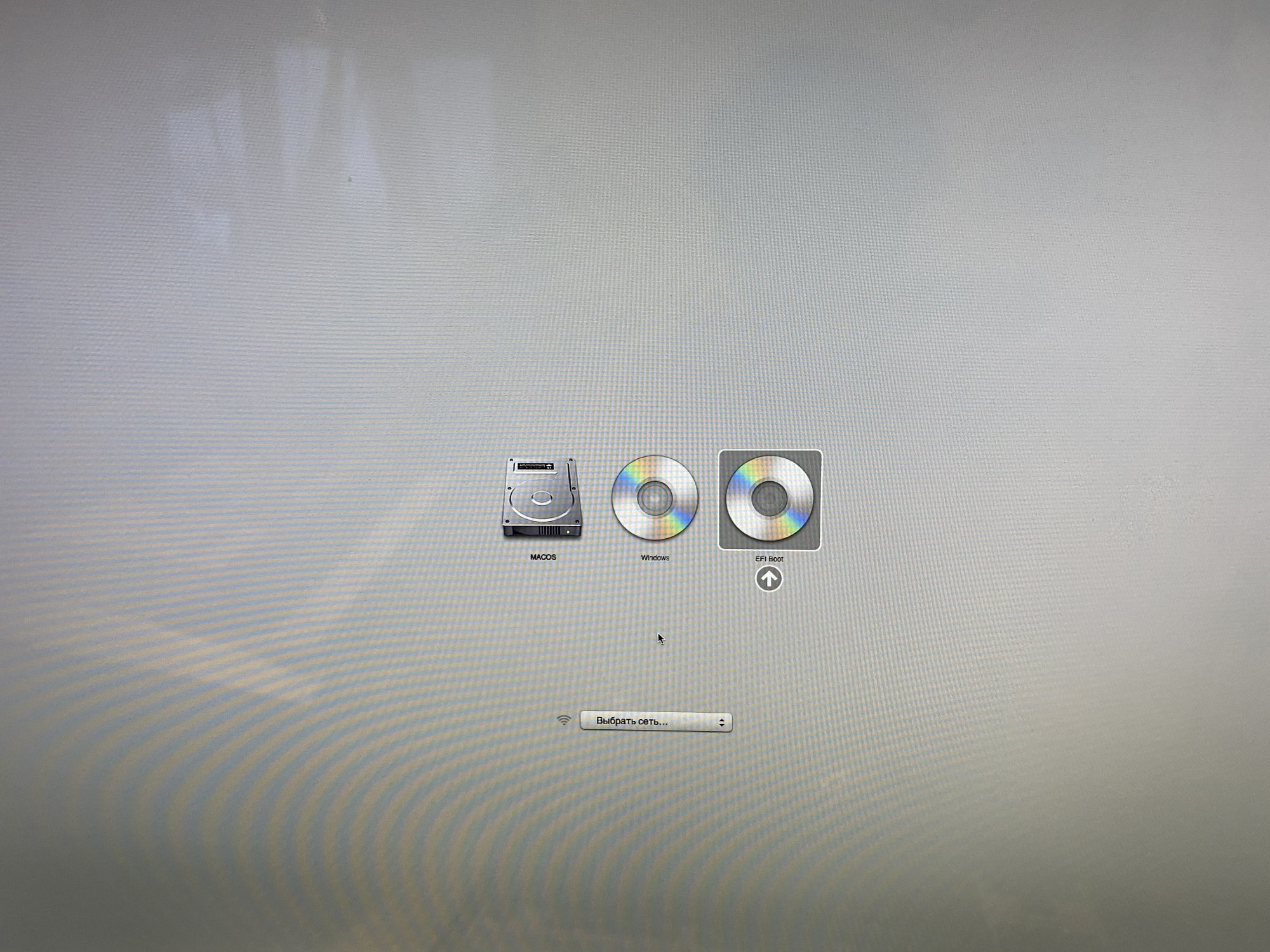

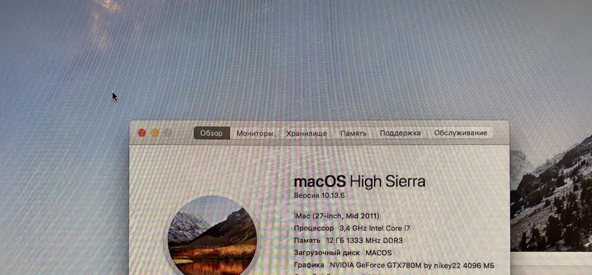

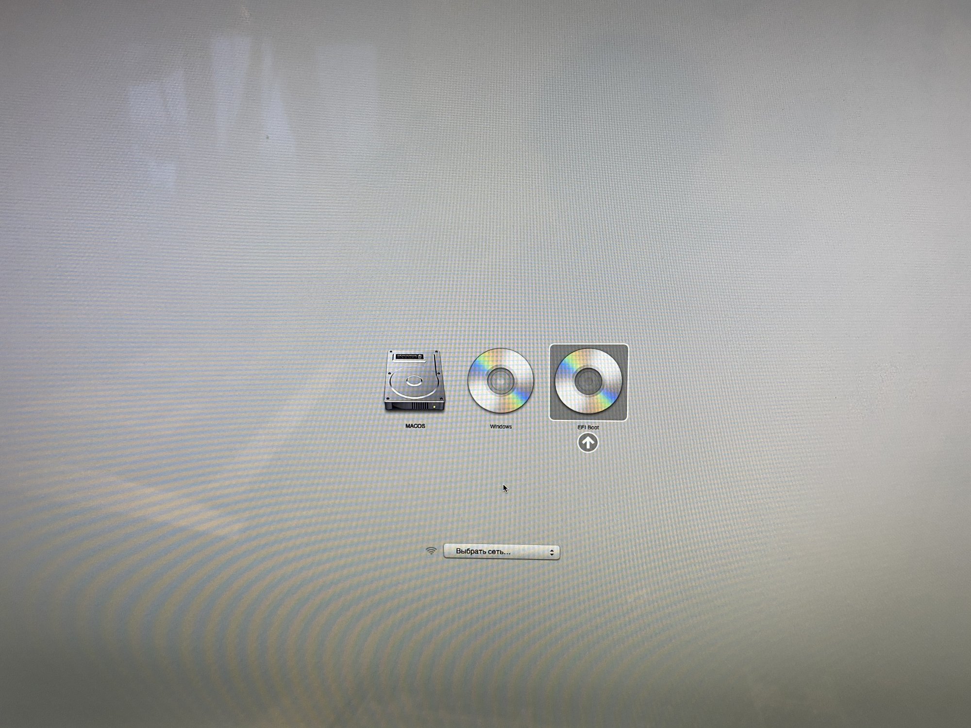

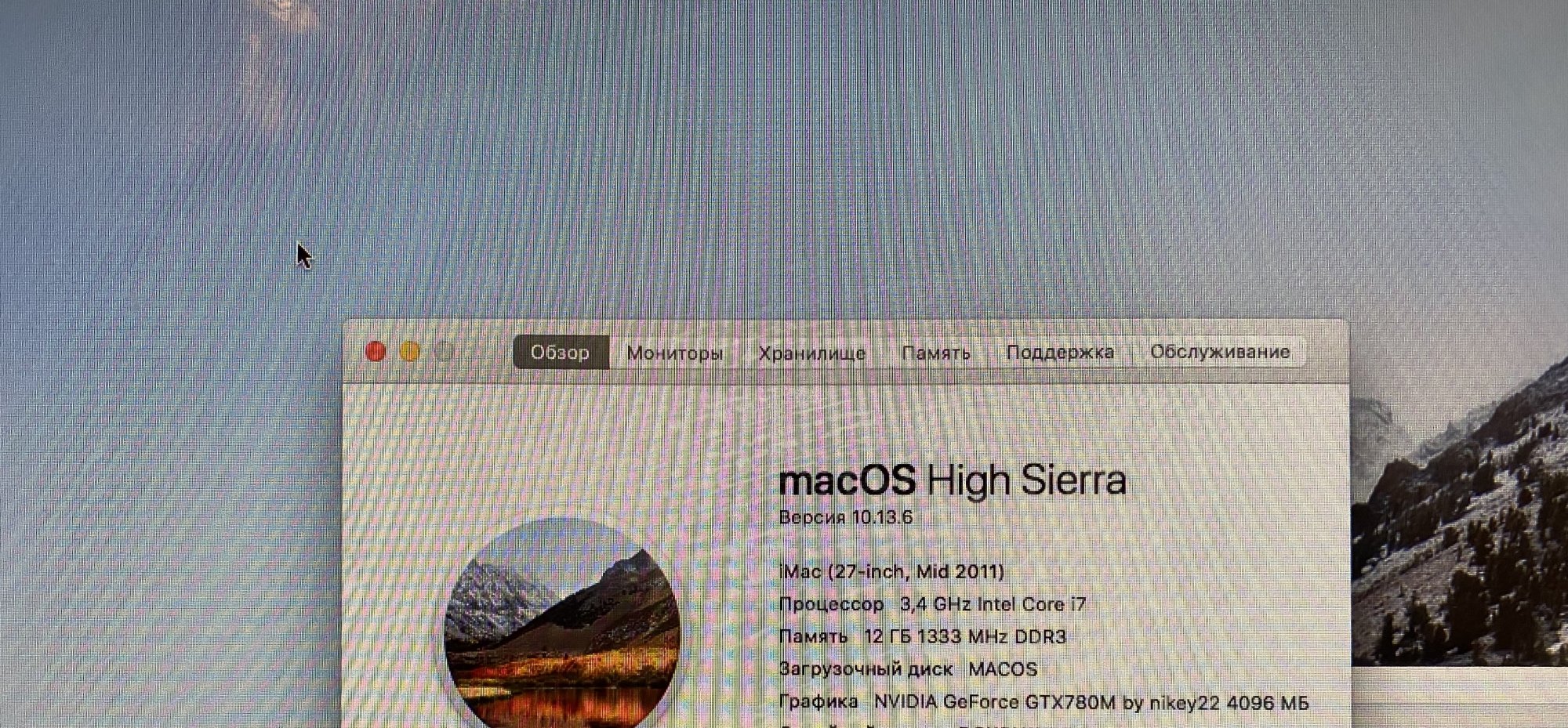

I have installed @nikey22 BIOS for my iMac 2011 27 with GeForce 780M, MacOS Catalina with @dosdude1 patch. And now it’s impossible installing Bootcamp Windows! I have white display and nothing happens! Please help, I don’t know what to do!!
First why are you using a DVD?
Second, is this Version 2004? Rufus hasn't been working well with version 2004. Even on Some ivy bridge Dell PC's it will hang. I'm trying the official windows Download Tool now.
Do you have the white display AFTER installing Windows or when you try to do this?
If you still can run your OSX, go there, install VirtualBox and validate your install DVD there.
If you cannot boot at all, use either OpenCore or rEFInd to get the boot partition selection.

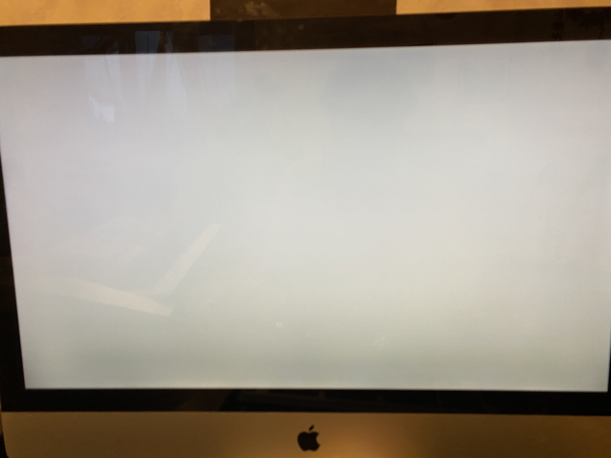

When I try - I cannot install and don’t see setup window , only white display
After upgrade I had been installed Windows on HDD and it also didn’t start.
It was said me that I must forget about bootcamp installation and try flash boot in uefi, made by rufus. Only Windows 10, not 7 with flash in uefi. Another one way is Virtual Box way, but I can’t imagine how to do it.
I download official windows 10 from Microsoft official. I don’t understand what 2004? It’s 2011, not early made. Windows 10 it for iMac 2011 same way to do windows setup, but with my modification I don’t think so that I can install win 7, Catalina said me only win 10, but I can’t start installation. I will try with rufus uefi iso, how it was said me.
Now my Mac in service center, after 1-2 days I will take it back and will trying. They also cannot fix it and thinkin bad bios, but I not think so.
2004 is the new version number. Windows 10 was in the 1900s for the longest time.

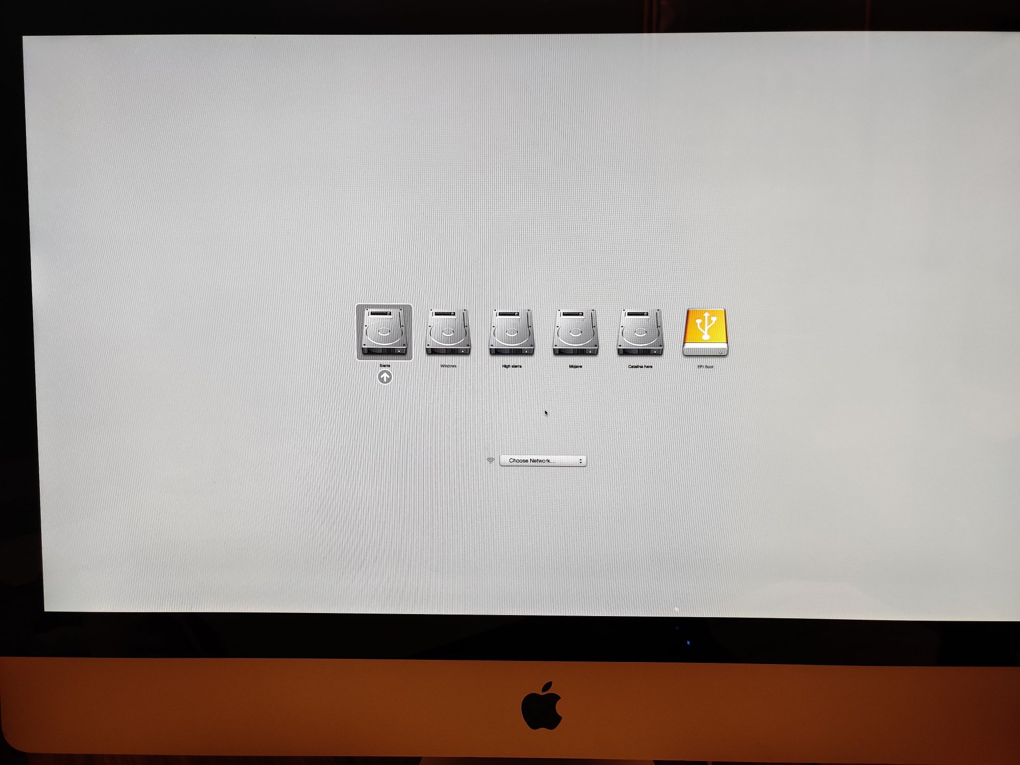

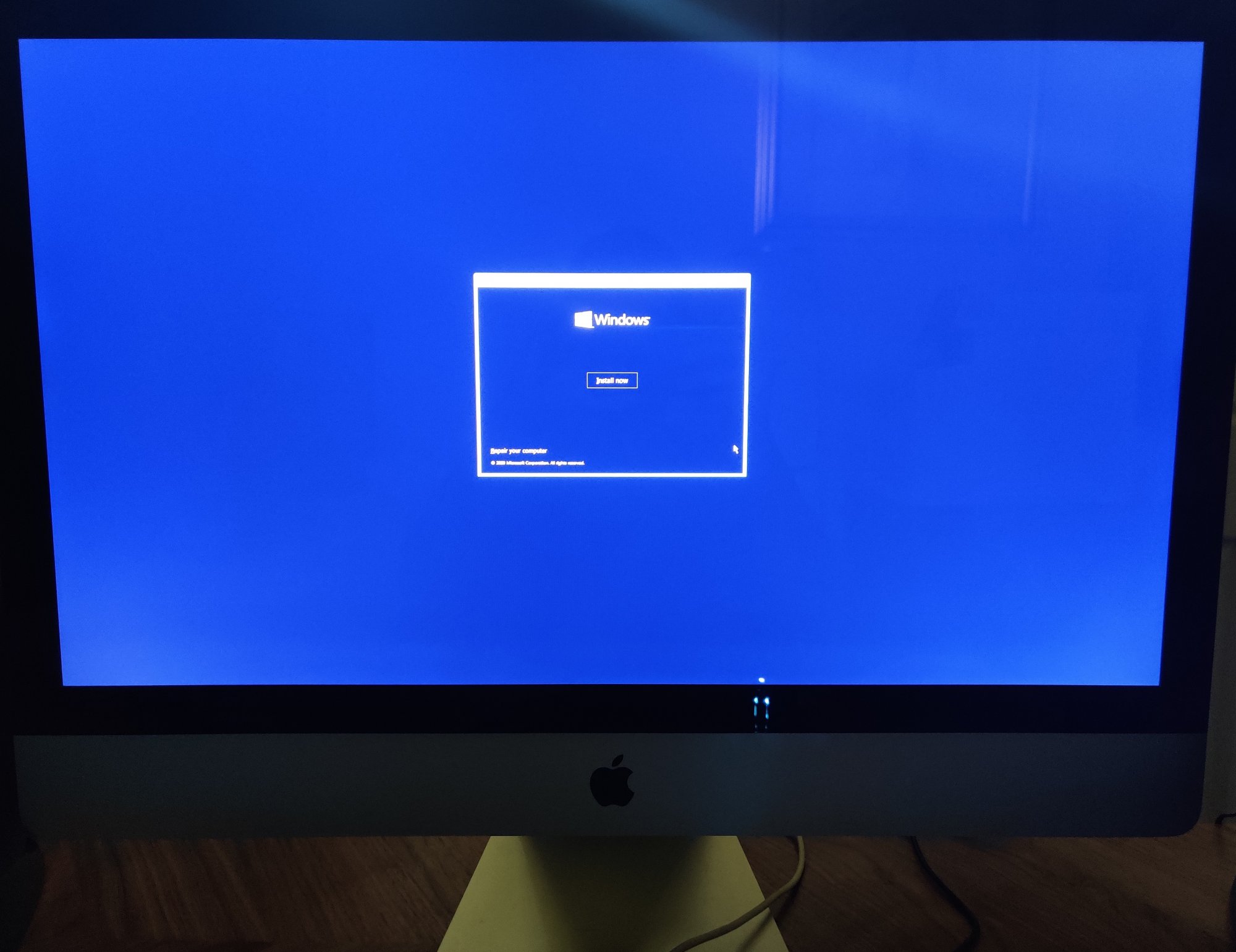

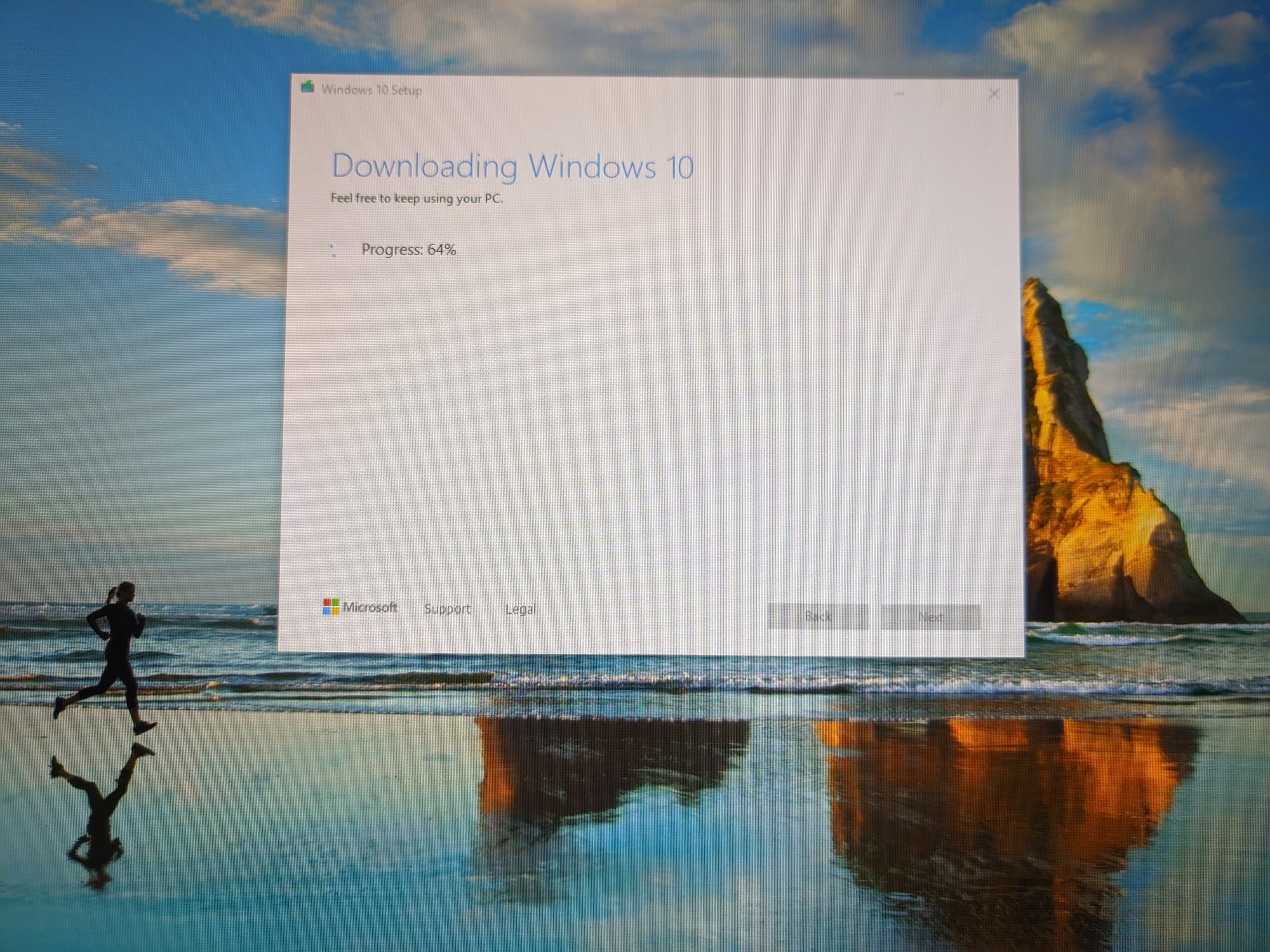

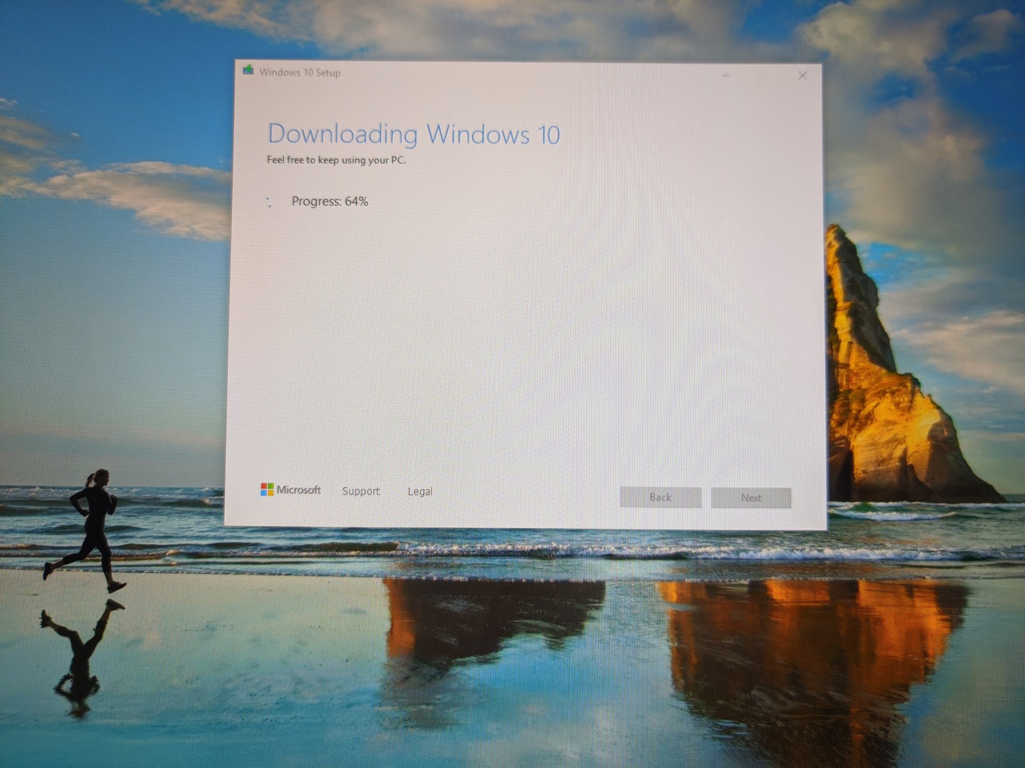

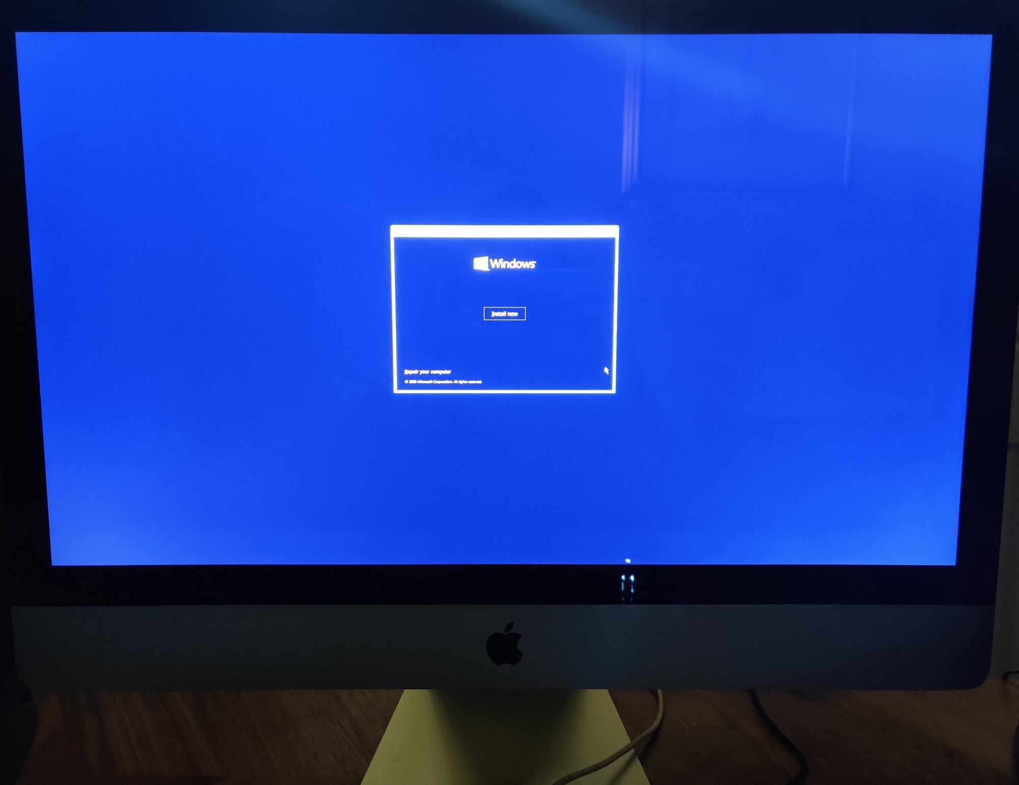

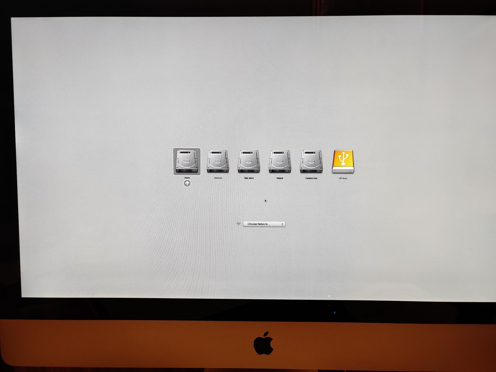

Use the Windows 10 Media creation tool to create a USB installer of Windows 10. Do not use Rufus, do not use a DVD. The installer loads just fine for me over USB

At some point they (service center/poster) will also need to Disable the HD3000 GPU in safe mode as well, hope either party is capable of doing this. You'll end up in an endless BSOD if you don't, these iMacs were never designed for EFI copies of windows 10... Also plan on using an external DAC in windows 10, unless you want to disable driver signing and follow a moderately difficult DSDT patching guide...
