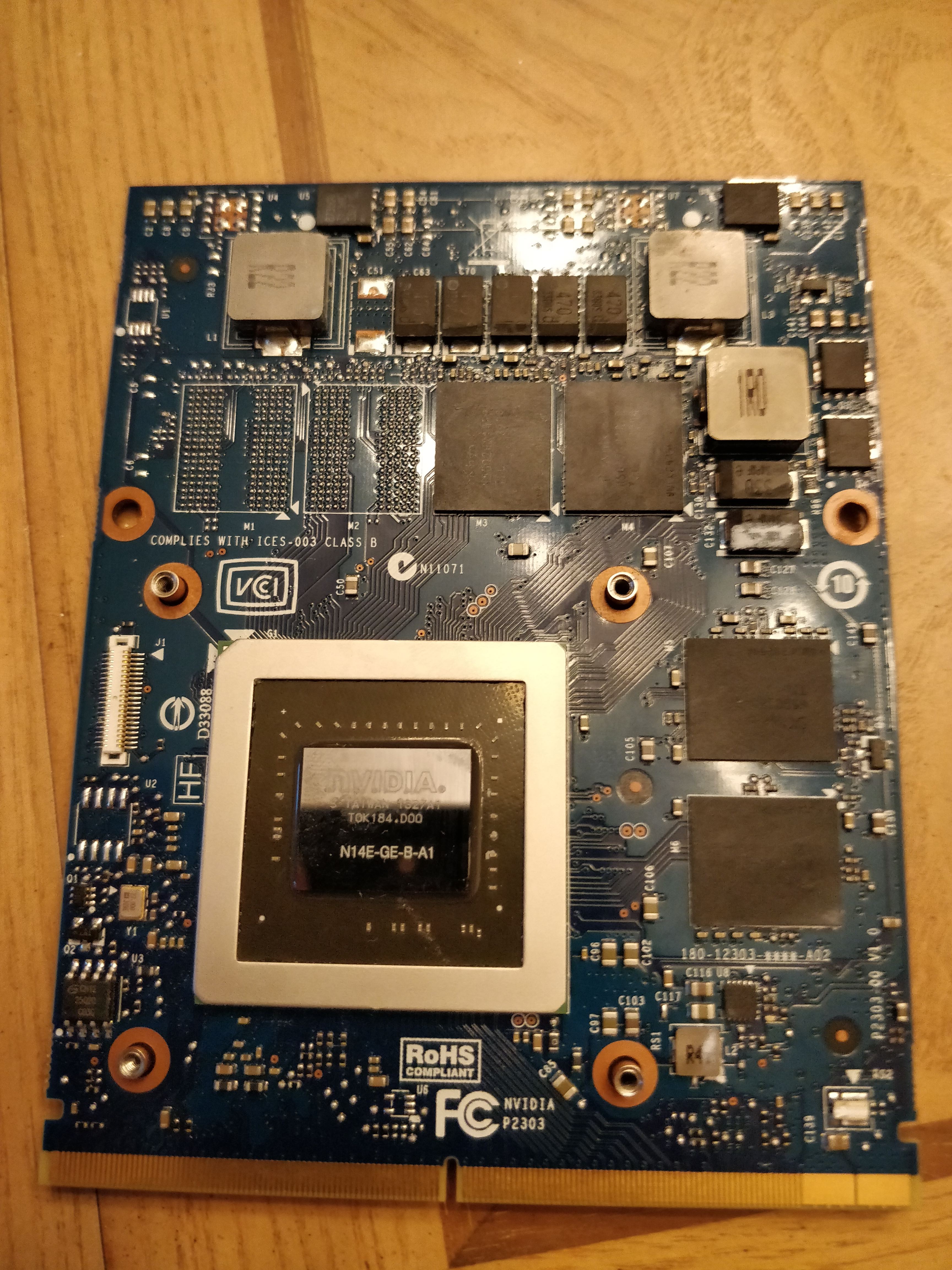

After all the reading on this Forum 😀 If i have my infomation correct. I could,
Buy a...
Alienware/Dell GTX 765m
I can install it, with modifications to the Heatsink. Requires No Bios flashing or Kext Hacking??? Correct.

I just ordered this one. https://rover.ebay.com/rover/0/0/0?mpre=https://www.ebay.com/ulk/itm/273143029829
We shall see how it goes! Only kind of worried about getting into recovery mode, but I guess it should work somehow, maybe even with external monitor worst case....
The lack of a boot screen is likely to cause problems with recovery and upgrades down the track. If you have a perfectly good working iMac then I would leave it as it is. Even if it has a graphics problem, I would wait to see what the MacVideoCard people come up with. In my case, I had an iMac with a broken display panel, so then bought very cheaply an iMac with a broken graphics card. After re-assembly I ended up with one perfectly working ordinary iMac, and a second iMac with no internal display and a 765m graphics card driving an external monitor.
If you can, before changing the graphics card, I would recommend disabling SIP and setting the nvram boot-args variable to -no_compat_check. That will make upgrading to Mojave a lot easier.

It had signs of paste on vRam and the coil labeled R42, the DIE had scratches on it, I doubt it was new. If you go a few pages back it only showed signs of life once. It said Unknown Nvidia card 256mb in system profiler. Took 2 weeks for the seller to refund me. I ended up buying a used 780m which is what i'm using now.
