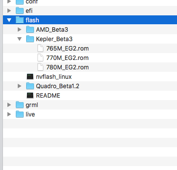

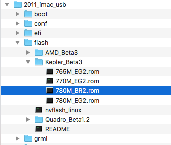

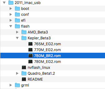

Tell me please, did I understand correctly that I need to add this file to this folder?
you can add this file in a folder called 780m inside the flash folder
you can also rename the the rom file to 780m.rom
then you will have flash > 780m > 780m.rom
when you will flash just modify the codelines
if you need some help just send me a private message 🙂
