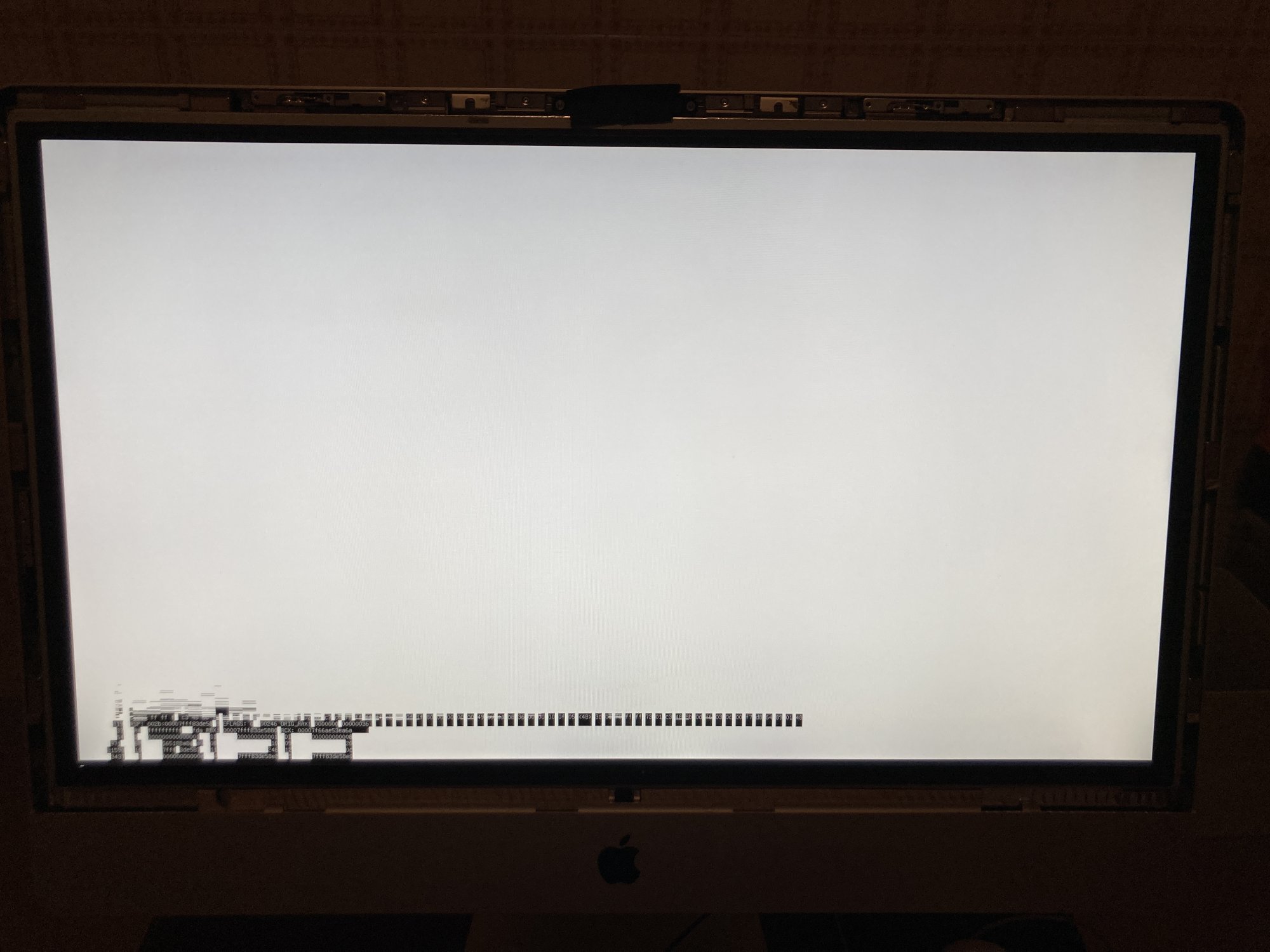

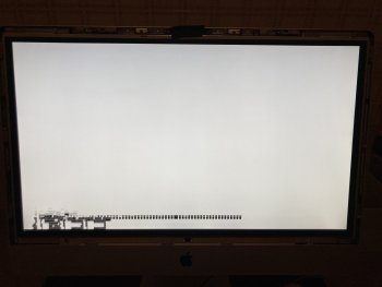

Update, issue on driver load.. tested on Debian, Windows 10, and OS X... everything works until driver I loaded, Linux gives something more than white screen
