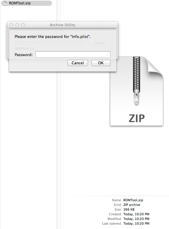

any reason why the ROMTool.zip file is asking for the "Info.plist" password?
copied from the link in post#1
