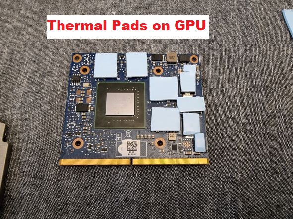

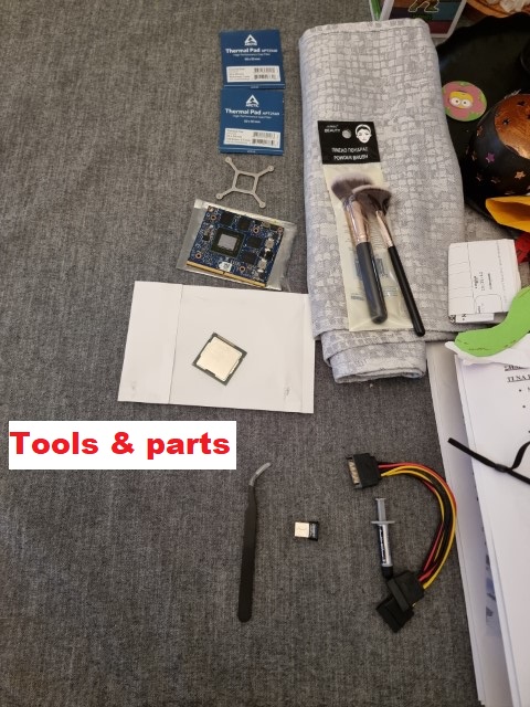

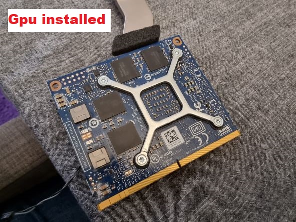

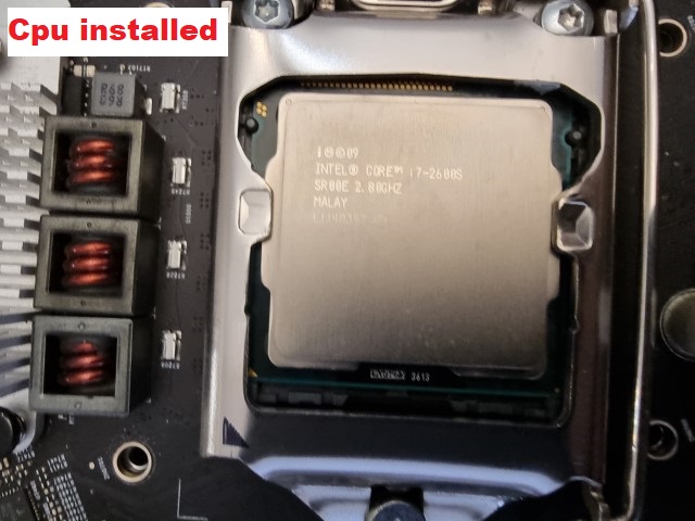

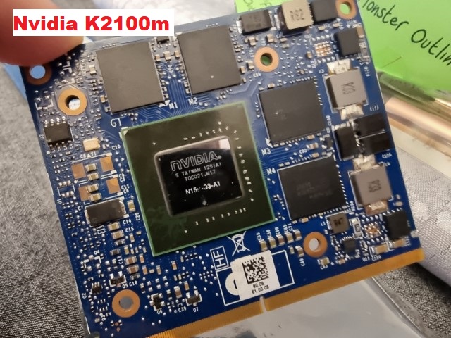

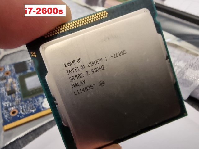

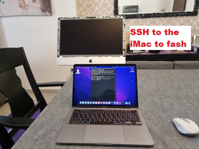

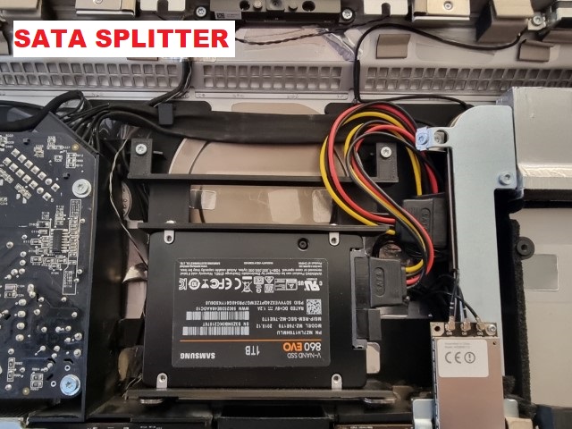

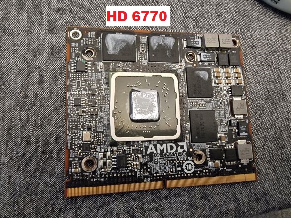

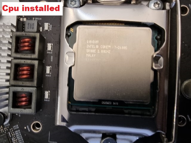

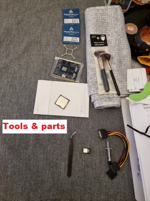

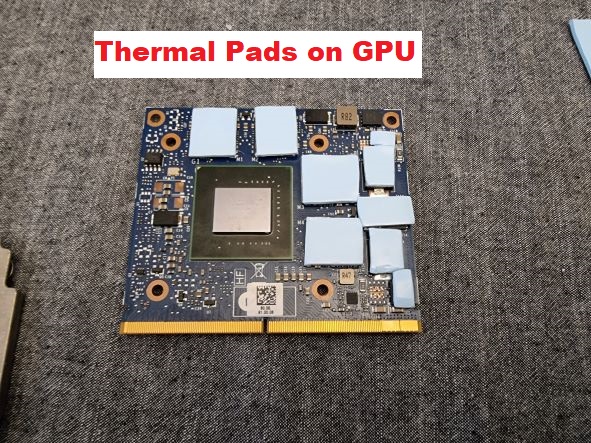

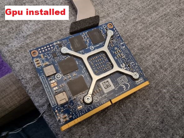

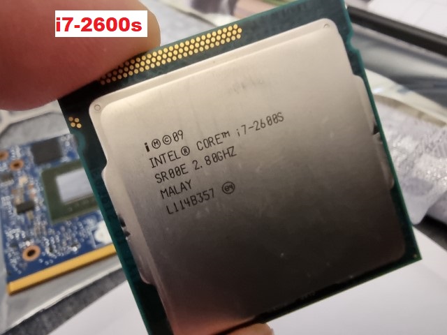

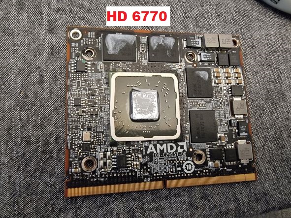

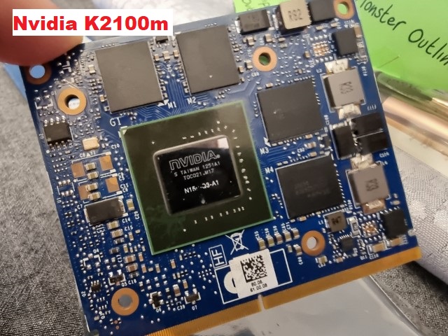

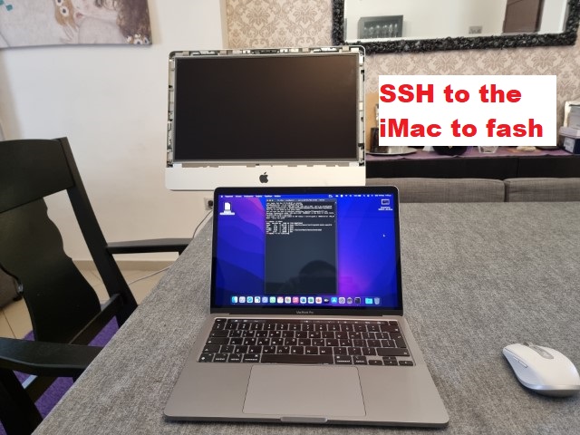

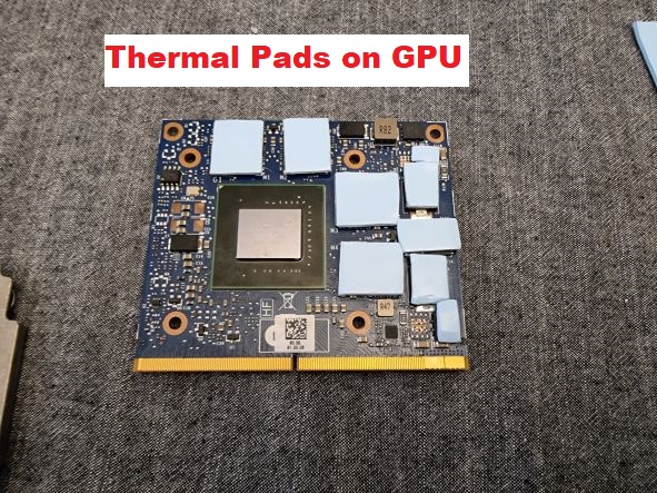

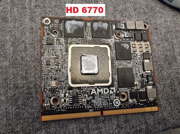

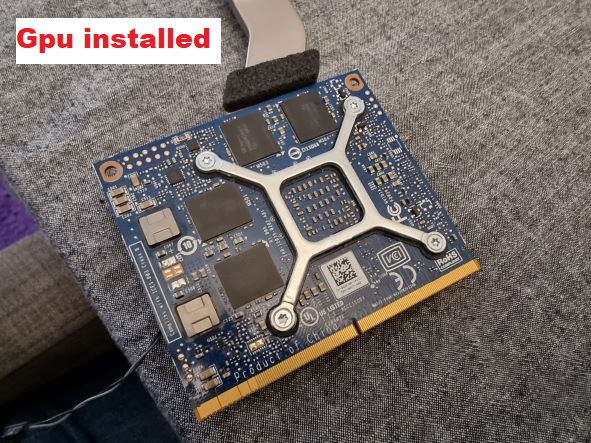

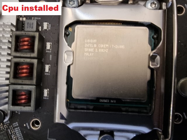

Further to my post here:
I attach some photos. I will also upload some benchmarks later today.

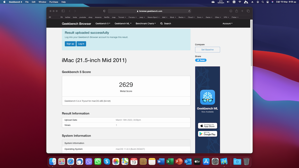

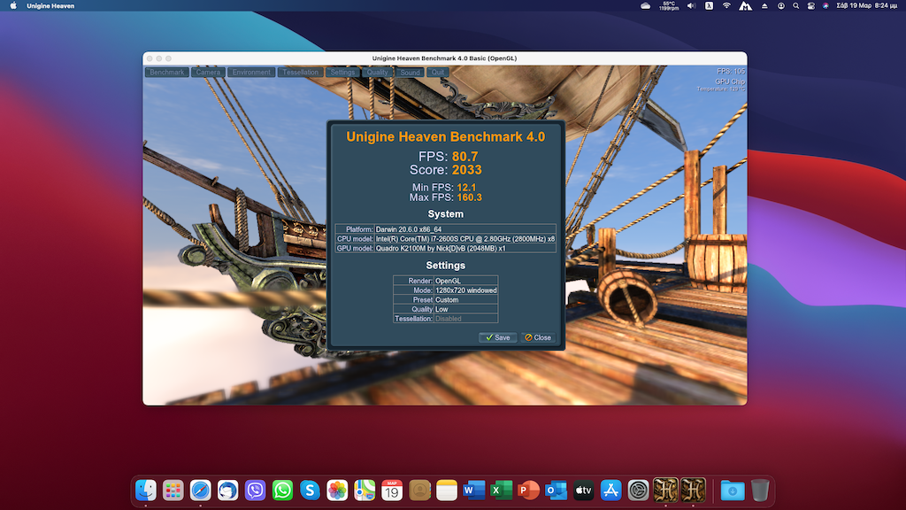

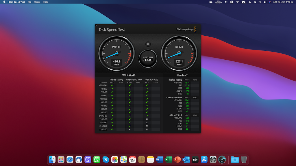

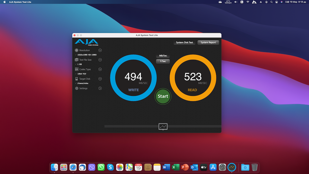

And some benchmarks from i7-2600s, Nvidia K2100m and Samsung 860 EVO 1TB in Big Sur.

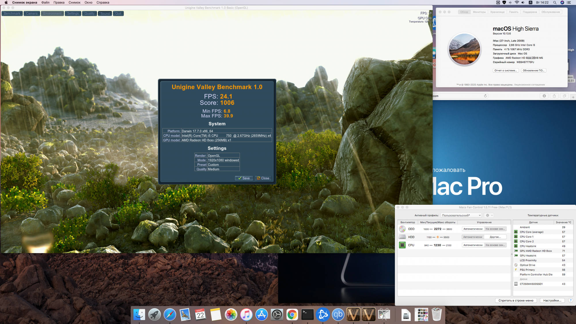

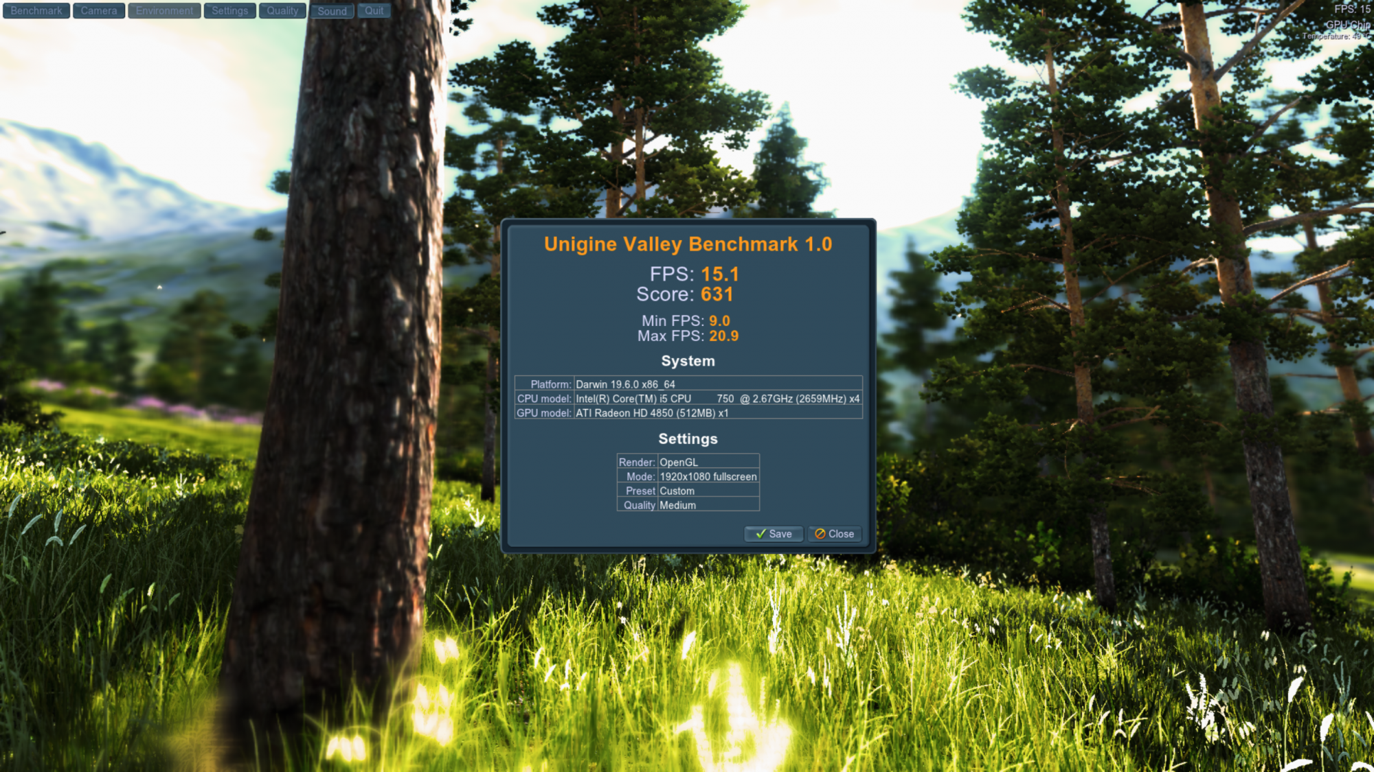

Hello everyone, I installed AMD M6100 on my iMac. To be honest, I expected a greater increase in graphics. Can anyone tell me why the video chip operates at a frequency of 600? because it should be 1000. We lose 40% of the chip power. How nice it was to see how the system thinks that I have an iMac Pro. Below are before and after photos.
PS
I tried to put Big Sur works fine, but the processor is always loaded by 20-40%

Is there a modded bios for this card? If yes, probably you need to flash it. I saw much better results after flashing the Nick[v]b bios in my K2100m.
As regards Big Sur, when you first update from High Sierra, the system needs to build the new spotlight catalog, and maybe this is why you experienced high cpu usage. But after a while it reverts to normal usage.
Before installing the card, I flashed the BIOS, which I took from the first page of the topic.
Big Sur may need to give the system time to work, maybe in the future I will upgrade to this version.
I noticed such a feature when the screen turns off, but does not go to sleep, the drive fans go to maximum speed.
Check you cables and sensors, this sounds like your system is throttled down because of a missing temp sensor?
I have all the sensors connected except HDD because SSD is installed. And so I turned off the HDD cooling fan (it hums terribly even at low speeds) and needs to be replaced.

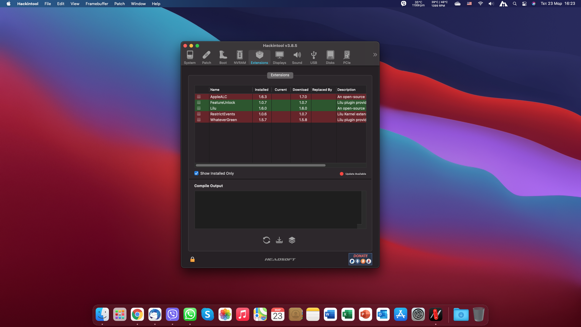

I used hackintool and I see that OCLP is using opencore 0.78 (instead of the latest one 0.79), and I also have a few kexts that could be updated to their latest version (see the attached pic).
Should I update the opencore and the kexts to the latest ones, or do I risk making the system unusable? 😅
OCLP is a package, do not rip it apart unless you want to enter the land of unsupported unsupported Macs.

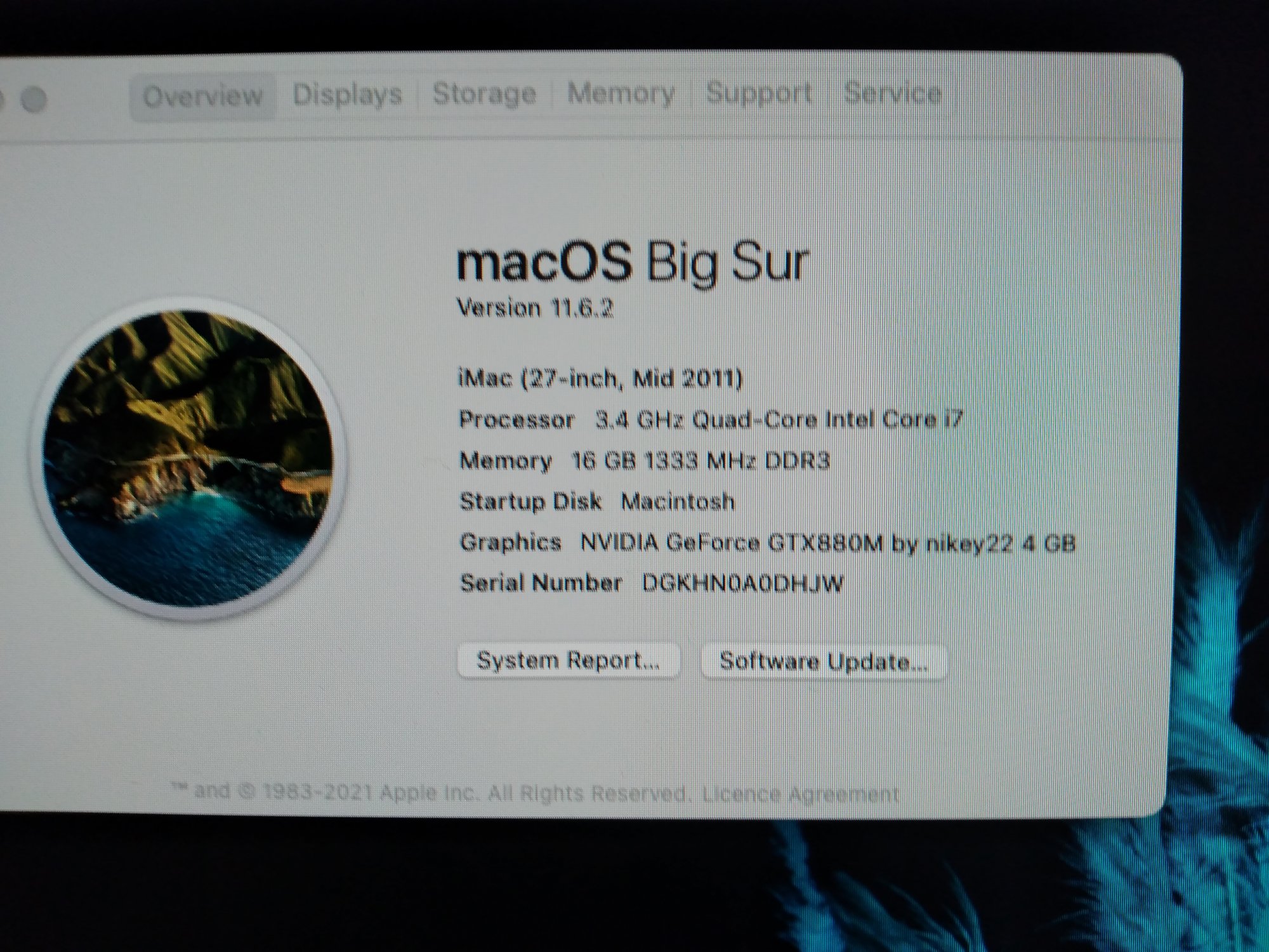

Hi, I bought gtx 880m 8gb flash it with the rom.here on the website but is recognize only 4gb, it's a video card problem or the rom here ?
Other problem with K3100M with Windows 10 after install nvidia drivers, and then reboot machine, windows stuck on 30-60 sec. before show "login screen" or desktop. few time initialize display before show desktop.
in mac os this problem not detected.
and no one didnt help with this problem.
no one care with bad bios for k3100m once again.
