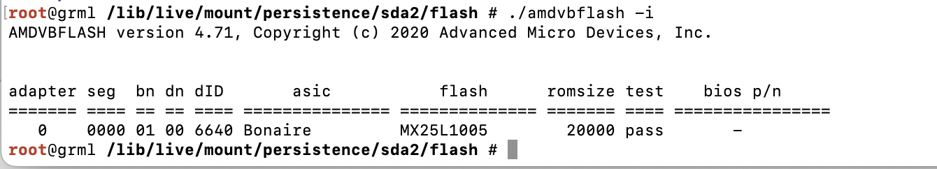

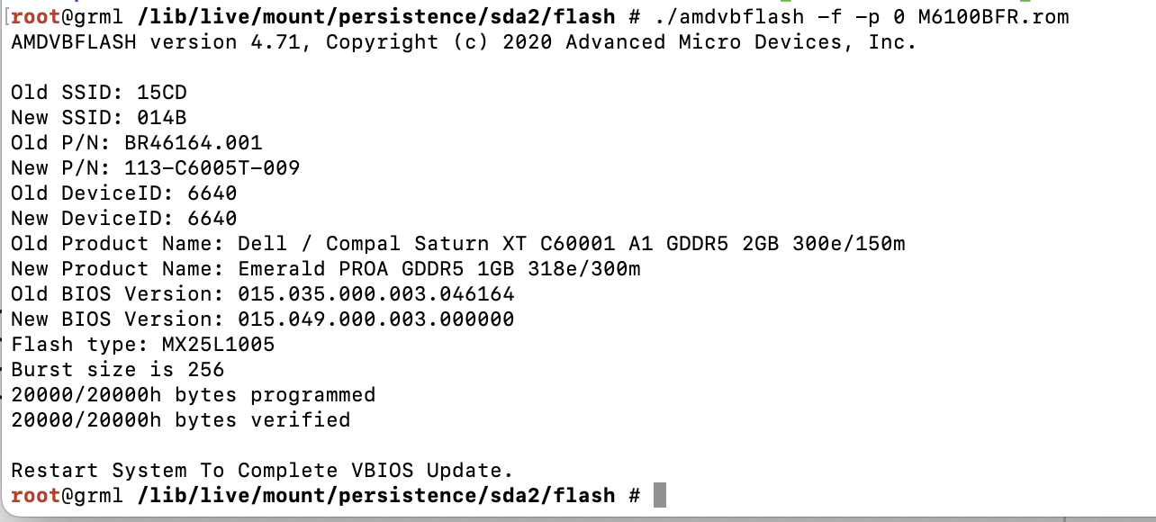

I'm trying to flash another M6100 and so far it's not working. I did it successfully with a previous M6100, it was working just fine and all of a sudden it stopped working properly.

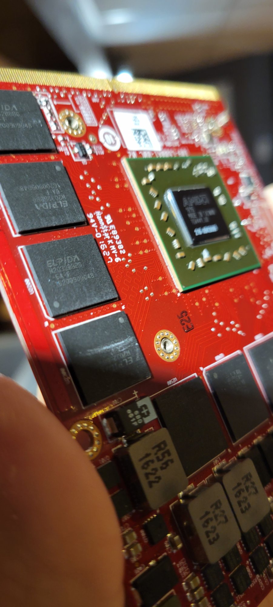

Anyway this new card i flashed with ROM2 because the card has Elpida memory (is that the rom i should have used?). It flashed ok but is it normal that it shows that the new name is "Emerald PROA GDDR5 1GB 318e/300m" ?
Before flashing:

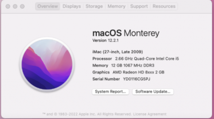

This is on an iMac 2009 by the way. This picture here was taken with the previous card when it was working.

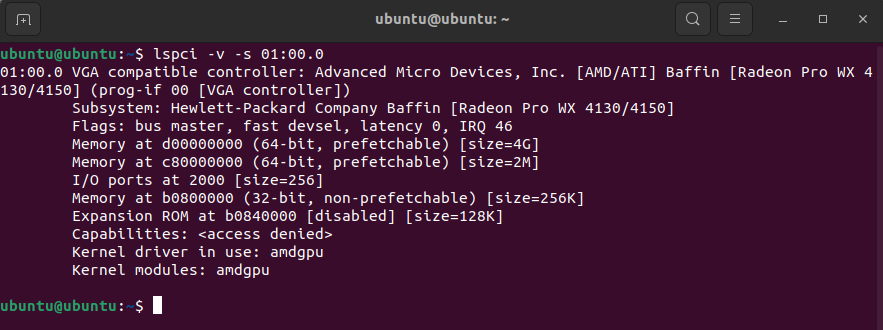

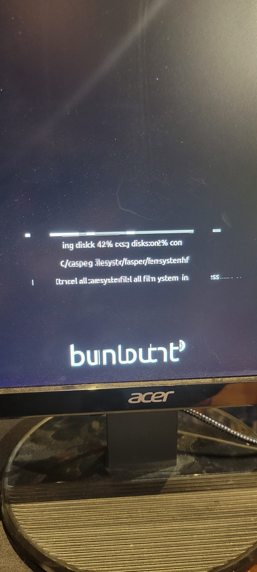

On external display when booting latest ubuntu, the display is messed-up:

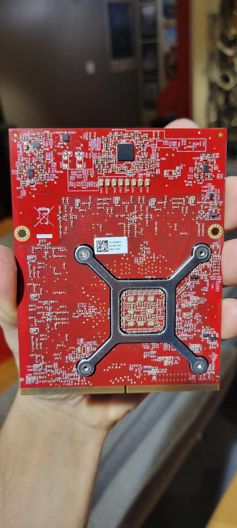

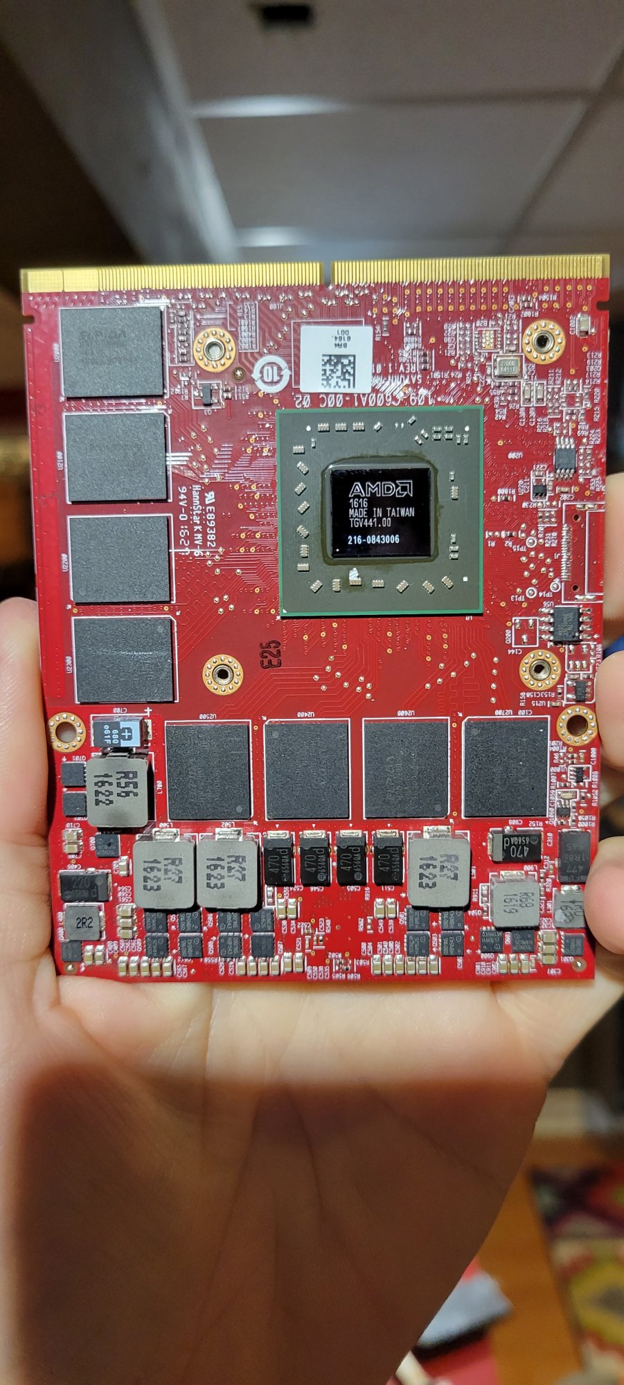

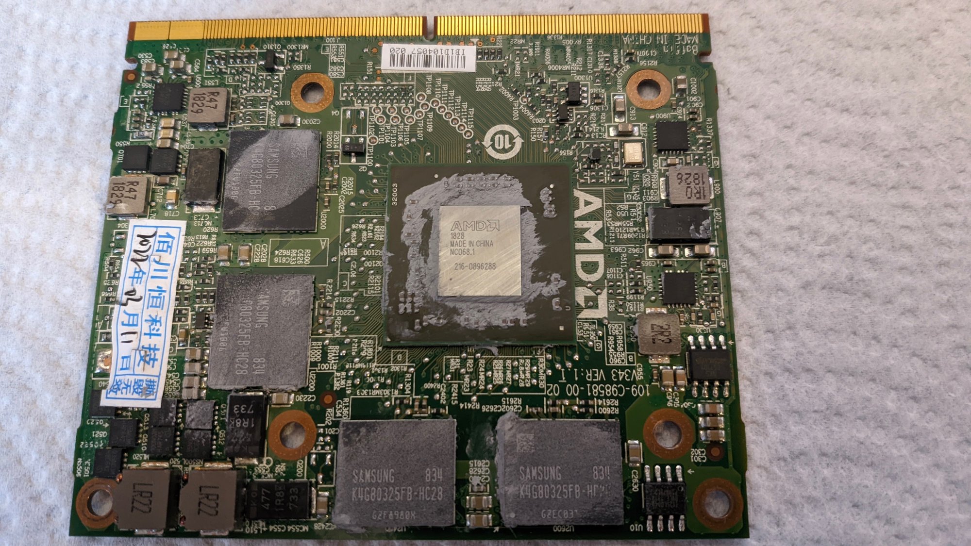

Here are some pics of my card:
Original vbios attached if that can be of any use.

Ah! Interesting. I had issues on my WX4170 when using the 4170 Bios. Flashing it to 4150 made it run stable and my thinking was that it runs with all the computing units even on the 4150 Bios. But yes. Clock speed may be an issue with the bios. Is there an easy way to modify it and try through the common values in the referenced post?
The difference between the 4150 and 4170 VBIOSes is just the clock speed. And Geekbench Metal scores are not reproducible because Geekbench doesn't allow any warmup time for the GPU to boost before measuring the speed.
Editing the VBIOSes while maintaining working boosting/throttling is not easy, so just stay with the VBIOS variant that gives you a stable system.

Your M6100 card is an Elpida-based 0x6640 with a newer base rom that I didn't have in my collection. Please try this one and let us know how it turns out. Make sure to use OCLP. I will update my main M6100 page with any successes, pending your results.
It works!
Ausdauersportler sent me a rom, maybe it is the same? But i re-flashed the card and my internal display turned on just fine! I did some stress tests like running Heaven Benchmark looking at the temps, everything is working fine so far. Sleep works, brightness control works, external display does not but i don't really care. GPU is reported as an AMD Radeon HD 8xxx 2GB.
I have another M6100 with SK hynix memory chips that i flashed with ROM2 at first then ROM1 after it started to fail. The screen just shut itself off while watching YouTube, sound was still playing. I rebooted the screen came back up but after logging in it shut itself off again and then it shut itself at OC bootpicker... I don't know what's wrong with it, it was working fine. I have the original rom if you want to look at it if you have the time, there's absolutely no hurry!

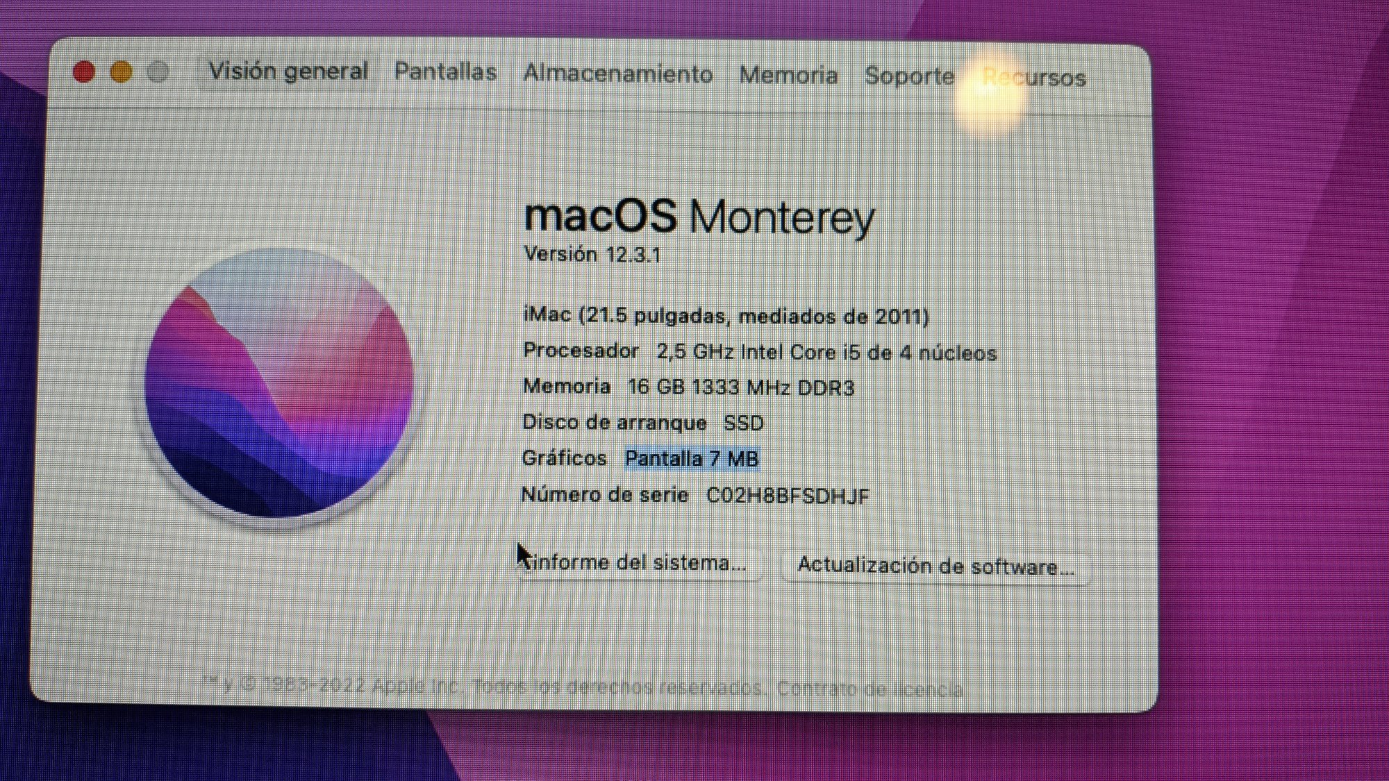

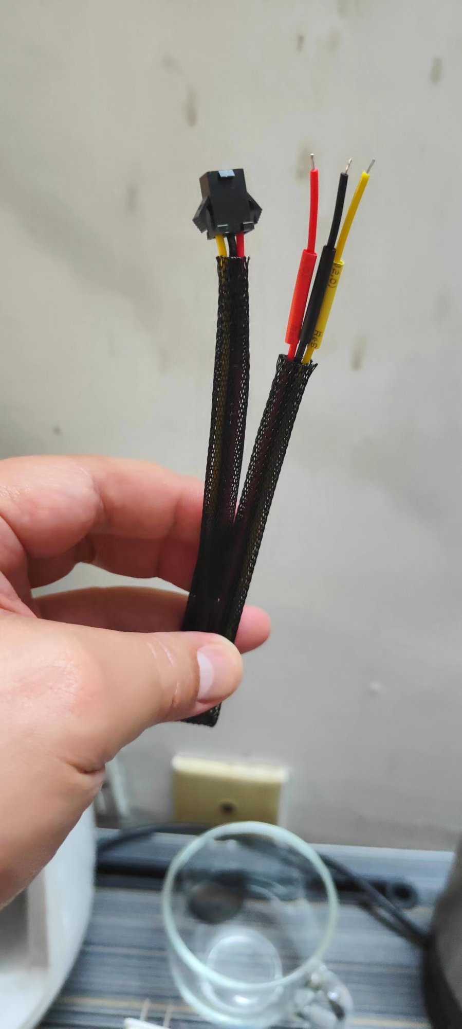

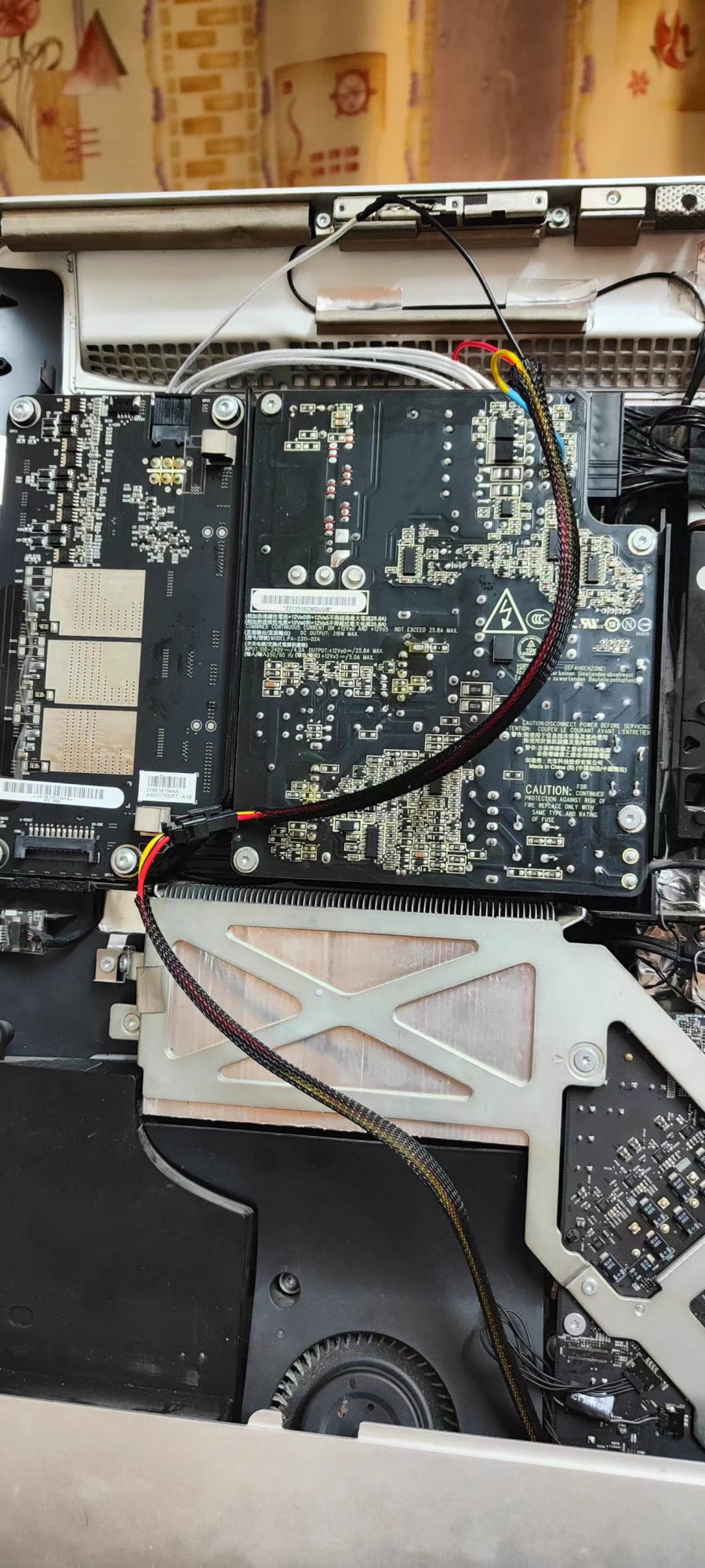

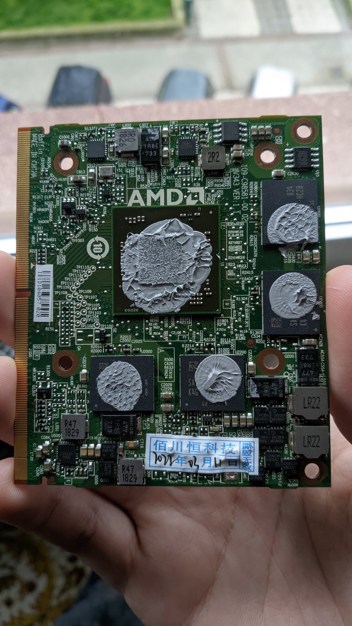

Hello, I hope you can help me.
I have installed an AMD WX4150 in an iMac mid 2011 21.5. Everything seems to work as it should at startup (it only works from an external screen) but when I go into MacOS Monterrey in the graphics information it tells me that I have 18MB and I don't see the model. The performance is very bad. Is this normal or does it mean that I haven't installed it correctly?
I attach a picture of the graphics card.
Check this post about the complete process and walk trough it - read the docs if you need more information.
P.S.:
The grey GPU paste does not work on the VRAM chips. Even this is covered in the docs. This photo is quite useless, the interesting information is masked by the paste.

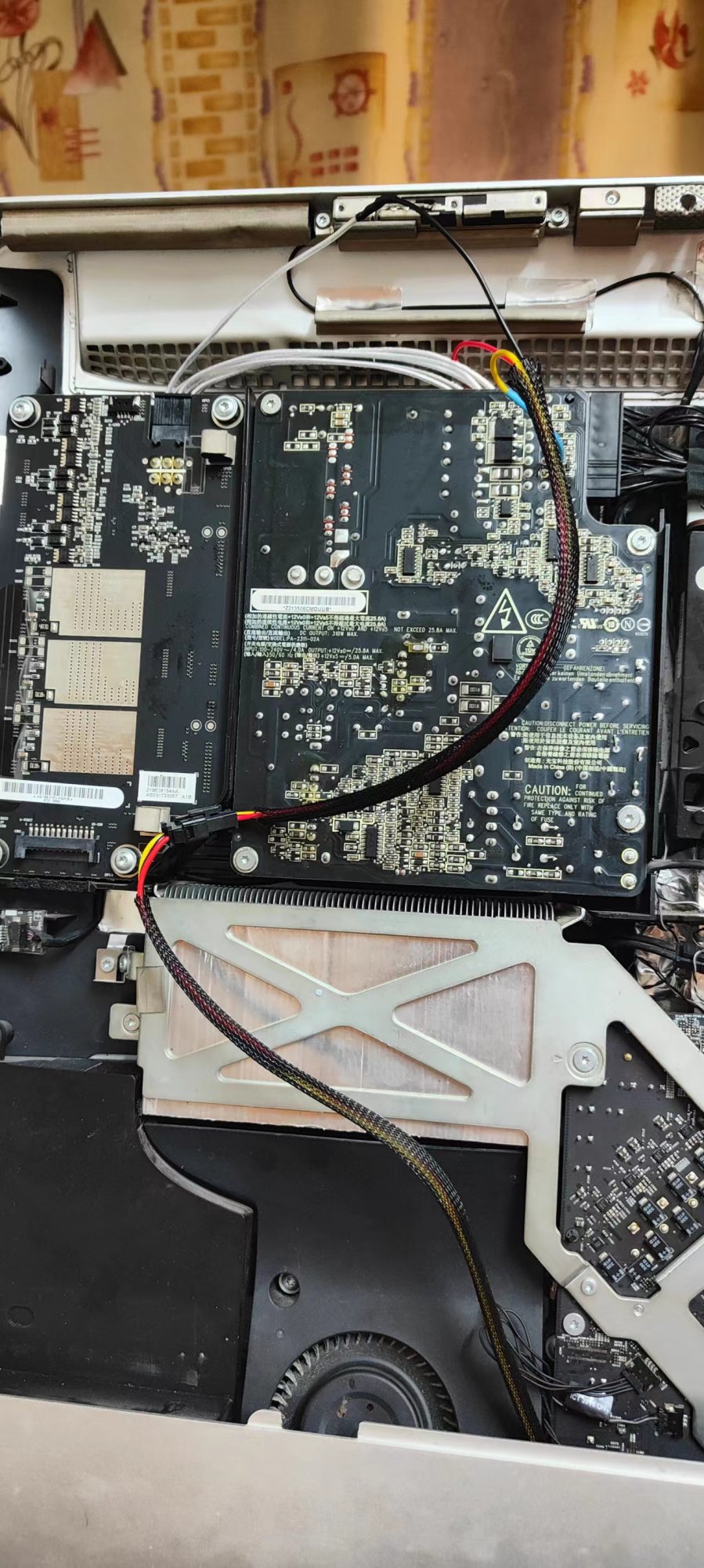

目标:为了让 iMac 的内部显示屏上显示启动屏幕,需要手动强制打开内部显示屏的背光,因为显卡上的固件不会自动执行此操作。iMac 使用脉冲调制的 3.3V 信号到显示器背光电源板来确定屏幕亮度 - 因此,如果该线路没有通电,亮度将为 0 - 即关闭。如果它获得稳定的 3.3 伏电压,它将是 100% - 全亮度。在启动时,这条线可能是零伏,所以屏幕保持关闭。解决方法是在启动时手动输入 3.3 伏电压以强制显示。但是,如果您将 3.3v 电源永久连接到其中,您的屏幕将始终保持 100% 亮度,无法调整它。所以需要做的是让它在启动时获得 3.3V 全输入,并更改它以在计算机启动后从 iMac 的主板获得标准的、调制的、可调节的信号。所以我加了一个拨动开关,你可以在开机的时候把它拨到3.3V稳定线,然后再拨到标准连接。
步骤 4.0.1 删除你的 iMac 显示器当然

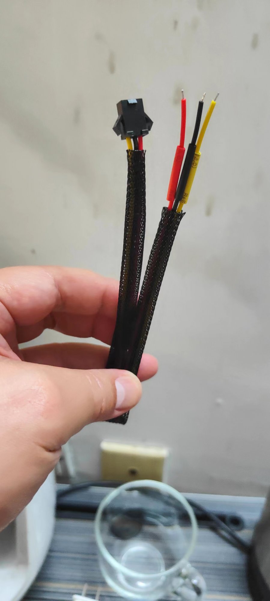

步骤 4.1 在您的 PCI-Express 电源延长电缆中,从延长插头端的左下方引脚(如果从连接器的电线侧看)切断电线。将电缆剪离插头约 6 英寸。请参阅所附图片 - 确保剪断正确的电线。剥去两个切割端,并在每个切割端焊接一根 1.5 英尺左右长的电线。使焊点绝缘。这就是前面的电话线有用的地方,因为它有 3 根电线捆绑在一起(它有 4 根,但你可以拔出一根留下 3 根)
步骤 4.2 找到一个双掷、开关或开关。开,因为在两个位置,开关都需要连接一些东西。在一个位置,它连接到我从 iMac 的 PSU 分接的 3.3V 电源,而在另一个位置,它连接回它最初连接的电线。如果您使用具有 3 个位置的开关(中间位置,电线不连接任何东西),您可以设置一个开关位置,在此位置可以在计算机运行时完全关闭内部显示器 -这对我来说非常棒,因为我可以让计算机处理某些东西,而不会浪费显示器的电量来完成不需要我一直盯着屏幕的任务。我真的希望 Apple 一开始就这样做......显然,这是我使用的开关类型。
步骤 4.3 焊接:1)从 PCIe 电源延长线插头端(即背光电源板端)到双掷开关中间引脚的(延长)切割线,2)另一条(延长)切割线,从PCIe电源扩展的插座端,即电缆的主板端,到开关的一侧(再次,详见图片)。
步骤 4.4:焊接另一根电线,将 iMac 电源的 3.3 伏电源引脚(参见附图)连接到拨动开关的另一侧引脚。
步骤 4.5 拆下 iMac 的 LCD 背光电源板,拔下插入其中的 6 针电缆,并插入刚刚修改的延长电缆。然后将用于插入背光电源板的电缆插入修改后的延长电缆的插座端。塞好电缆,这样它们就不会挡住屏幕。
第 4.6 步(可选)您可以在 iMac 外壳的某处钻一个孔来安装开关。如果您使用带有圆柱的开关,这是最简单的 - 所以只需钻一个圆孔并通过它安装它。我在底部扬声器格栅上打了一个洞,就在 RAM 卡托架的左侧,那里有一个从内部清晰的地方。看起来真的很整洁IMO🙂
步骤 4.7 整齐地布置电缆并重新组装您的 iMac
现在您可以在启动机器时将开关移到一侧以获得启动屏幕,然后在启动后将其切换到另一侧以进行正常的亮度控制!
注意:如果您仍然保持连接外接显示器,iMac 仍仅在该显示器上显示启动屏幕,并且即使您将开关设置为启用它也会忽略内部显示。您必须断开外部显示器才能使内部启动屏幕正常工作。

Thanks for the help! So Mac OS won't recognise the GPU model and the memory until it has been flashed?
I attach a picture of the clean card where you can see more information.
Whether or not macOS can recognize the GPU depends on the contents of the VBIOS EEPROM on the card - so it seems the VBIOS on your card has a PCI device ID that is not recognized by the macOS drivers; that's somewhat strange. Might be helpful if you could save the original VBIOS and upload it here.
The Samsung VRAM on your card should be supported by all of the VBIOS variants available here.
Thank you for your help. This afternoon I will install the graphics card again and try to flash it to see if it recognises it correctly.
I will also try to take a backup and upload it.
I bought the card here, I don't know if that can give you more info on why it doesn't recognise it.

Hi all, I've got imac 27 mid 11 with faulty gpu, guys at local service center replaced it with "something more powerful" shown as Apple Quadro k3101MX in MacOS/Nvidia k3100m in windows. They installed opencore on this machine aswell. The problem is - It works great on MacOS, but I have some problems using it with windows(both uefi/legacy). The main problem that hurts me - is using external display on windows( Apple Cinema 27 Thunderbolt). While it runs great on macos even with hot plug, it doesn't work at all on windows. 90% of boots both internal and external displays wount even boot up( While system loads, i hear system sound etc). 2 times both displays loaded and the thing is external display runs great while interal have some shaking, wrong colours, you cant watch it without getting epilepsy, but in most cases displays just woun't load at all. Can I have some advice how to fix it/is it real at all? Btw sorry for my english, didnt use it for a while
Well, I have news about my WX4150, but it's not good news. Yesterday I installed it again and booting with Linux from the USB I was able to flash it. At first everything seemed fine, and now the iMac powers up without the need of an external screen.
However it still doesn't recognise the graphics card, just showing "7MB Screeen" as GPU. The performance is very bad and there are no graphical effects. It doesn't recognise the external screen either (it does in Linux but with low resolution). I have tried flashing both the WX4150_GOP.rom and WX4150_ALT_VRAM.rom ROM, but I get the same result.
And because I'm stupid, although I made a backup of the original ROM I left it saved in the Linux Live download folder so... I lost it. Anyway, any idea what I can do, should I try flashing with the "old" ROM from the first post? Or I give the card for dead. In linux it also shows up as Unknown Graphics, although in the command line it does show up as AMD Polaris.
Not really! You may try and clean the MXM slot and the contacts of the card using cleaning alcohol and a tooth brush (same works for the GPU before applying new thermal paste, too).
The published vBIOS versions should run fine on this type of card.
You can - of course - try every WX4150 version you find here or on techpowerup.com and other sources unless you find one showing the 4GB memory of your card correctly.
Have you upgraded the iMacs firmware to the most recent version (87.0.0.0.0 or something similar)?
Only the folder named Backups on the GRML is persistent, so put all pulled files there.

Could it be caused by the thermal paste? I used the same grey one as in the previous pictures, while the new one I ordered was arriving.
I have the latest macOS Monterrey updates, do I need anything else to update the firmware?
No, highly unlikely. Only dirt on the slot itself is known to cause problems.
Yes, you need to install High Sierra from the scratch on an internal disk and apply all updates. I am pretty sure this is part of the published plan and docs. After that - after the successful upgrade - test your card until it works on High Sierra and only after fixing all problems move ahead to an unsupported macOS version (High Sierra has this ugly bug needing an external display connected to switch on the internal LCD with AMD cards - mentioned in the docs, too).

Another possible question... Are these problems related only to MacOS? I mean, if I try an Ubuntu installation for example, the graphics should work?
EDIT: Linux does seem to recognise the graphics card and the 4GB of memory correctly
