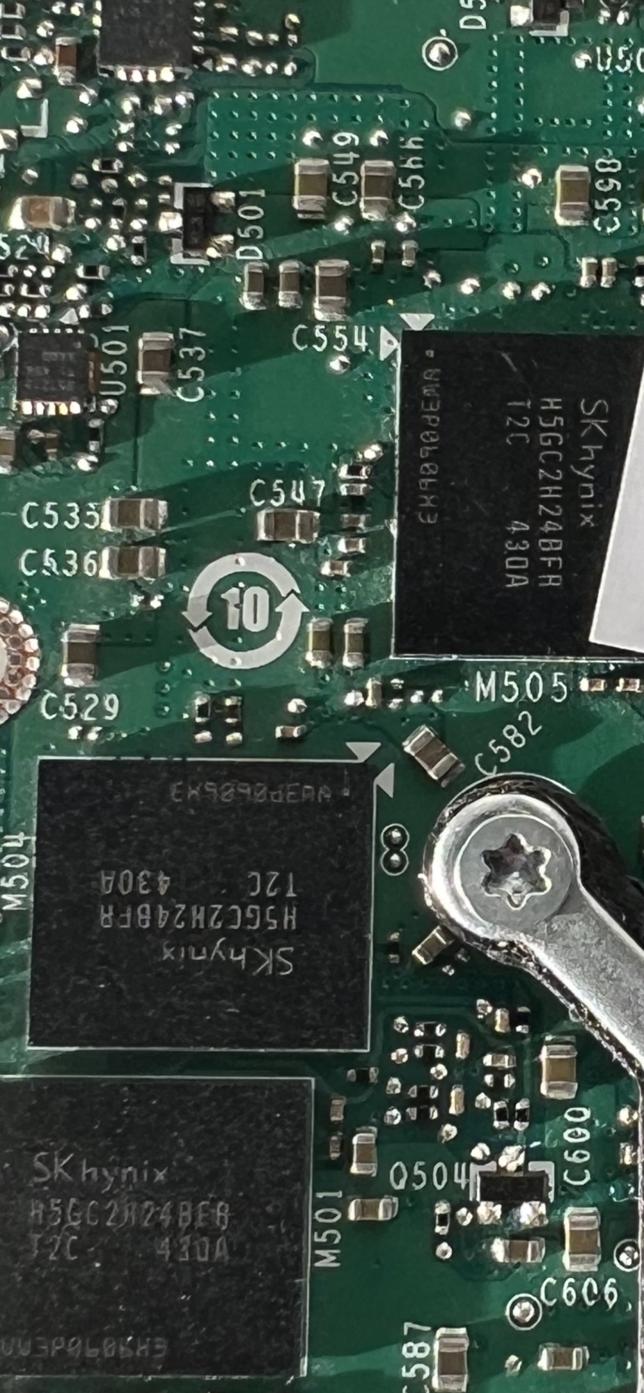

With the screen off, the Imac stays in a loop with the sound on and no key combination works.
I can't install patches or anything because the screen is off and I can't connect an external monitor either....
I'm a little desperate and I don't know what to do... I would appreciate any advice ¡

Post 1 and some linked posts are full of such advices! And yes, it is long and it takes time to read and study.
In all likelihood you won’t have display output until you flash a proper VBIOS (that’s in post 1). If you have consecutive cut-off chimes, there is likely a hardware problem.
Again, read post 1 on how to flash the VBIOS via remote access. (It is very likely that you’ll have to disconnect all internal drives. If those consecutive chimes persist after that, you have a hardware problem.)

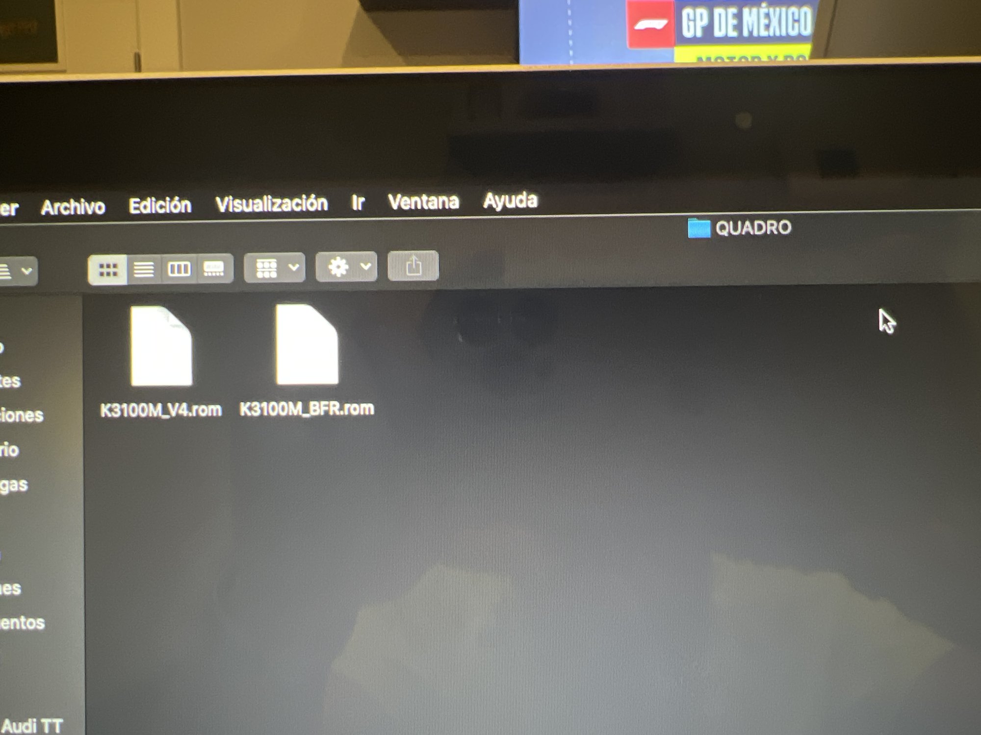

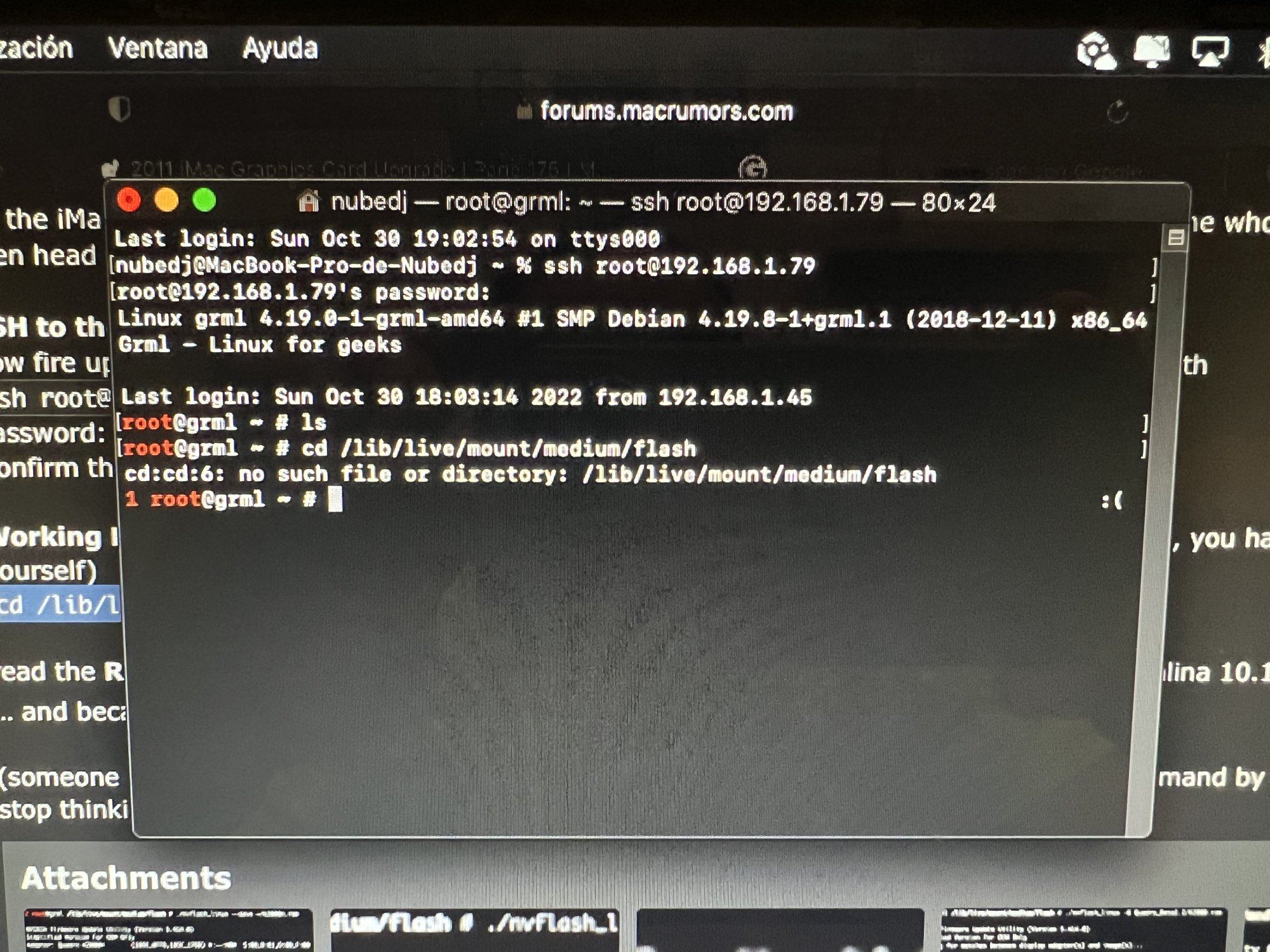

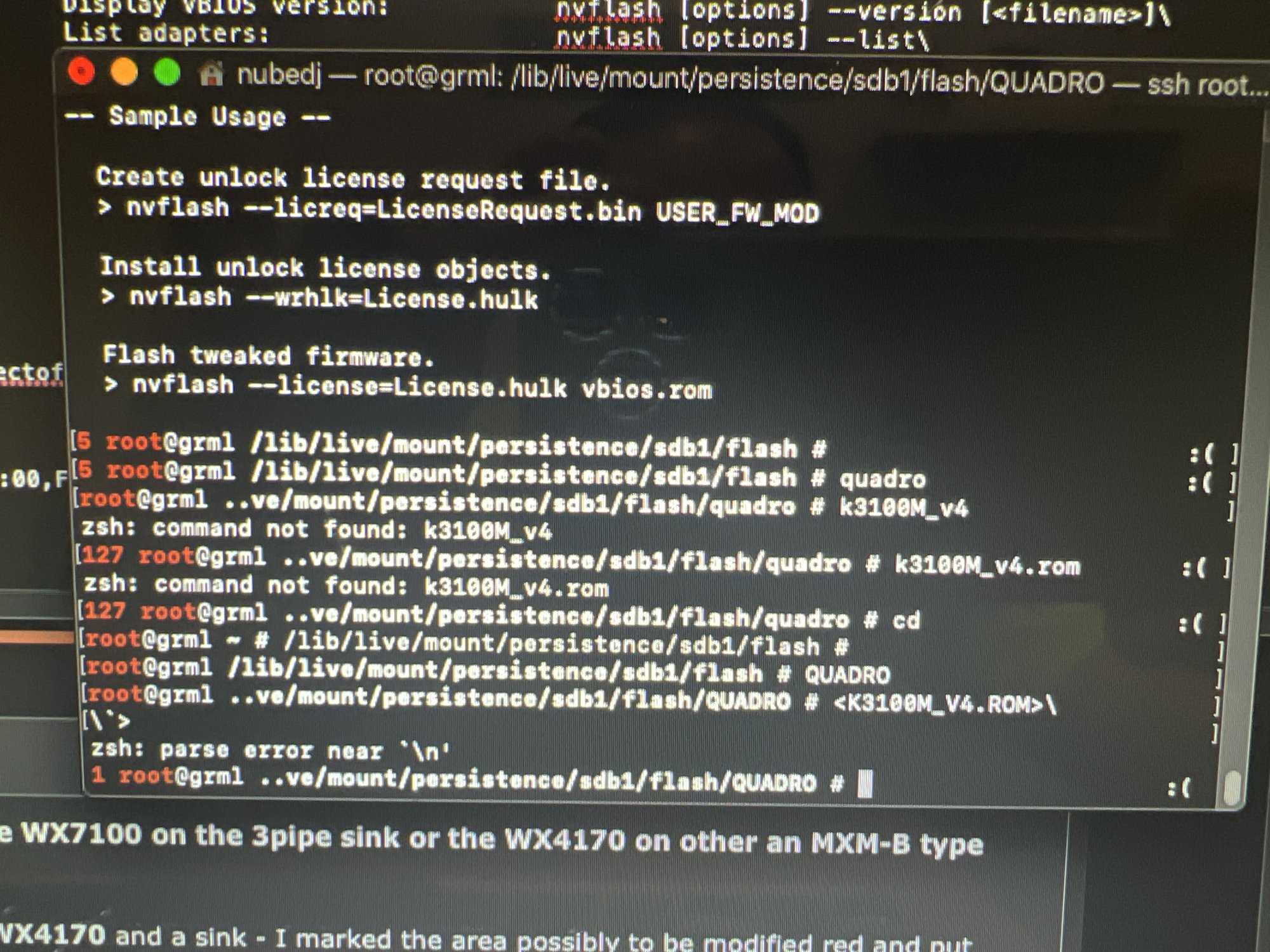

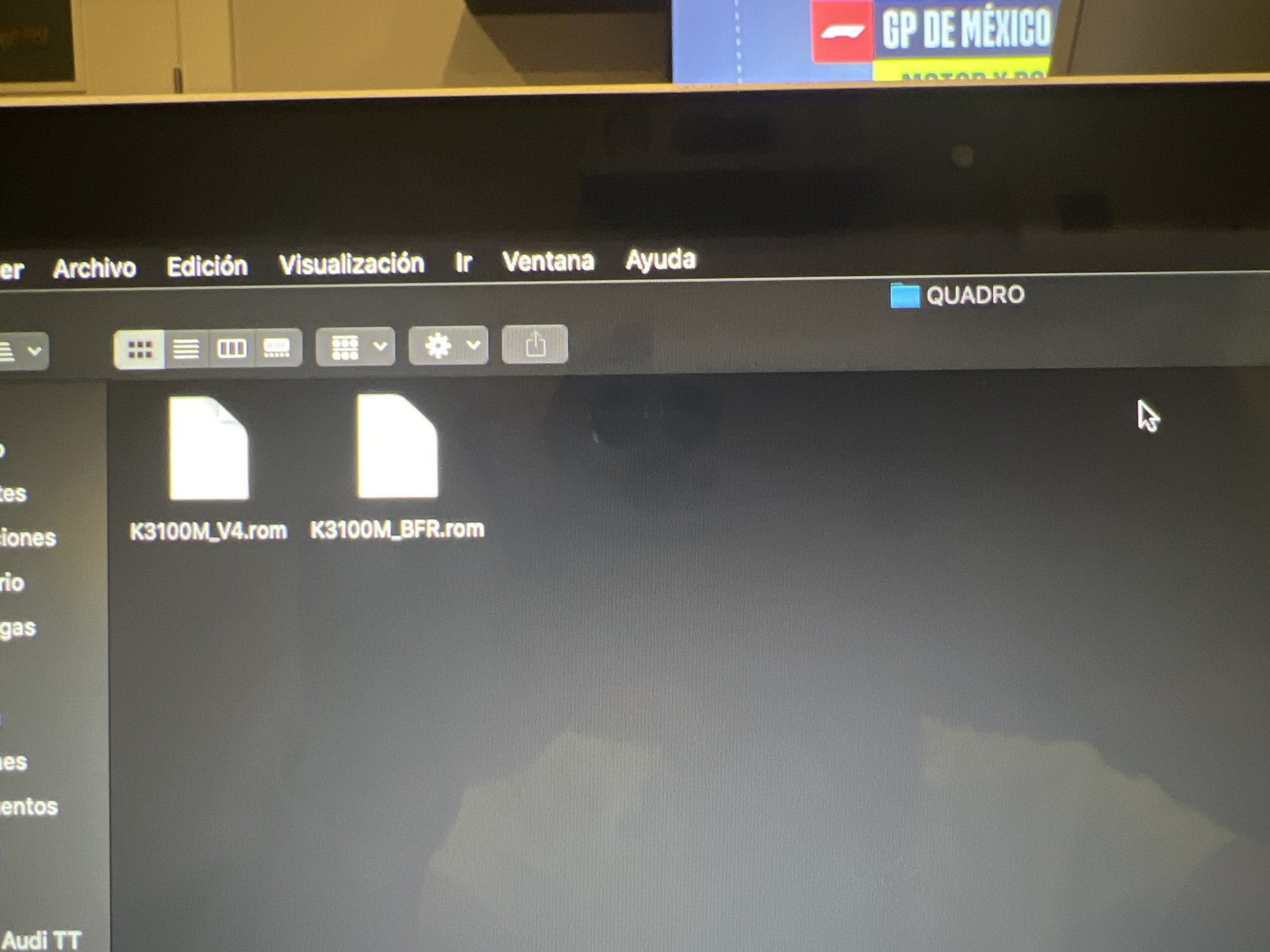

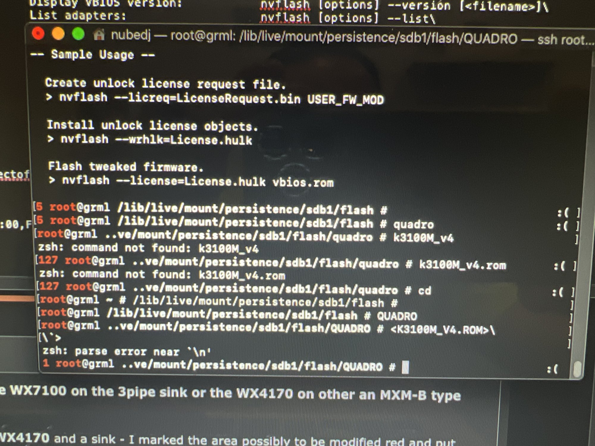

I'm still trying...

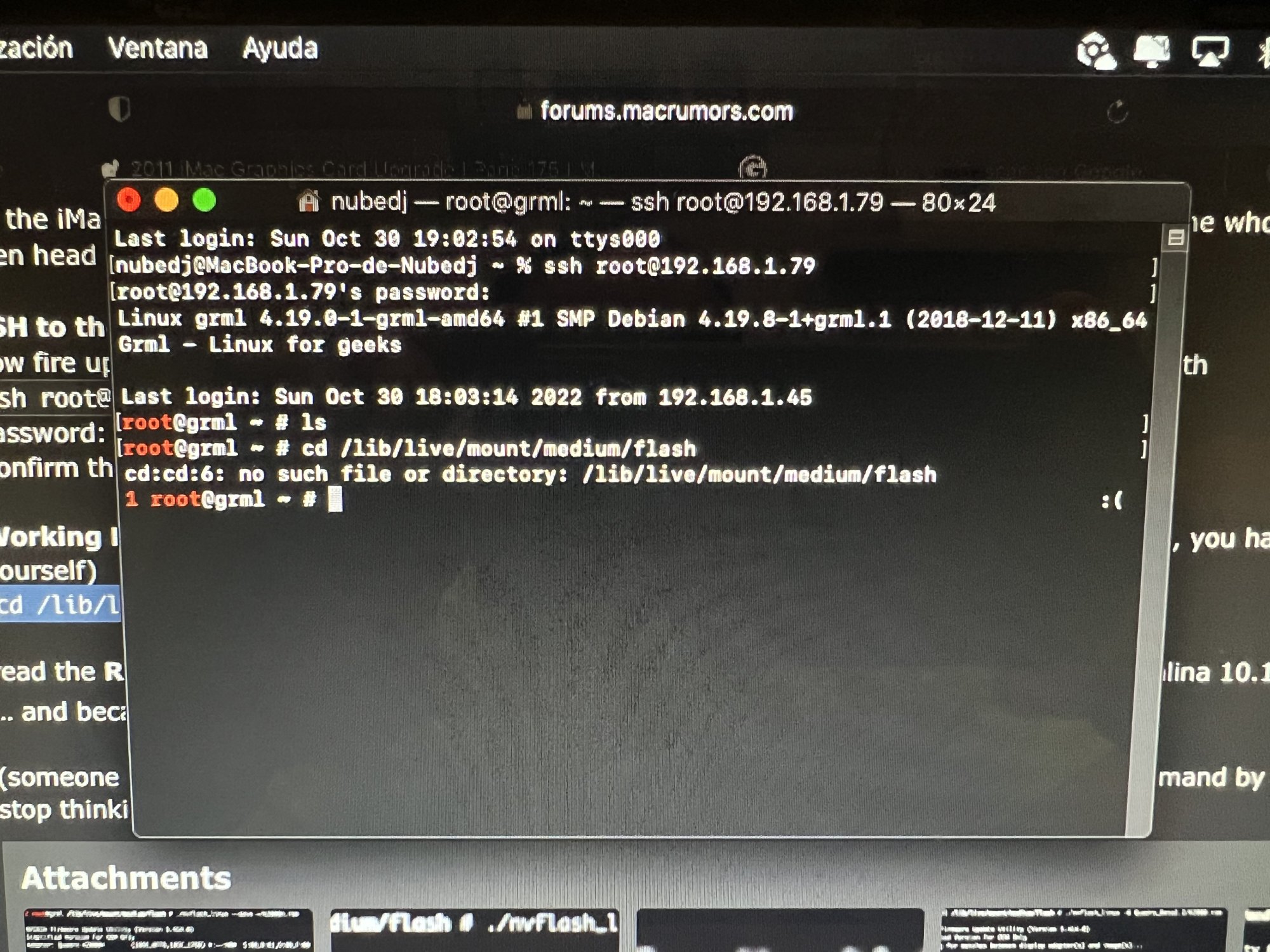

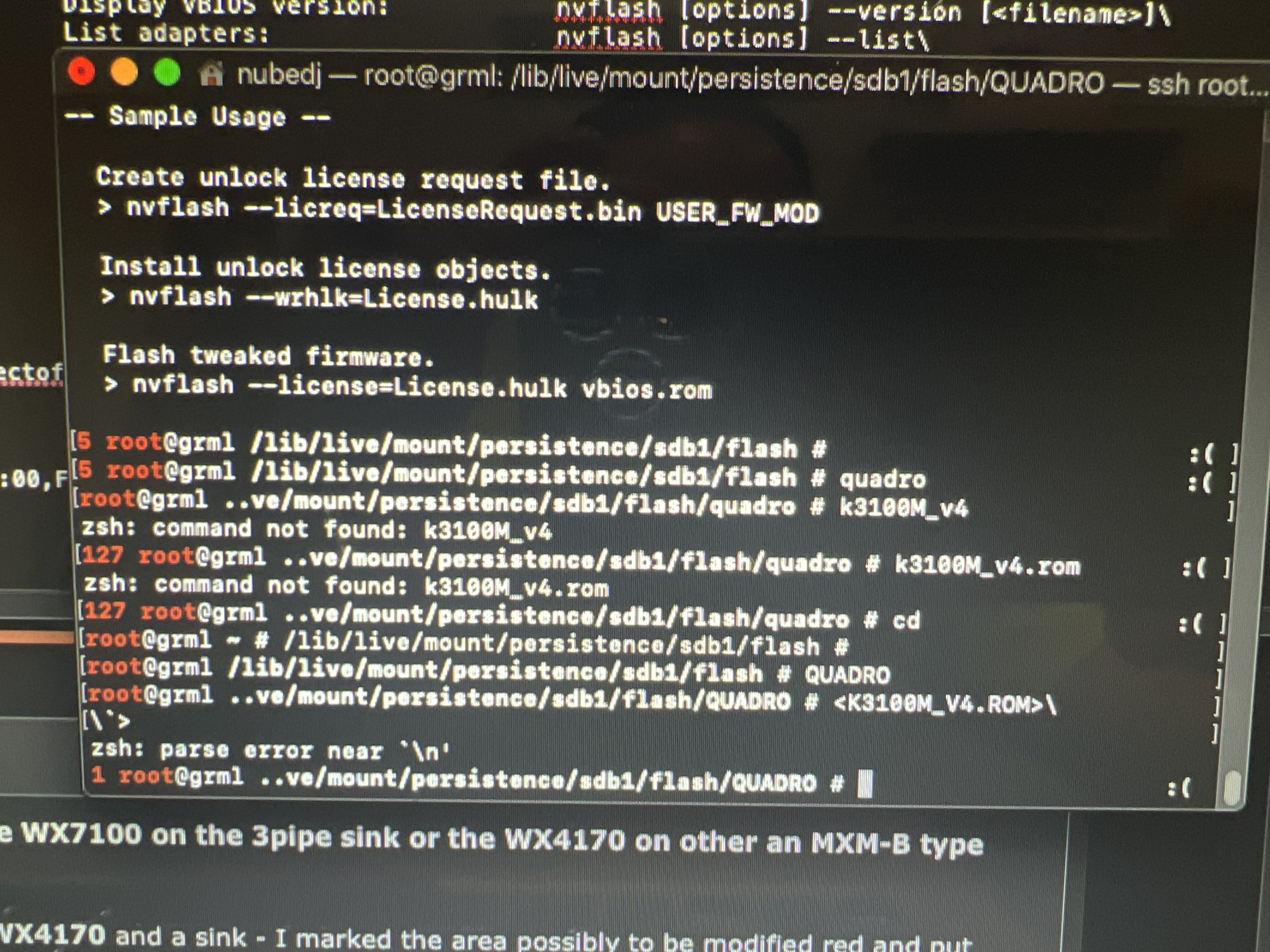

I can't get into the route, am I typing something wrong?
I have copied the 6 folders directly to the root of the usb but I don't know what is the problem…
Please, help me…

You really just need to follow instructions and write Unix-like terminal commands properly. Or get some local help...

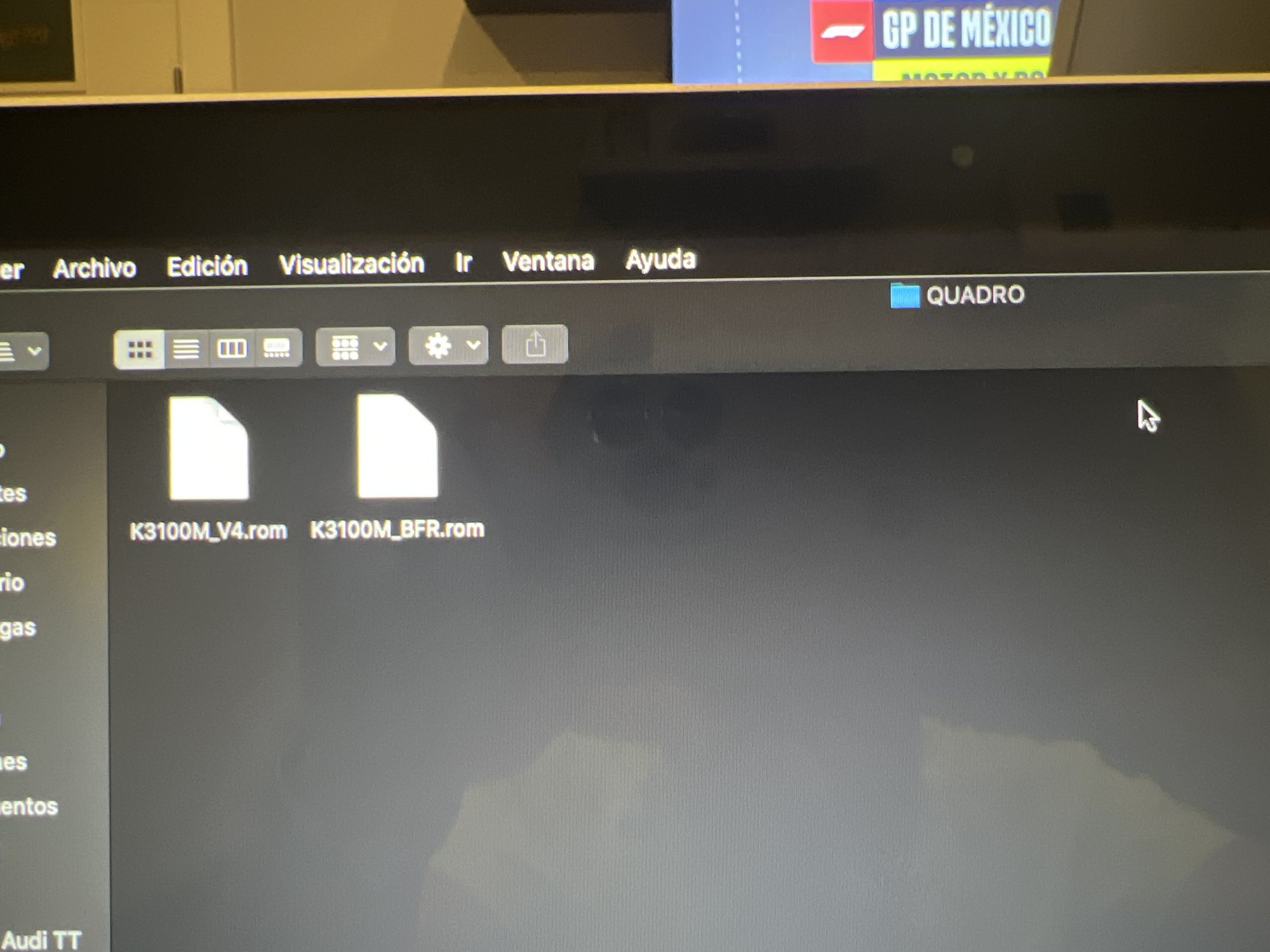

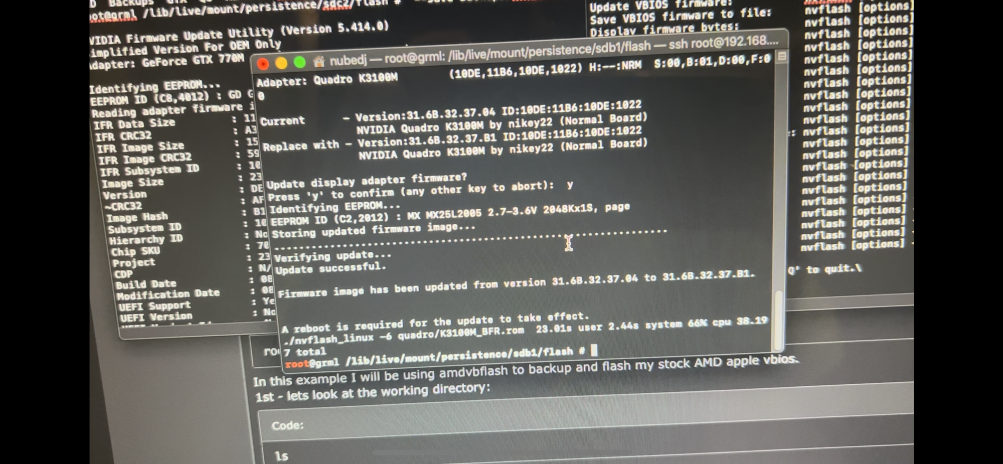

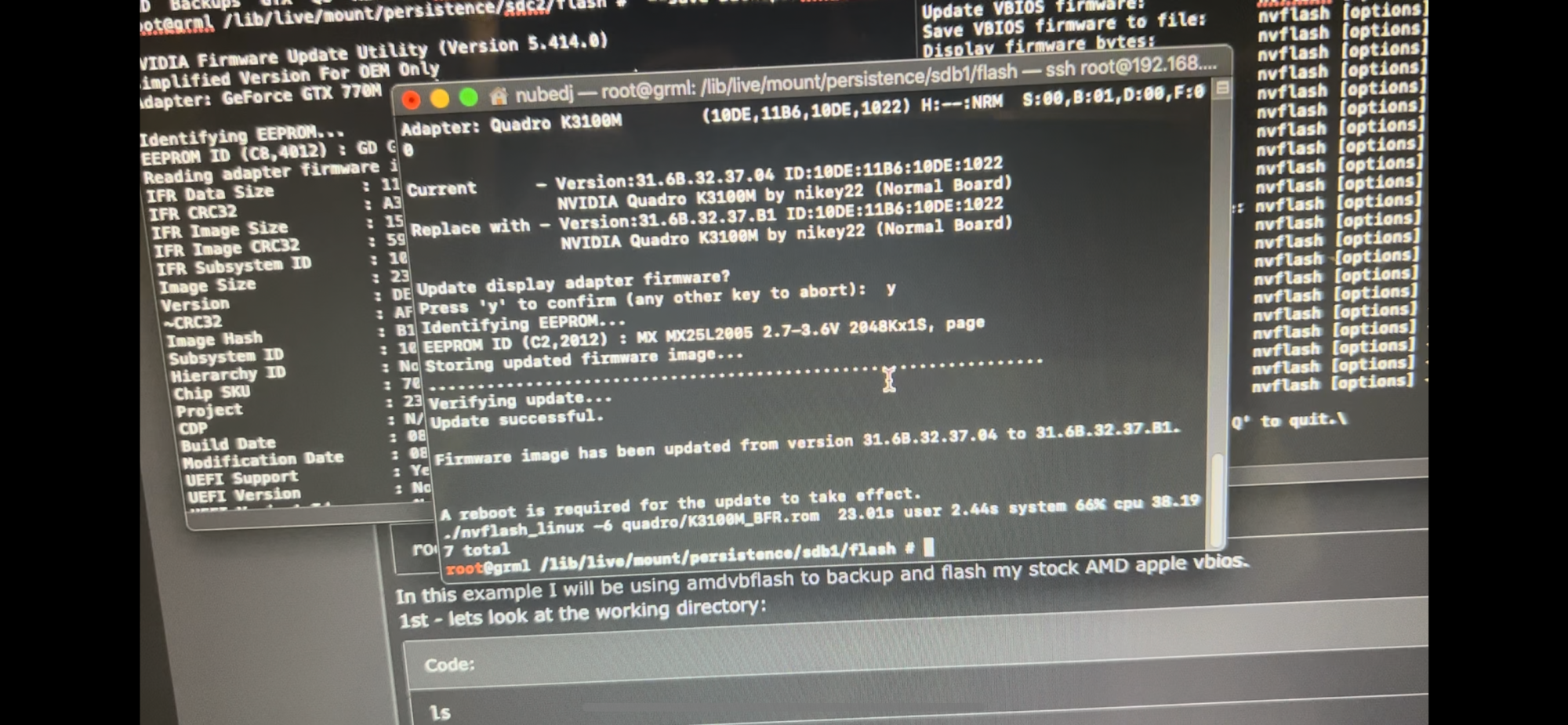

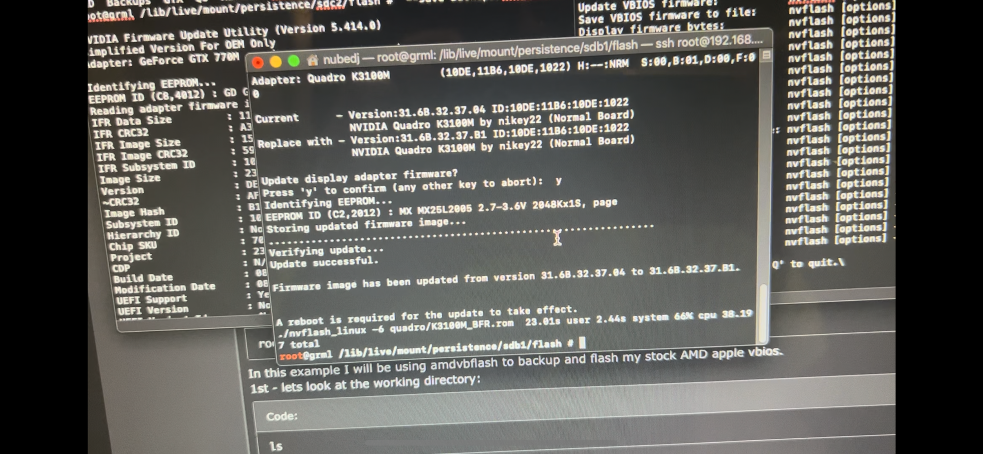

I have finally managed to install the vbios¡¡¡

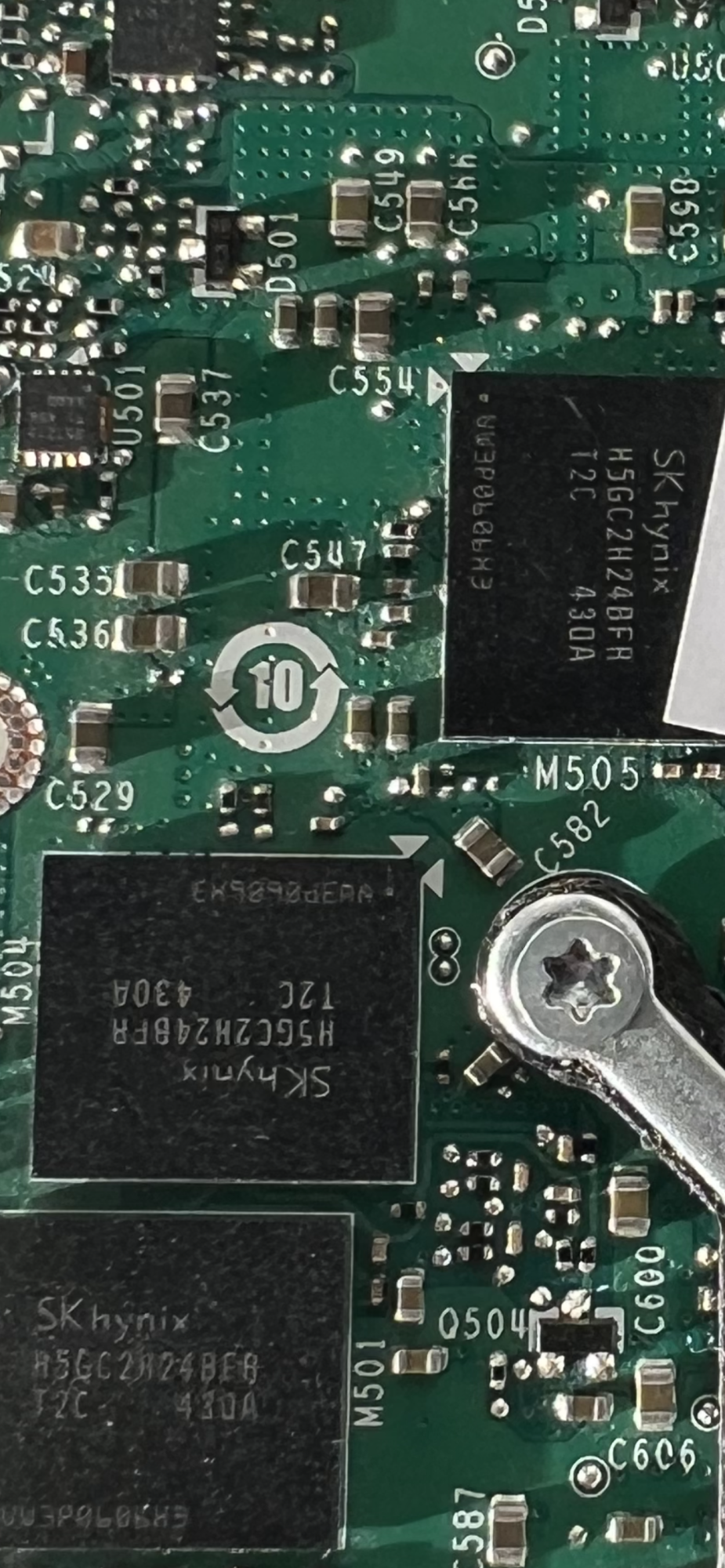

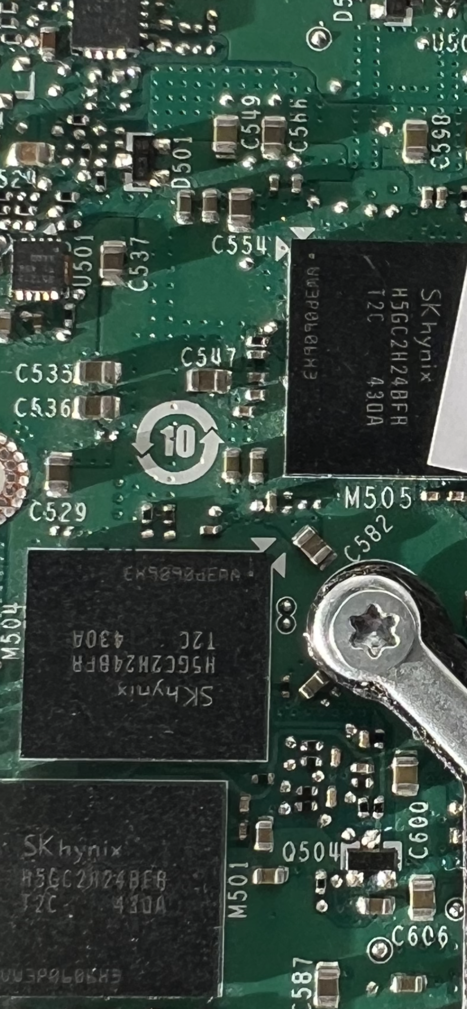

I have used the K3100M BFR rom (my chip are Hynix BFR), then I have reset pram but the screen is still black and any connected monitor does not work.
How do I install the patch if it doesn't turn on the screen by holding down the alt key?
thanks¡
thanks¡
The patch can be run on another working machine, including the one you are trying to upgrade with its stock GPU.
The above statement is to encourage you read the document about OCLP and post 1, not to encourage you raise another question.
Personally, I think the symptom you are facing indicate a hardware issue. A properly flashed K3100m is assumed to function natively in High Sierra, both boot screen and brightness control should work without any patches.
