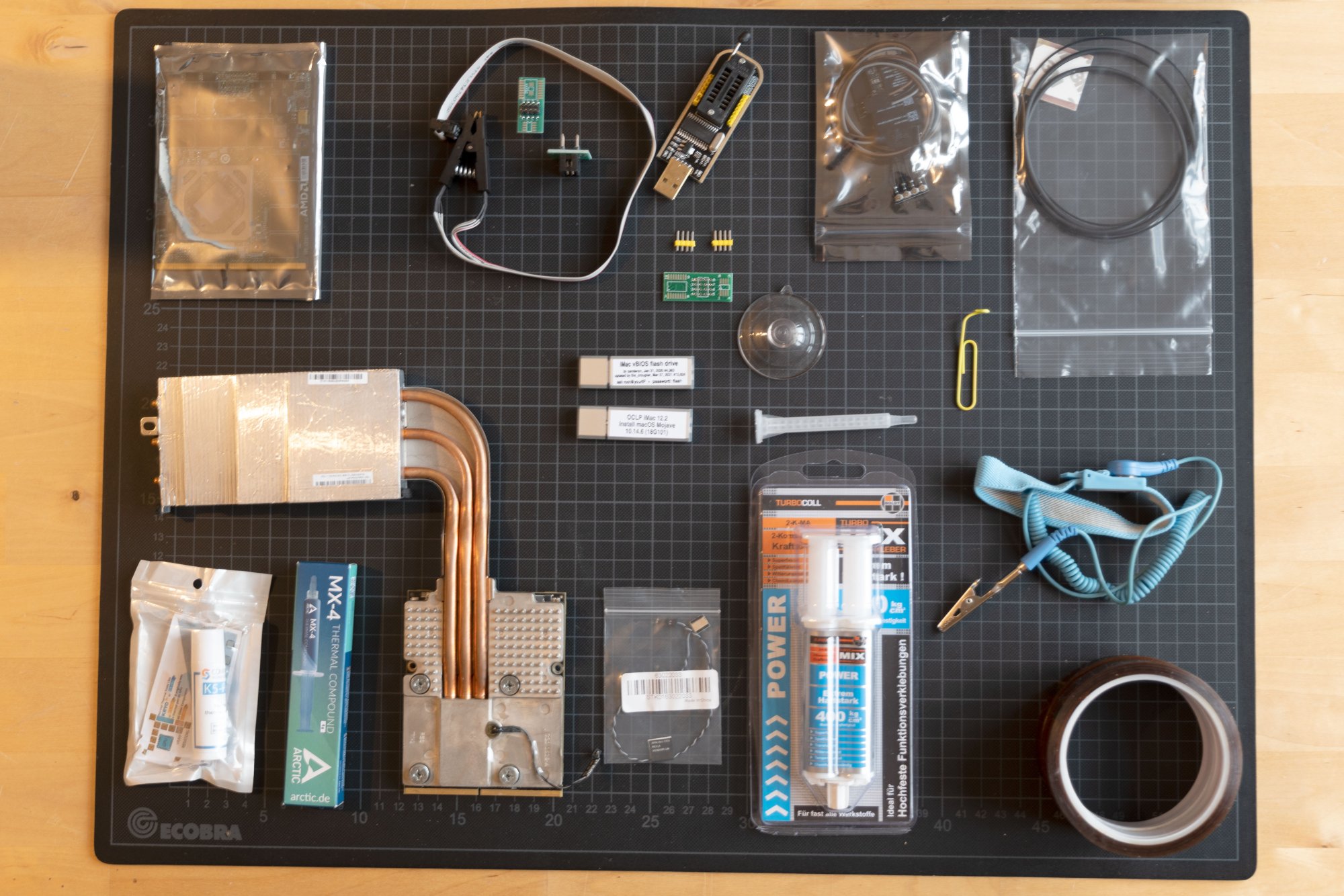

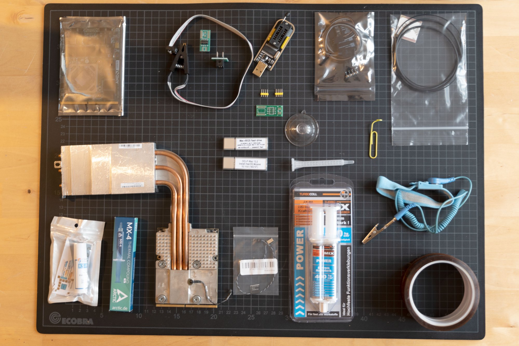

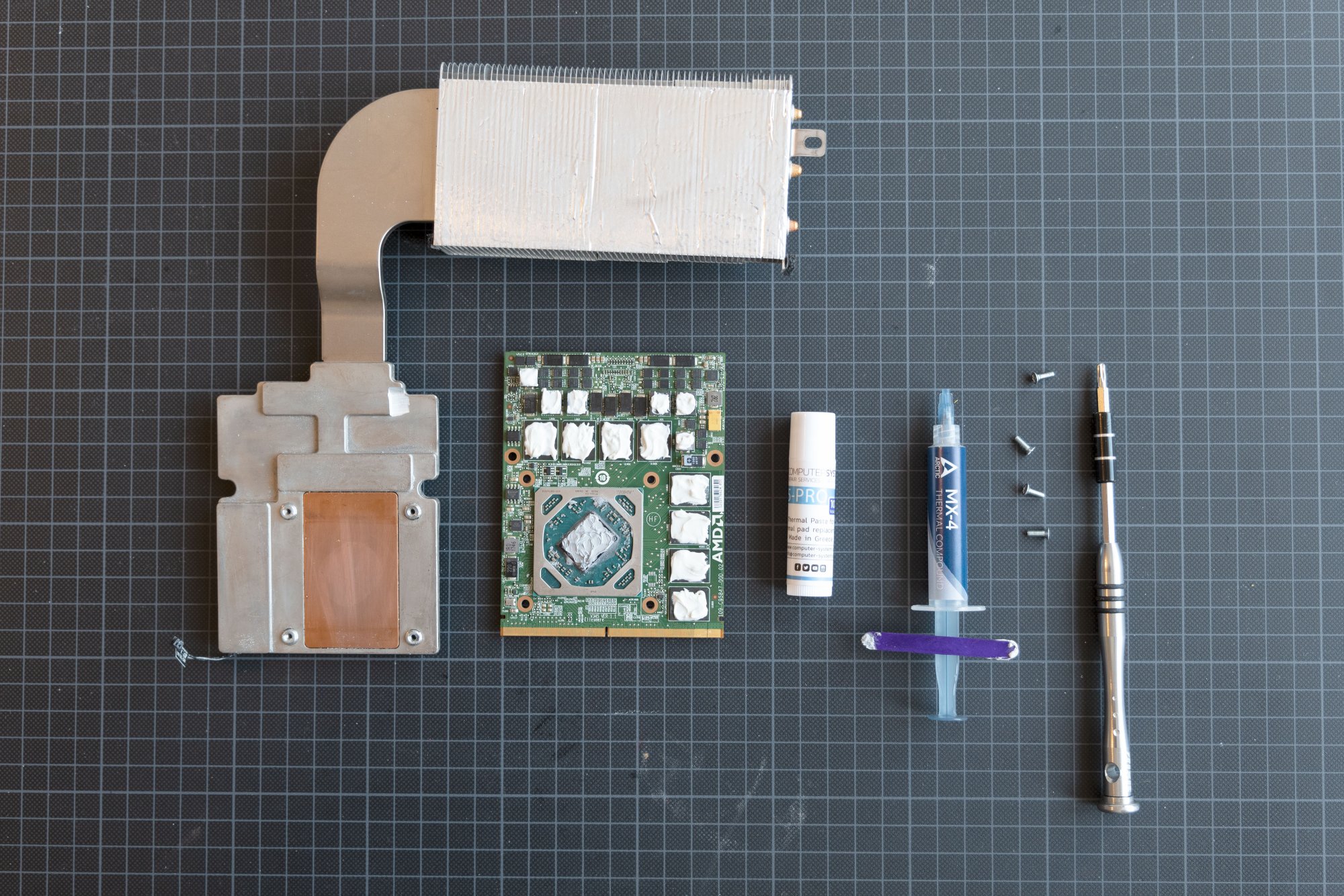

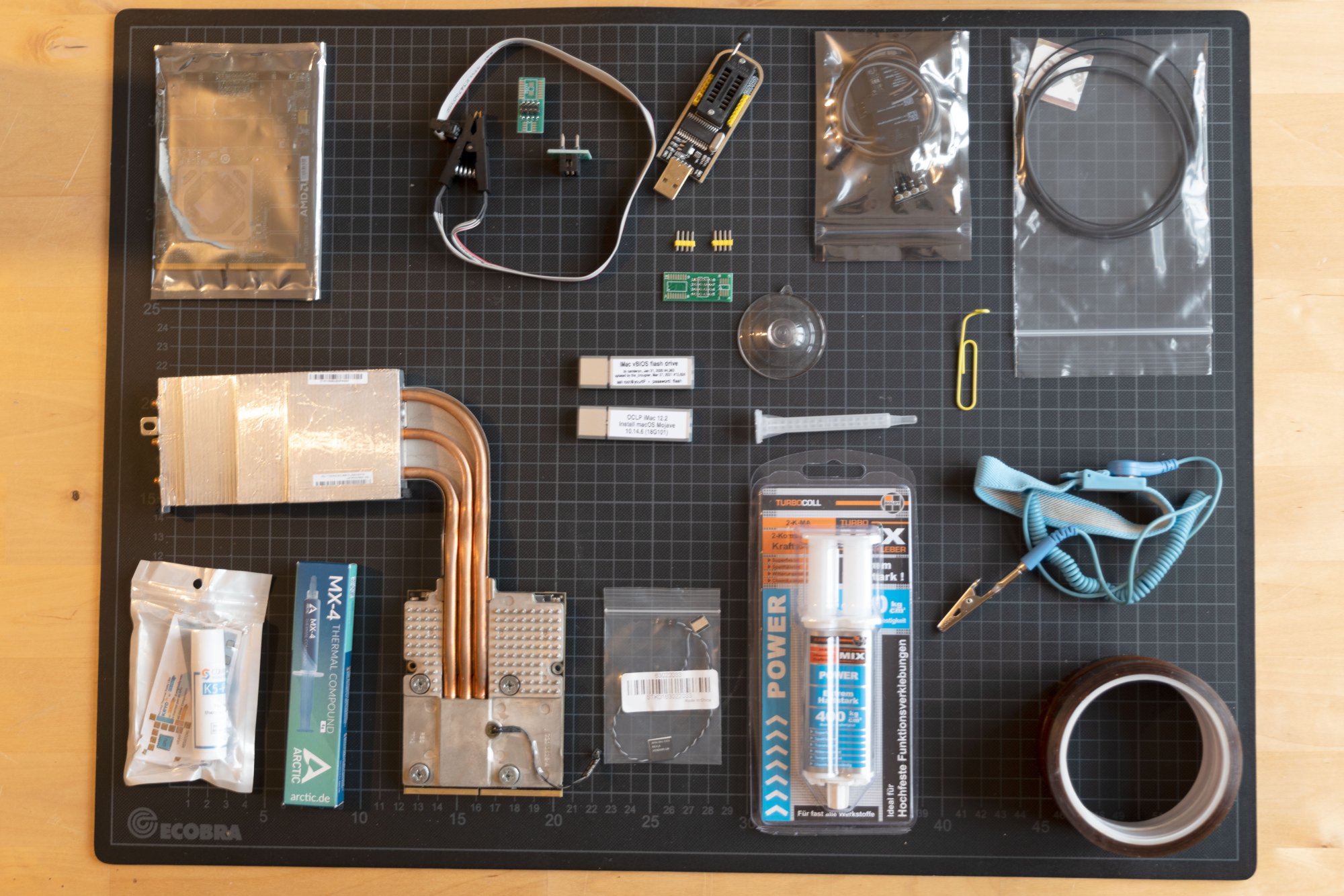

  4. check your tools.
  5. find the right time to do it. Very experienced people can do it maybe in 1-2 hours, but this is in fact a more complex operation, with a lot of moving parts, so a lot can happen. Therefore it is better to have some time available. Just don't do it, if you are in a hurry!!! If I may: rainy Saturdays are perfect.
A head-mounted magnifying glass might be a good idea even if your eyes are prefect. You get just simply more information about what you are doing and how things work, attach, how they are named, etc. The more you know, the less stress will be put on the parts by poking around ...

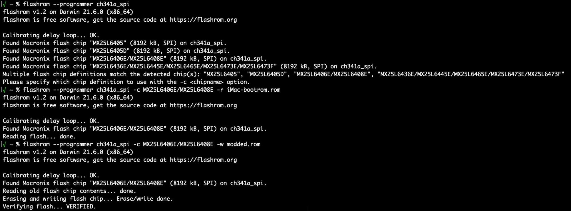

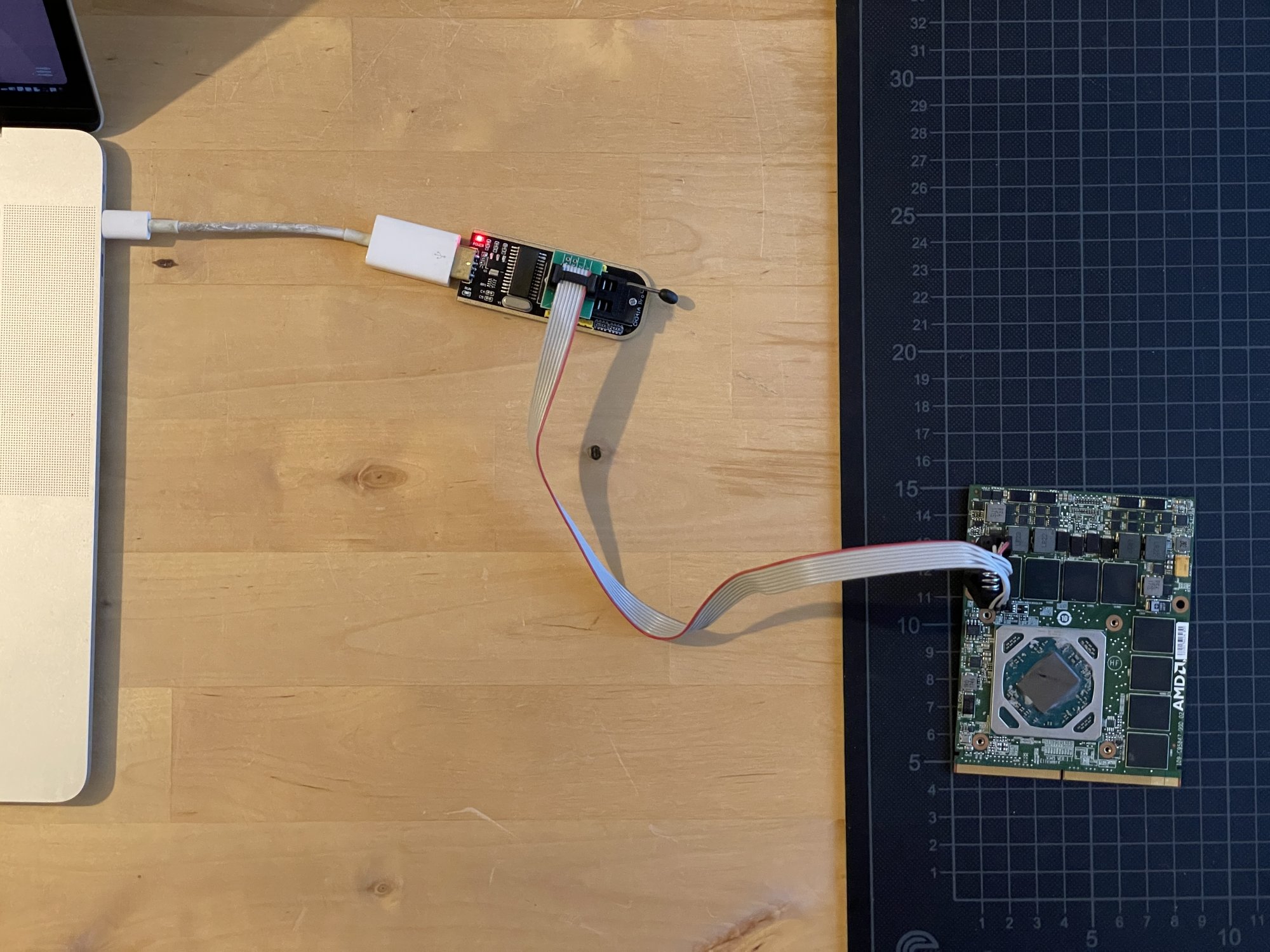

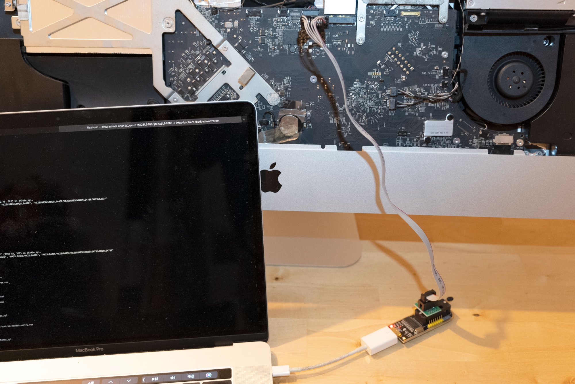

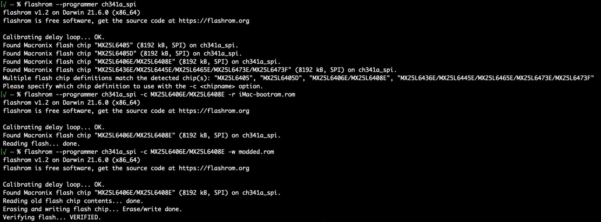

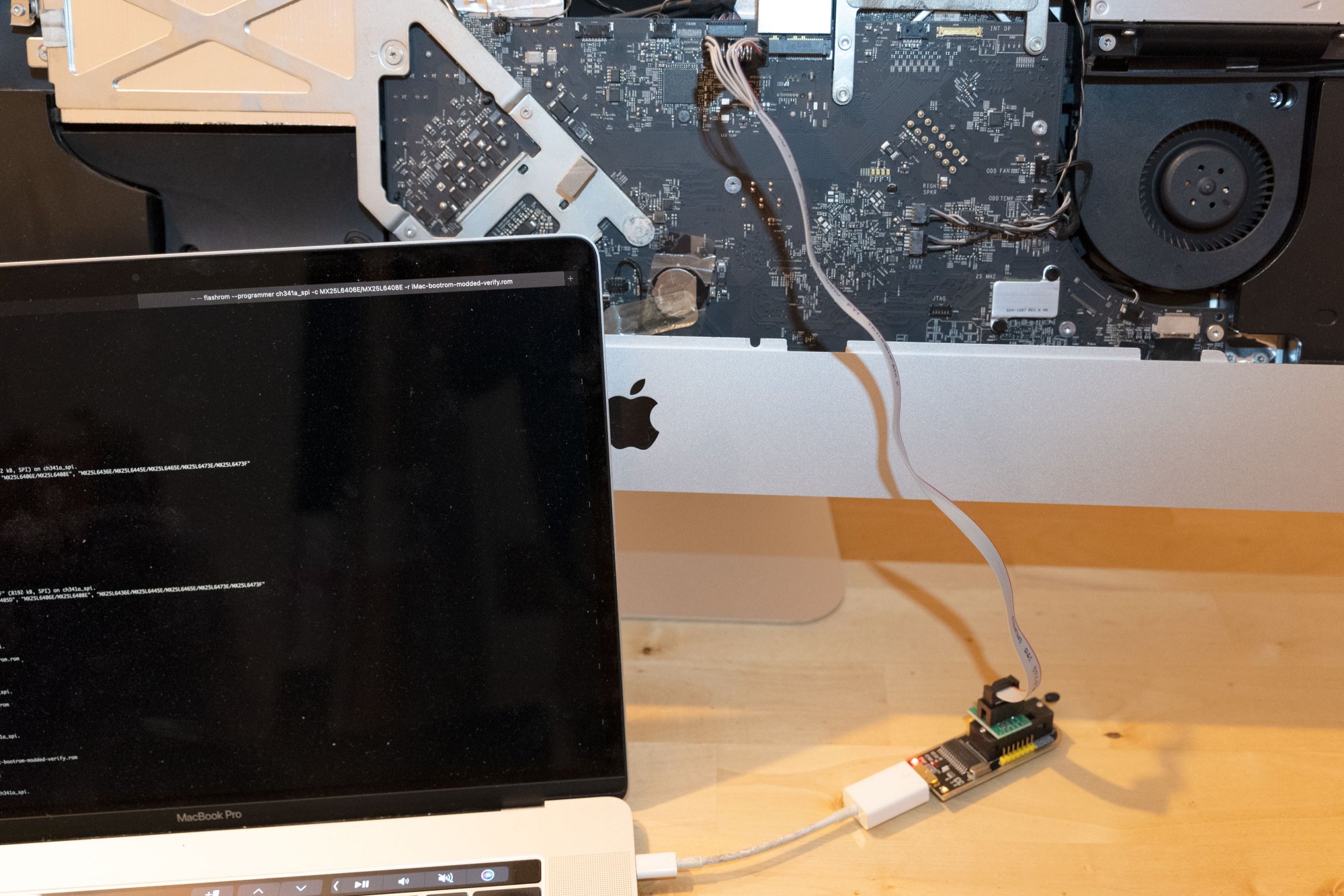

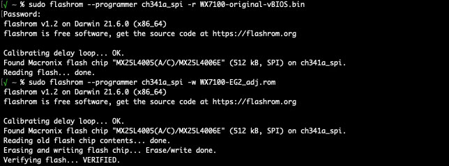

II. Flashing the BootROM​

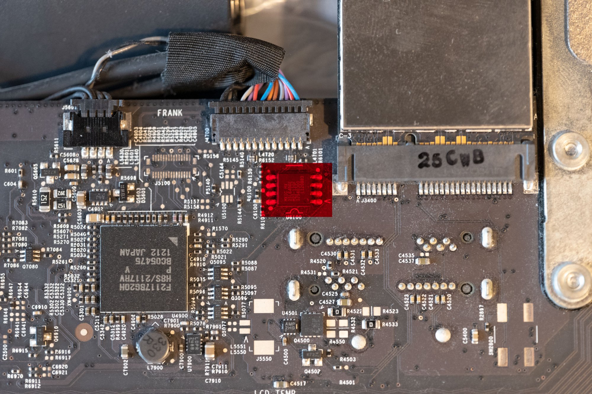

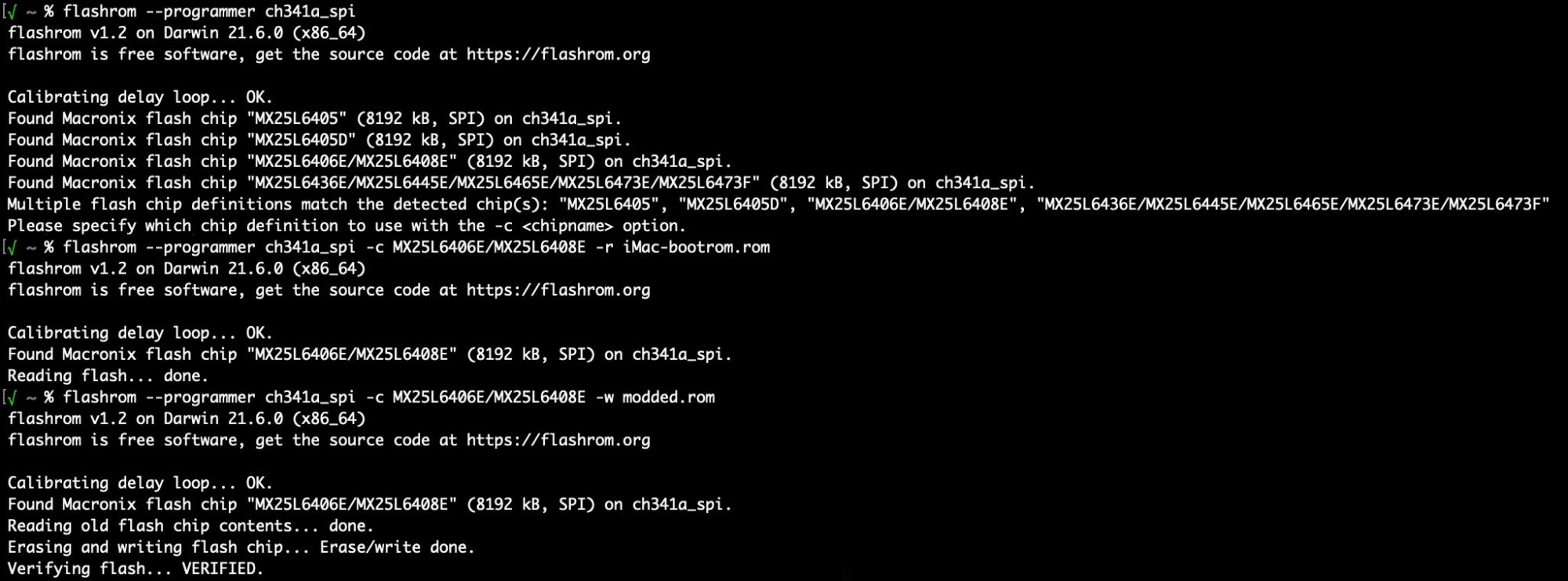

  1. I installed flashrom through brew on a second Mac
  2. You have to know the version of your BIOS chip in order to be able to dump and flash it!
  3. Be very careful, when you attach the CH341a programmer. The head-mounted magnifying glass is quite handy here.

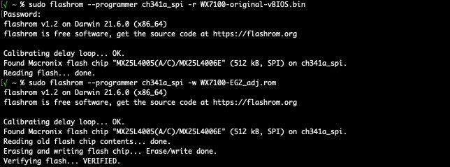

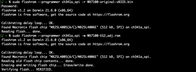

  4. dump the original bootROM first
  5. save the original bootROM in a safe place
  6. make a copy of the original bootROM and apply the EG modification by inserting the two DXE-Drivers. @Nick [D]vB's post is an excellent guide.
  7. It is a good advice to test the machine after flashing the bootROM. This way you will know, if this part of the process worked. You do not need to reattach the LCD-panel, an attached external display will do.

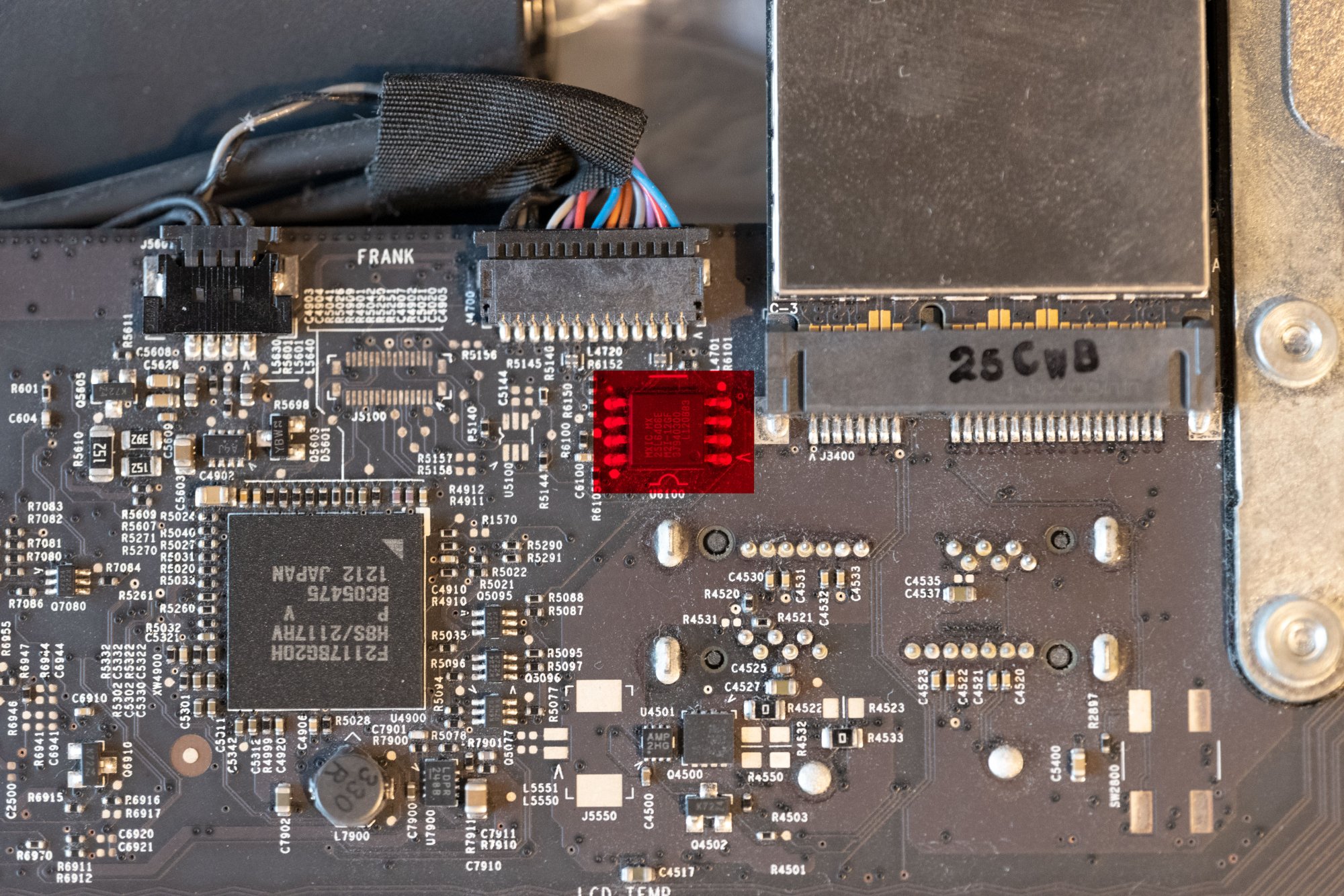

(position of the BIOS chip)

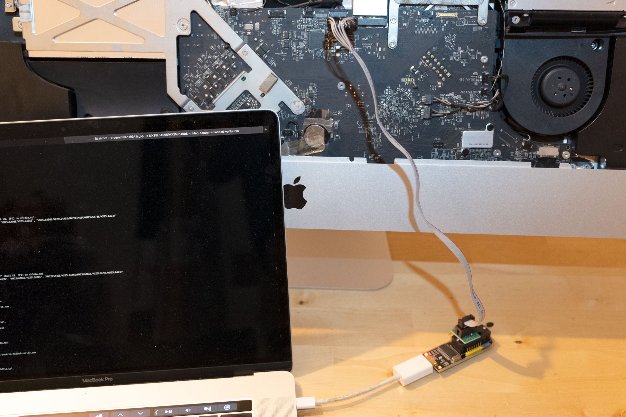

In case a CH341a programmer is used, it is a good advice to already do the dump with it. This way you will find out, if the CH341a works and if the connection is stable. For the reading and writing part you will have to know the version of your firmware chip.

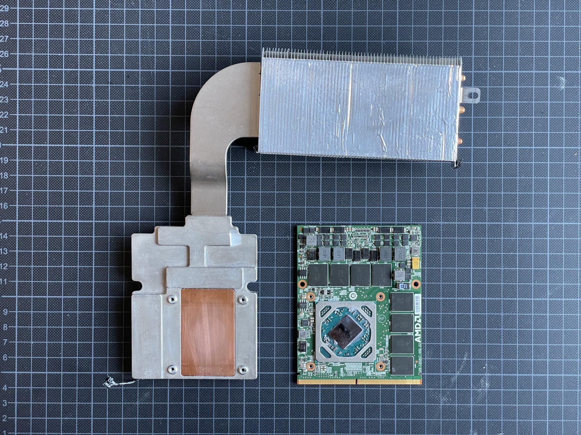

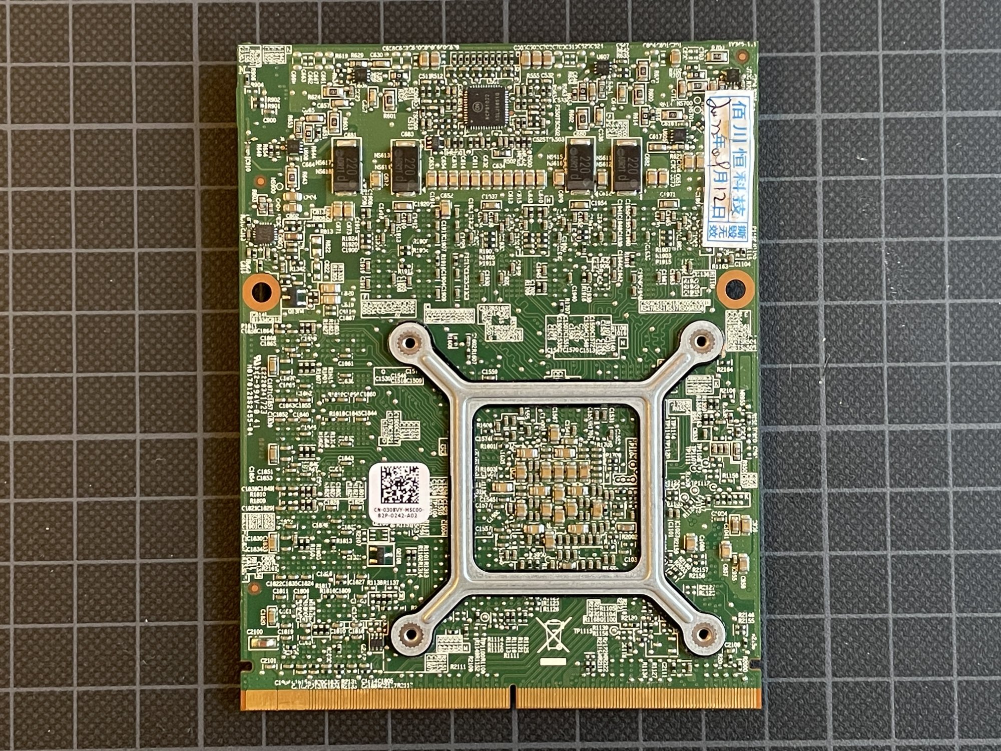

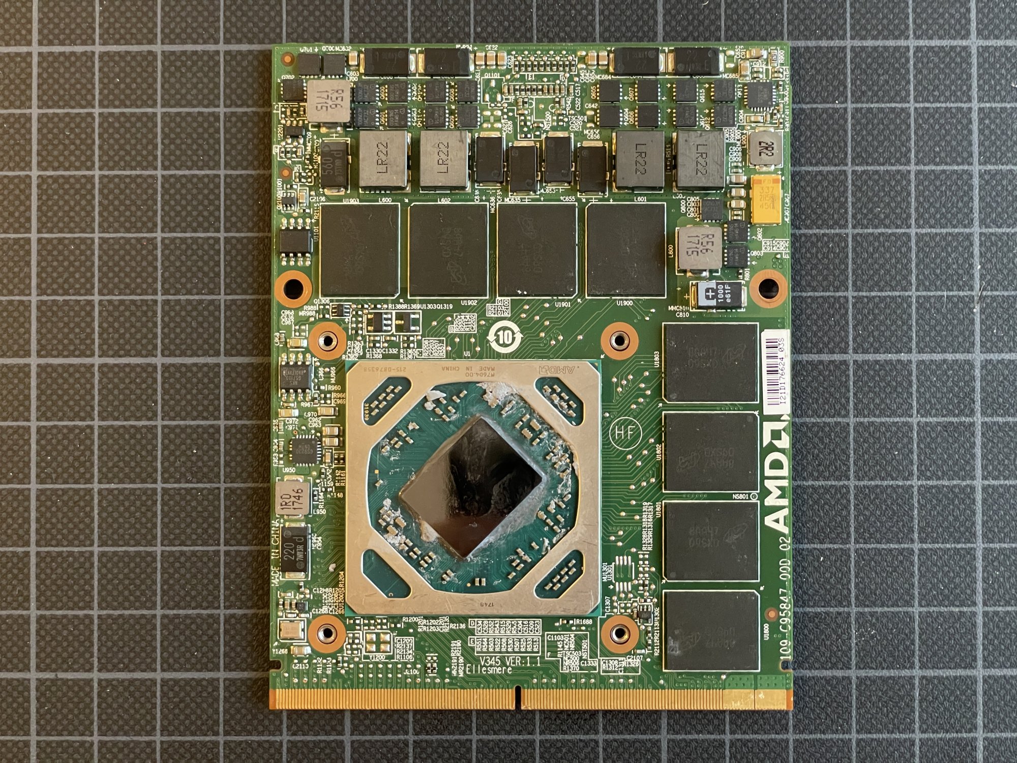

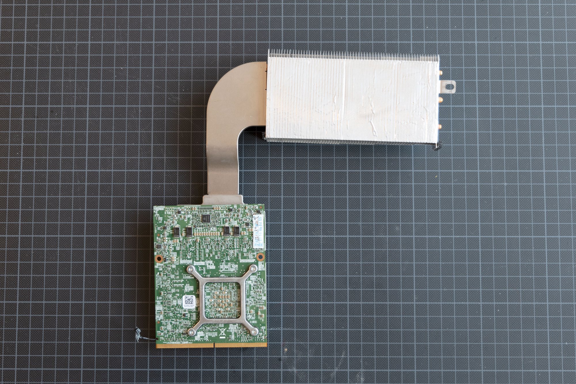

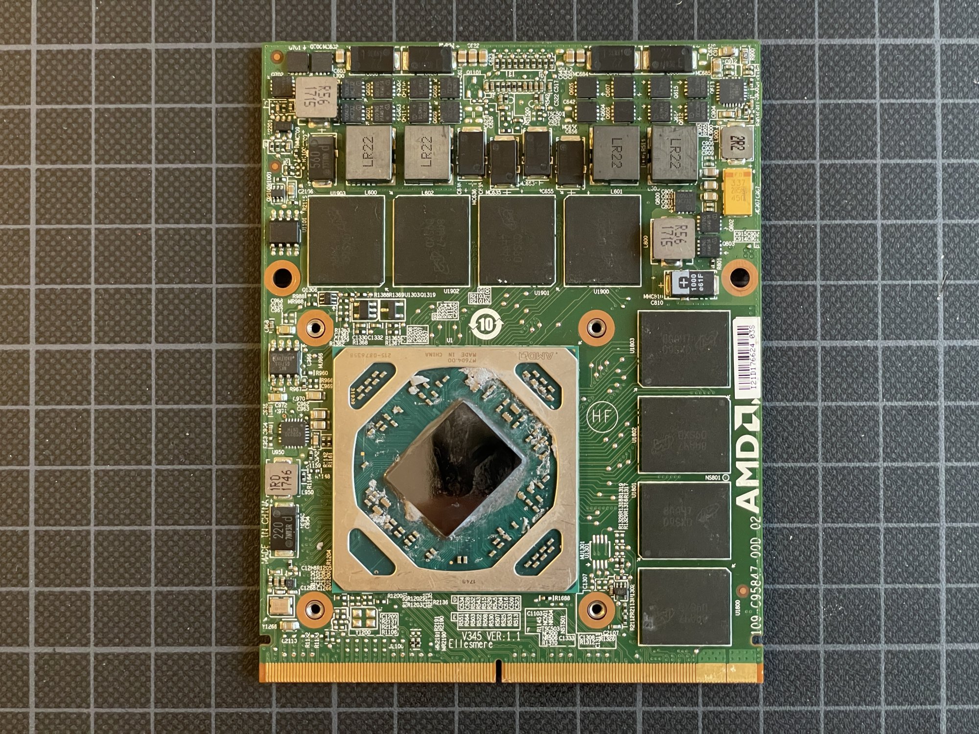

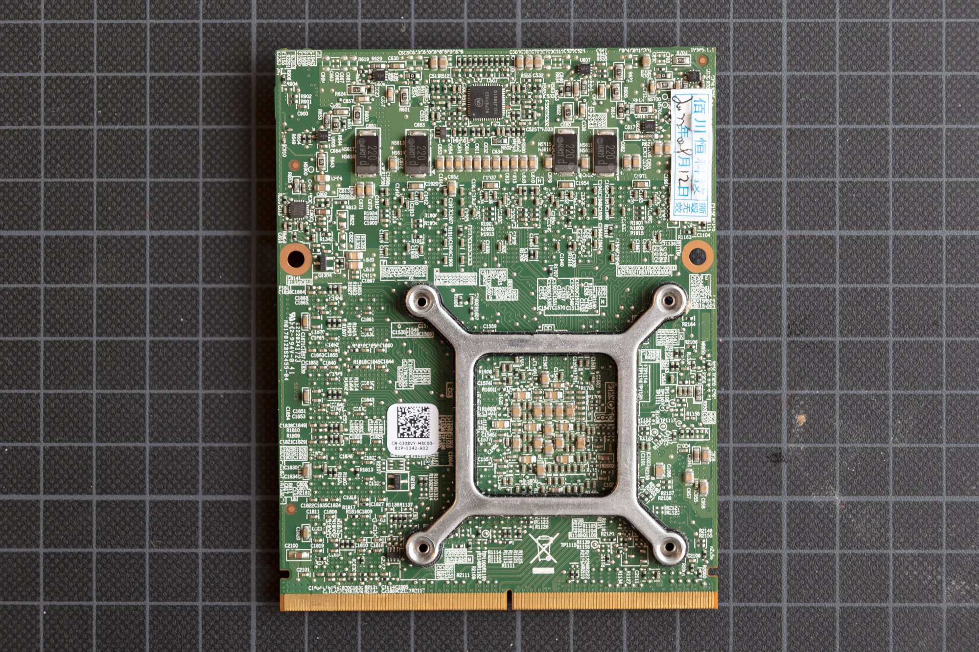

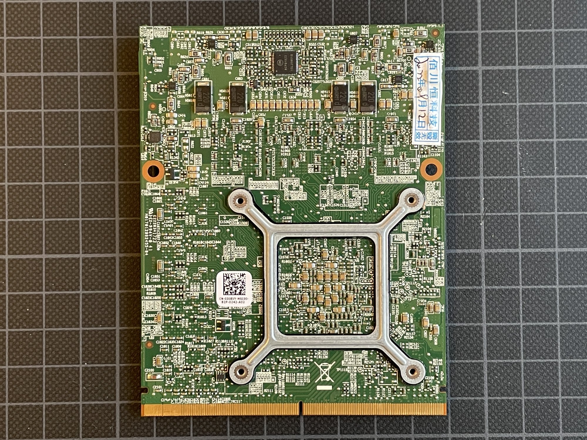

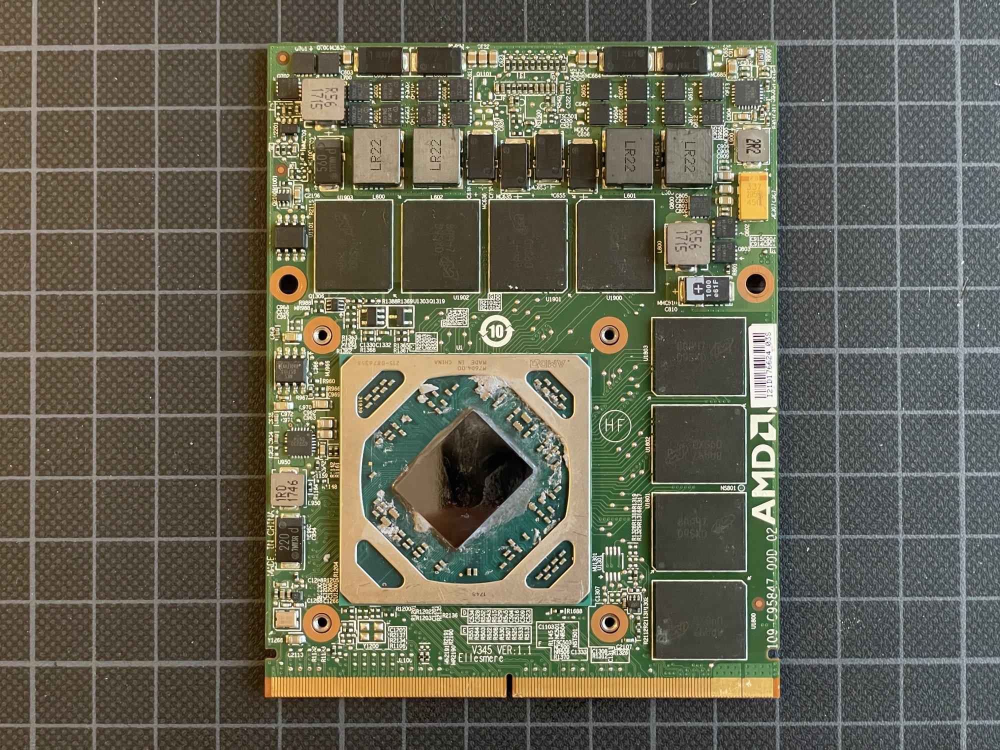

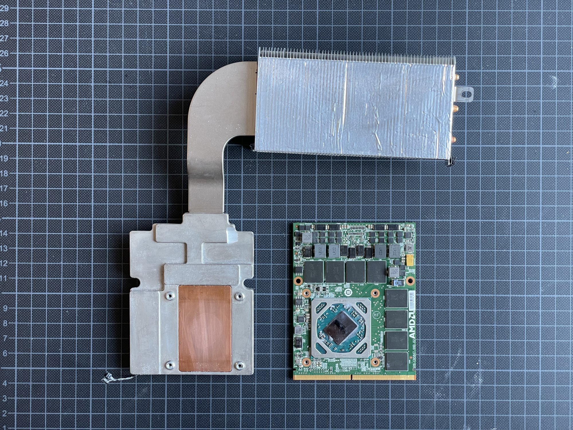

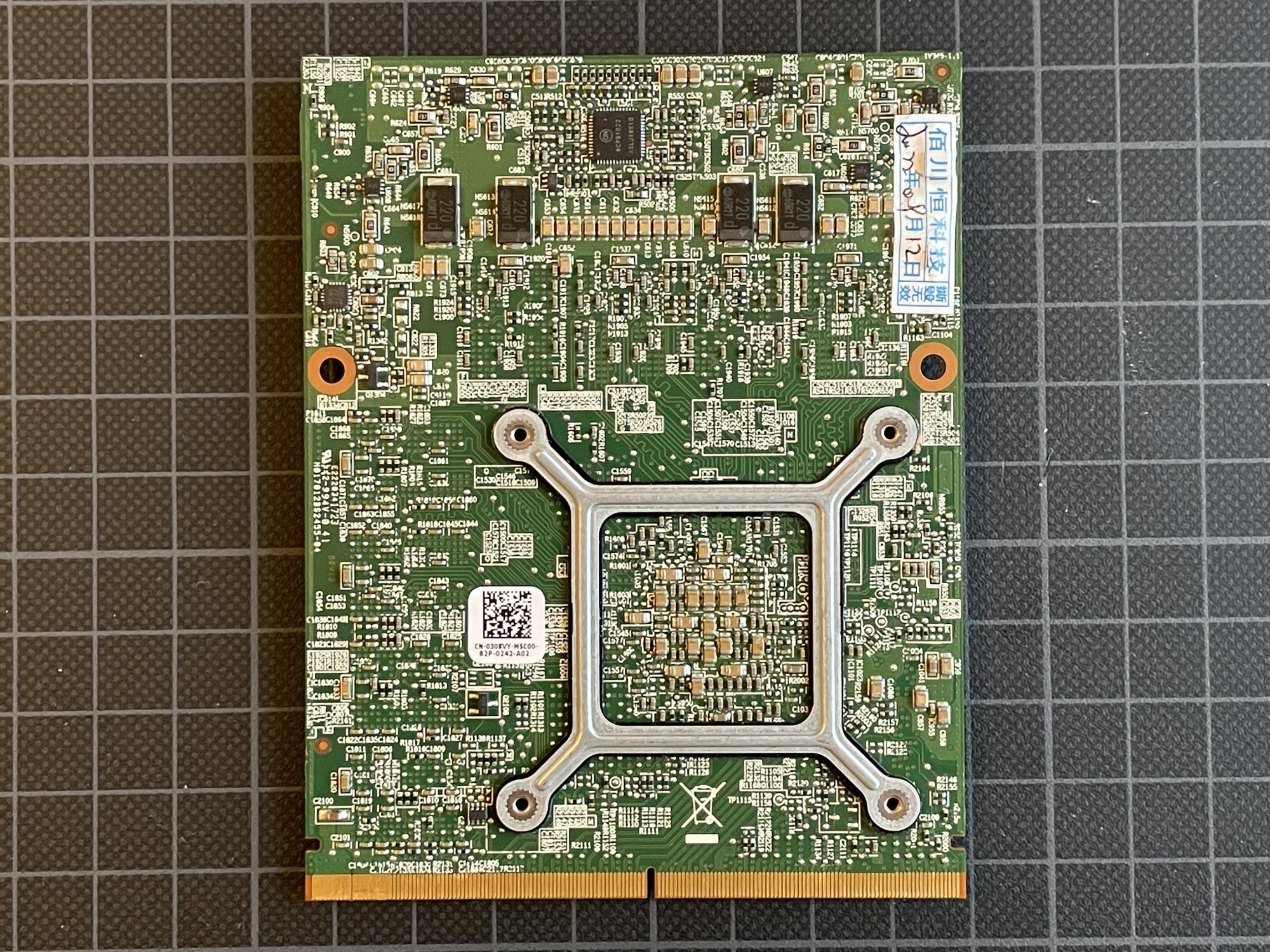

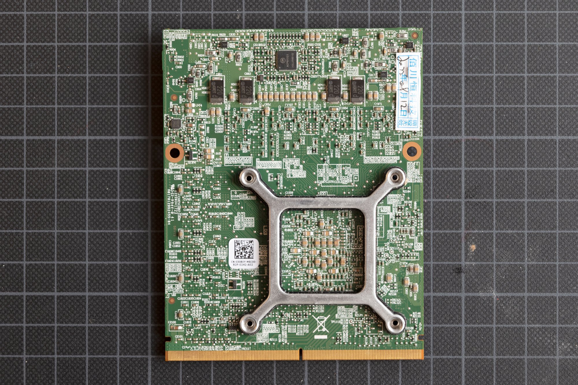

III. Documenting the GPU​
Document the GPU-card before mounting it. The more details about the card you document, the better. Document especially the VRAM in a way, that the information about the producer and model are visible! Other members of the thread will need the information, as well as the dumped vBIOS, in order to try to help you, if things do not work out.

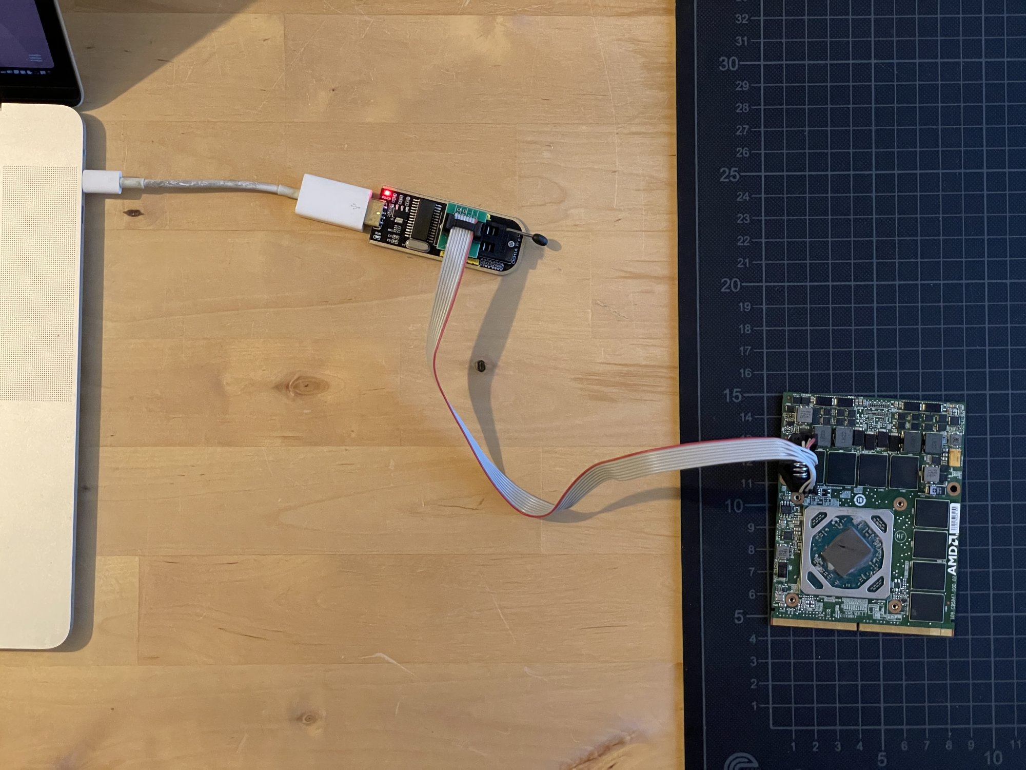

IV. Flashing the GPU​

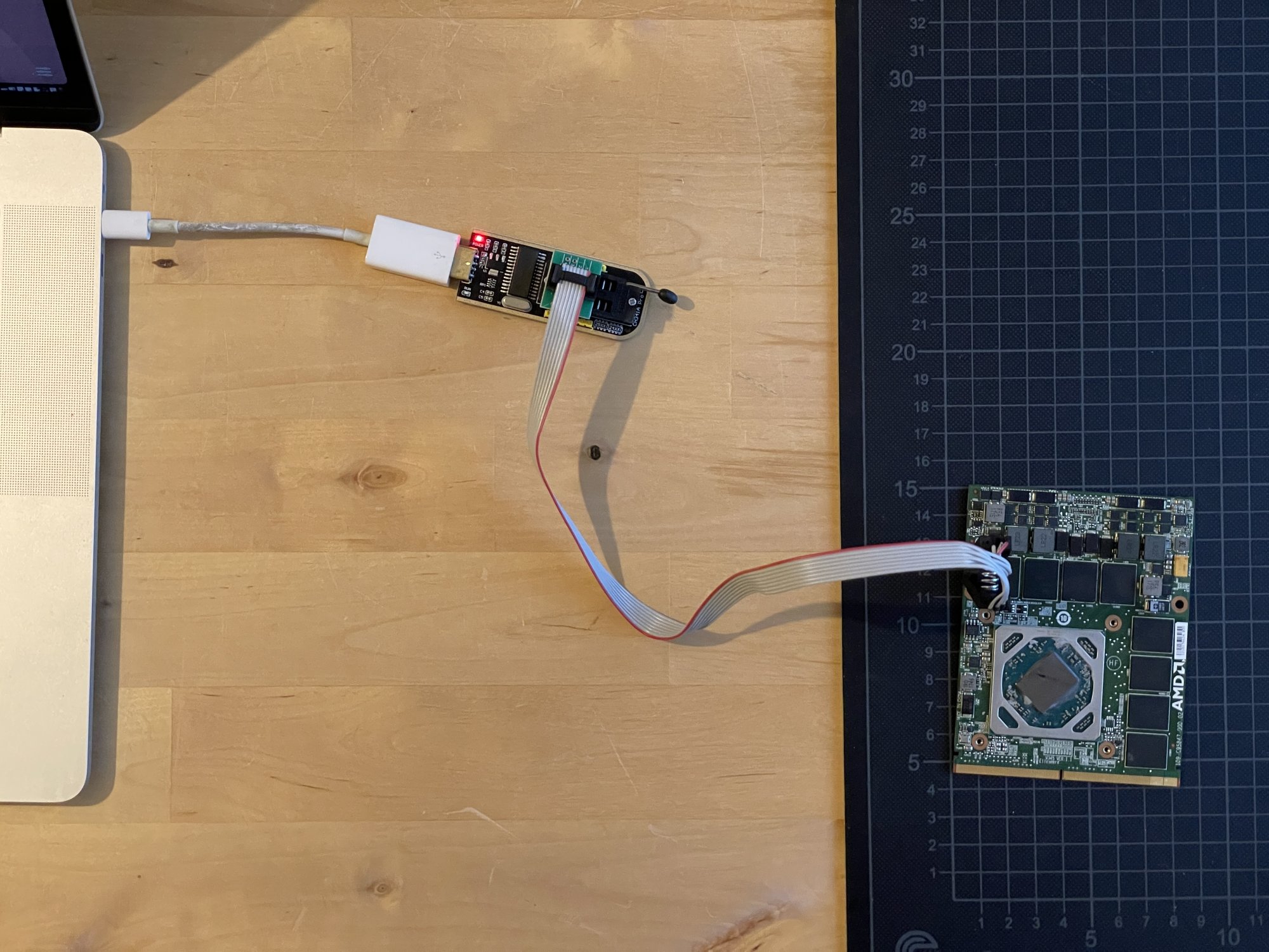

  1. Connect the CH341a programmer to the BIOS chip on the GPU card. The head-mounted magnifying glass is handy here too.
  2. Use flashrom to flash the card with the vBIOS you have chosen.

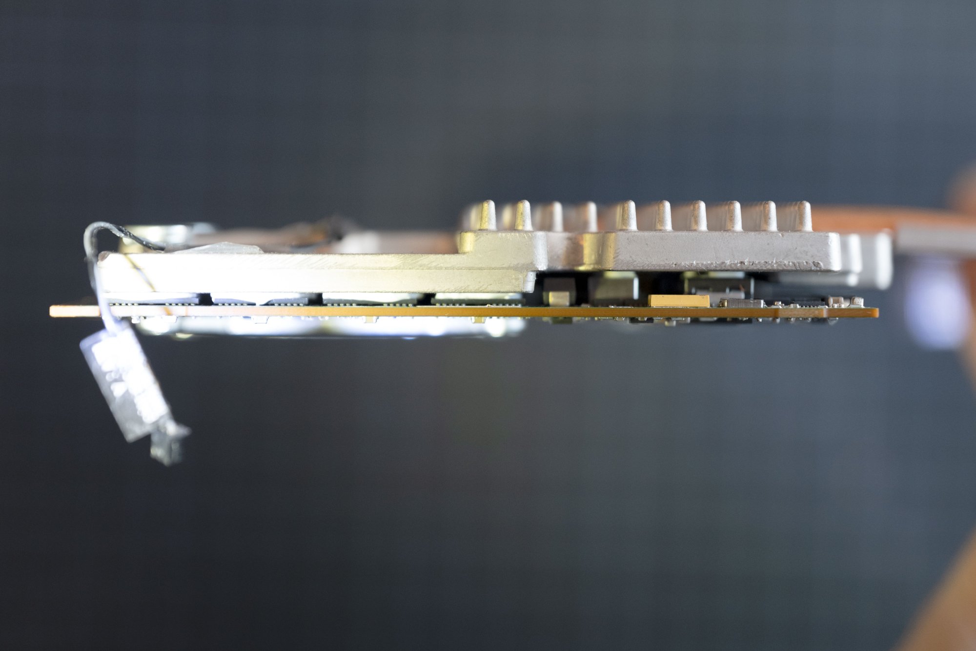

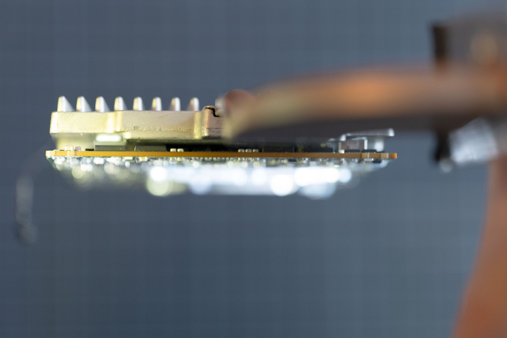

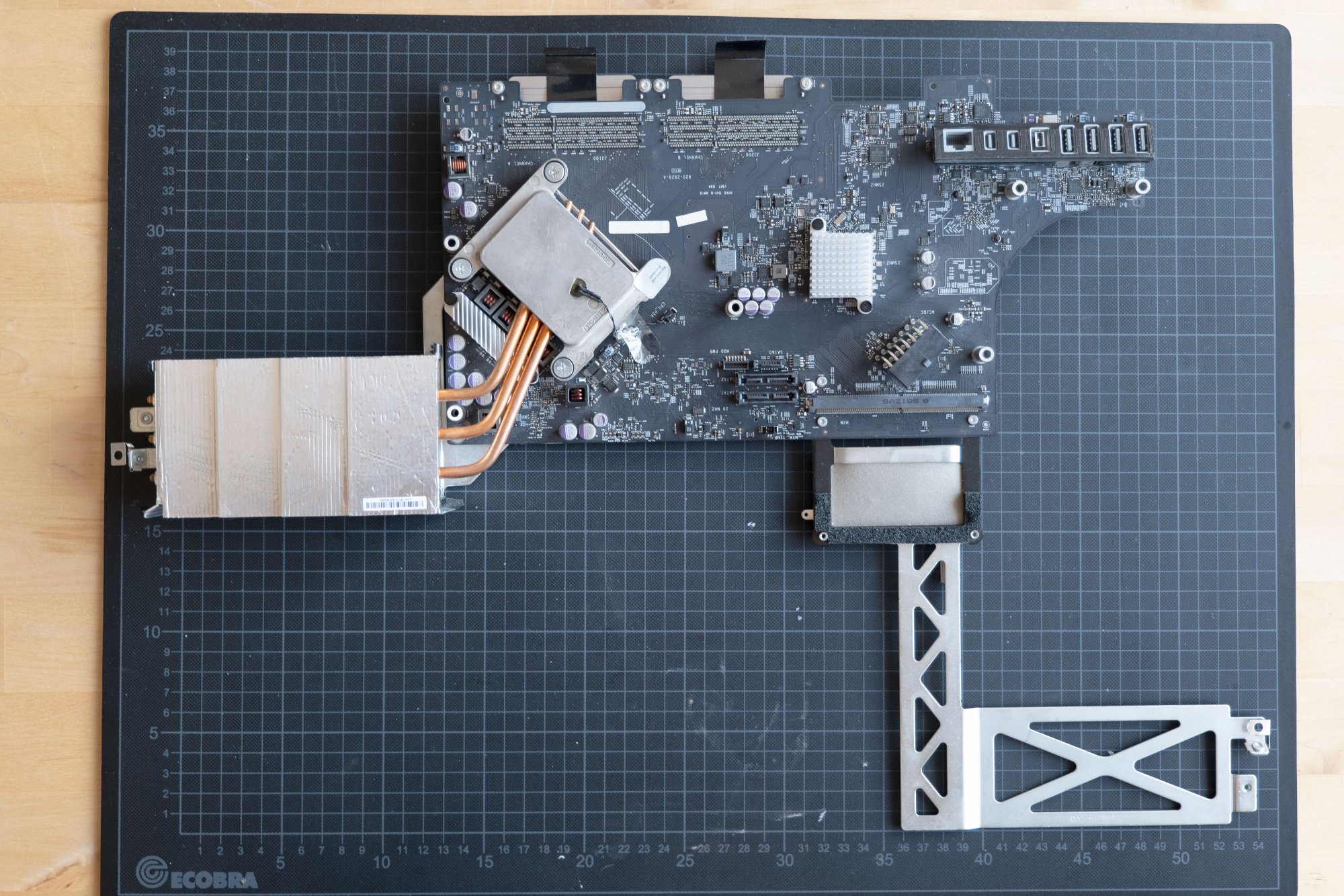

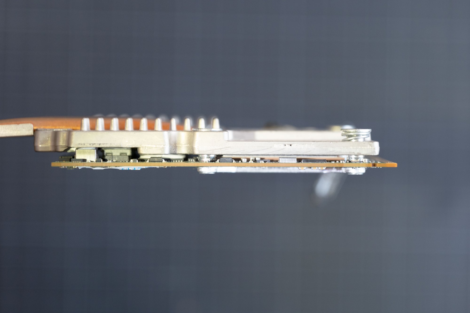

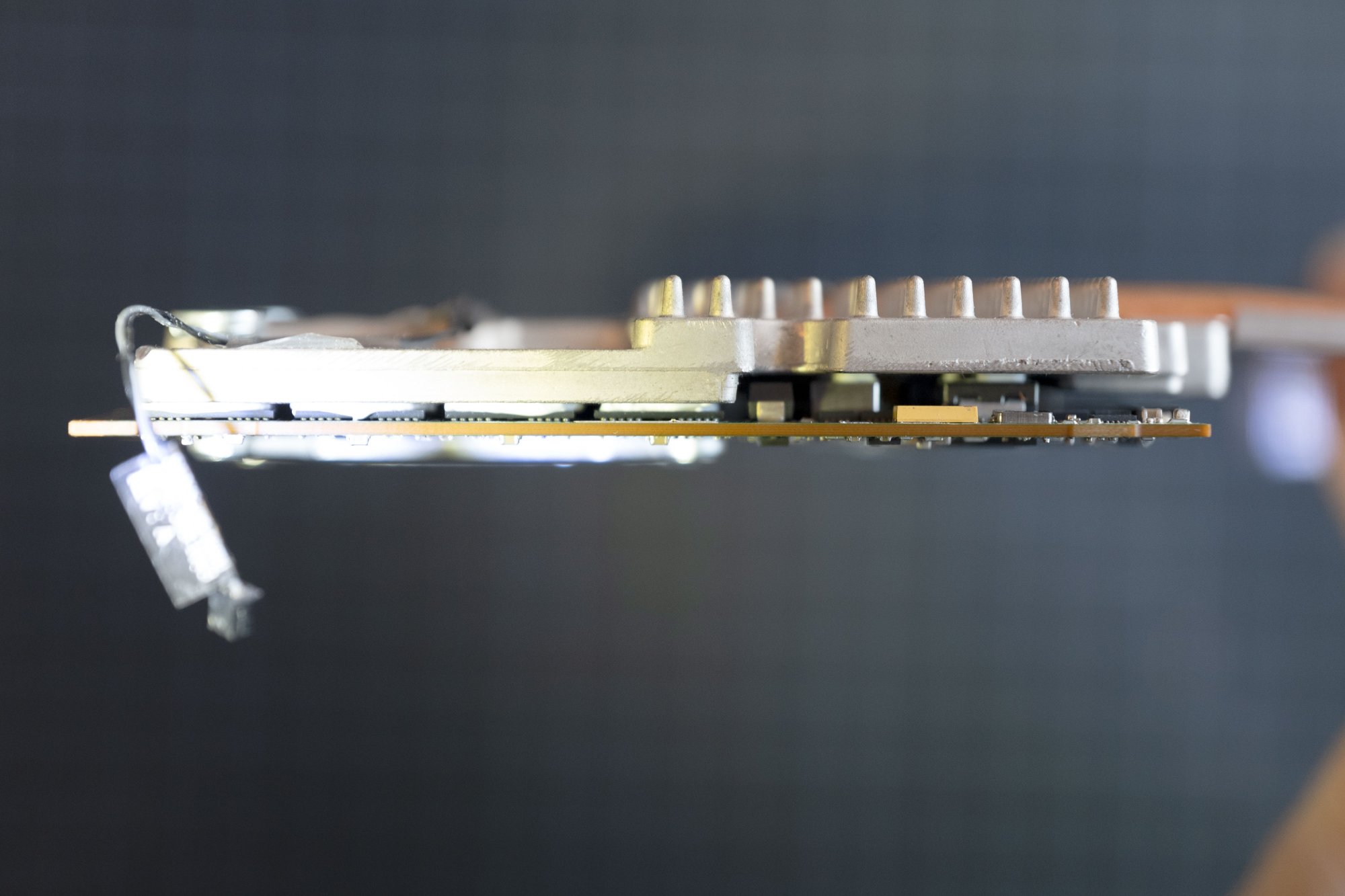

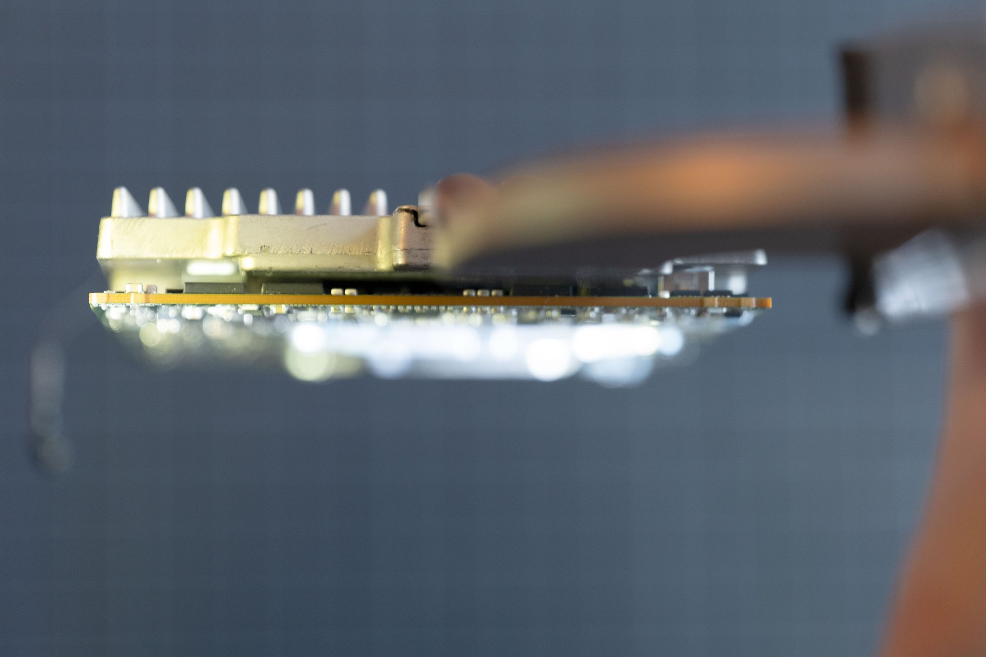

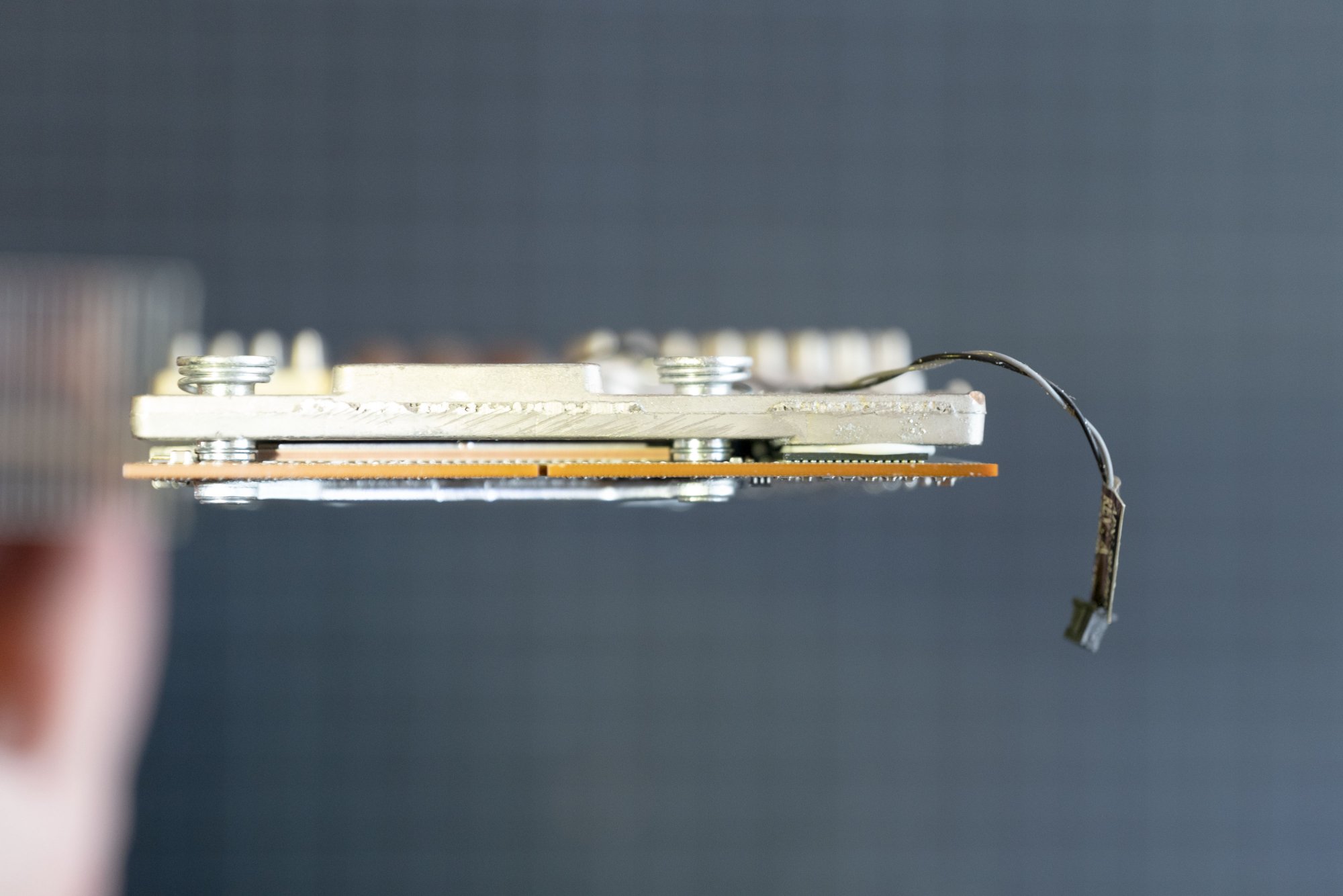

V. Heatsink modification​

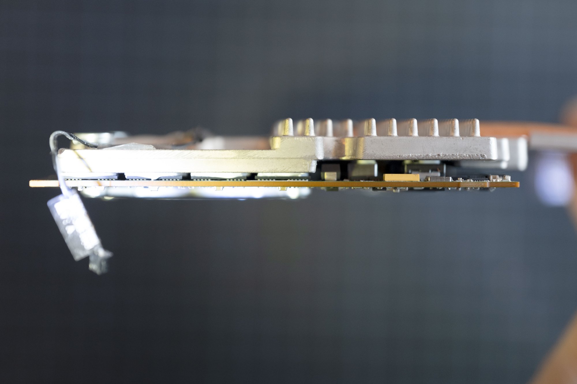

  1. Apparently the WX7100 does not require the modification, but I did it just to be sure. I used a Dremel 196 high speed cutter bit to remove a small section on the right side of the raised upper horizontal bar.

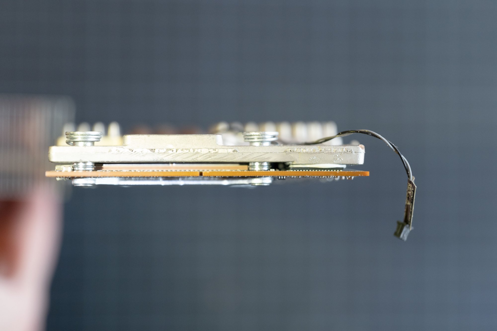

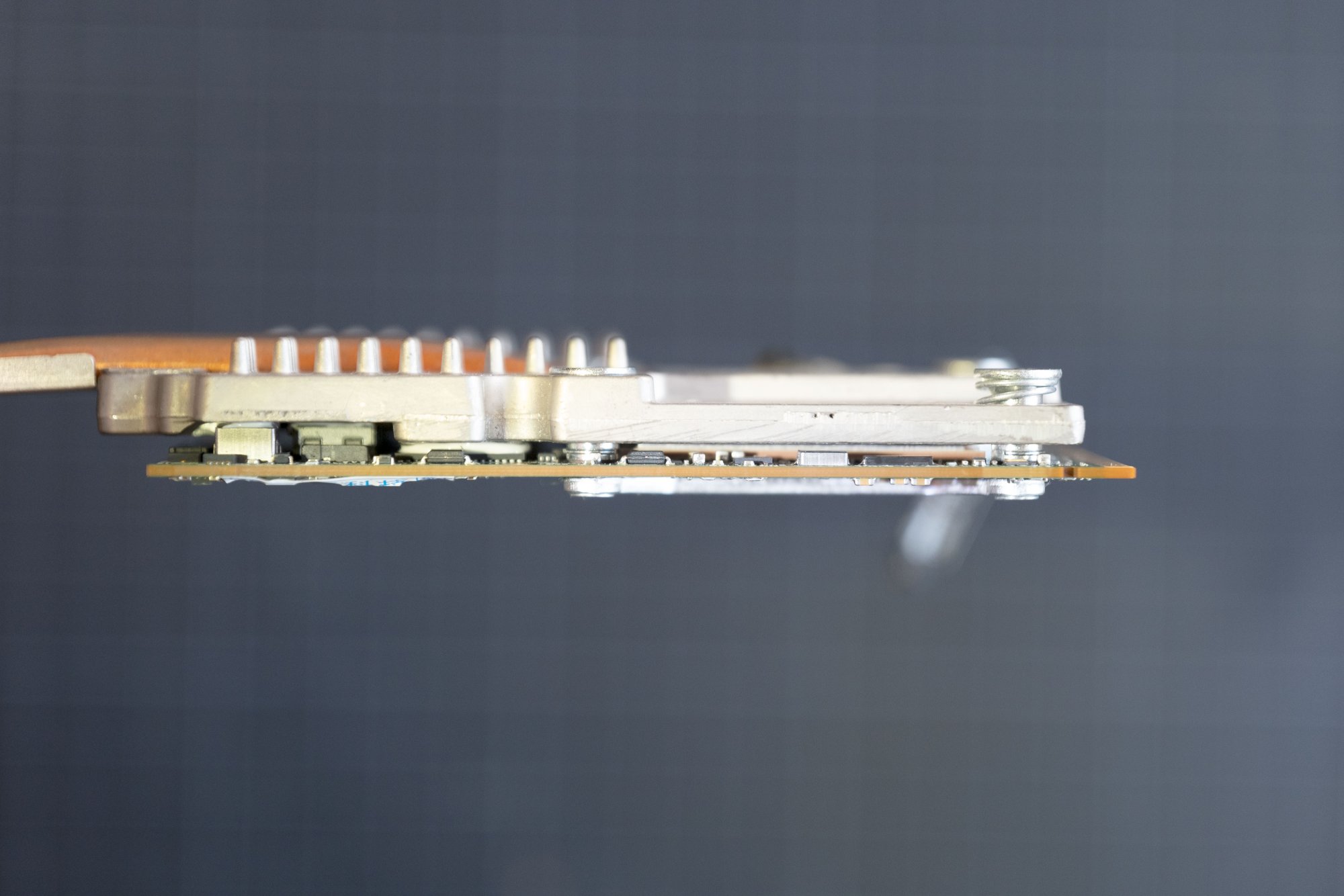

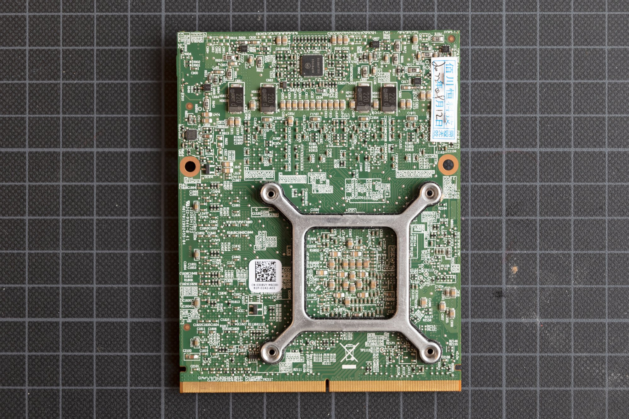

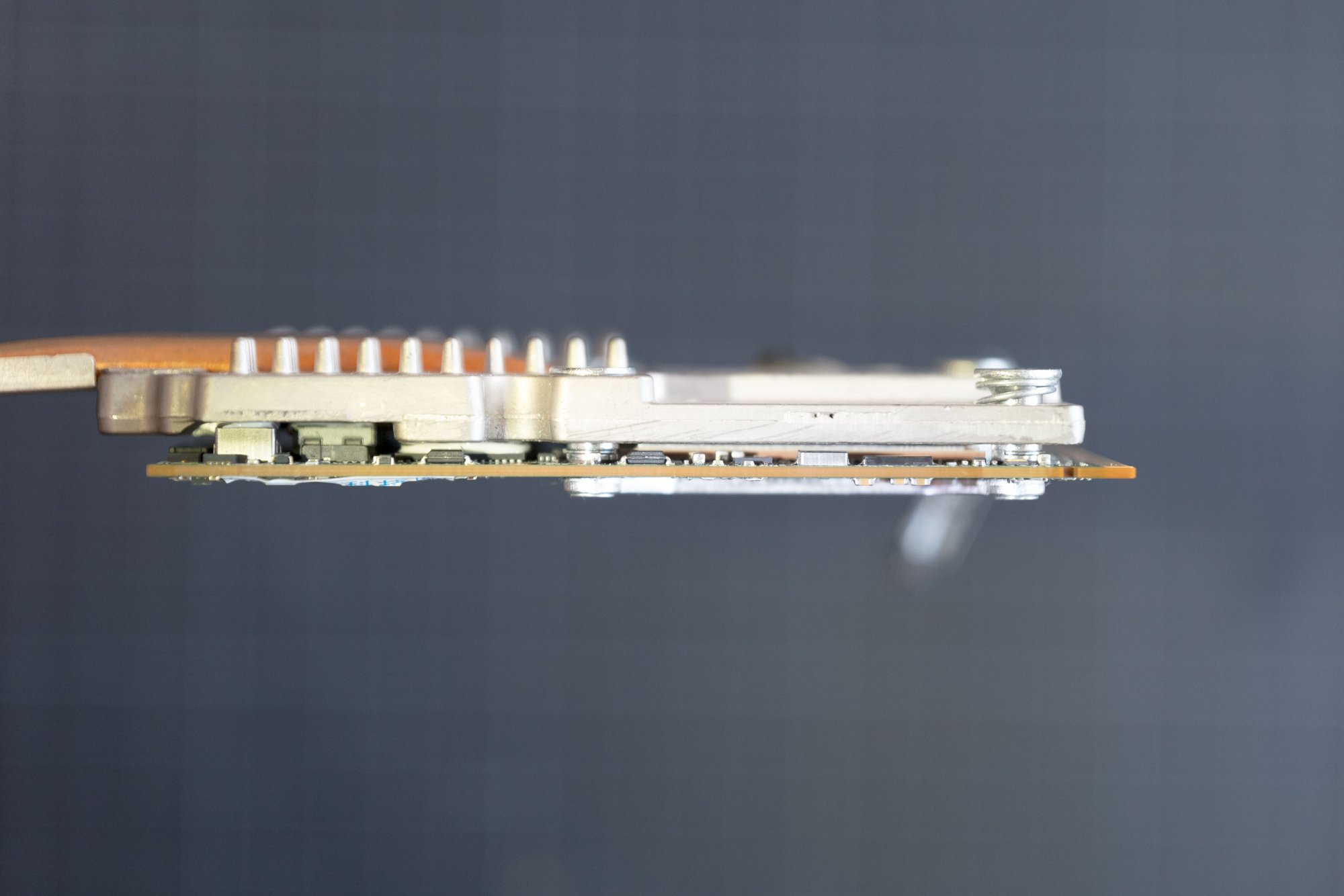

VI. About the X-clamp​
The x-clamp, which might be attached to your WX7100, will have little threaded inserts. You cannot use it with the heatsink, without either removing the inserts carefully or by modifying the heatsink.
In case you have the original X-Clamp, which was used by Apple for the AMD Radeon HD 6970M, or are able to source it, you should use this clamp instead. Remove the WX7100 x-clamp with a hairdryer and you are good to go.
As can be seen in the image: Apple's large X-clamp fits perfectly to the WX 7100.
(Apple's X-clamp above the WX 7100's x-clamp)

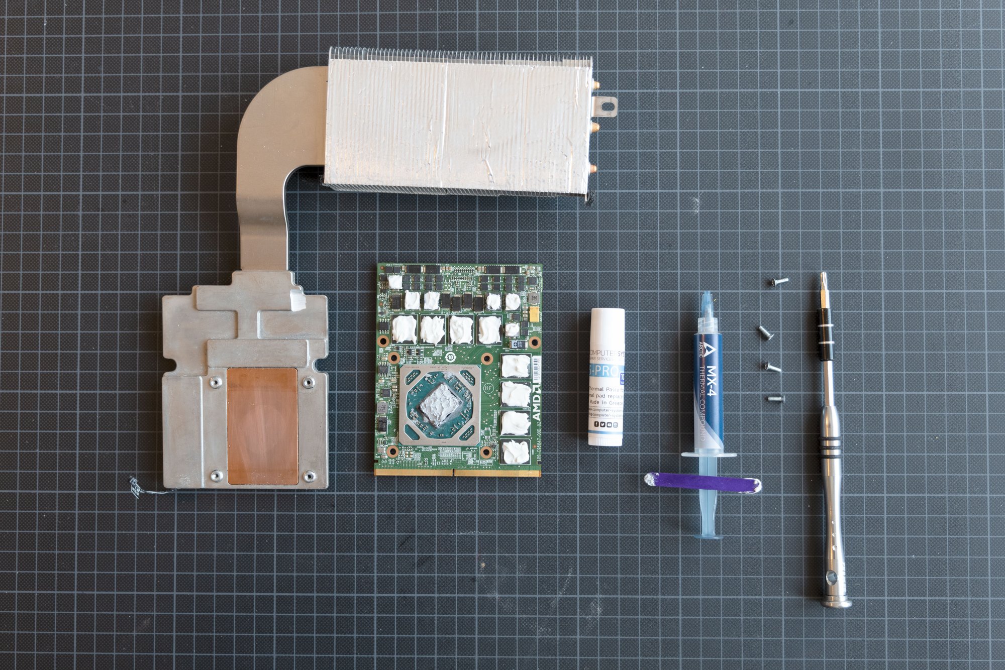

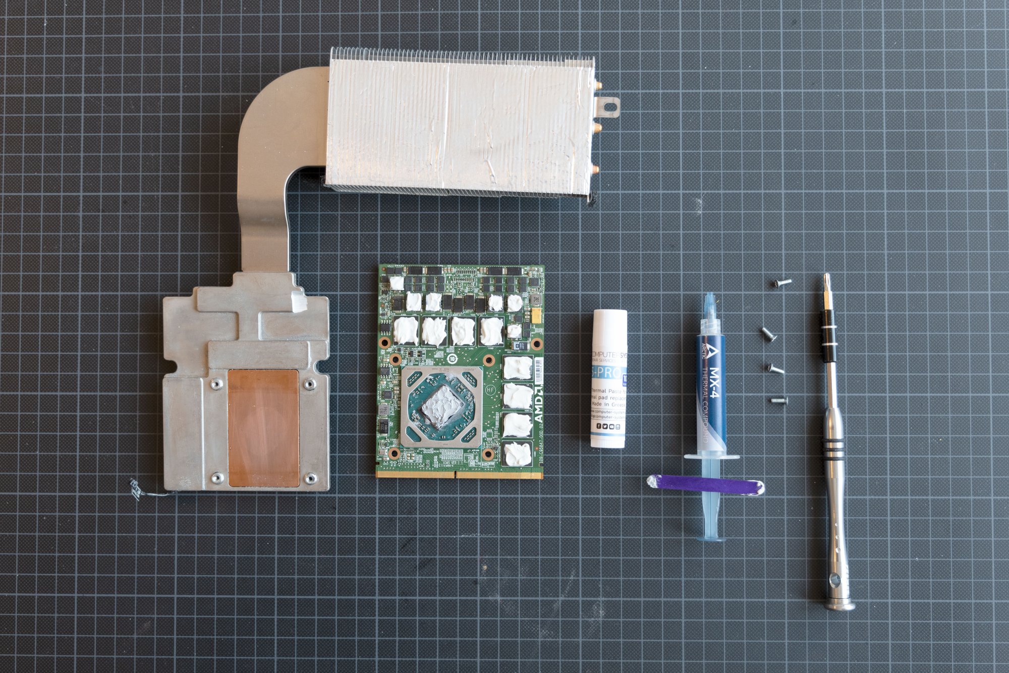

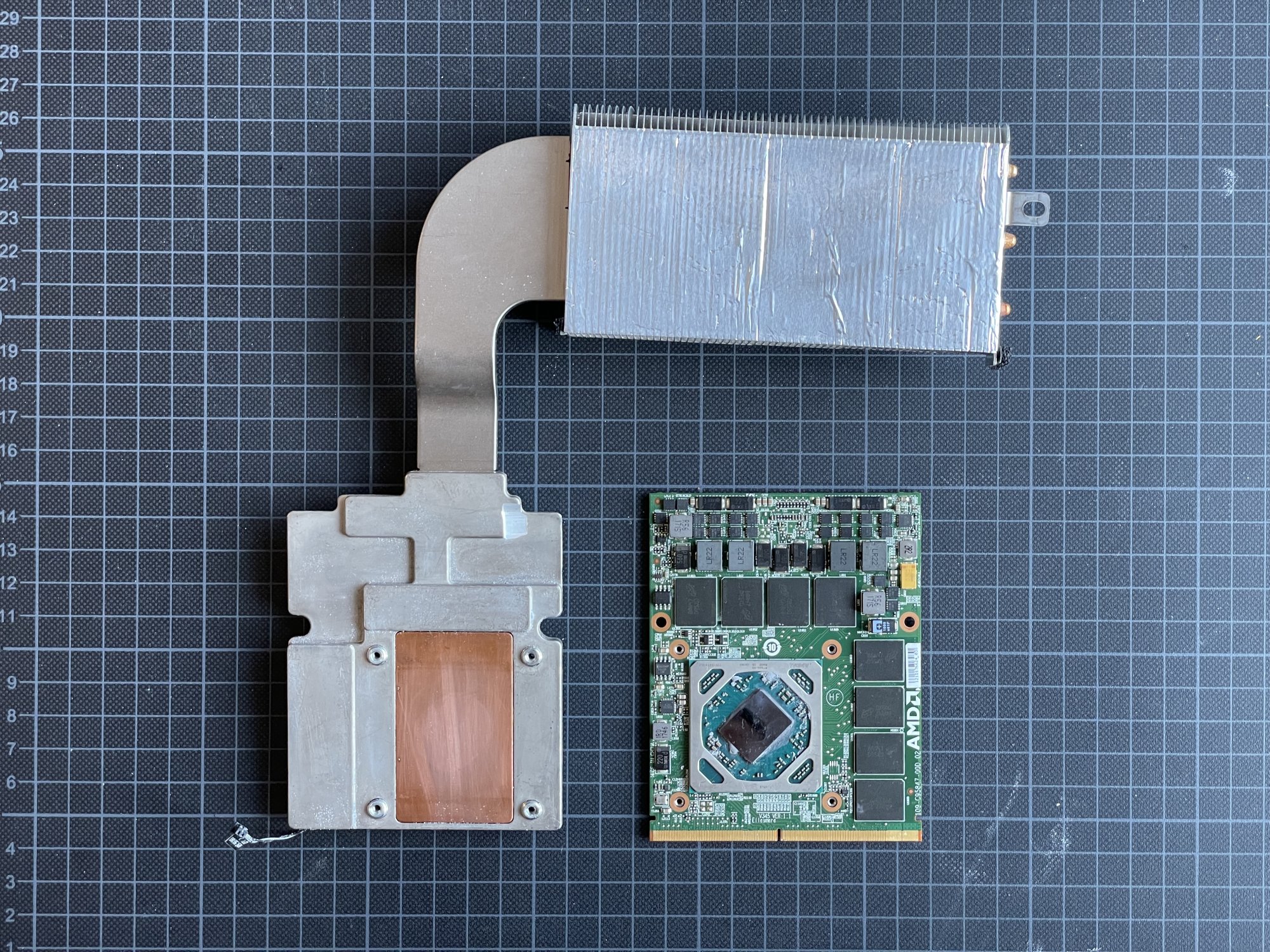

VII. Applying thermal paste​
Follow the instructions you find in the thread. On the GPU a pea sized amount of MX-4 is enough, the VRAM and the other chips need a higher amount (for example K5-Pro), since they have to touch the heatsink too.

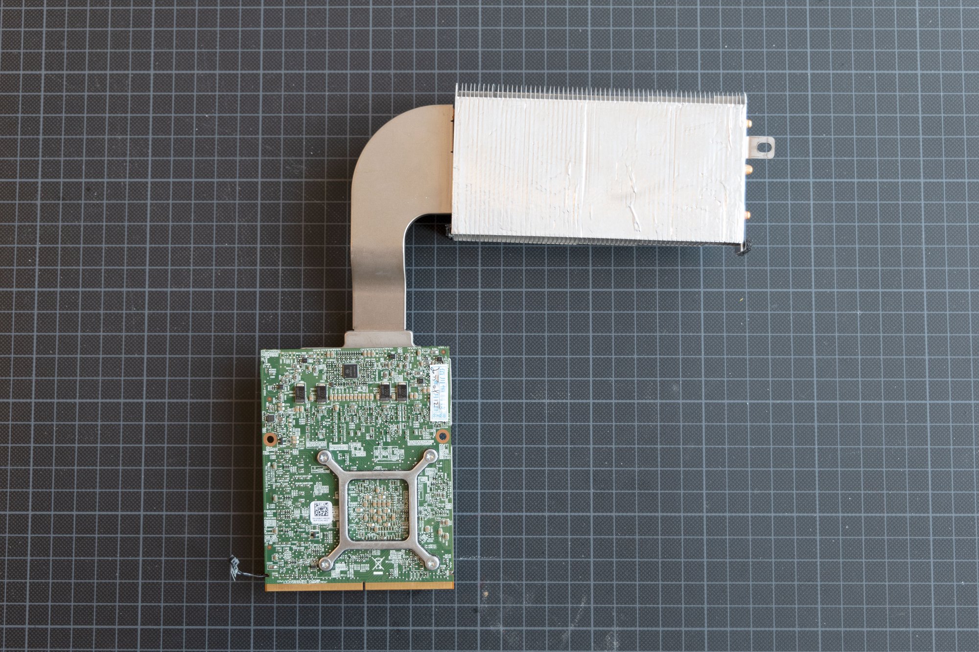

VIII. GPU-heatsink wedding​
  1. place the card above the heatsink
  2. fasten the card by following an X-pattern. For example: top left > bottom right > top right > bottom left > top left > bottom right > etc ...
  3. take turns and fasten the screws with each passage a little bit more (I fastend them finger-tight, which means until you feel, that the torque to turn them increases considerably. You should stop before applying more torque). Sometimes Apple specifies the moment of force, with which to fasten the screws of the heatsink, for example, in case of the Mac Pro 5.1's CPUs: 8 lb.- in. or 0.904 Nm torque ;0). In the case of this installation the finger-tight rule should be sufficient and is what I encountered in the thread.
  4. check your work

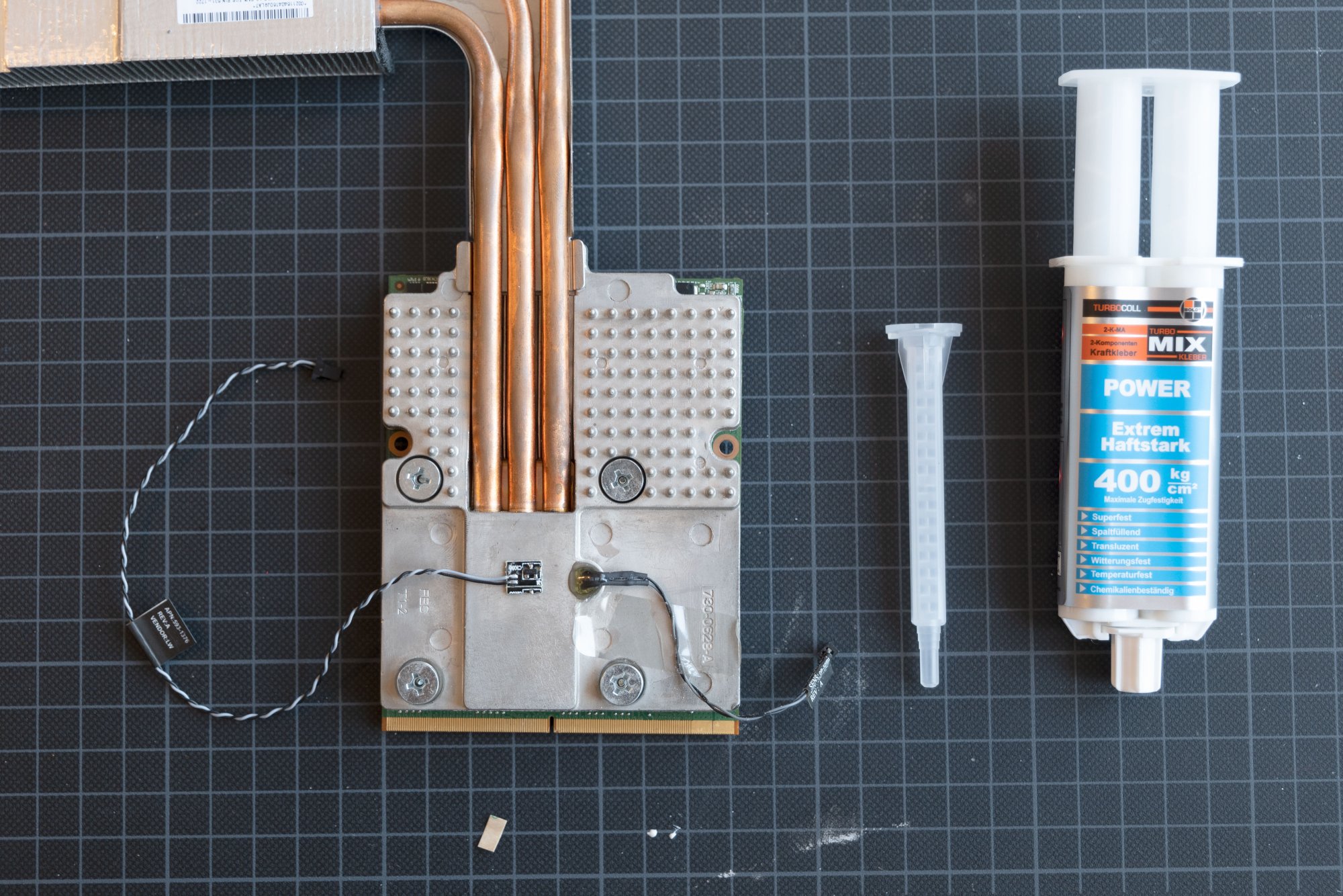

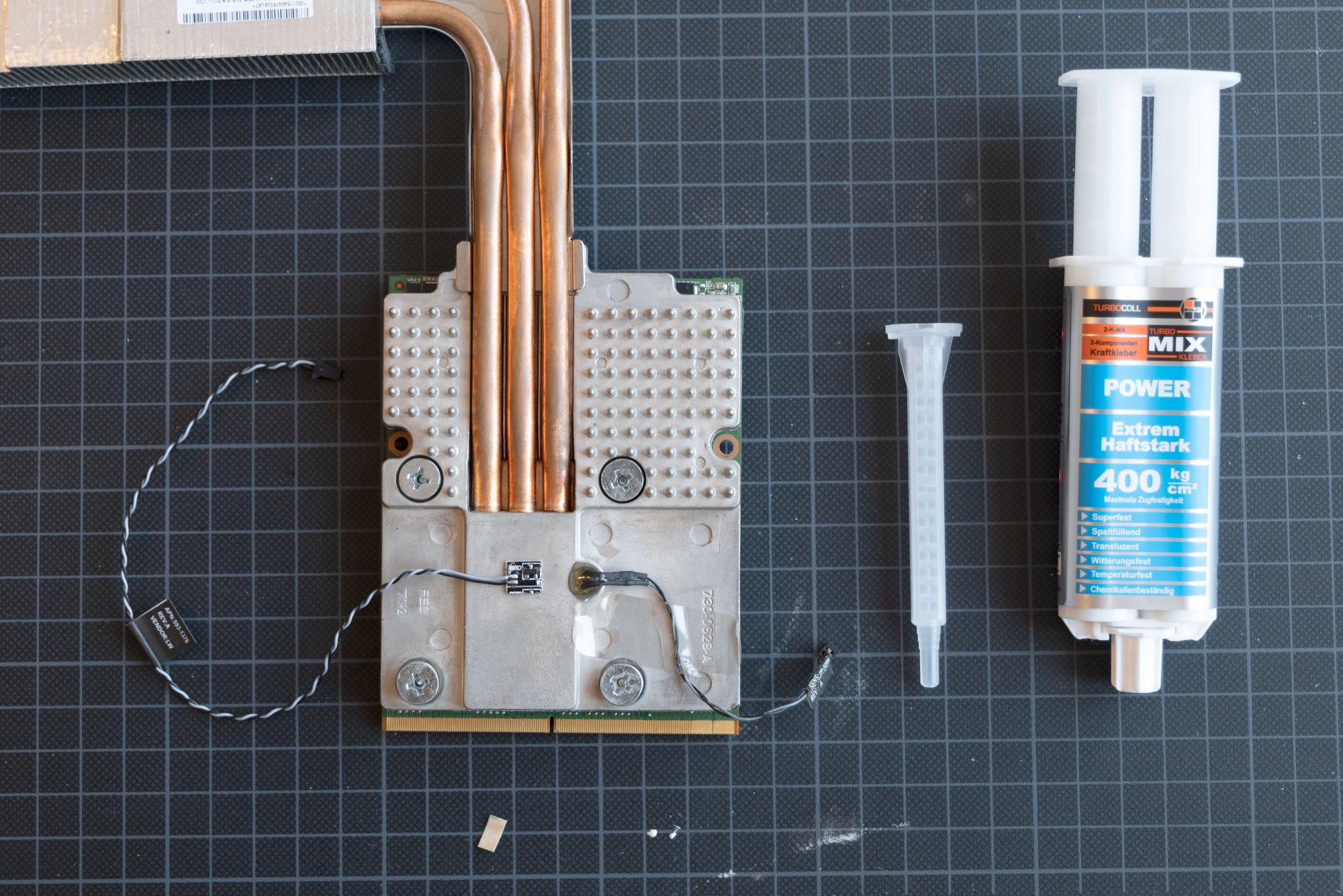

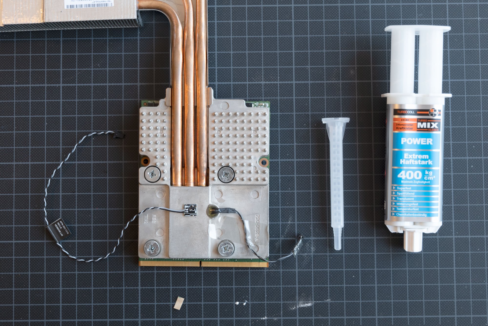

IX. ODD sensor mod​

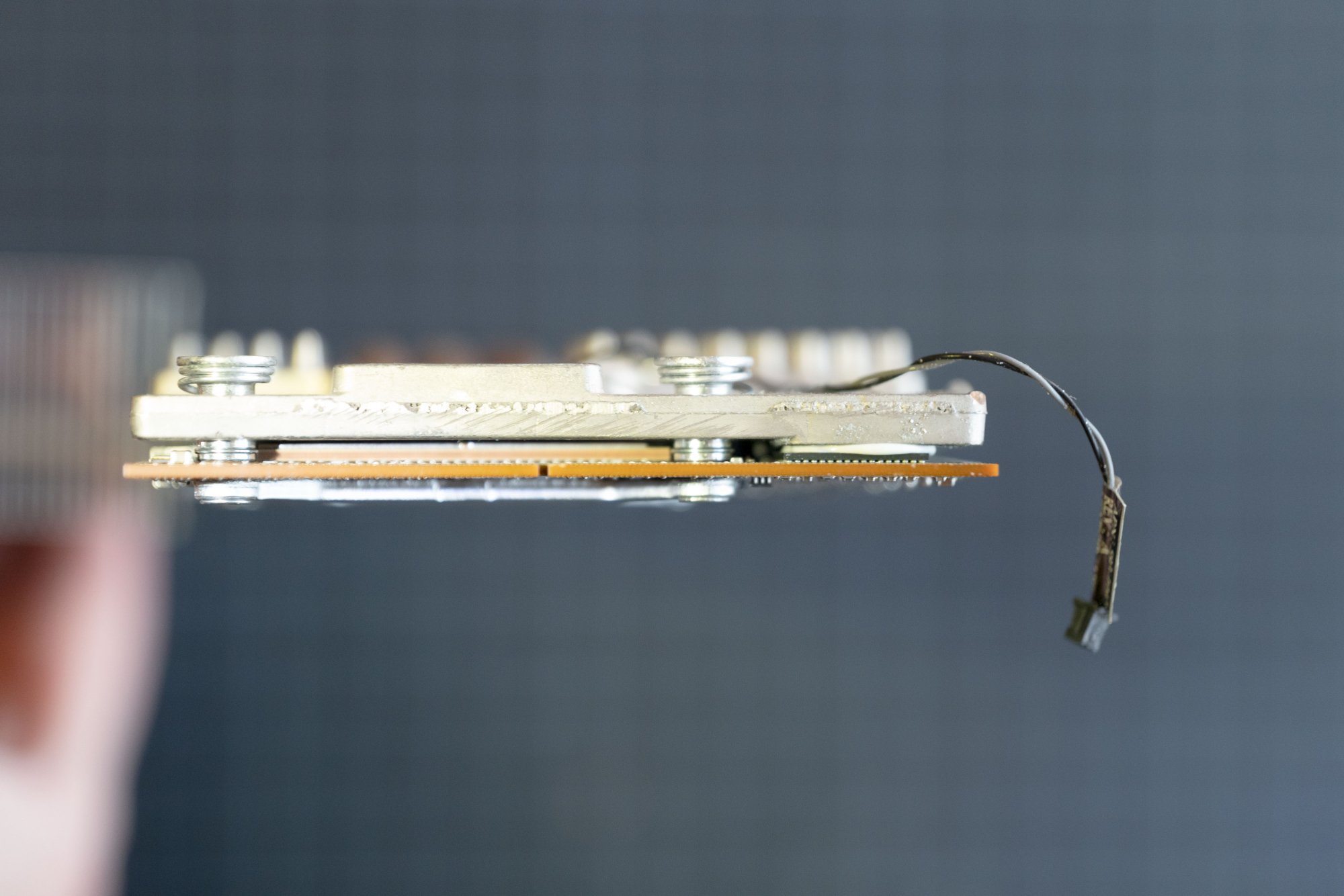

Attach the ODD sensor with some glue. It has to be heat resistant. I used a two-component adhesive, which checks all those requirements. I got all the information about it from this post.

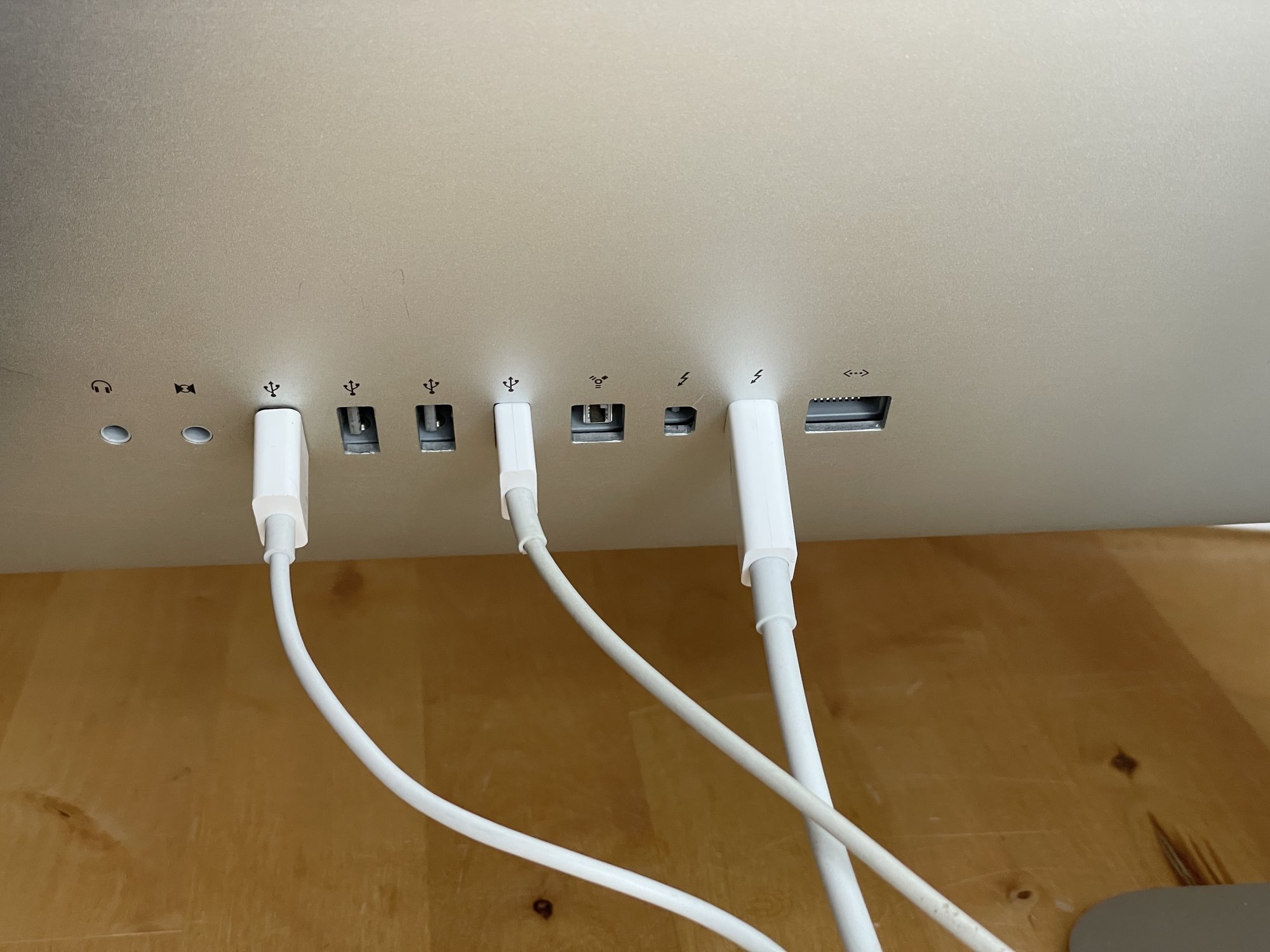

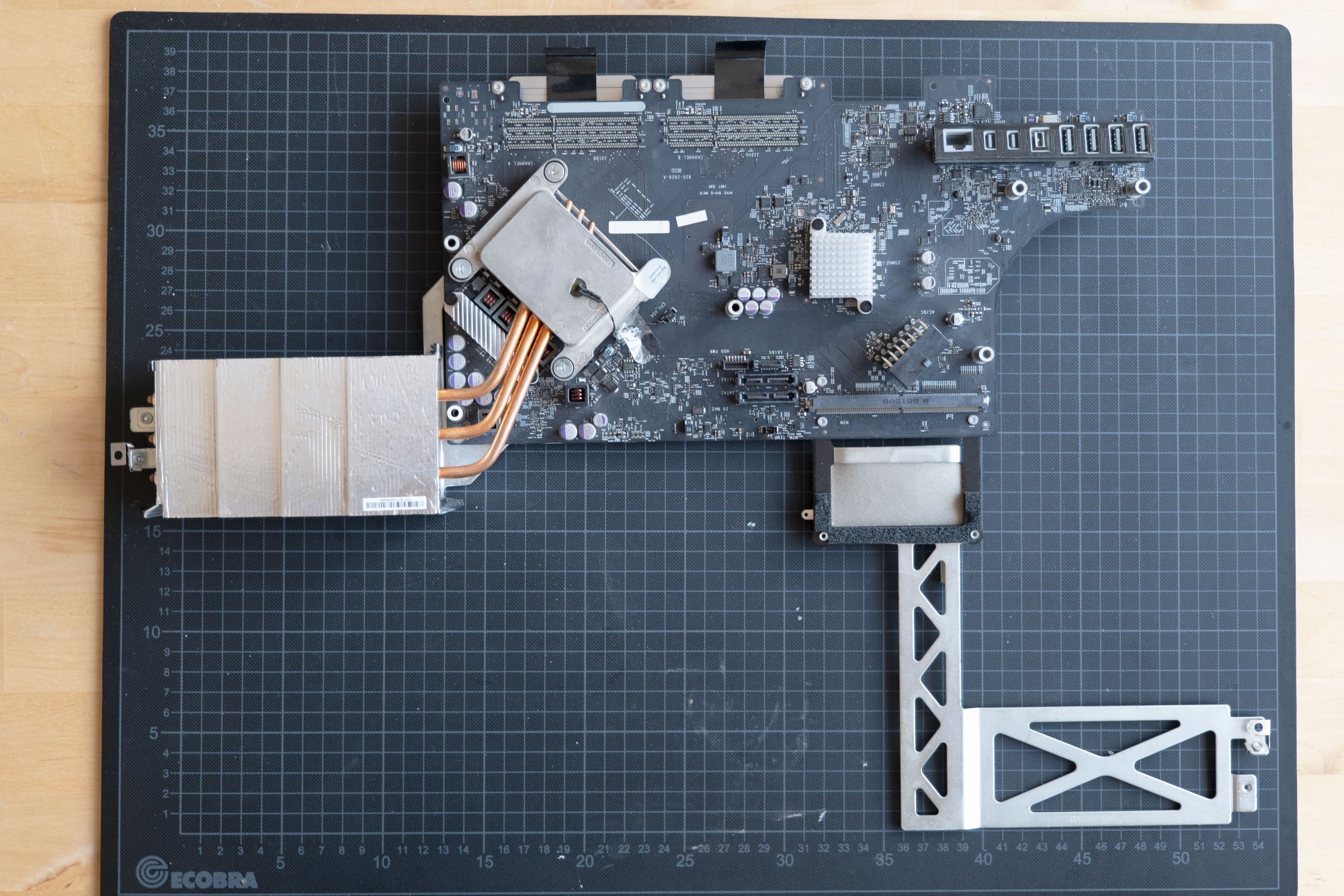

  1. follow @Ausdauersportler's advice and remove the metal-cage from the motherboard for this step. This way you can do your tests without having to remove the motherboard continuously.
  2. assemble everything and connect all cables. At this stage you do not need to fix all screws, the ones which are near the interface sockets are an option for fastening in order to being able to:

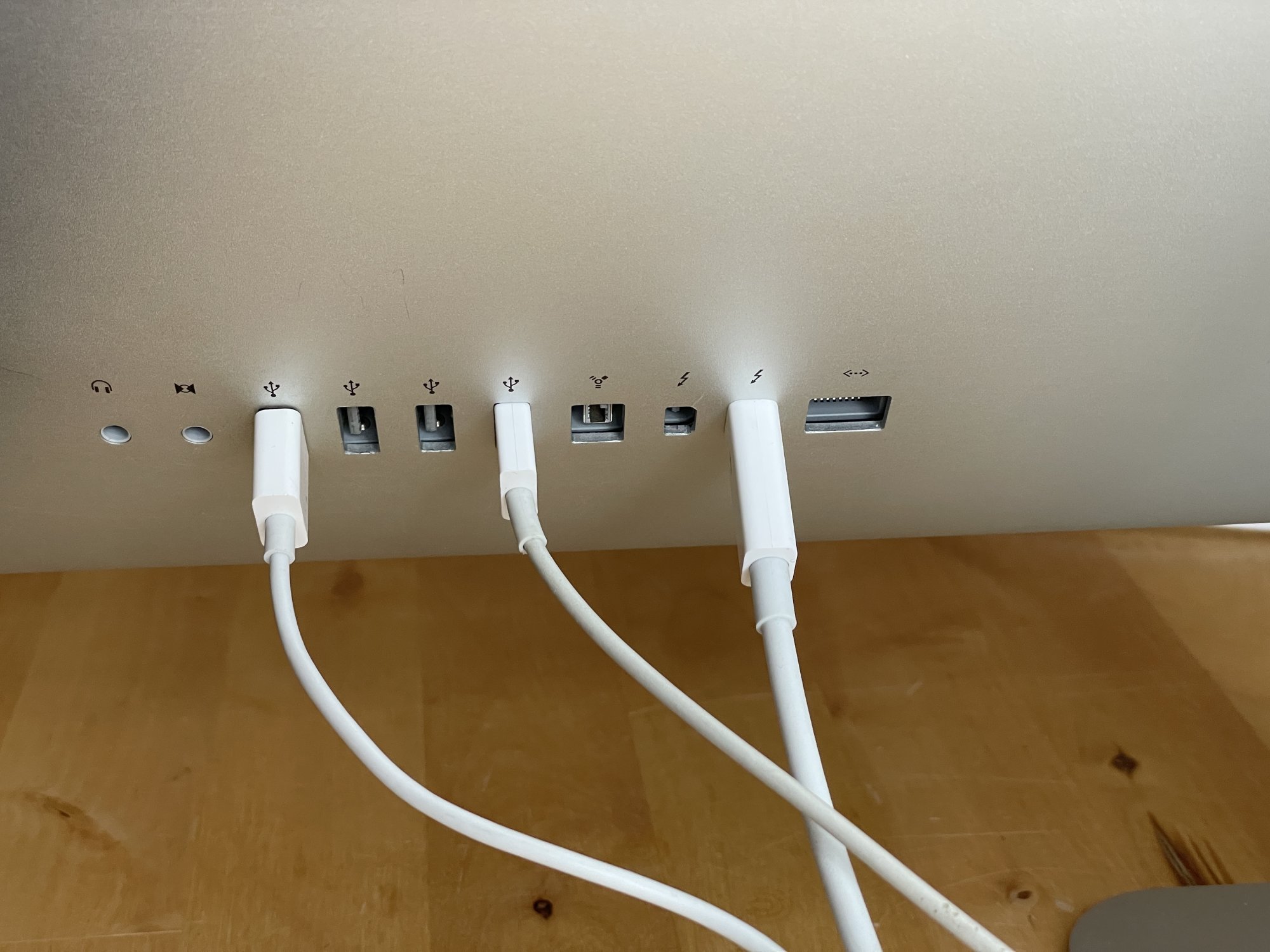

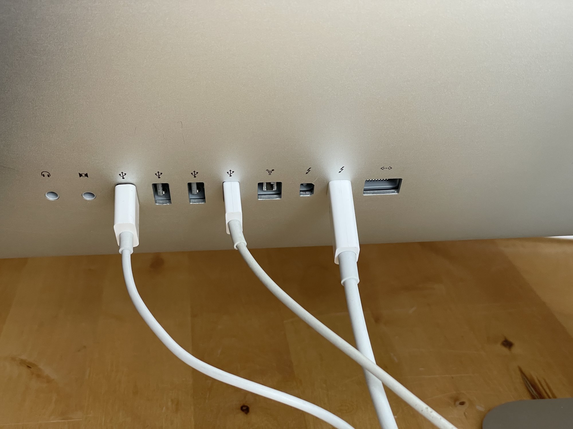

  3. connect an external display via a mini display port connector to the thunderbolt port next to the firewire port.

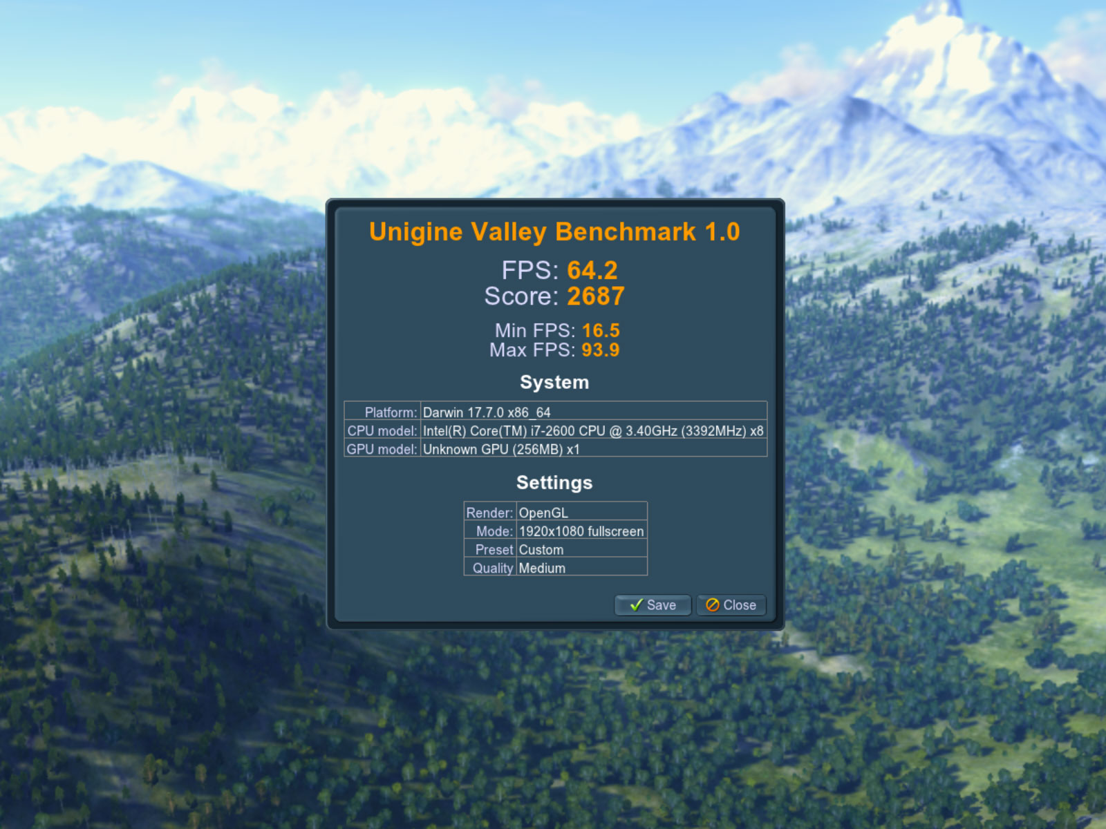

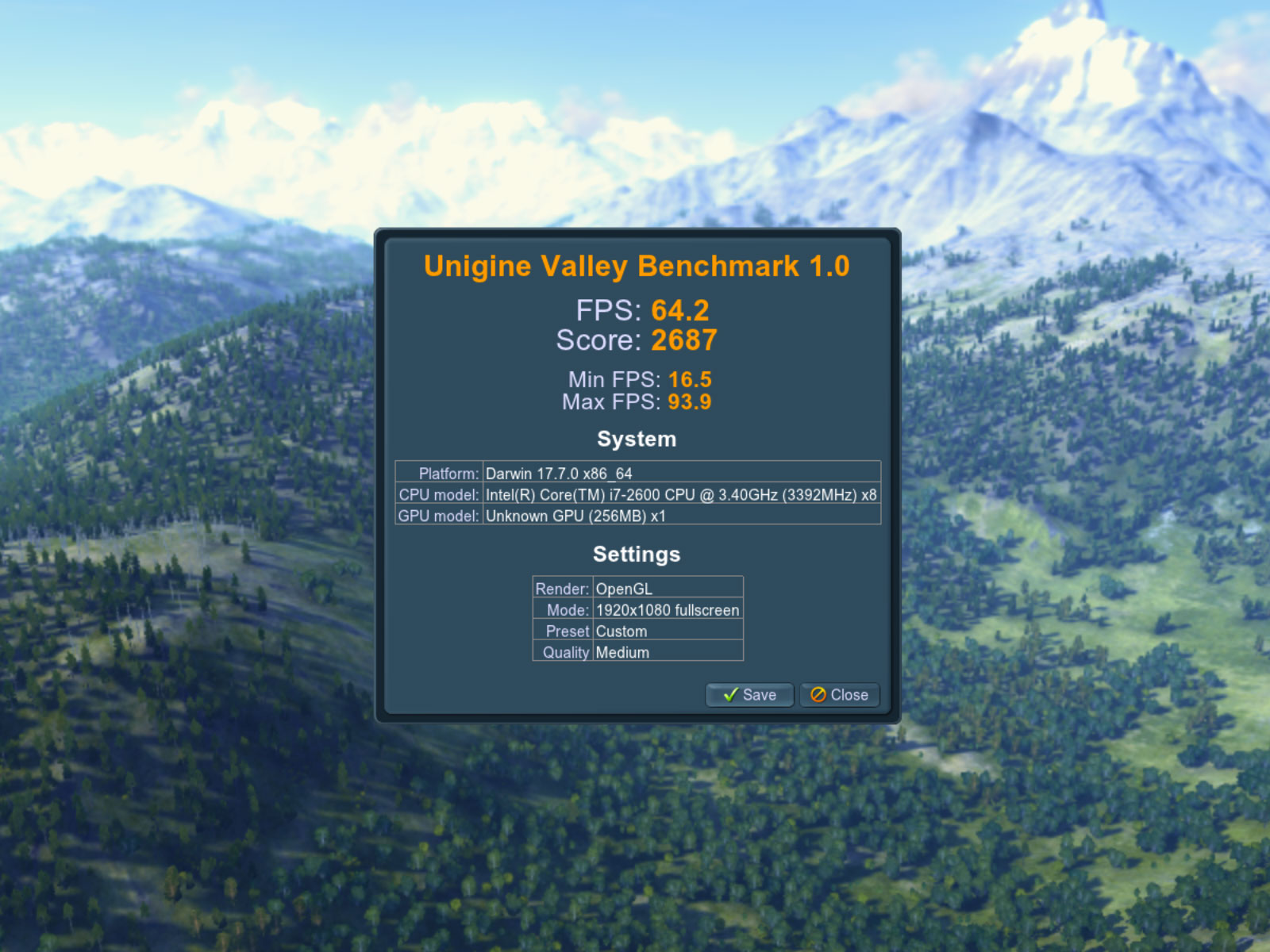

XII. Benchmark and stress-test​
  1. follow the information in post #1 to test your card, for example by running Unigine Valley for same time.
  2. Benchmark your card and setting
  3. post your results through the links in post #1
  4. now it would be a great point to invite those who helped you for a bear or glass of wine. I, for my part, am a highly educated person with an design, engineering and informatics background. I know my stuff and love to push my knowledge continuously to new areas, but without this thread and all the great people, who know so much more than I do about this field, came up with all the solutions and invested so much time, I wouldn't have come to this point! Respect!
Post-Install​
My machine starts and the GPU works, thanks mostly to the help by several amazing participants in this threat!!! Brightness control works, Option key on startup brings up the boot selector (modified bootROM). In High Sierra the boot screen is not shown, which is normal and means that upon start you immediately get to the login screen. Wake from sleep is working. Through the ODD-sensor mod Apples SMC adjusts the fan speeds of the ODD-fan according to GPU heatsink temperature. I could have gone only with my installed aftermarket solution, but to apply the mod seemed to me a sensible backup.
I was able to run Unigine Valley and Geekbench 4. Furthermore, I was able to run Geekbench 5 CPU and OpenGL benchmarks, but the Metal benchmark of GB5 does crash right before finishing. I suspect and hope that this has only to do with High Sierra. I will report back, once I eventually run OCLP and a more modern macOS or get more info about the reason for it crashing.

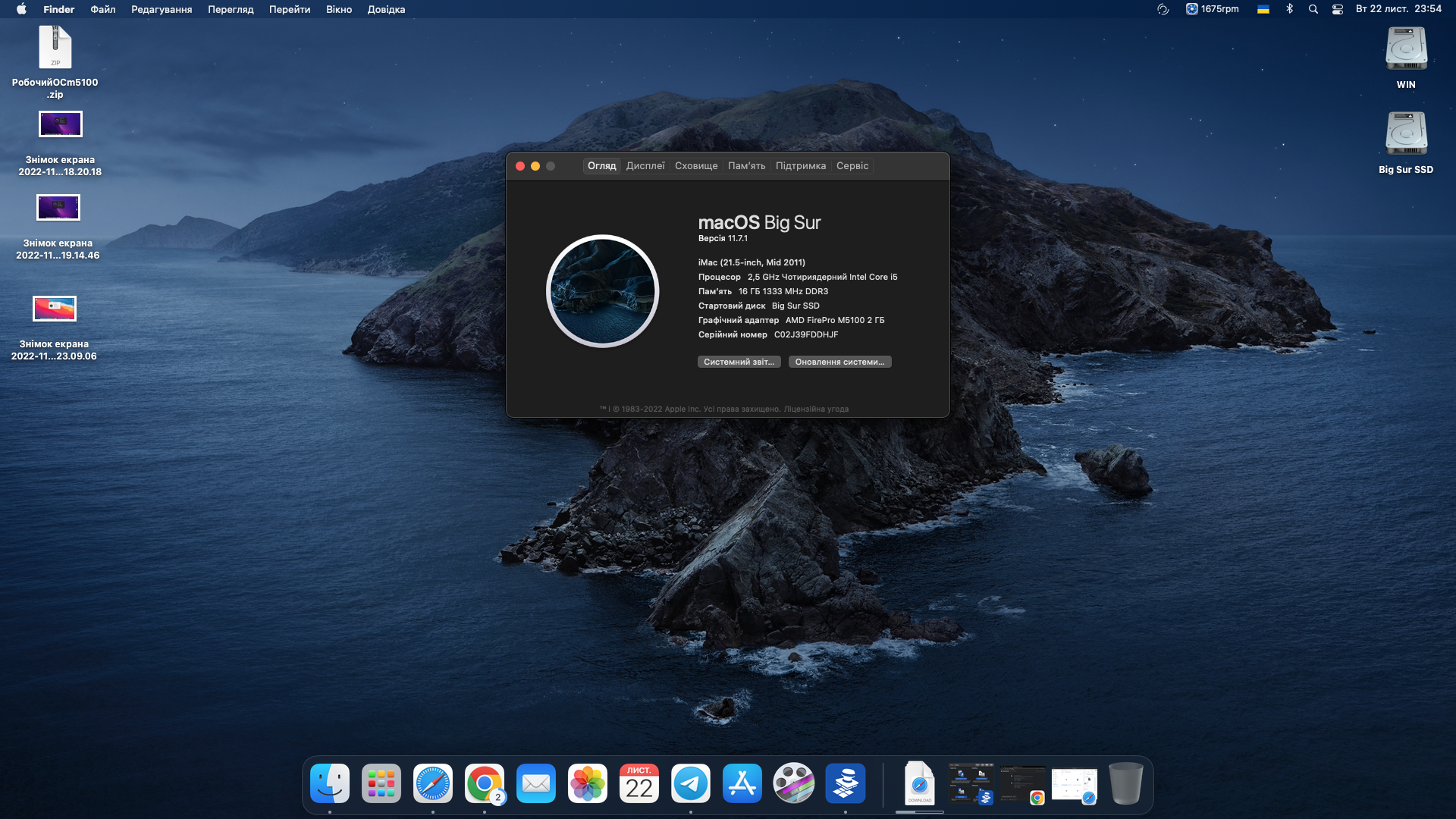

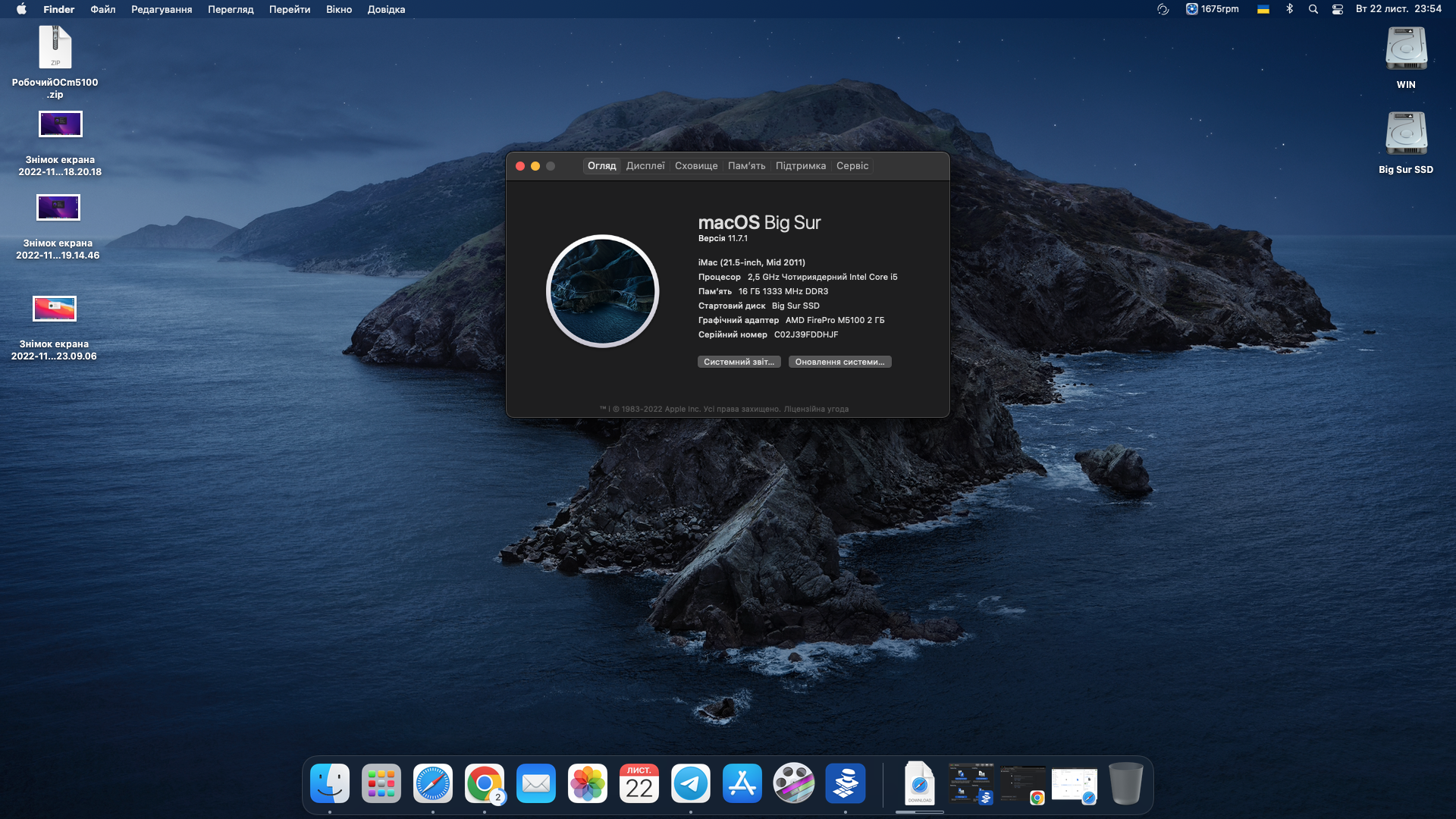

Hi to all) I created a RESCUE DISK, I want to check it, but when I turn off the imac, turn it on and reset the PRAM, start with the C button pressed, the Opencore that is on the SSD and not on the SD starts, to check, do I need to remove Opencore from my SSD? Tell me who knows)
Most likely there was an issue along the way, like file paths or writing method. It's veeery common (I actually gave up making my own rescue CD because I couldn't get them to work after wasting like 4 cds...)
