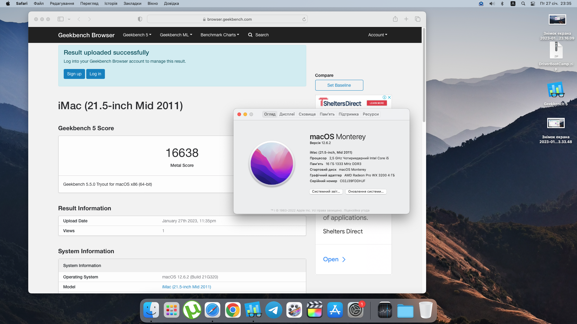

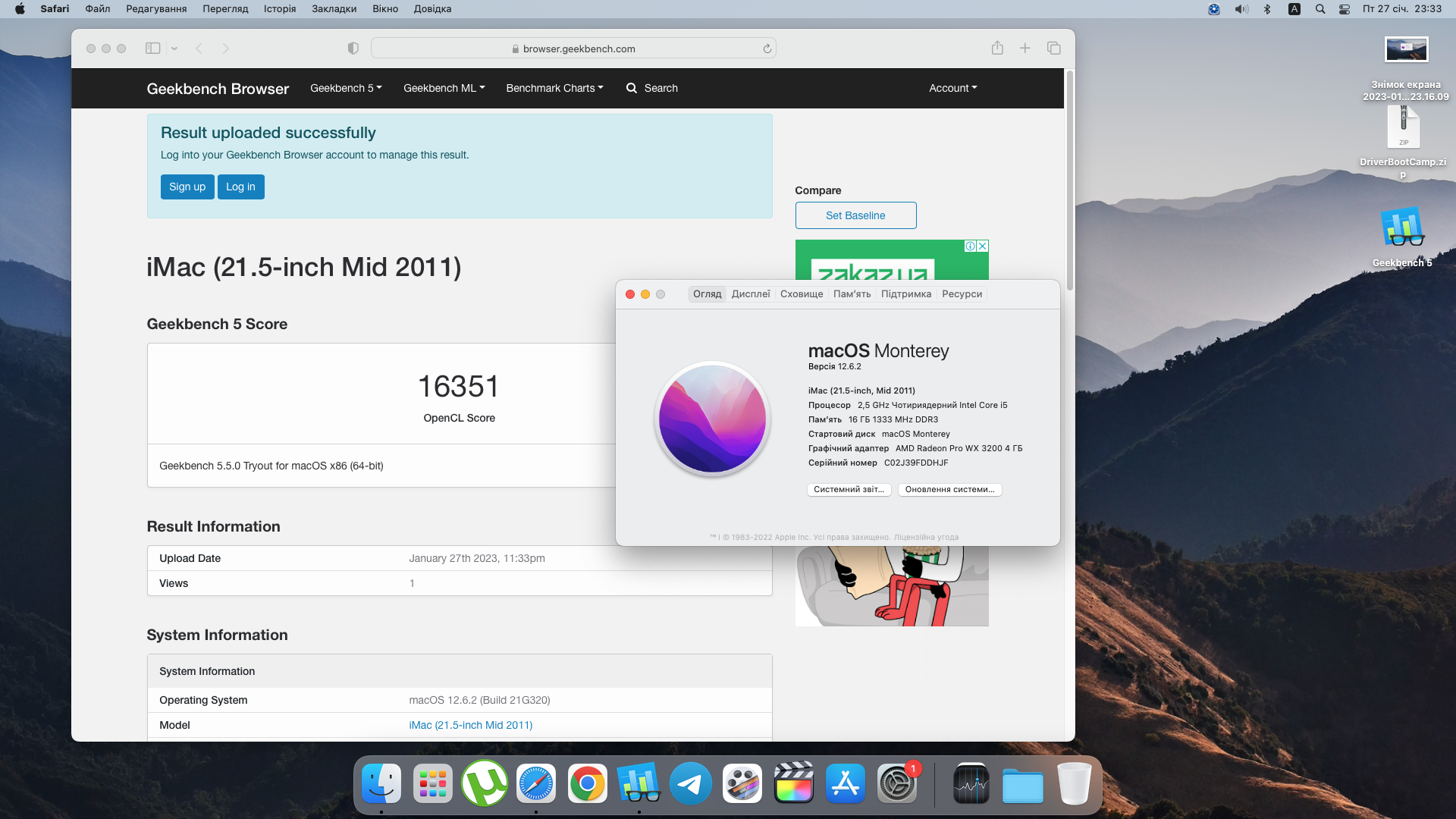

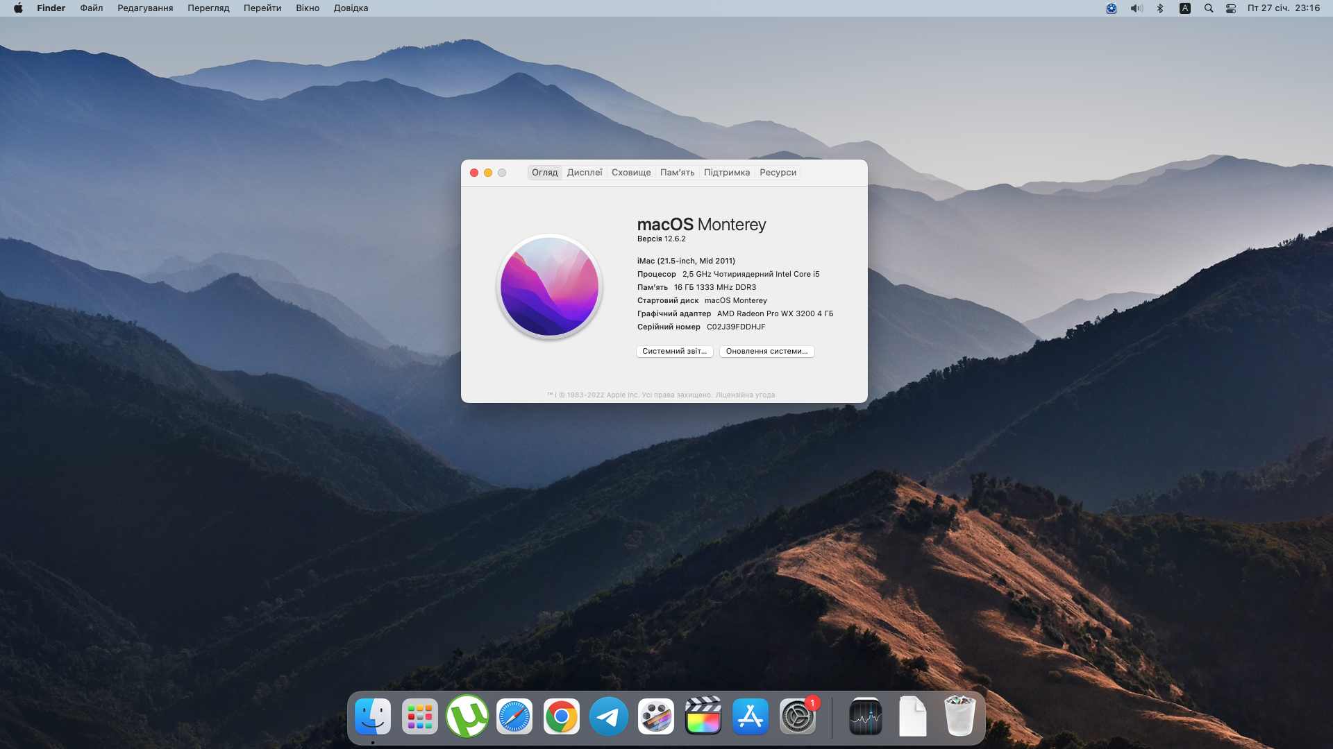

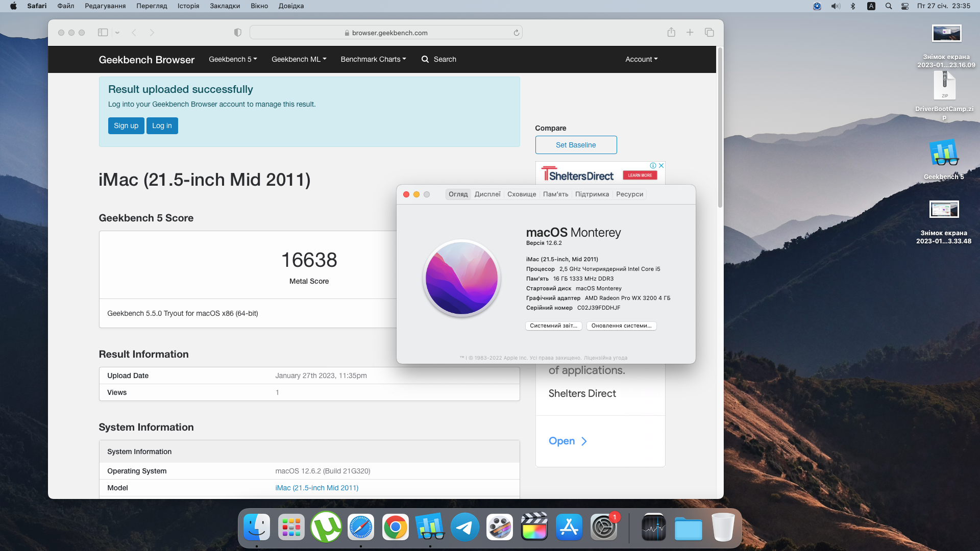

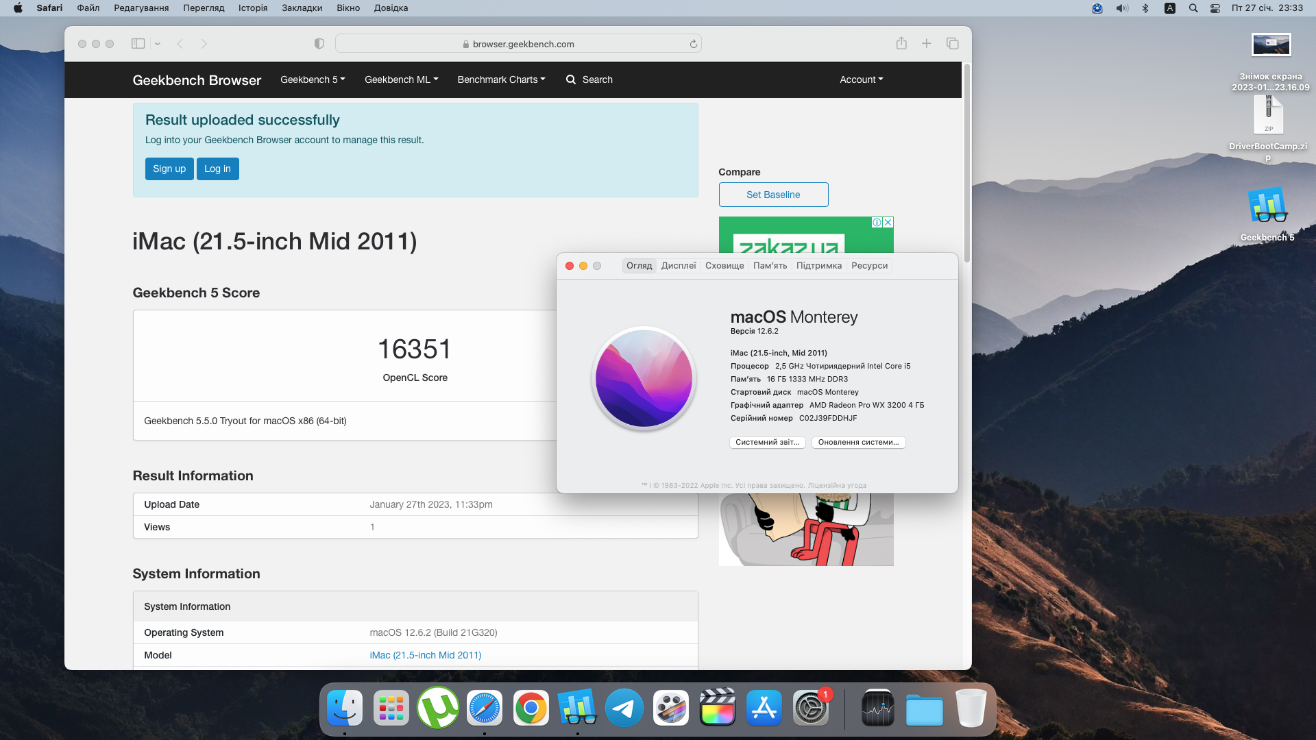

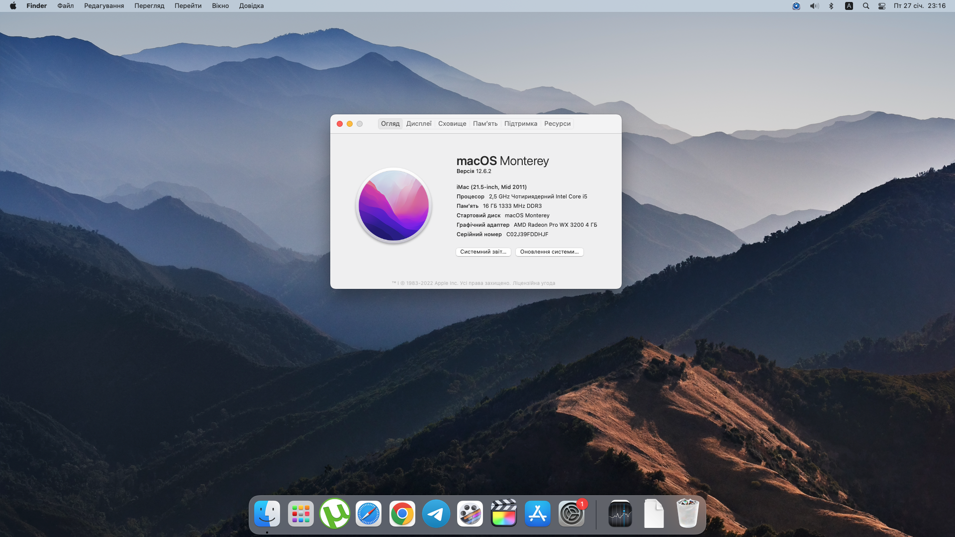

hello guys) I updated the video card in iMac 21 mid 2011 to Amd Radeon Pro WX3200 4gb bought on Aliexpress for $95, everything works perfectly) I am attaching some tests)View attachment 2149261View attachment 2149262View attachment 2149263View attachment 2149264
if anyone needs it, I can provide a link to the seller on Aliexpress, the cards are as indicated by him new, and the price is $100, immediately stitched and ready for installation) if you write something)
Reactions: SEJU

hello) it's not difficult, you don't need to make modifications, you just take the old one and put a new one 😉 before installing in the Efi folder of the bootable disk with macos, you need to write Opencore Legacy Patcher, the seller will provide you with a cable for the desired image, you only need to write it, and after replacing the card, everything will start without problems) there is no need to rearrange the system) by the way, it works perfectly with Windows, games they work, everything is great) you just need to disable the processor graphics, the instructions are here)

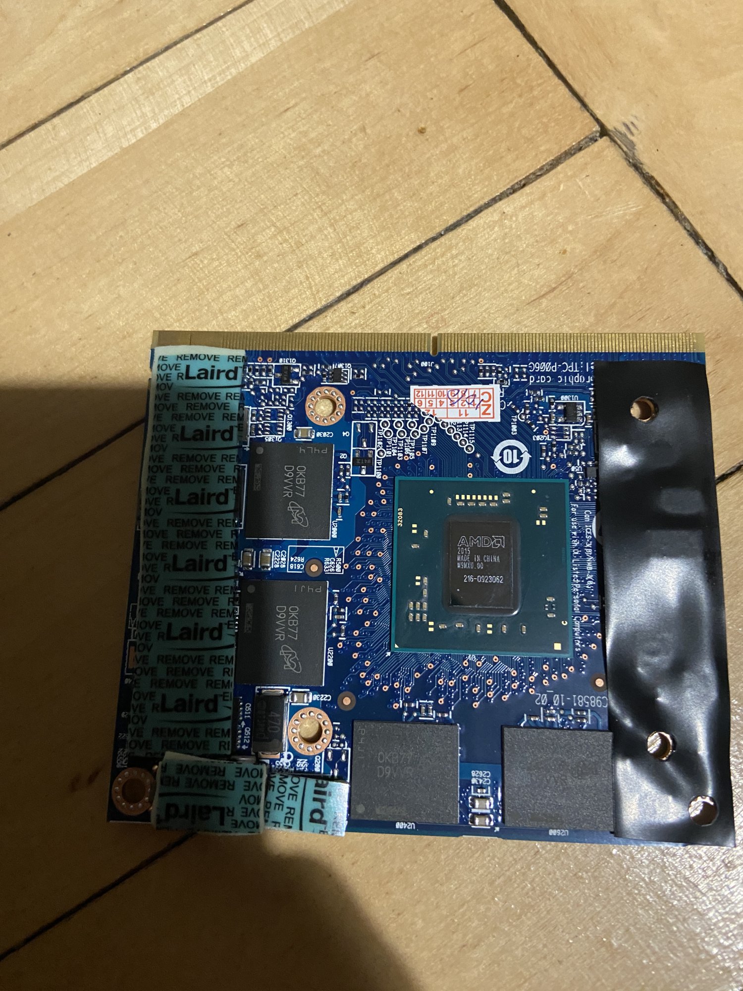

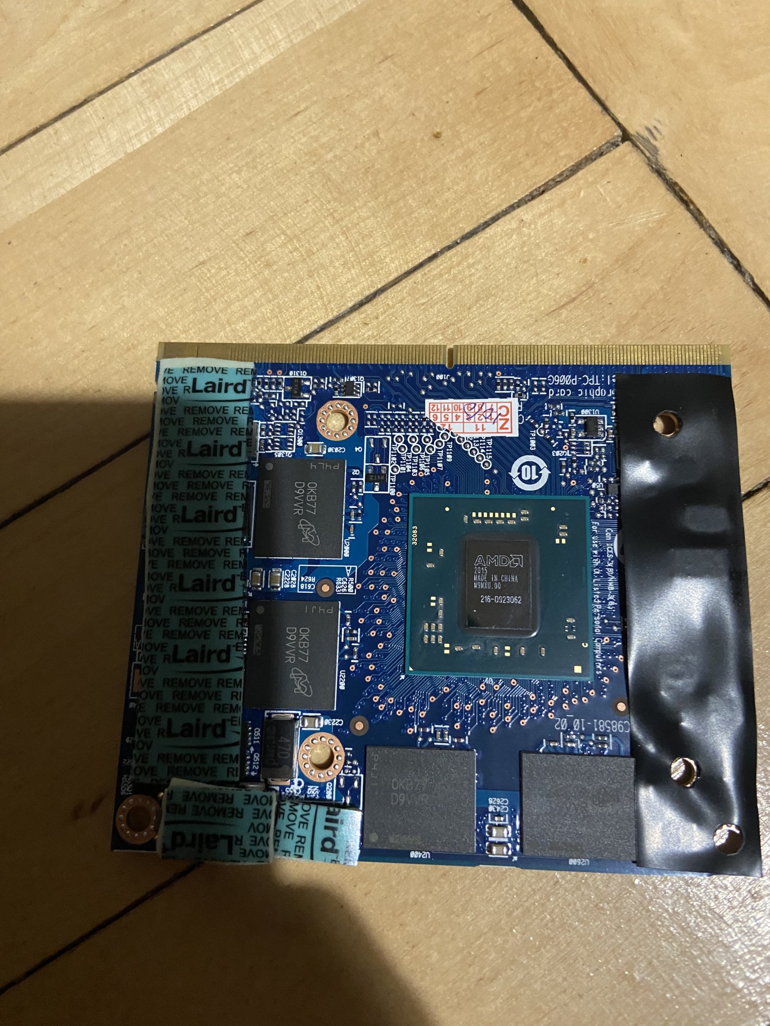

Have a nice day, everyone.I have an imac 27 2011.I bought an Amd m6100.When starting the imac, the screen is black, there is a system startup sound.But 3 LEDs are not lit.Does this mean that the m6100 is faulty?Or do I need to flash another vbios?

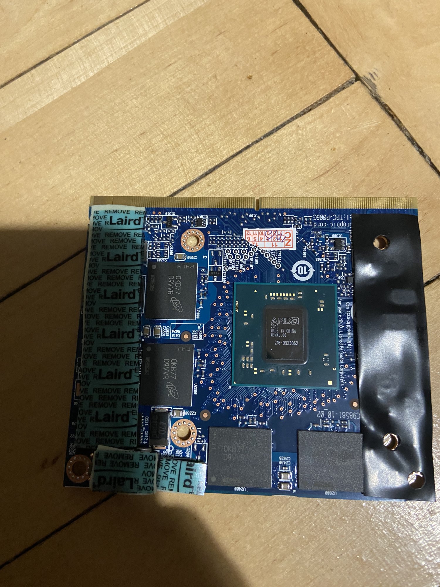

Experimental AMD M6000 2GB support (AMD Radeon R9 M370X 2GB)
TypeidentBIOS versiondevice-idworking
Blue AMD PCB109-C42251-00BM60006825yes
This GPU will be identified by the macOS as AMD FirePro M6000 and by MetalBench and GeekBench5 as AMD Radeon R9 M370X. The current vBIOS supports Hynix video memory.
Warning:
This card is easy to install but complex to manage during the initial software installation.
You need to install OpenCore in advance and add the changes posted before booting into macOS.
The card will not boot into macOS without the adjusted CAIL values in the config.plist.

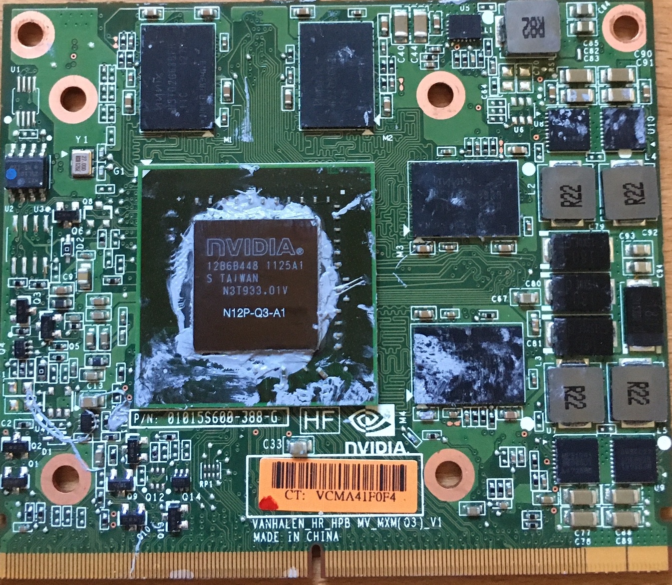

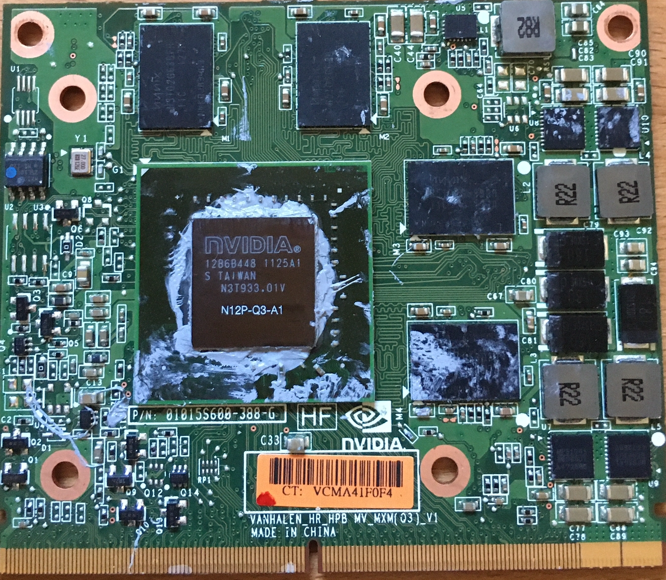

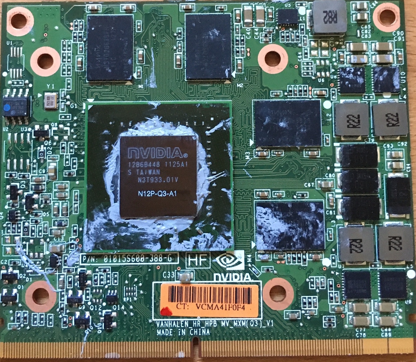

Hello,
After numerous intents to flash this card with the SSH-method, I suspect my card is not the Nvidia K2000M card (see attachment). Could anyone help me confirm that the card is or is not the Nvidia K2000M?
Thanks in advance.

Hello,
Thanks in advance.
Regards
The pictures show an Nvidia 2000M, while you need the K2000M - easy to confuse those two, but the K means Kepler and is the most important part of the name for us.
