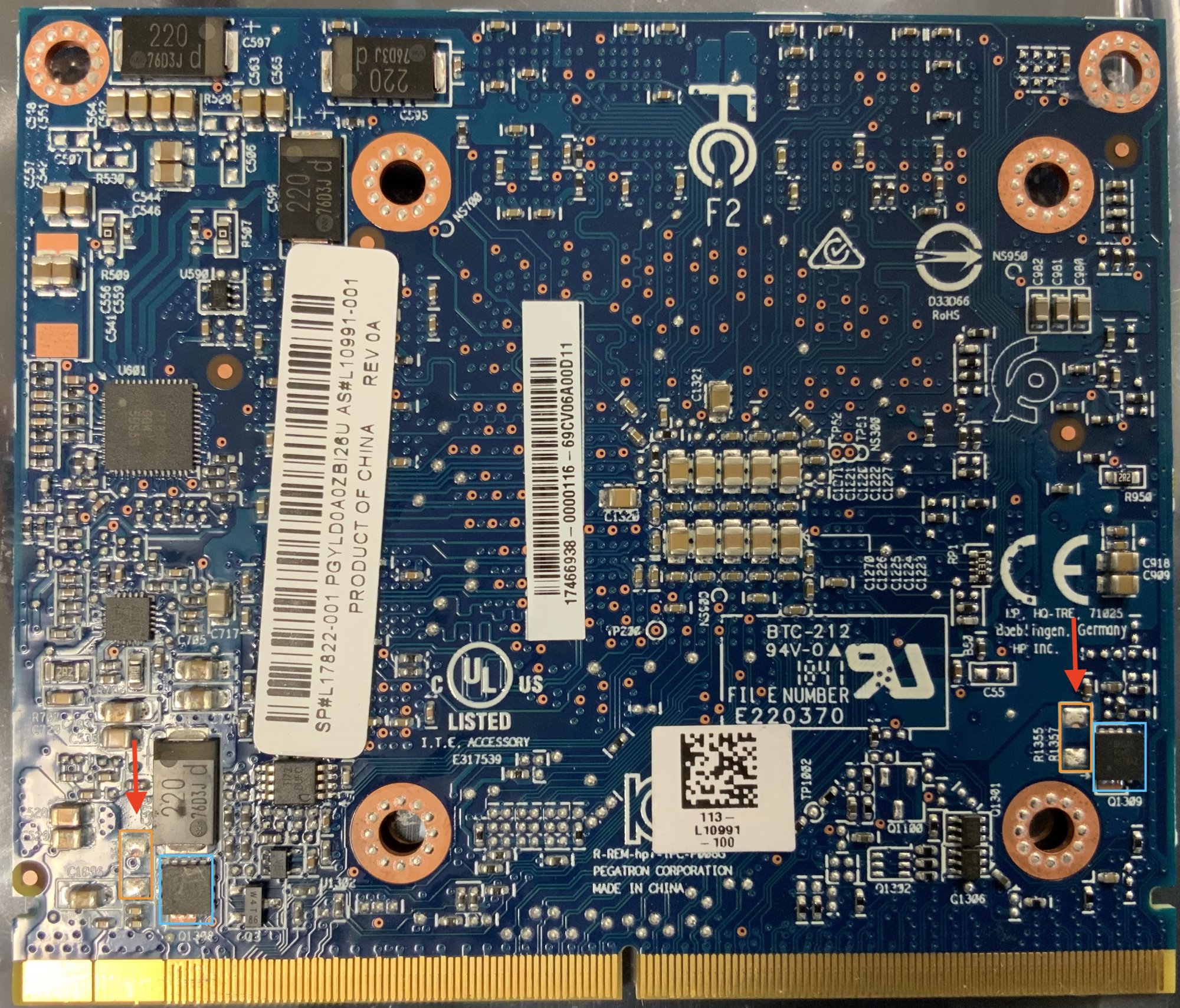

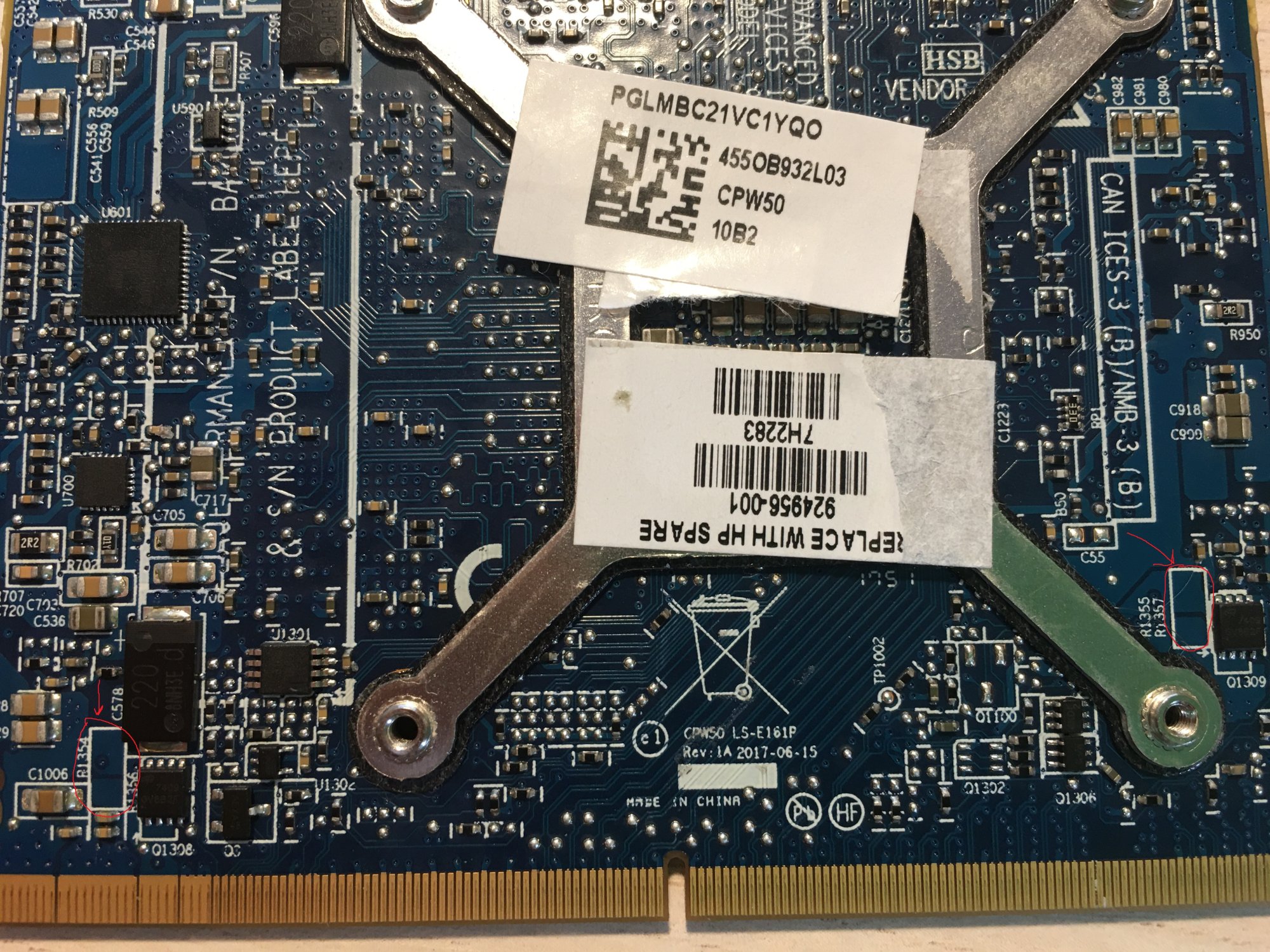

SM-Bus conflicts with components on the board cause the SMC to shutdown the machine immediately, if I remember correctly.

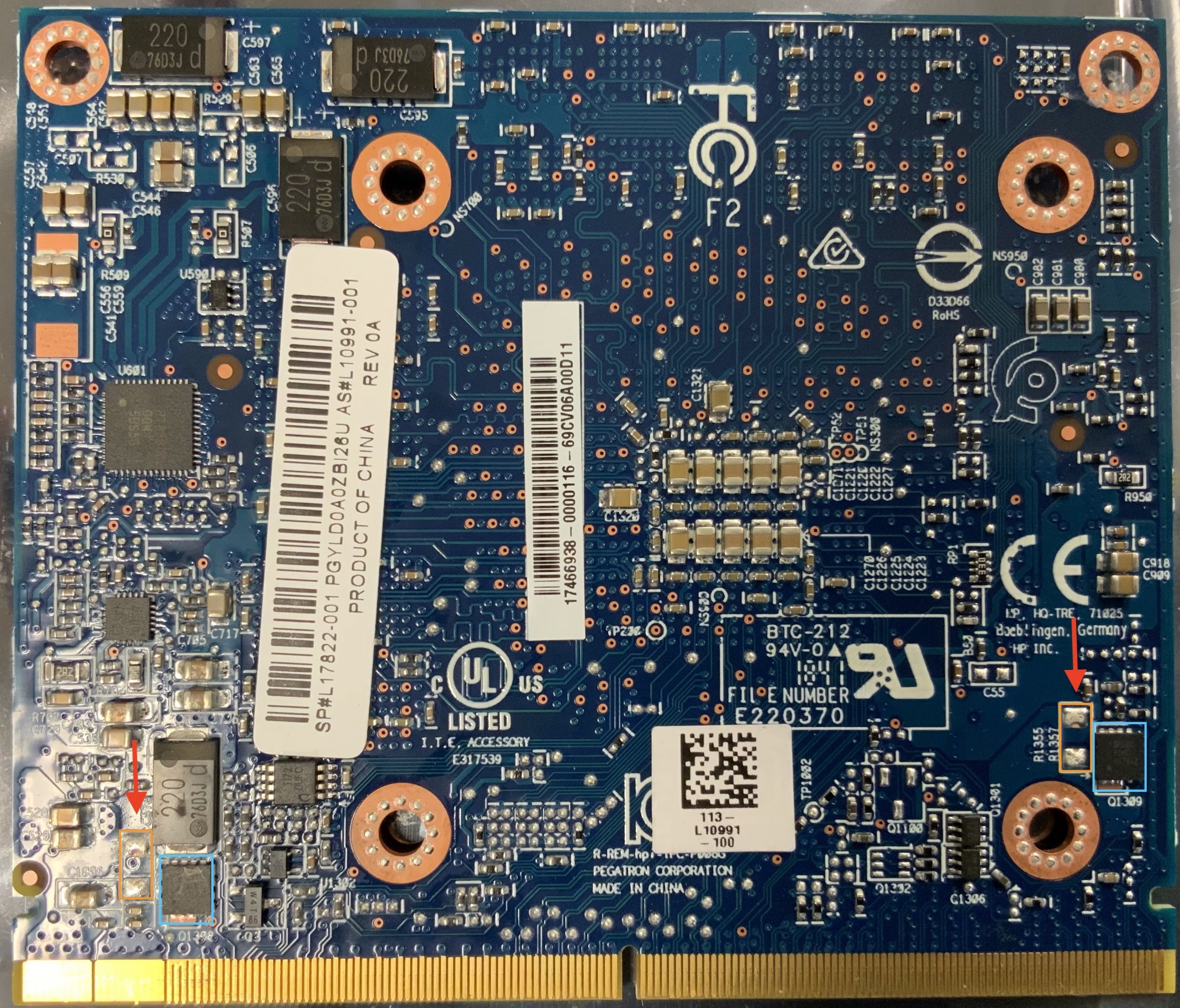

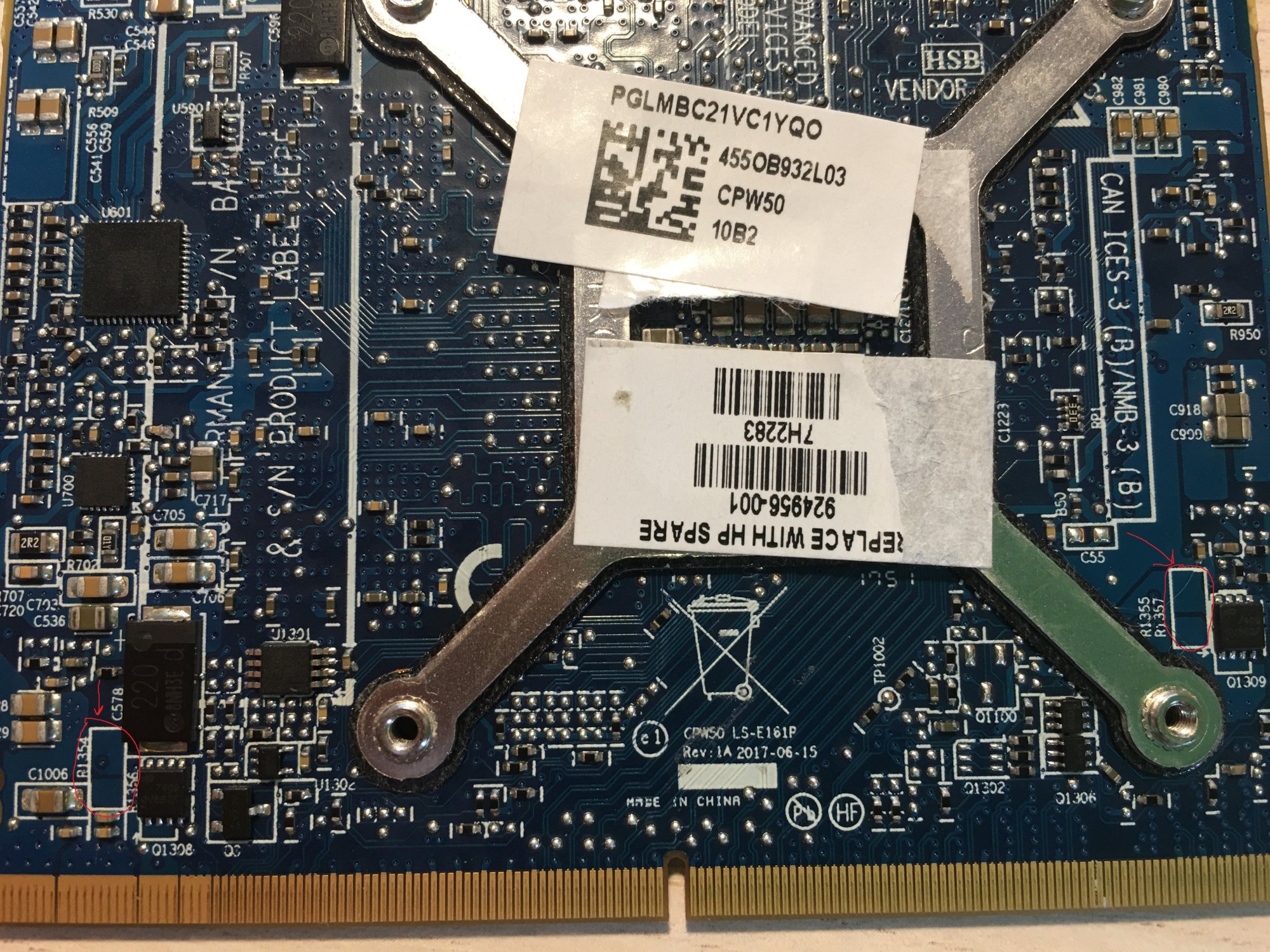

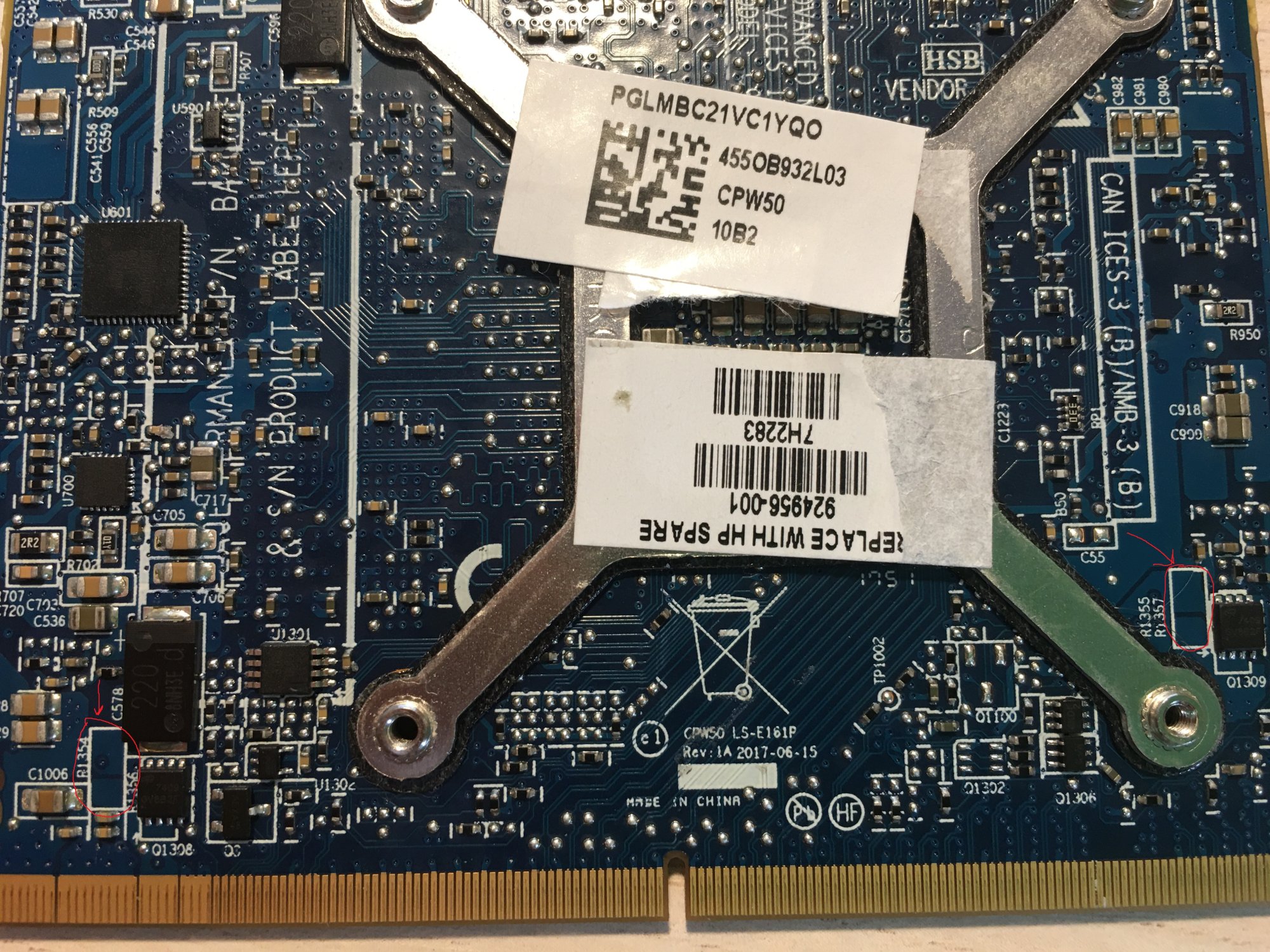

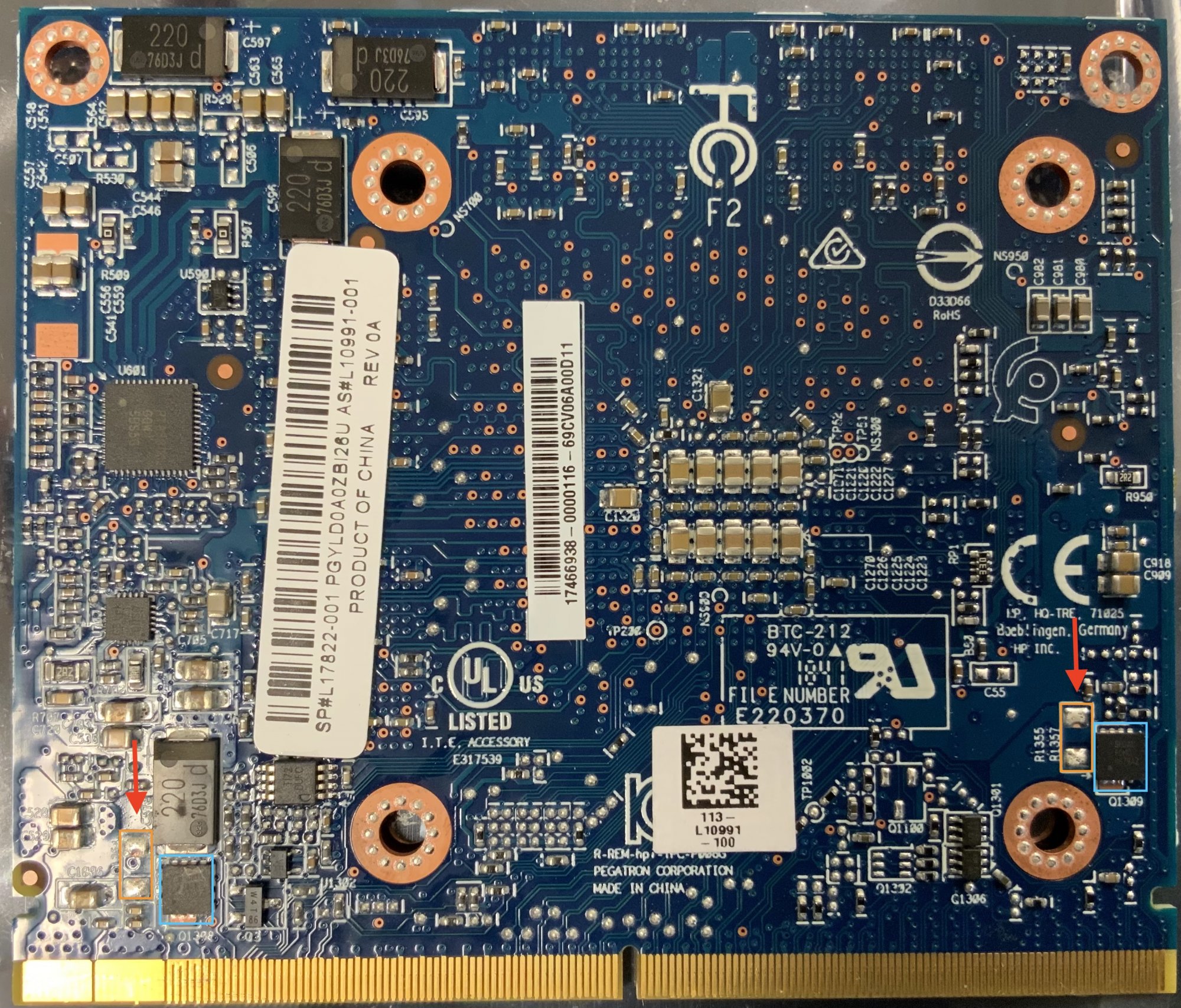

Roger that. So if I apply mods, problem will be fixed? I found two 0402-sized 0R resistors which need to be removed, as proposed in 2nd additional mod. But with the first mod I dont know what to do, because my card looking not the same as original card from post. I think it's not possible to add this jumpers on my card. Also I attach the photos. First photo from original post and second it's my card. Any advice will be appreciate.
Look closely - on your card the pads to solder those jumpers are simply covered in solder mask lacquer. You'll have to (carefully !) scrape this off to expose the pads to solder those jumpers. (Depending on the tools you have, you could also probably simply remove the MOSFETs next to those (non-)pads and replace the MOSFETs with jumpers.)
Also, the added 1206 jumpers in some way 'work around' the iMac12,x power up logic to actually allow the machine to, well, power up. The two 0402 jumpers you need to remove do avoid that (potential) SMBus issue.

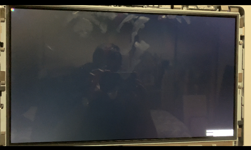

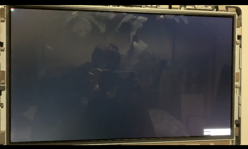

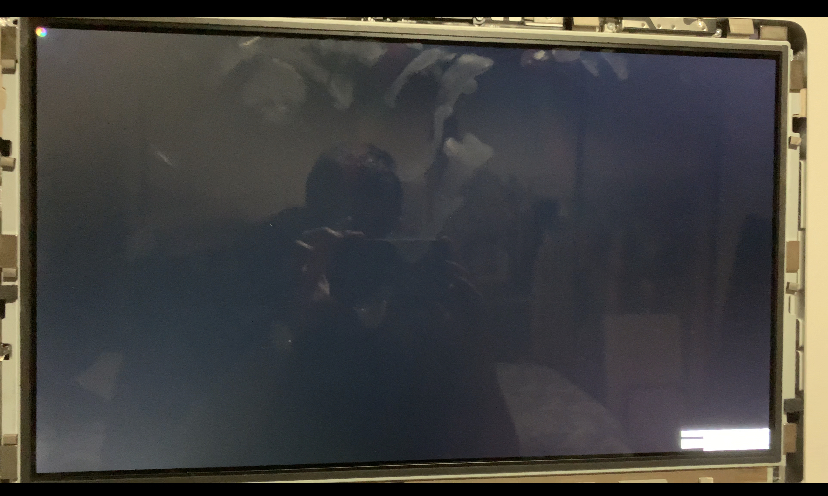

God evening. I done with mod according Your instructions. Many thanks for help. iMac successfully boot to OS, but display is black, no any picture on the screen. Maybe it’s because bios of the card must be flashed? Or it’s something else? Thanks in advance.
