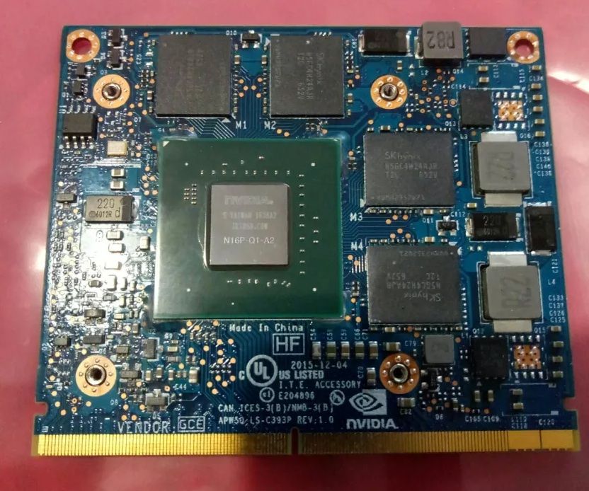

Will this card work in iMac 27 2011 ?
nVidia M1000M DDR5 2Gb MXM GTX 950 HP ZBook
image;s=1000x700
Dont think it will work oob
It’s not an dell card.
It looks like it does have 8 legged eeprom, you could flash the bios to a dell version i think.
But for my self i would not buy it, and just buy a known working dell card..

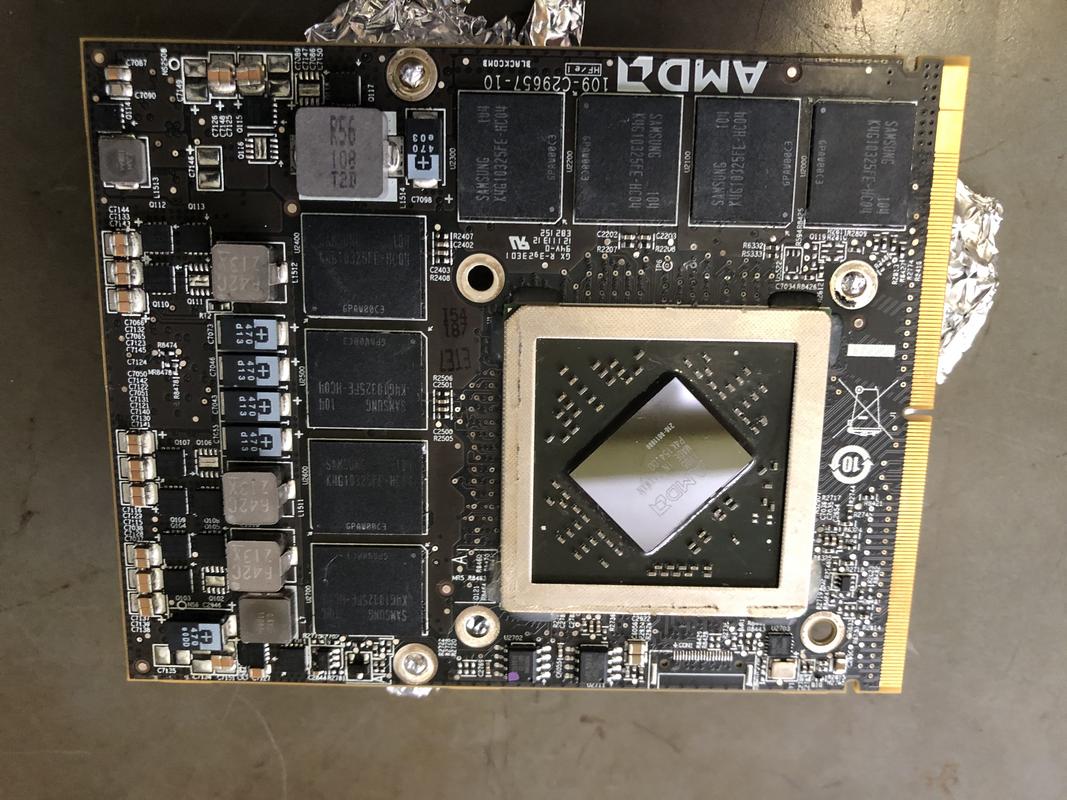

Hello to all,
I am completely new here and this i my first post so sorry if i did something wrong.
I have a question. I bought AMD Radeon HD 6970 2GB GPU taken from Alienware to upgrade my iMac Mid 2011 27”.
Swap was fast and smooth but i am constantly getting black screen. Machine is booting definitely. I can hear the booting sound, but nothing is happening.
Can do something to change this or is it a lost cause?

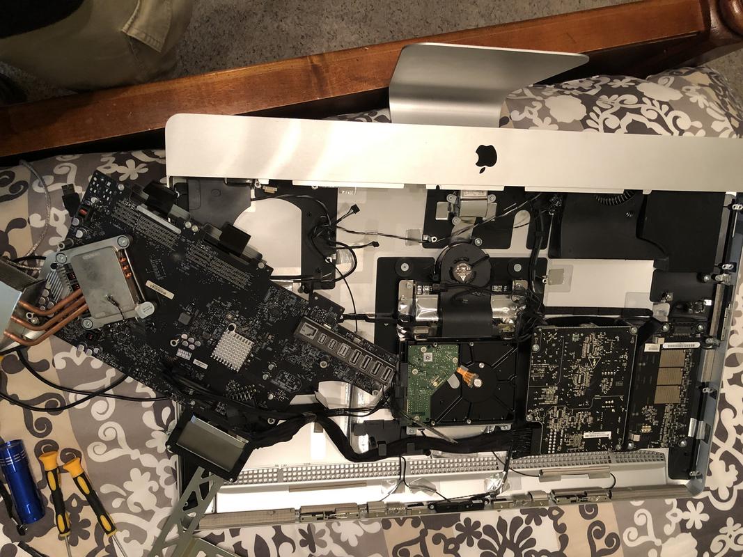

So waiting for my K1100m to come in, for now I went ahead and pulled it apart anyhow and just completed a bake at 395F @ 8 minutes.. yeah, I know .. this may not work, or if it does, will not last.. just buying time.
Just want to get the SSD installed, and get things pre-mojave ready..

Did you flashed that card with the iMac rom? https://www.techpowerup.com/vgabios/109915/apple-hd6970m-2048-110128
Update: 6970M Bake Successful.. All video glitching is gone for now, Samsung SSD is working great... Will continue to gather parts for round 2 with the installation of the K1100M, and backlight mod.. but will ride this as it is for as long as it will with the original card.
Reactions: Lost Heaven
Good, this was also a good practise for a dissasembly of the iMac I guess.. ? :p

do keep in mind that your card will fail again !
All AMD HD6xxx series will die, due to chip underfill problems I think.
I would better advise you to go with a compatible Dell/Alienware card..

yes I agree, but my card didn't fail. I am using 6770 512MB and this was simply an upgrade that i wanted.
i choose this card because i didn't want to think about was it supported or not. I wanted clean swap, but didn't know that
i would need to flash rom. So i choose the card that Apple was installing. Also i found it for 88$ taken from Alienware in working condition.
To flash using a raspberry pi: https://www.ifixit.com/Answers/View/296157/What+GPU's+are+compatible+with+iMac+27"+2011#answer420333
You can also remove the bios chip from your broken apple card and replace it on your dell card, but obviously you need some tools for this to properly desolder/resolder.
Thanks passatgt,
I am not sure if I can do this. I am ok techie guy and i was flashing desktop GPU-s many times but i never done this.
I found SOIC 8 but how to make adapter for Raspberry Pi? I can see that this one was custom made on this picture.
