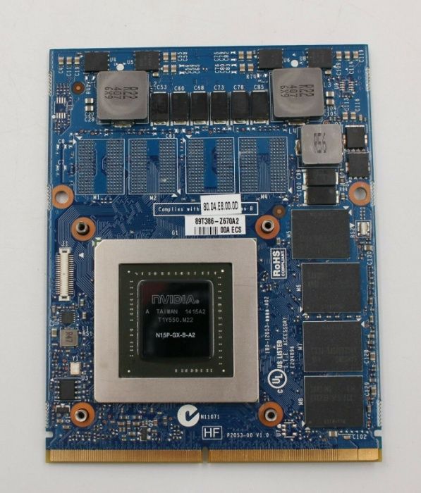

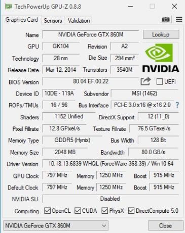

What about this card ? Looks like it Kepler, but subvendor is MSI
NVIDIA GeForce GTX 860M 2Gb GDDR5
