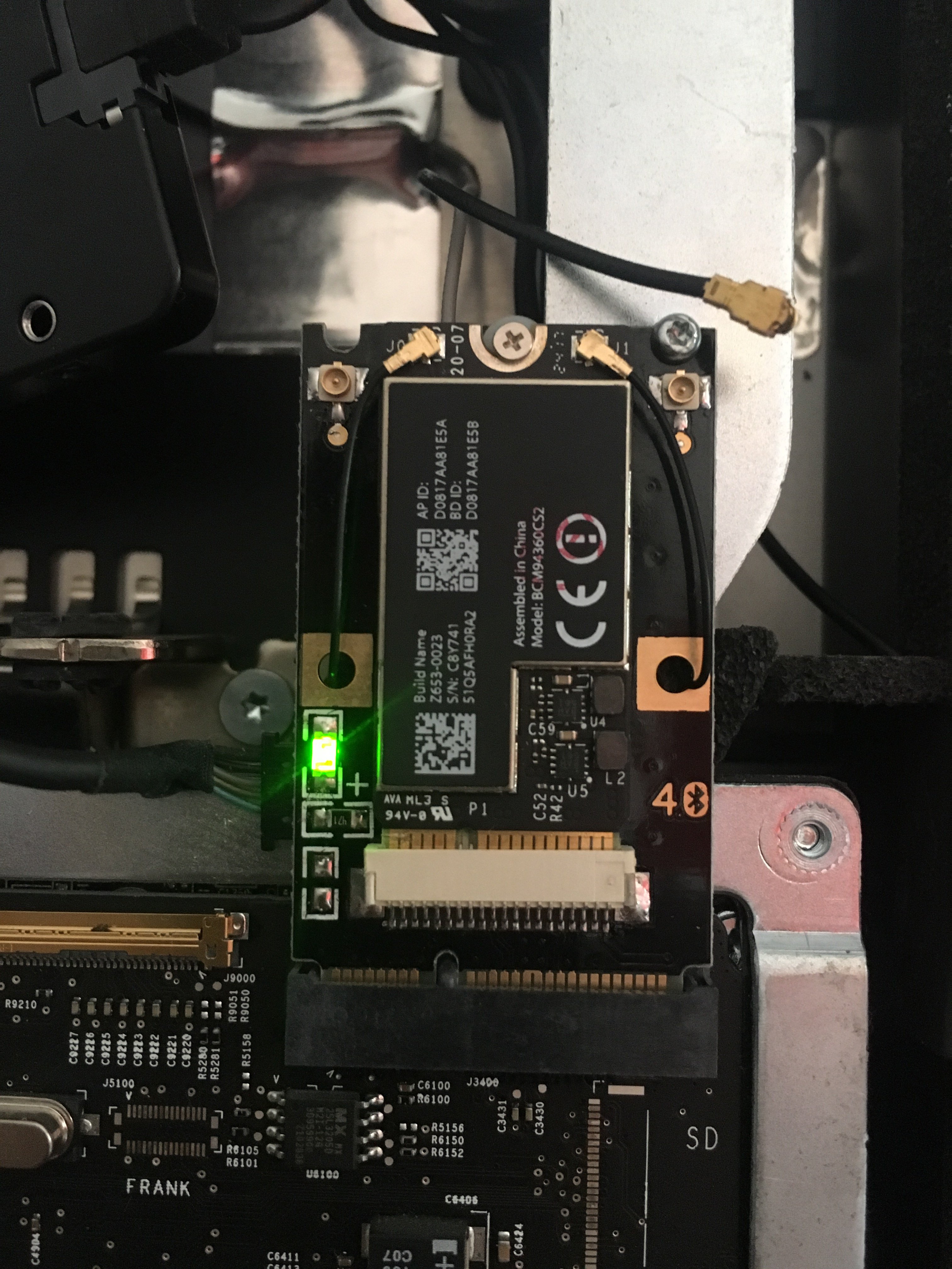

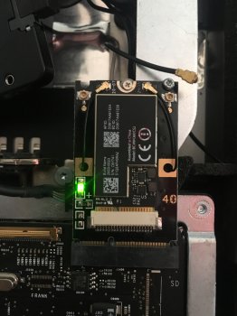

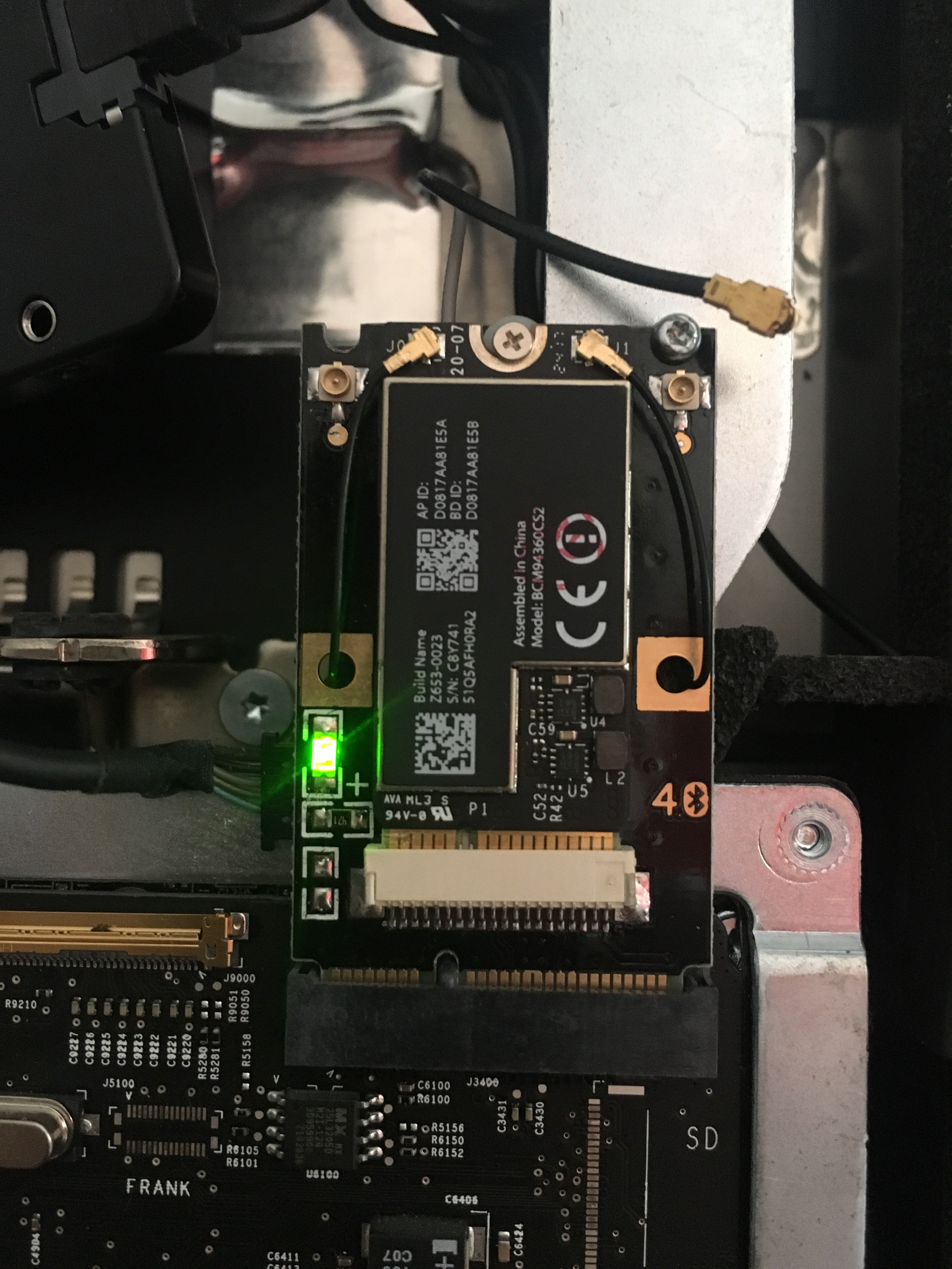

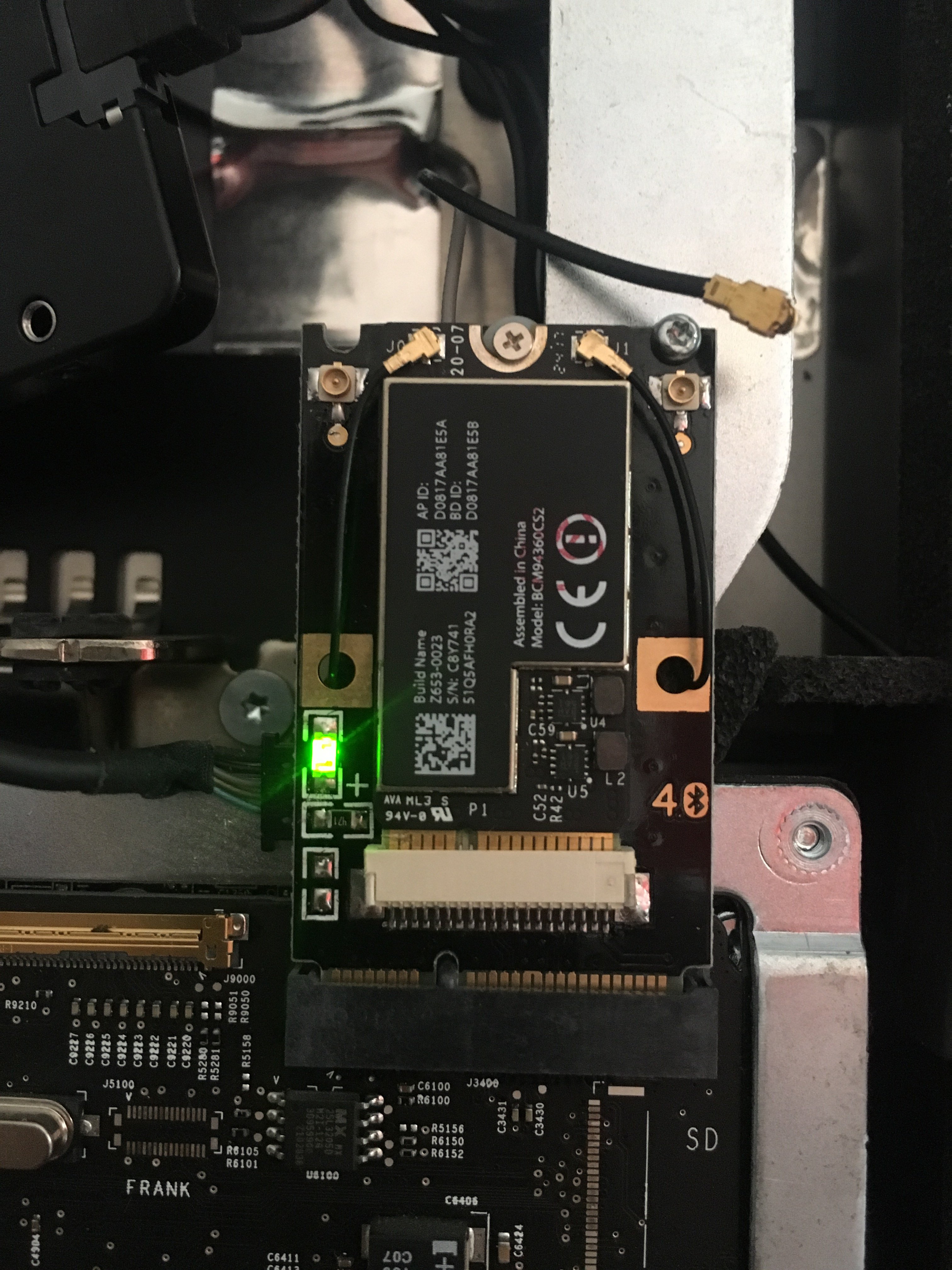

I ordered a AC wifi + bt4 solution from taobao: https://item.taobao.com/item.htm?spm=a1z10.1-c.w4004-660199089.9.409e5ac5zQu37p&id=40307425283
It works fine, plug & play. Since i purchased this for a 2010 iMac, i opted for the two antenna version(BCM94360CS2). It works plug & play, and you can connect the bluetooth cable directly into the daughterboard, so you don't need to do any soldering, wire cutting. Both Wifi and BT4 works, however i'm not sure how to enable continuity. I downloaded the continuity activation tool, but it just says that its already active. But i don't see any difference sadly. I didn't connected the antennas yet, because i will take this machine apart again and its a very fragile connector... but even without the antenna connected, i still got 40-50mbps.

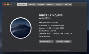

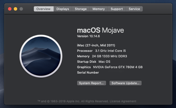

I finally got the gtx 780m working on my mid-2011 27" iMac
logic board issue potentially.
Looks like a psu problem to me btw..

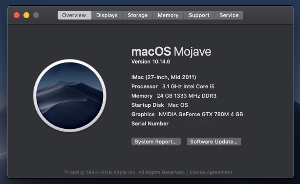

It turns out passatgt was correct. I had short. I believed the problem was the nvidia x-bracket. So, I took apart the iMac and wrapped the x-bracket with tape and voila... I got in Mojave.
It's running perfectly right now. But, does anyone know if there is a way to use CUDA in Mojave ?
Thanks for your help guys!
Good that it woeks now !
Cuda support for mojave still a no go, i doubt there will be any nvidia drivers will to be released for mojave..
Maybe with catalina we will get more lucky this time..
