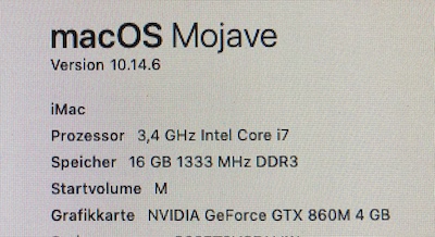

Should this GTX860m work? Thank you all and sorry for my english. I'm from Germany.
Dell Alienware works best i think. The vard looks fine. If the bios is not good, you can always replace it with an alienware from techpowerup. But it looks fine.

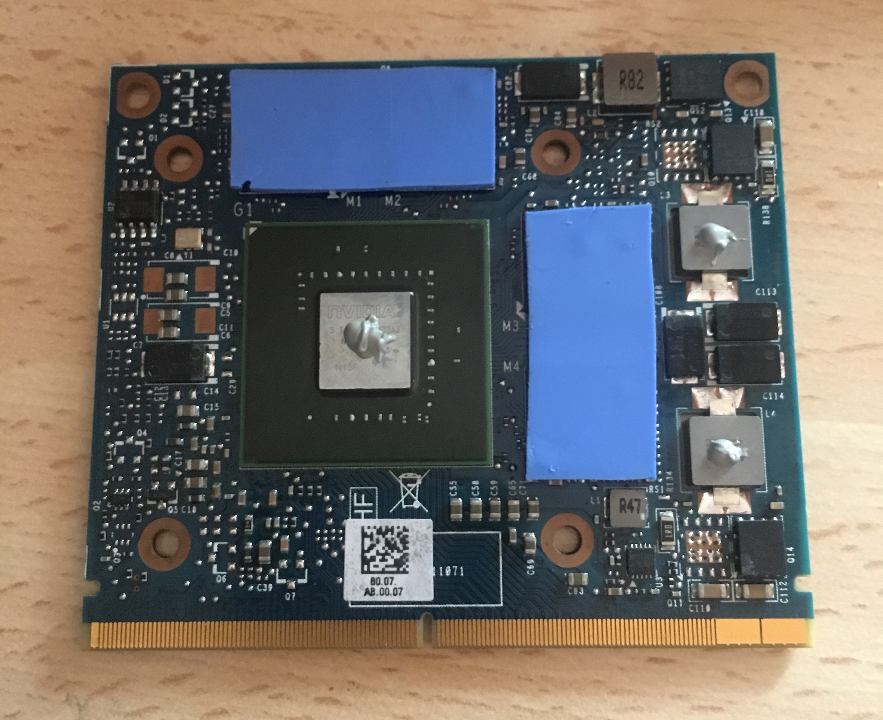

So, the 2gb k1100m works. Here is how the card looks:
No issues with i7 870S + k1100M. Run some benchmarks too:
Cinebench R20 - 194 -> 397
Blackmagic Disk Speed Test - 107/99 -> 454/515
Geekbench: https://browser.geekbench.com/v4/cpu/14277043 /
https://browser.geekbench.com/v4/compute/4428630
Novabench - 226 -> 349
Interestingly i wasn't able to run Heaven or Valley benchmarks, because it gave me very little scores and for some reason it recognised it as a 256mb card... But i think the card works fine. Any idea how can i test it to make sure?
Chrome runs 4k youtube almost perfectly(i noticed some frame drops, but very minimal).
Edit: i installed the nvidia web drivers, but i see the same results for both geekbench compute and valley. Can someone please check and tell me the scores? The system itself feels fine bit i think somethings wrong. Should i try with Mojave?

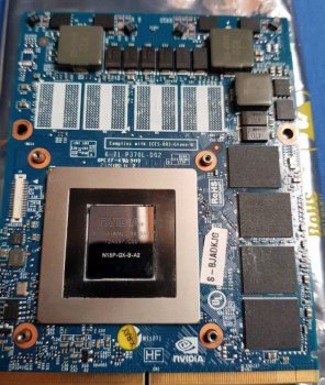

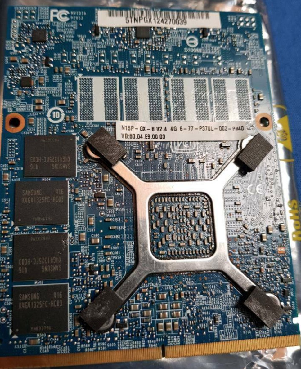

Thank you. Now i know, that the card ist new and from Clevo. VBios:80.04.E9.00.03
Will it work and should i buy it? I think it is the same Firmware like the Dell version.
Would it be possible to flash the card inside the iMac if it is the wrong firmware? I don`t have access to another computer with mxm.
GPU Device Id: 0x10DE 0x119A
Version: 80.04.E9.00.03
GK104 P2053 SKU 004 VGA BIOS (HWDIAG).
Copyright (C) 1996-2013 NVIDIA Corp.
GK104 Board - 20530004

I doubt Clevo vbios will work, but of course you can always try.
I think you can flash this card using bootcamp, using tools like nvflash.
Could be tricky to setup bootcamp blindly, but it could be a way to flash the card.
I dont think you can flash the card within macOS.
best is in my opinion to just buy a known compatible Dell/Alienware model, this way you won't have to pray and try to flash one your self..

Thank you. I bring the card to work with Ubuntu Linux (Unpluged SSD and booting form live DVD).
OSX from my SSD (high sierra preinstalled) don't show anything. Sometimes i've got a bing noise at any key when i try to make a blindfold login. The volume buttons works. Maybe it is my FileVault Drive?

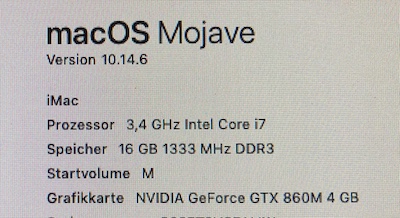

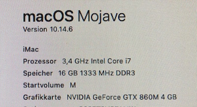

The "Dell GTX 860M 4 GB BIOS" from techpowerup.com has the same VBIOS Version: 80.04.E9.00.03 like the Clevo and the nvflash compare is identical. So i don't think that flashing will help.
I've made a patched Mojave installation on a usb-drive, unplugged the other drives and the iMac started, but only showed the screen on a external display. On booth TB-Ports. This means, that it is the wrong vBios? Ubuntu from DVD could light the iMac Screen up.
