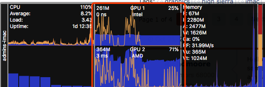

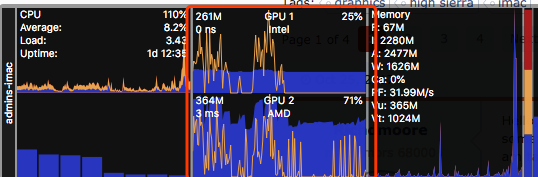

HI GUYS, I found our iMac 2011 intel GPU still actives when OS running, is it anyway to let system find it ?
The iGPU can also be used an seen in video tools.
For as far as I can remember tools like handbrake can use the intel iGPU and I think FCPX will also be able to use it..
And many others I think.

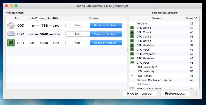

I installed the mac fan control application, so it works, just wanted to know why changing the fan speed changed when changing the video card. And I still have a question as to how reliable the GTX765M video card is?
Can you check which sensor reads 129C in Macs Fan Control? Maybe you forget to connect the GPU heatsink sensor back to the motherboard(next to the mxm slot) when you replaced the card?

here are my fan values

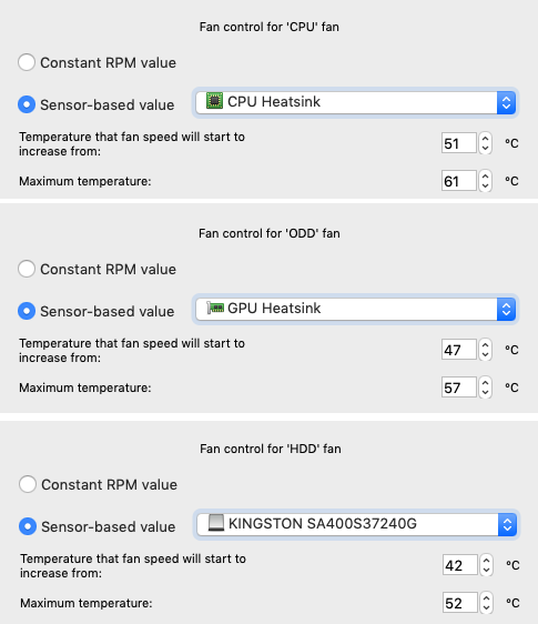

Hm, interesting, it looks normal. However i would not recommend setting the fans to ambient temp. Set the cpu to cpu heatsink or cpu core 1, odd to gpu heatsink and hdd fan to your ssd or hdd installed in the middle of the imac
Thank you very much and what values should i take?
