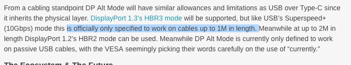

Yes, but if you read carefully, you observe that dp1.3 is restricted to 3ft under usb-c alt mode, by this reason (and other reasons) Intel ditched it from thunderbolt 3 Alpine Ridge.
More details here http://www.anandtech.com/show/9331/intel-announces-thunderbolt-3
Interesting. I always assumed they left it out because it wasn't included in skylake.
More on DP1.3 and its 3Ft extension limit:
http://www.anandtech.com/show/8558/displayport-alternate-mode-for-usb-typec-announced

All the DP1.3 issues might be one of the reasons we still don't have a proper rTBD yet, along with lack of hardware of course. The display will have to be awesome, 5K and HDR, which could be a problem.
The 1m/3ft issue is a problem but how long are the cables now anyway?
