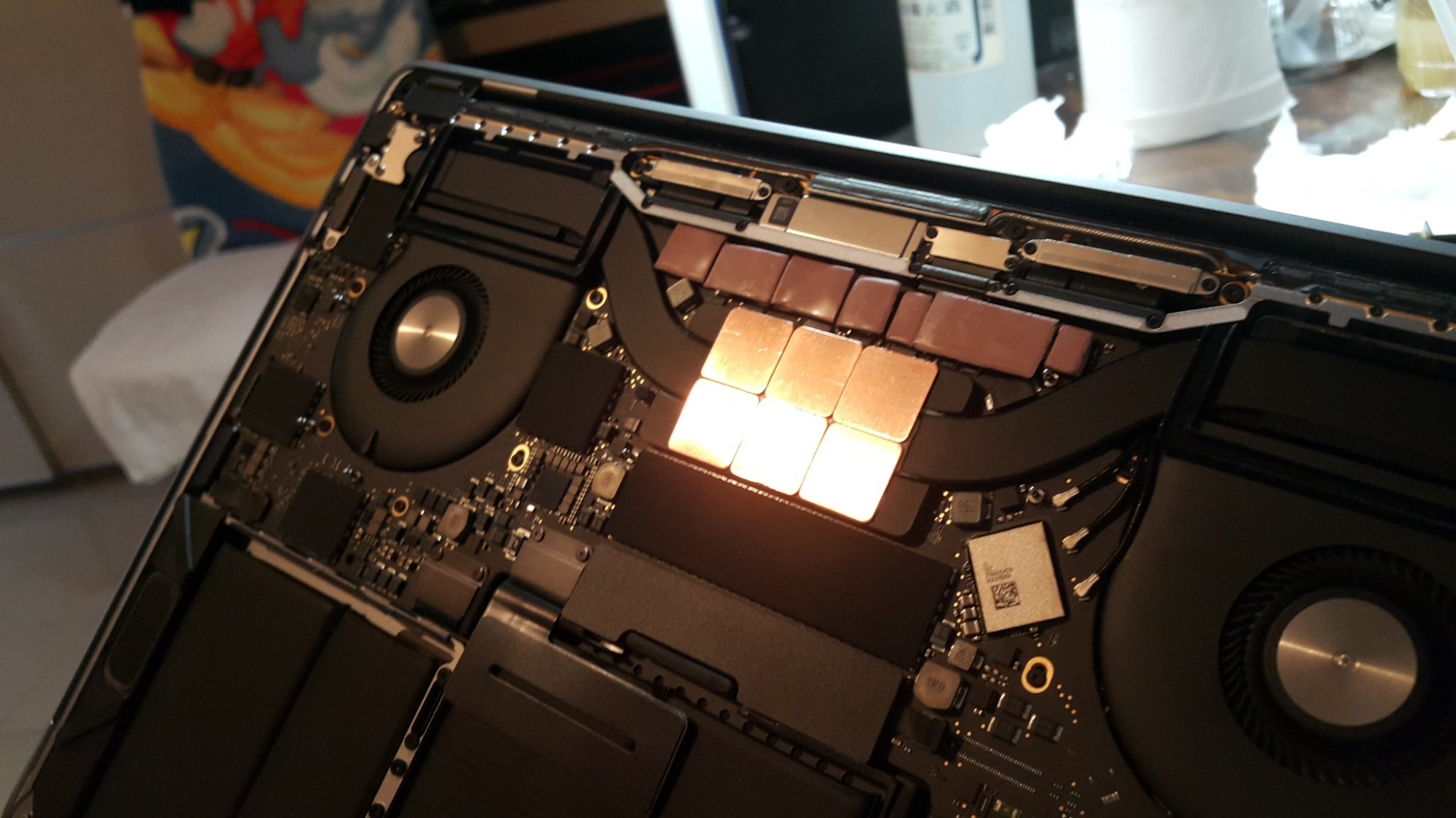

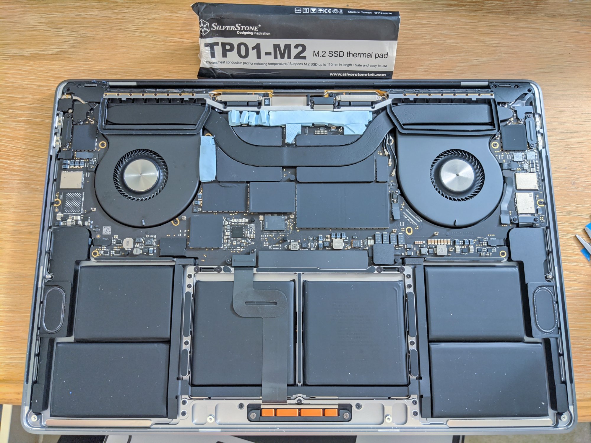

I've alluded to this mod in an earlier post, I have since implemented it and used the moded machine for a while to form a mature opinion about it. I think this mode is great for people who regularly use their MacBook in clamshell mode although I cannot recommend it because it obviously voids warranty (but Apple doesn't have to know since it's non-destructive).
Pros for the mod:
  • non-destructive, completely reversible
  • relatively cheap, easy and safe to apply
  • does not significantly affect normal usage
  • up to 20 degrees lower temperatures under sustained load
  • reduced fan speed under such load, and therefore noise
  • higher sustained power under such load, up to 7W more power
  • can accept external cooling like heat sinks or ice packs for silent cooling even at max power
Cons:
  • can burn your skin if not careful
  • prohibits laptop use under high loads
  • potential damage to skins/cases/tables/table mats
  • thermal improvements are mostly negated when sitting flat on a surface
Theory
https://forums.macrumors.com/threads/im-thinking-of-a-thermal-mod-for-the-mbp.2133914/

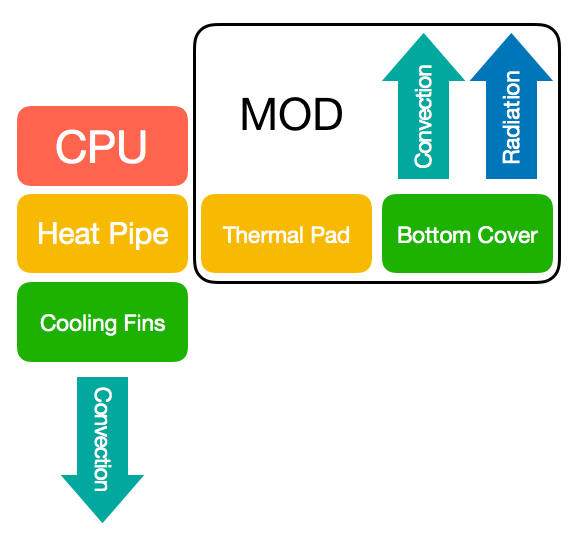

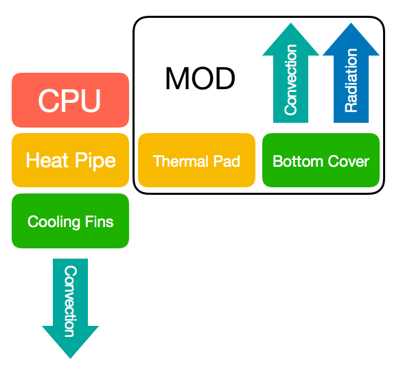

As I have mentioned in this post, due to the proximity of the heat source and the bottom cover which is effectively a big radiator, we can simply couple them together and let the bottom panel radiate heat into the environment.
Application

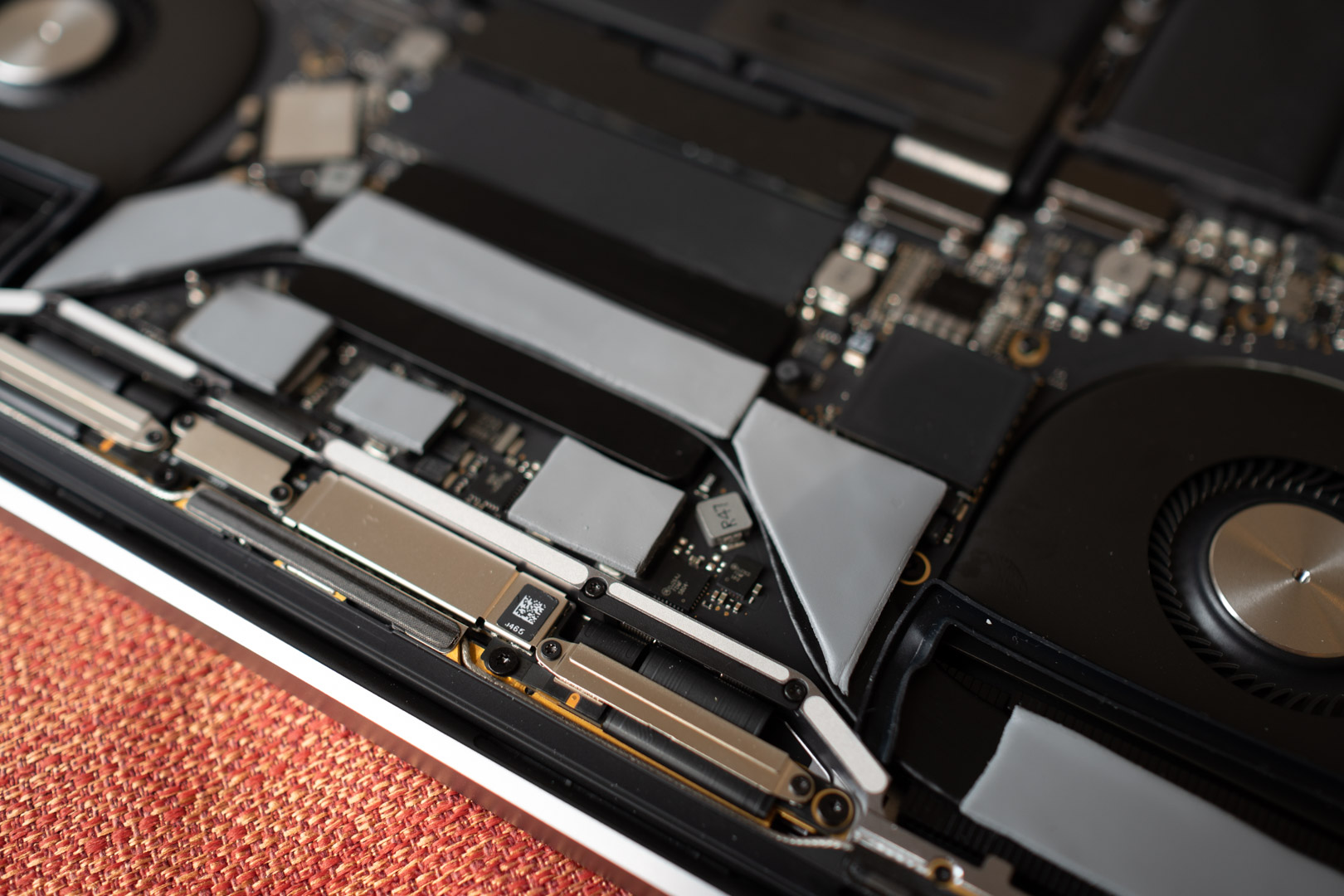

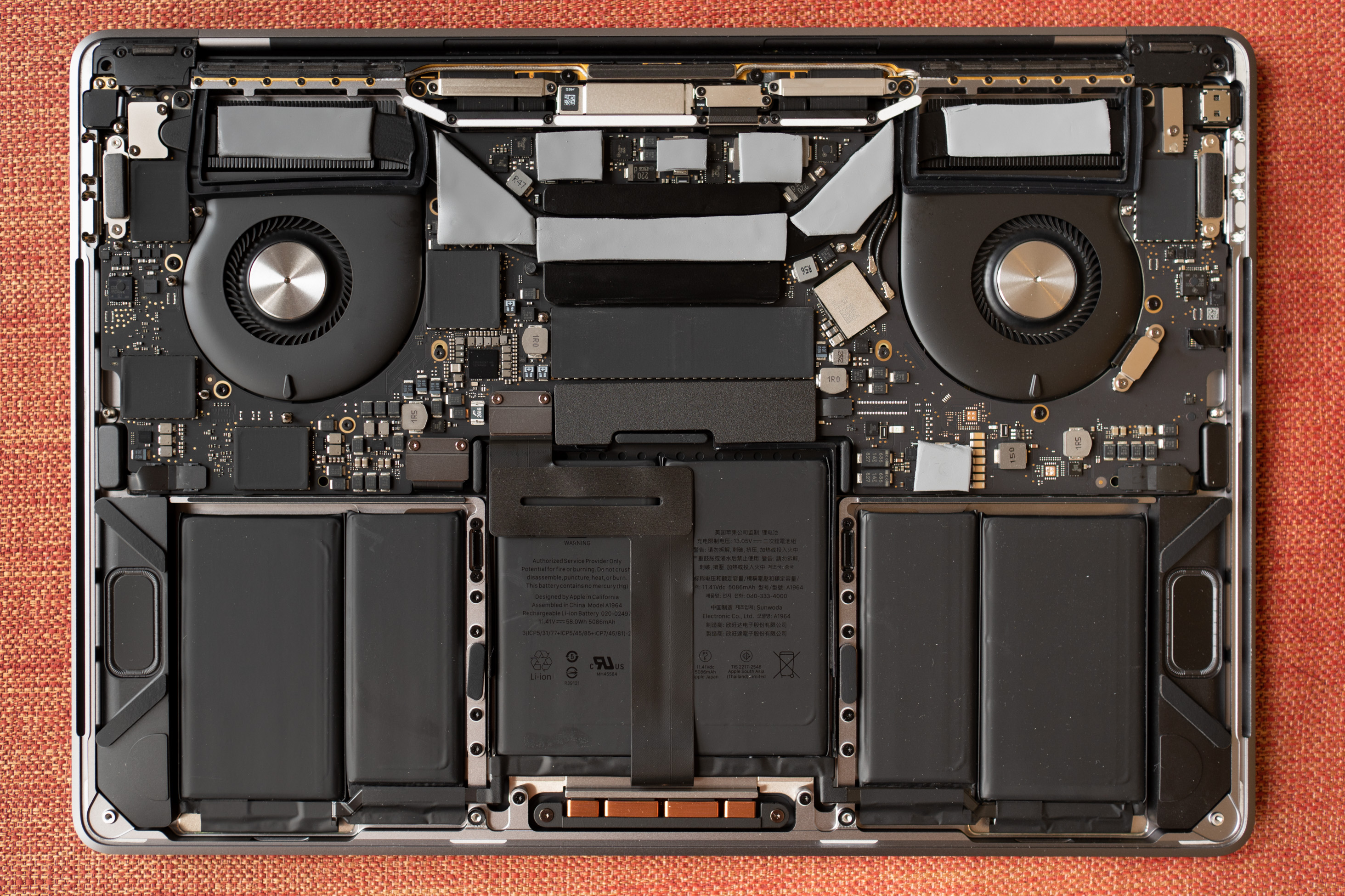

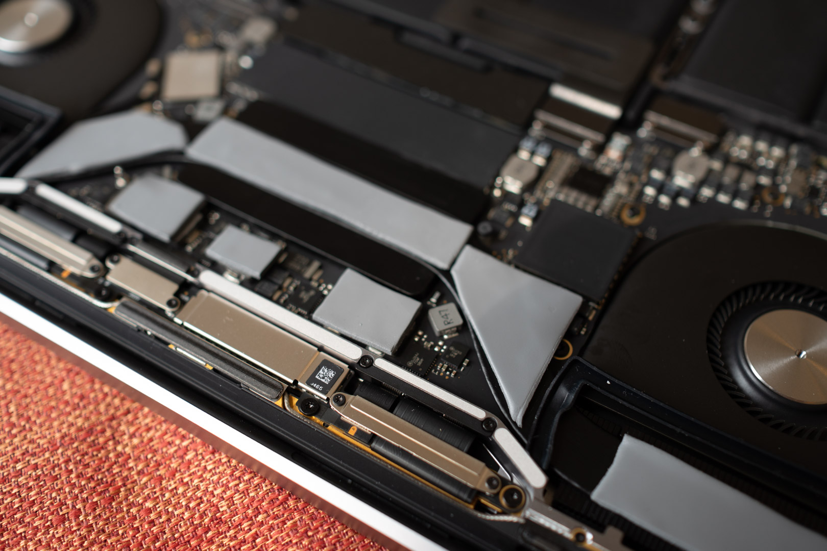

Quite simply, you remove the bottom cover, and apply 1.5mm thick thermal pad to the hottest areas like so:
The power regulators up top don't really need this because they can tolerate very high heat but I paded them anyway because they could offer better efficiency at lower temperatures and thus reduce power consumption.
And that's it, you just pop the cover back on and you're good to go. Except for the bottom cover to effectively radiate heat, it can't just face the surface of a table because that will just heat the table up to the same temperature and then you don't radiate much more heat.

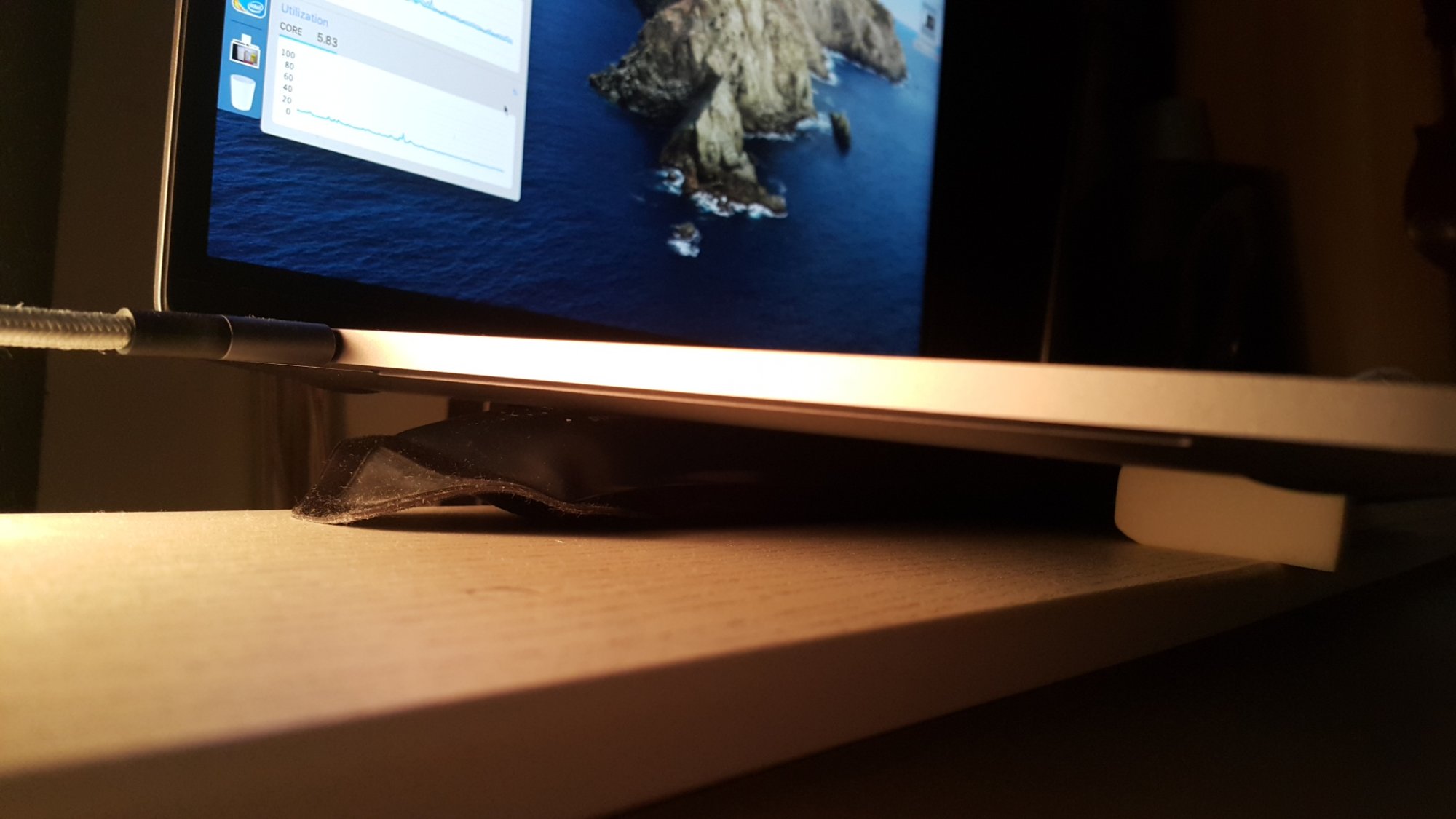

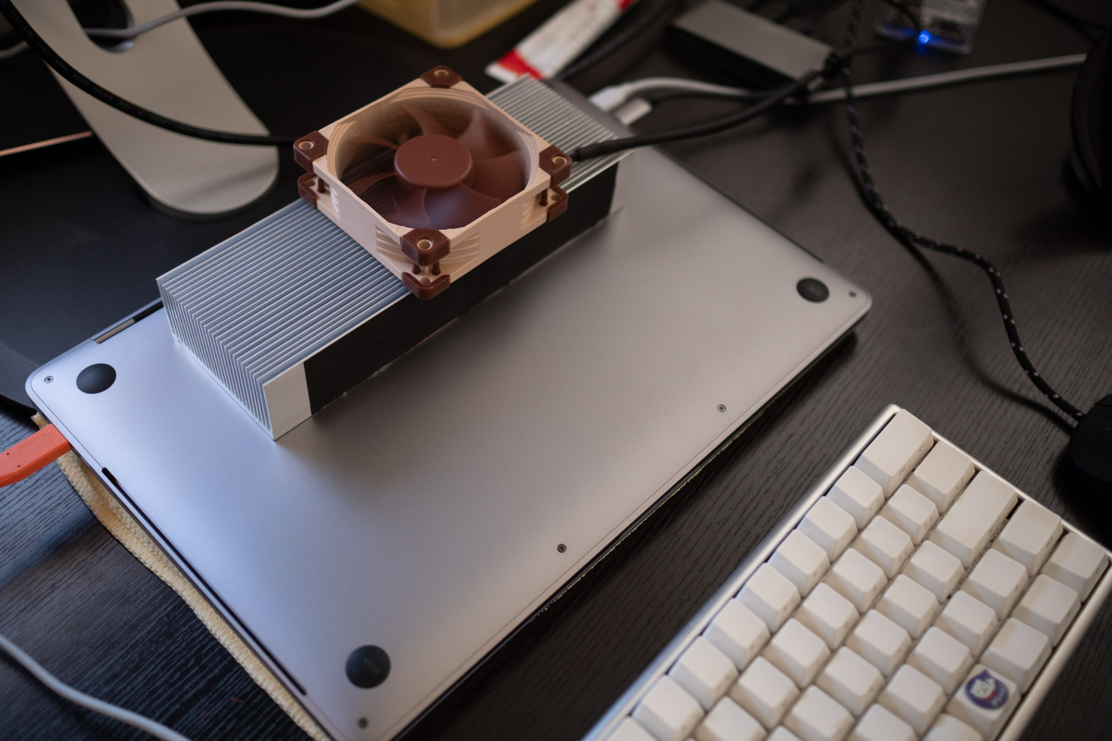

For optimal performance you need to either place the machine in a stand or flip it over on the table so that the bottom panel is facing preferably a cool area of the room (not under the sun beside a window).
Results

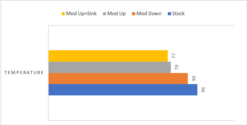

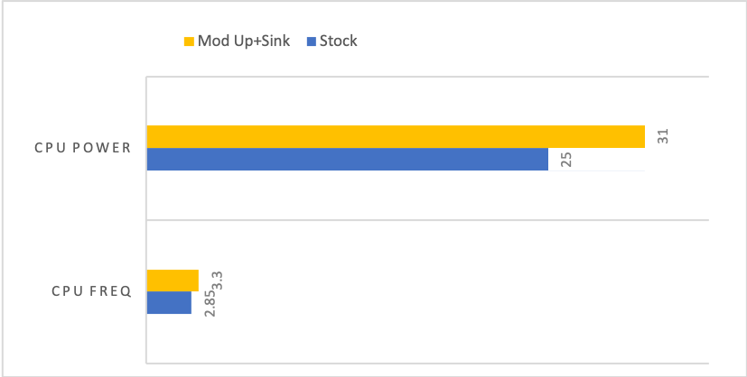

All tests are done in clamshell mode, this makes a difference because the CPU package actually draws about 5W more power regardless of everything else, when you output video.

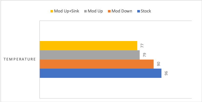

In this chart blue represents stock obviously, I tested by simply opening up a save game in StarCraft 2 in Windows with turbo boost disabled, which produces a constant and reproducible load.
Orange is the moded machine but just placed on the table like normal. As you can see there is an improvement but not much.

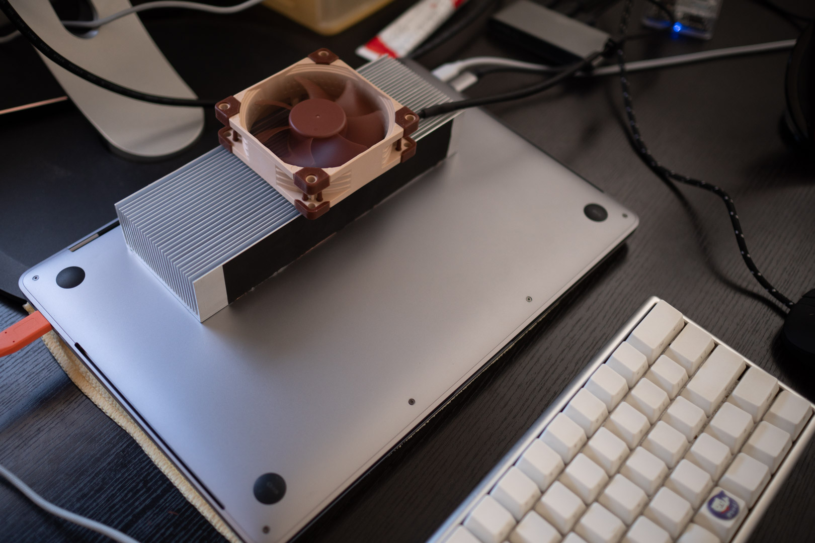

The magic happens when you flip the machine over and let it just radiate into the room, represented by the gray line. The yellow line represents the flipped over machine with a big aluminum heat sink just placed on it. There is almost no difference from the heat sink because heat sinks don't provide significantly increased surface area for radiation, it gives improved surface area for convection.
I have not tested this but placing it on a laptop cooler should be just as effective as flipping it over on the table. (where as those products don't actually help the stock laptop, or most other laptops for that matter)
If I add a fan to blow across the heat sink, temperatures are further reduced to around 72 degrees. Such a setup can completely eliminate internal fan activity even under heavy loads. And you can use fan control to force the fans to minimum speed and still run at over 30w without hitting 100 degrees for any amount of time.

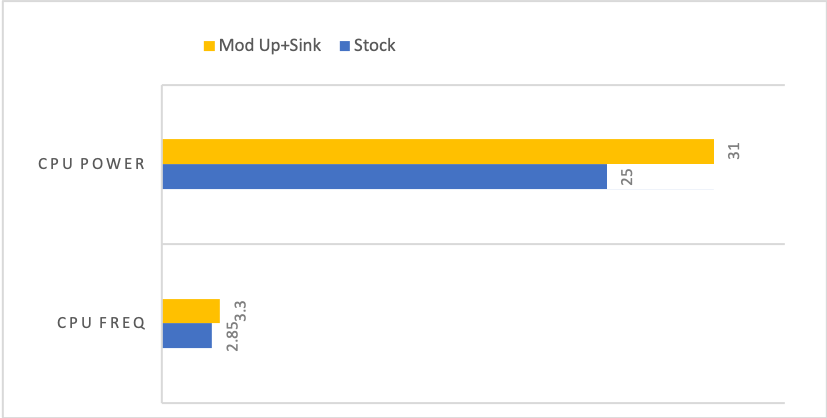

I also tested constant power, by immediately running Cinebench after I warm up the machine with StarCraft. As you can see, the stock machine can then only accommodate about 25w of cpu power, while the moded machine can run at 31W.
At this point CPU power is basically bottlenecked by thermal paste performance, even with ice packs directly on the bottom panel, I could not really get any high power through the CPU. I'm guessing I would need to apply liquid metal for further improvements. Interestingly, when you distribute the load across CPU and GPU, you can get like 40w through the package without thermal throttling but the CPU can only take about 35.

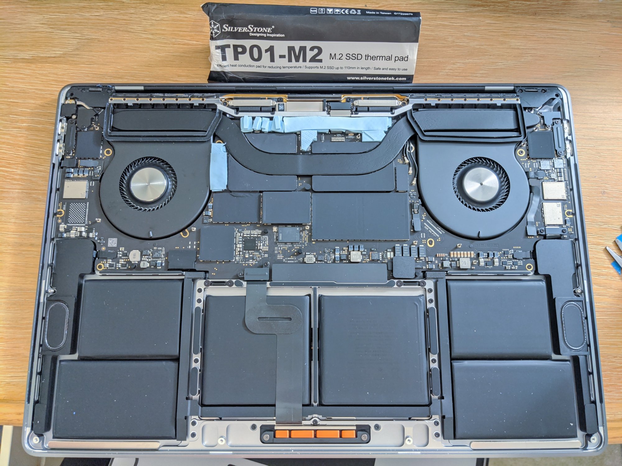

I'm planning to make this mode on exactly the same machine, what exactly I should cover with pads? Like vrm or something?
Reactions: zuongpham
can anybody tell me what should I cover with thermal pads except heatsink?
My mac is dropping frames sometimes while gaming under bootcamp if I push it too hard but the temps are actually low like 78-85 and it goes like 90+ for first 30 min but then it drops, I bet it's vrm overheating but maybe it's video memory also, any thoughts?

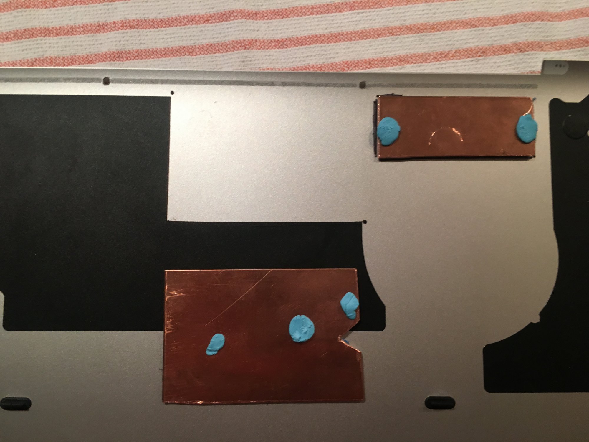

I just did the mod with a 1mm copper plate in between the heat-sync and the case. I don’t think it is possible to swap bottom cover cause the silicon pads will stop sticking after a couple applications. I’ll probably do a post about my mod soon.

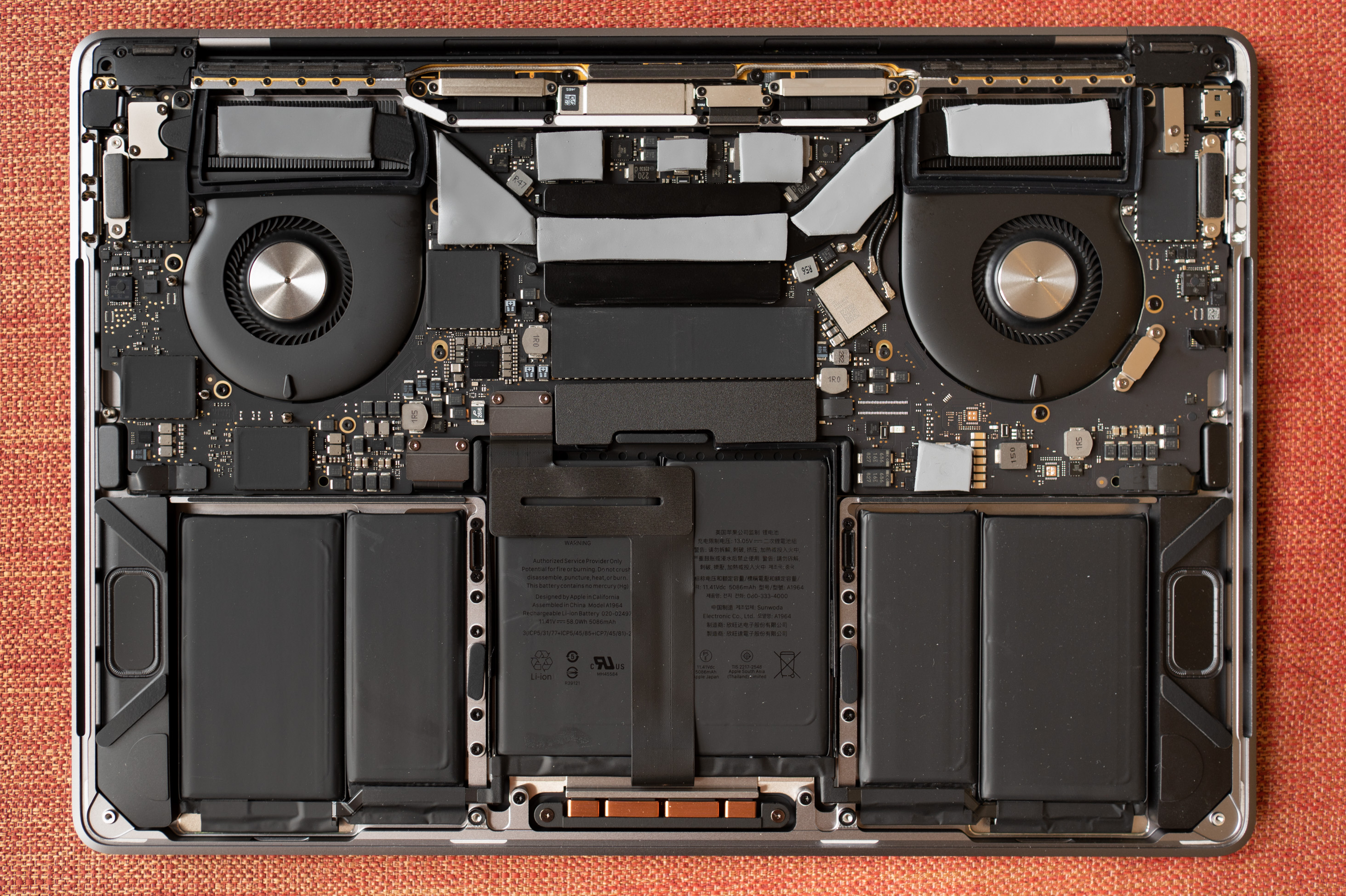

A few months ago this idea came to me and I found your precious report which gave me much confidence.
Thank you 1096bimu.
I expected a bit more performance improvement, but I'm satisfied with the result.
MacBook Pro 15" Early 2013 (Core i7-3740QM)
(laid on dedicated aluminum heatsink with thermal pad)
Added internal thermal pad: GP-EXTREME 1.5mm thick
Environmental temperature: 18.9 degrees Celsius
Before the mod:
CPU idol: 60 degrees
CPU Cinebench: 2.50-2.60GHz 100-103 degrees
Cinebench 20: 1015pts
Geekbench 4: 3758/11479 OpenCL 13394
After the mod:
CPU idol: 49 degrees
CPU Cinebench: 2.70-2.80GHz 100-103 degrees
Cinebench 20: 1076pts (+6%)
Geekbench 4: 3567/12192 (+6%) OpenCL 13343

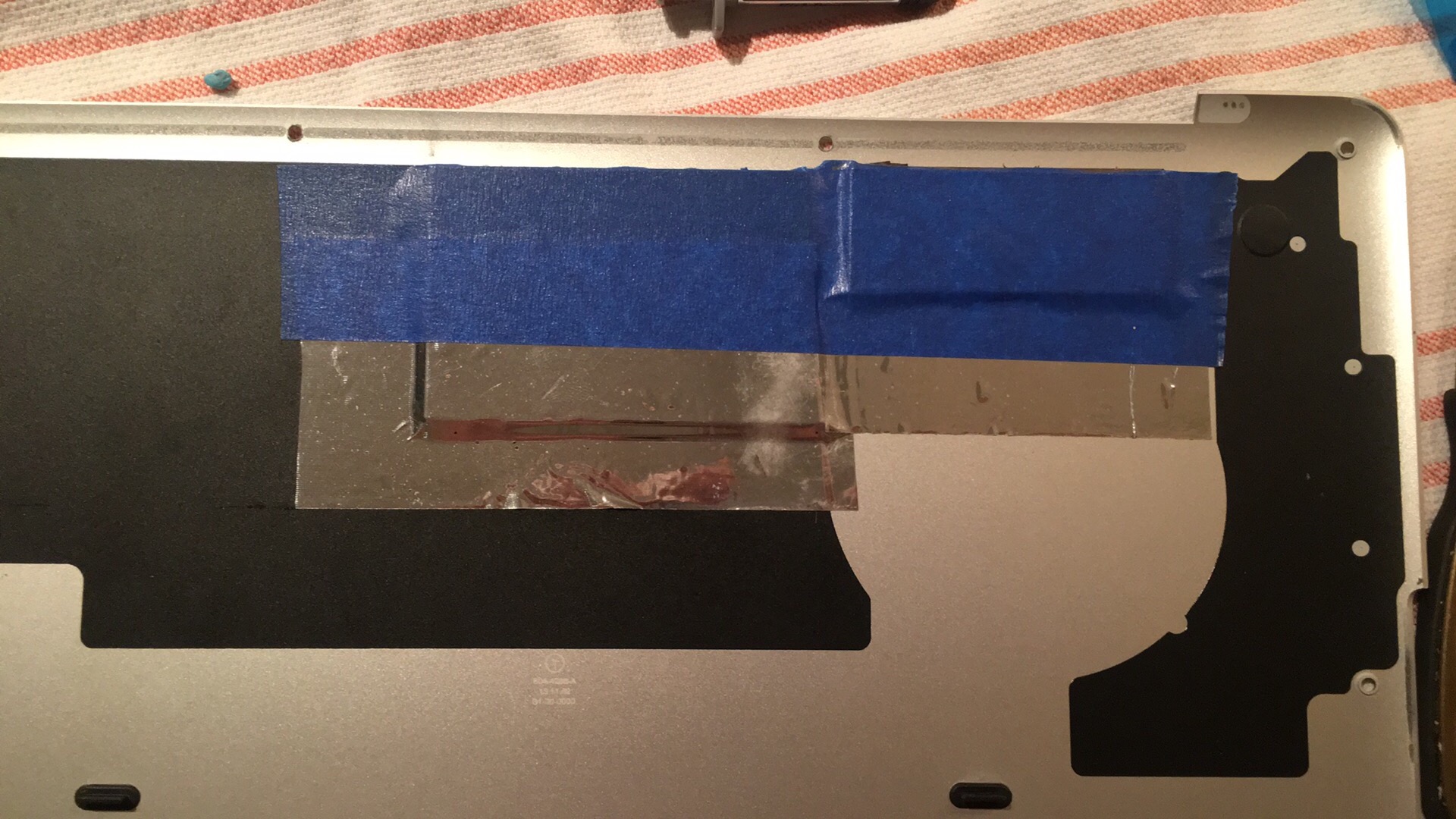

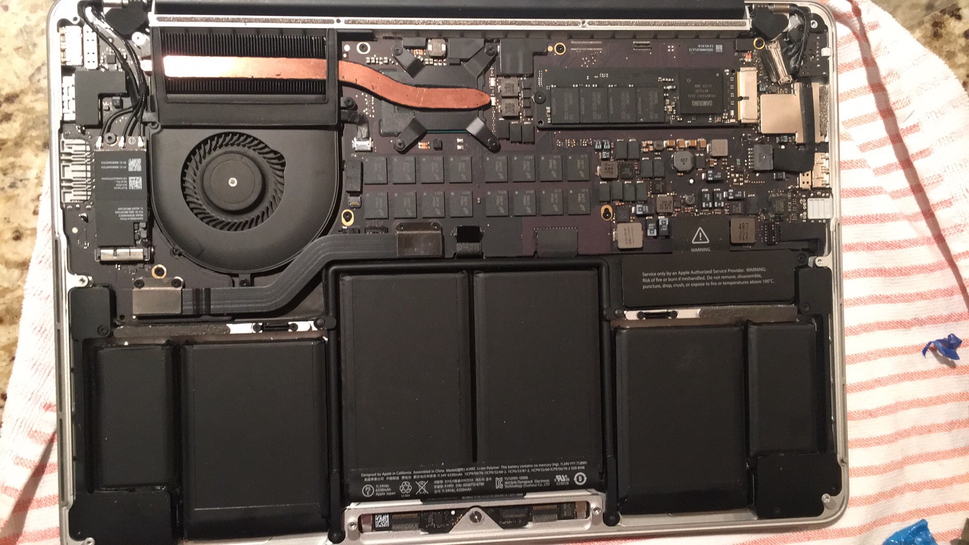

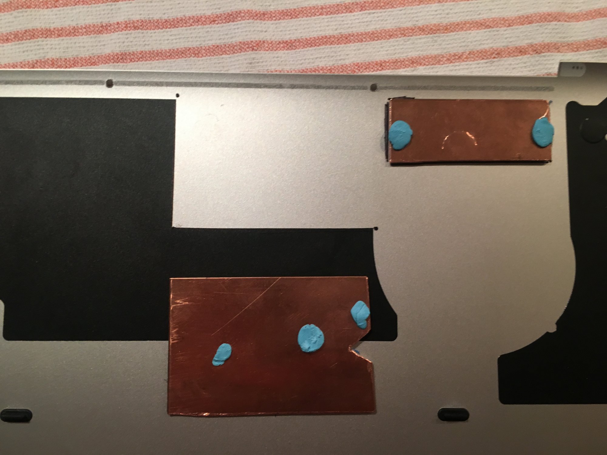

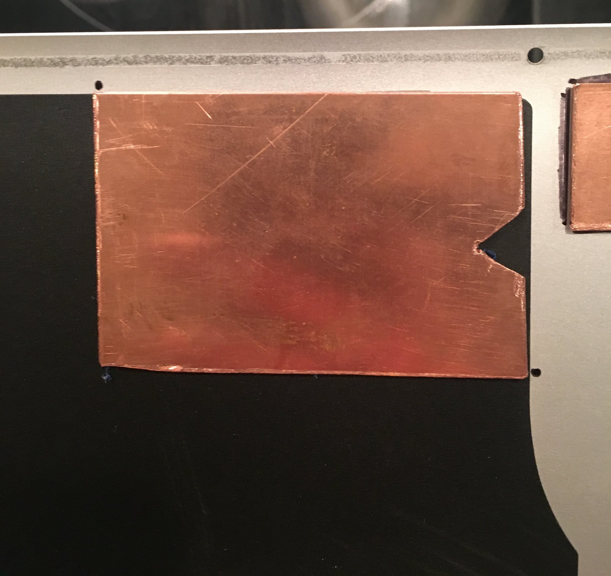

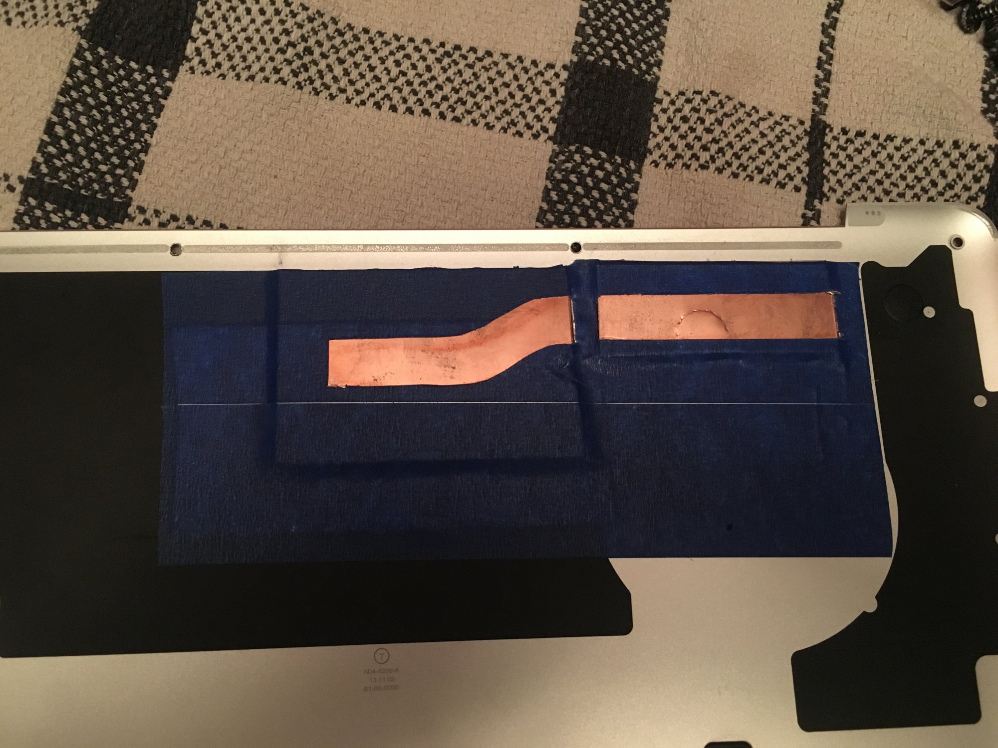

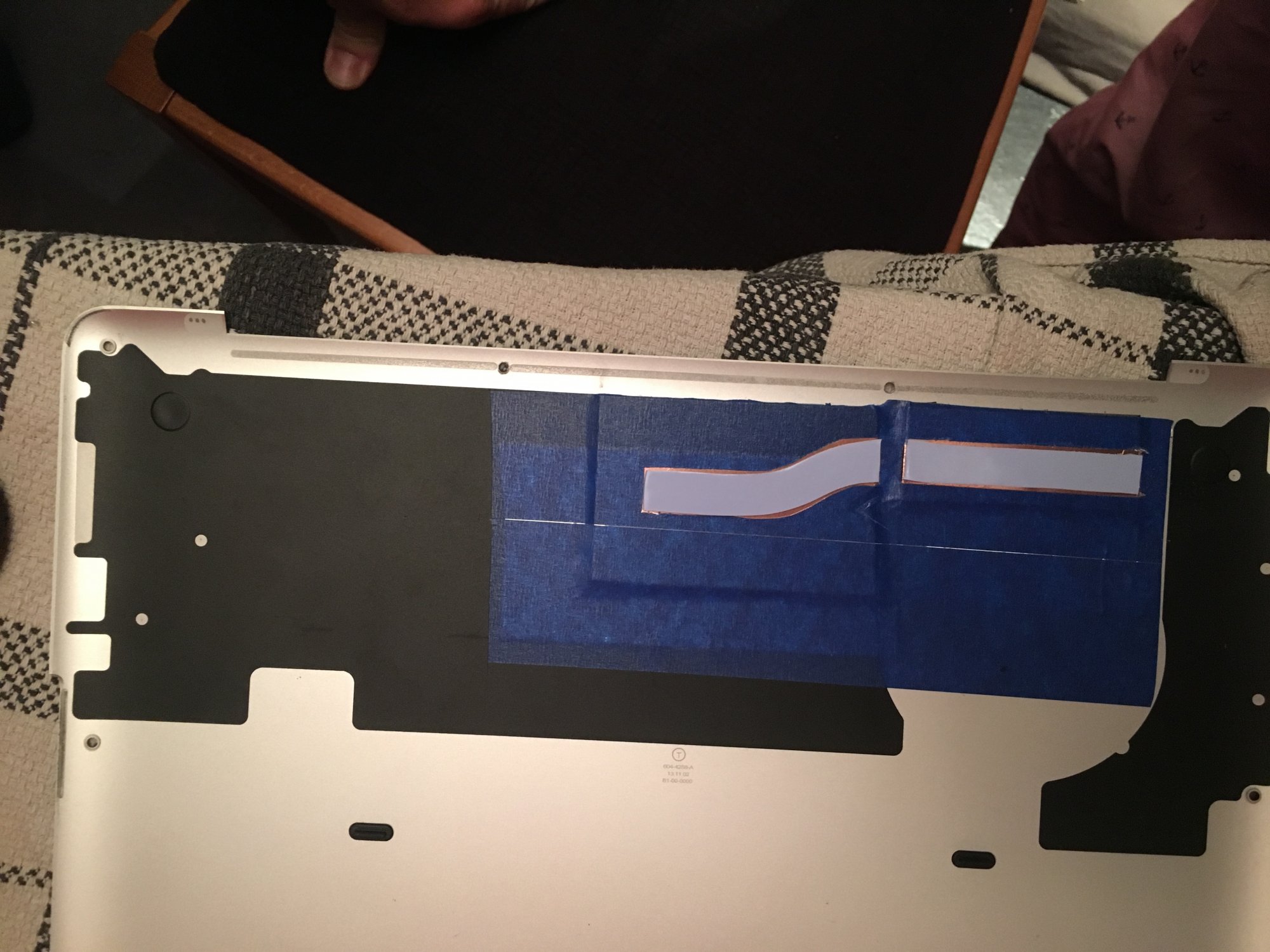

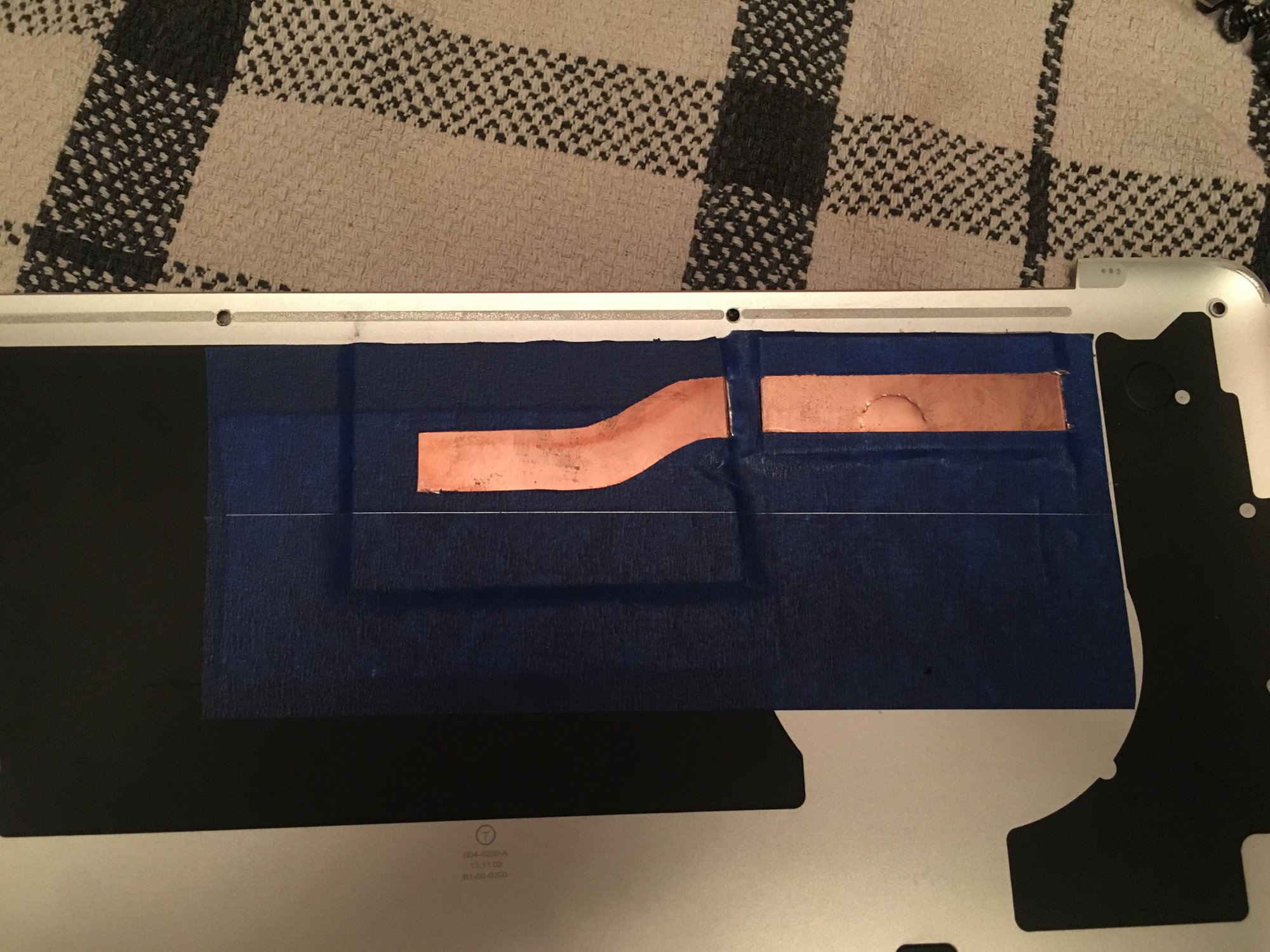

Hi, first thanks a lot for your post, it made me realize that I was't the only one with this idea and it made me actually do the fallowing project. So I did what you did, but with a little twist. I have 1,5 mm of room, why don't I try to add a copper plate?
Ill explain the project and will fallow withe the result and my opinion.
First thing I opened my late 2013 13 inch MacBook Pro and removed the heat sync in order to sand off the black coating exposing the copper surface. The heat sync is held up by five screws so quite easy to get out. The heat sync on my model was 30$ on eBay so I figured not the end of the world if I end up damaging it. By removing the black coating I was hoping to get better heat transfer and to have a little bit more clearance between the heat sync and the bottom case. If you decide to remove your heat sync you will have to replace your thermal paste witch is not a bad idea, even if you have a newer model. Plenty of videos are available on how to do so and how much thermal paste you need to apply.
Here is my heat sync back in my macbook.
Next step was to figure how much clearance I had between my heat sync and the bottom case. By putting small stickers ball on my heat sync and compressing them by putting back my bottom case, I figured I had about a little more than 1,5mm of clearance. I measured my flat stickers ball with calipers.
I bought a 1mm thick 10cm wide square copper plate of of eBay for about 5$. I tried a 1,5mm too but it clearly did not fit.
Next step was to cut my metal plate. I did two stencil using paper. I traced the paper stencils on my copper plate and cut the two peaces.
I placed the peaces at their right position in the macbook, by sticker balls to the plates and closing the macbook, I transferred the right position of the plate on the bottom case.
As you can see on the next pictures I had to remove a bit of the isolation layer on the bottom case.
Next I applied a a even thin layer of thermal pasted on both plates and stick them in place.
I used a layer of aluminium tape with a layer of masking tape to make sure to not short anything on the board. If you have access to Capton tape It would probably make a better job.
Again by using stickers balls I reported the heat sync position on the tape and cut a 1 cm channel.
I used .5mm silicone thermal pads and cut them to the right size and put them in the channels.
I bought a kit with .5mm 1mm and 1.5mm pads off of amazon to make sure I had the right thickness.
Only thing left was to close the laptop.
Now for the results, I did not expect to draw more heat out of the machine by using a copper plate. In theory more heat can be transferred cause I used a thinner silicone pad but I don't think that it is making that big of a difference.
My goal was to spread the heat more evenly across the bottom case and I am satisfied with the results.
The heat is distributed across almost all of the bottom, of course a little bit on the right side, but there is no very hot spot. Under small load like 1080p youtube steaming the bottom case became warm to the touch nothing more.
In my case my laptop was't thermal trotting, I could keep my dual core i5 around 70c with a custom fan curve. So I did not achieve any more performance. The big difference is in the noise level. By using a cooling pad at low speed, my laptop fan stabilise at about 2500rpm out of the max 6500 for 65 to 70c under full load. The laptop and pad combo remain silent.
I am satisfied withe the result, I paired my laptop with a egpu so I end up with a pretty powerful silent machine.
The whole project cost me about 20$ and I would totally recommend it.
Hope you enjoyed

Edit 15/06/2020: Adding a small heatsink that rests on the bottom of the laptop with a slow fan pulling air across it I can sustain >70W combined load. CPU >3.4GHz and GPU > 900MHz for hours at a time with temps in the mid/high 80's.
Just reactivated my account to post that I did this mod on my MBP 16 2.4GHZ, 64GB, 5500M 8GB.
Cut my fanspeeds in half for day to day work and fixed my throttling in games.

Theory
Application
Results

2018 13 inch MBP i7
Found these copper plates on Japanese Amazon to replace the pads
Secured the plates with thermal paste, added a 0.5mm pad strip in the middle where the pipe sits down a bit
Heat pipe seems easy to puncture so I didn't strip the black paint; added liquid metal
It's seated on a bag of iOpener from iFixit (and an old eraser)
Can run at 35 watts (3.3Ghz all core average) power limit without throttling for about 30 minutes before going down to between 27 to 35 watts (3.0-3.3Ghz), with Macs Fan Control set to Full Blast
