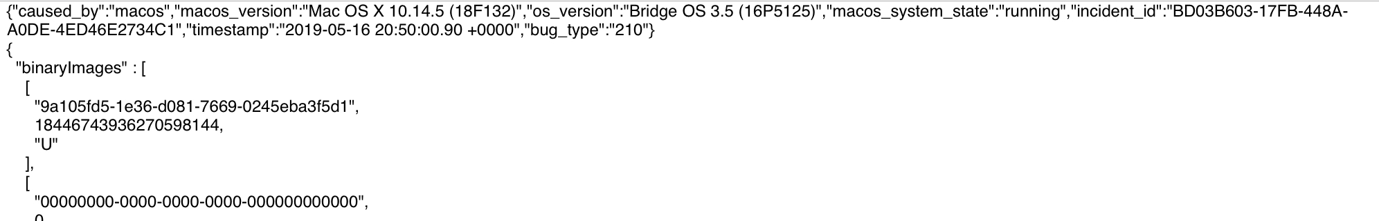

Of course right after I post this. And I Have the new 10.14.5 update
{"caused_by":"macos","macos_version":"Mac OS X 10.14.5 (18F132)","os_version":"Bridge OS 3.5 (16P5125)","macos_system_state":"running","incident_id":"2040A01D-18D1-4A33-B28F-9ED9AAAAC5CA","timestamp":"2019-05-24 20:07:07.94 +0000","bug_type":"210"}
So far in the last 3 weeks I have not had too many issues. I have had it crash a few times in Premiere but that could just be Premiere. Only one total crash and restart but I did not get an error log. I have not stressed this iMac pro yet. We did a couple small projects and had it make proxies, but now it is in the hands of my GFX guy hopefully this one is not in the 30% that has T2 chip issues.
[doublepost=1558732806][/doublepost]

Does this system have any external drives attached? I've seen the BridgeOS error 210 caused by a mounted hard disk array and by an optical drive that was giving hardware errors.
View attachment 837864 Seems like this is an issue related to a failed firmware of T2 chip. Updating or restoring the firmware should fix the issue in most cases. https://eclecticlight.co/2018/07/30/recovering-from-failed-t2-firmware-updates-and-related-problems/
