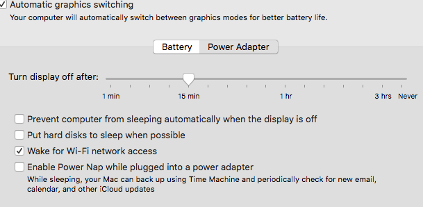

Energy Saver settings
  • Power Nap
  • Wake for Wifi Access

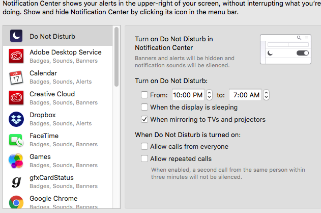

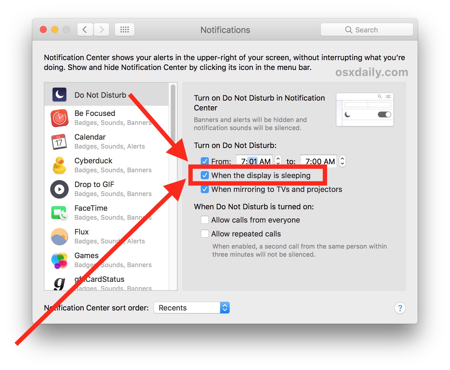

Notifications
  • Do you have them set to DND when the display is sleeping?

Here's my settings:
Default Start up Security, I made no changes
Power settings:
Notifications, I didn't make any changes this is, in fact this is probably the first time I even went into that preference pane.
