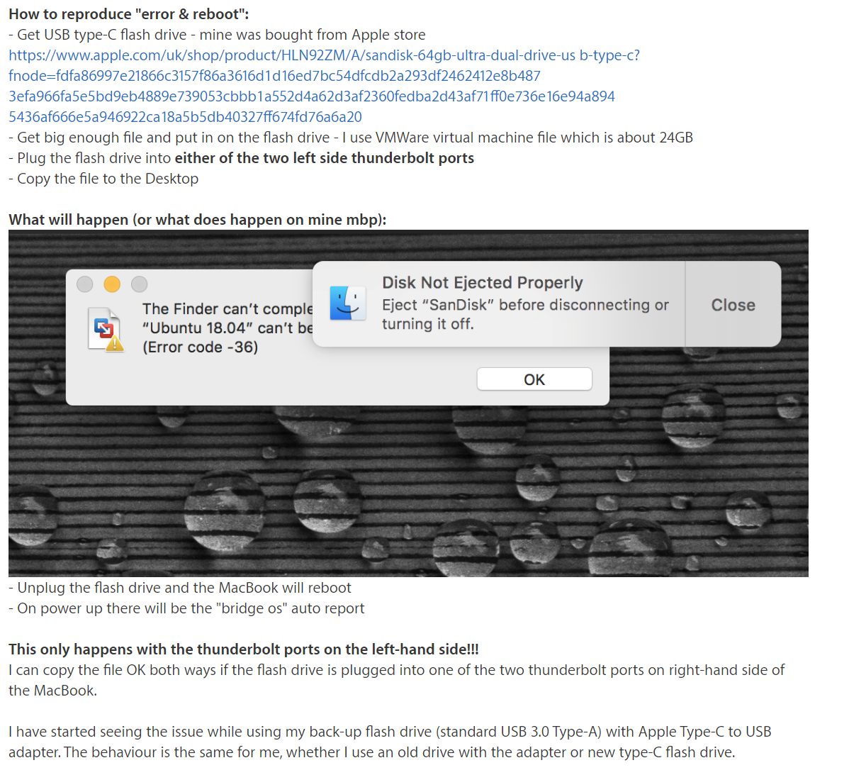

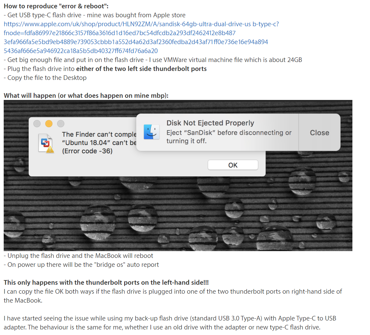

God I’m so bad at remembering names, but there’s “one guy” as I always say, on this thread who had a way of bringing this on each time.
https://discussions.apple.com/thread/8465477?page=10
Scroll down to a guy called Horho77, they pasted the same thing here too. More awareness - better for us.
They found a way of replicating it each time. It would be amazing if someone with the latest beta tried this out, but I can totally understand if they don’t. I wouldn’t wish this on anyone. Literally playing with fire.
If someone can report back that there is no issue, then god bless!! We are in good hands, if not.. pls send help

Sorry for my ignorance. I understand T2 chip is in 13" as well but most reports here are from 15". Is 13" as badly affected as 15"? Going to buy maxed out 13" soon and kinda concerned. :(
Well there is a user on this post https://discussions.apple.com/thread/8465477?page=10 by user horho77
who is using a 13" and found a way to replicate, so I wouldn't say any particular model is safe.
There are users who said they have never got a KP, @maflynn springs to mind (he has the 15" model) and I would trust him. So it sounds like very specific operations cause the issue.
The steps shed some light on what the root cause can be:
Of course this is just one example of how the error comes about and there could be many other scenario's - some have mentioned they use no peripherals and got the error. Take what you will from that.
