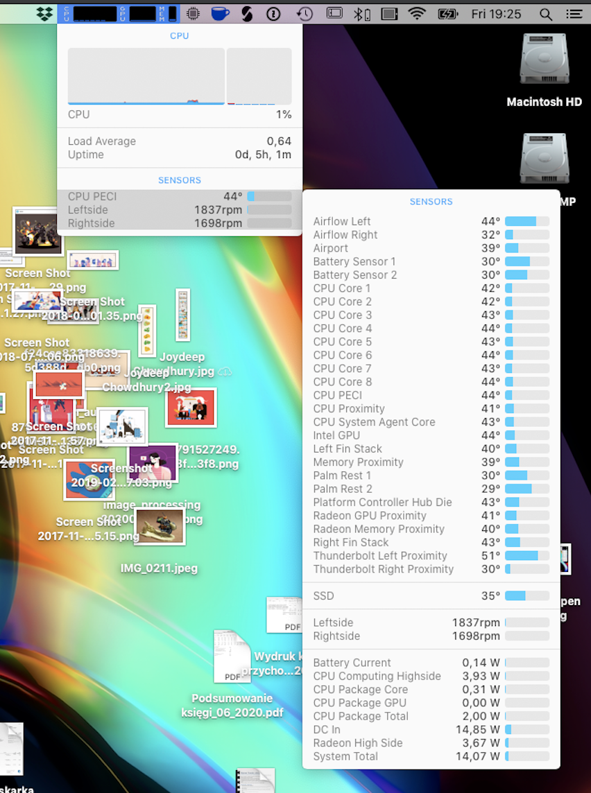

It Works awesome for me with lid open. It’s even better in clamshell but I’m too lazy to close the lid now... I got 1440p + Razer Core x with RVII.

This laptop with the external monitor and lid open is CRAZY cold.
CPU/GPU temps are 45c on actual use with Slack, PHPStorm, Browser, Terminal, Webpack
