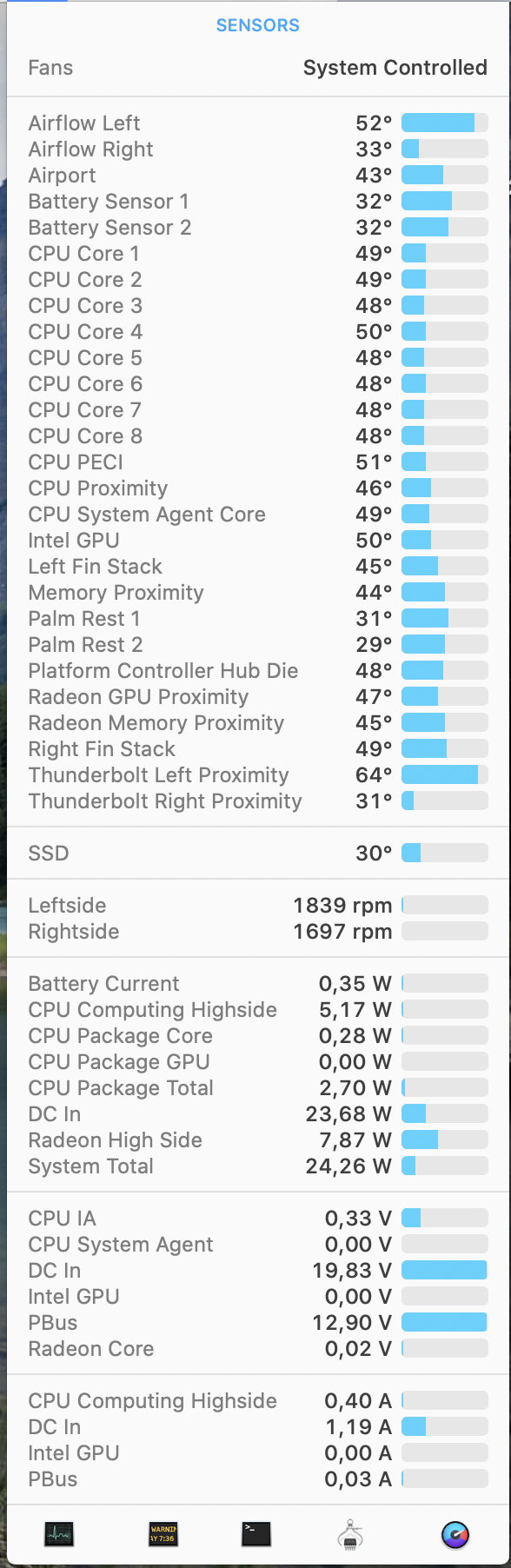

Ok, using my previous post (clamshell) as a template with some extra's left out. This time Lid open.
The laptop is just sitting flat on the desk so no extra cooling as with a stand.
Some info:
  • MBP 16" 2,3GHz i9, 32GB RAM, 5600M graphics.
  • Lid open mode
  • LG 34WK95U on a desk-mounted arm. Using the provided TB3 cable by LG.
  • Resolution: 3360x1417 HiDPI(full 5k2k resolution is tiny! Very sharp looking though, but so is this)
    • Mac standard scaled resolution in the Display settings pane, one to the right (more space)
  • Wallpaper resolution: 3440 x 1440
  • Connections:
    • 1 port: TB3 cable for display/charging
    • 1 port: TB3 (USB-C) to TB2 adapter --> TB2 to ethernet adapter (seriously, Apple. Double dongles for RJ45?)
    • Both connected on the same side.
Temps/Power after a few minutes idle:
  • CPU:
    • 47°C proximity with cores dipping to around 48°C
    • For reference:
      • Idle without external monitor I've noticed so far is around 40°C
      • Idle clamshell with external monitor was cores lowest also 40°C with the proximity the same 48ish °C.
  • GPU:
    • Radeon High Side 7.95W
    • 5600M: 56°C, proximity 46-49°C
    • Intel UHD 630: 47°C
  • Thunderbolt Port:
    • 60 - 65°C
    • Same as clamshell
  • Fans:
    • Around 1770 RPM average all the time, quiet, unnoticeable.
    • Left side higher by about 100RPM because TB3 ports connected on that side I assume.
    • Same as clamshell
Note: This is Idle after a few minutes. Safari open with one tab (website), Messages open, Mail and Activity monitor open in the background. Also, I do have airconditioning in this room.
General/Performance
Everything feels quick and responsive. Same as with clamshell.
Typing this while playing a youtube video in the background tab for music (safari) cores are 54-58°C and Radeon high side continues to go back down to 7.95 with some short spikes with usage mostly keeping below 10W.
Conclusion: It definitely does not heat up significantly just by using an external display with lid open.
Attached: iStat sensor data just before opening this website with the apps open as mentioned above.
Reactions: Minga089 and sauria

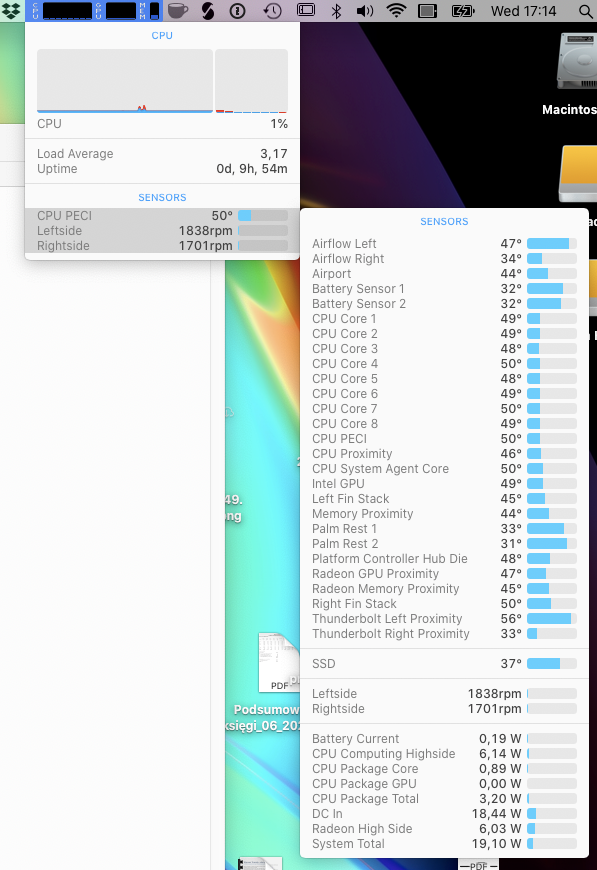

My 5500 is not that far away in clamshell mode than your 5600 :)

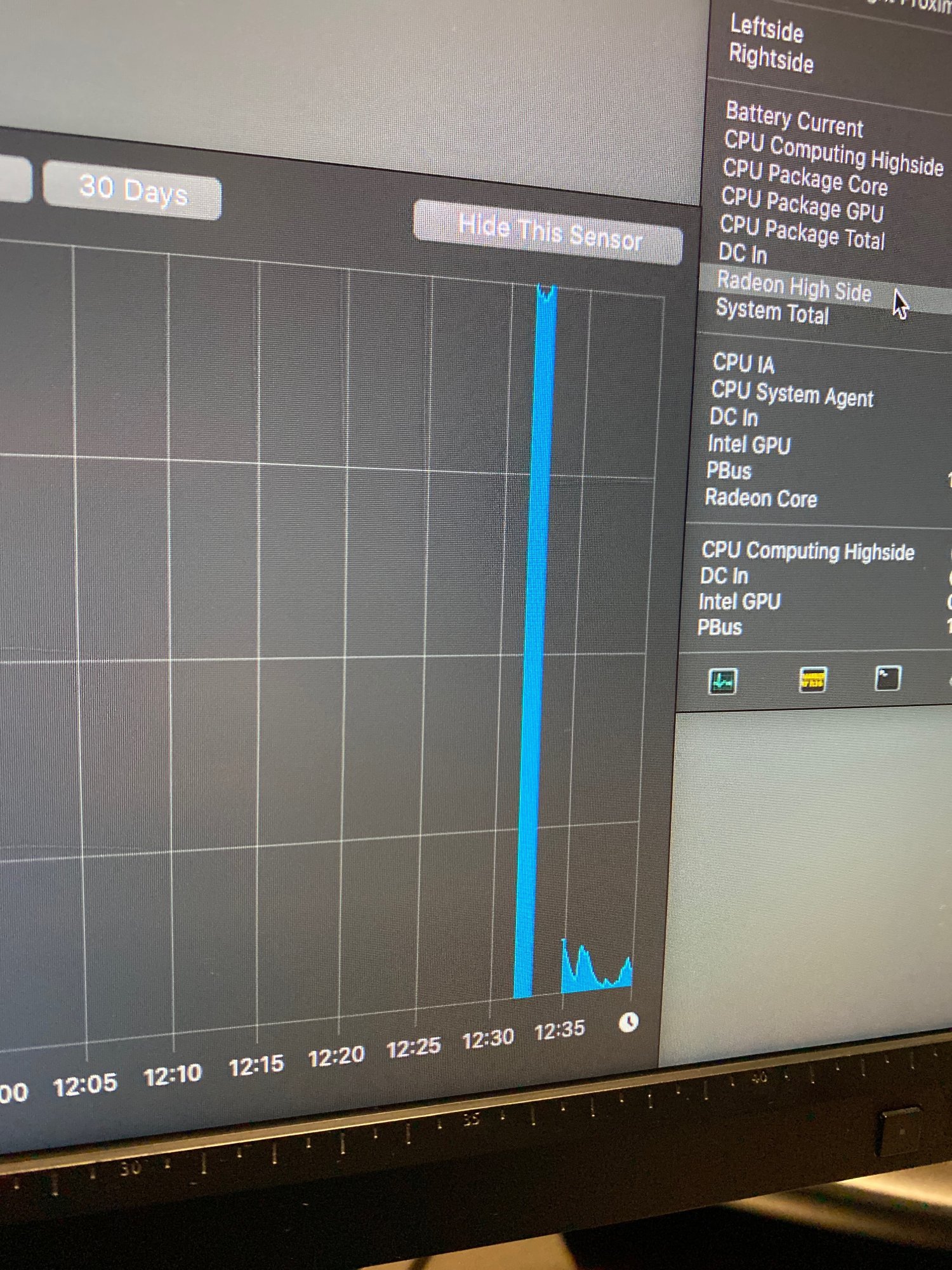

One thing that isn't talked about much in this thread is how high wattage pull can go on the 5300m and 5500m -- not just idle. Idle doesn't exactly replicate real world use, but at the same time use that could easily be supported by internal graphics.
Anecdotally I saw that the 5500m would spike into the high 30 watts when have two videos open on an external with the screen open. It definitely is a worse option than the 5300m if all you care about is coolness. But neither are good.

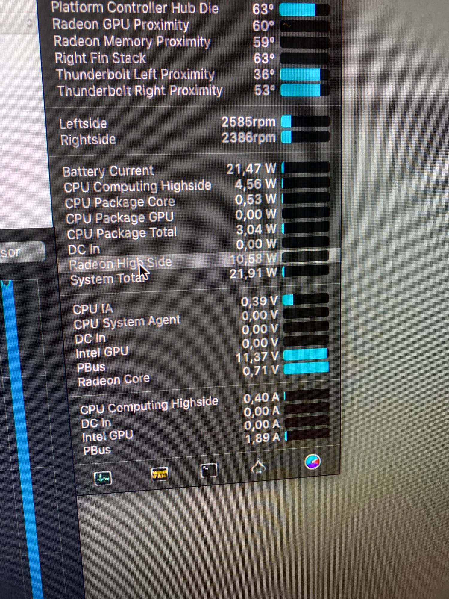

I've just tried booting in Safe Mode while connected to and external monitor with lid open aaaand Radeon is pulling 10w (see the attachments).
I'm star thinking that it's really a driver problem and not hardware related one!
Anyway to "temporarily" fix the problem i've just buyed a DisplayLink dongle to connect my displayport monitor, hope that works, i'll let you know when it will be delivered.
