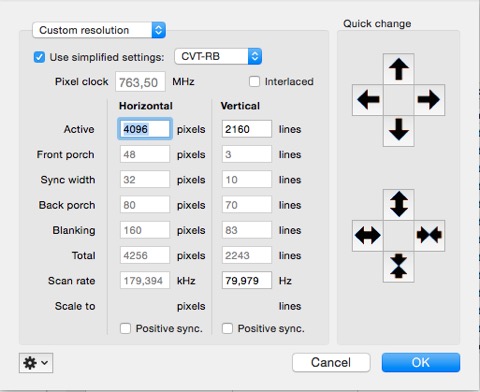

Your screenshot shows a refresh rate of 79.979, not 59.9966. In any case, refresh rate is an aggregate value while the frequency of the signal itself is the pixel clock of (in your case) 763.5 MHz. Is it this that needs to be synchronized? Will SwitchResX show what it is for the internal monitor, and then if you tweak the external settings to get the same value, will that take it down to 5 watts with lid open?
Hi Robert, I borrow that screenshot from switchResX website. My setting is 4k @ 59.996hz using CVT-RB(Reduced Blanking) timing standard.
I am also aware the total bandwidth of the resolution must be lower than the bandwidth of the Displayport/HDMI with a 5-10% margin. It is because the memory clock will be stuck to max if there is not enough blanking time for the memory clock to switch.

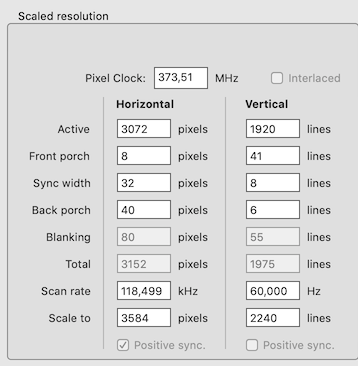

I also can confirm @kelvincht is correct. I'm trying to use my MacBook with an external 4K monitor while the lid is open and once I copied resolution and timings from the internal monitor and applied them to the external (it accepts a wide range of resolutions and timings) the system power consumption immediately dropped to 16-20W while "radeon high side" itself to 5-6W. The only downside: the image on the external monitor is distorted due to incorrect resolution.
Hmm, I tried to do this by matching the settings shown in the screenshot but it didn't work. Note, in my case when setting on the external monitor the "Scale to" fields were greyed out, not sure if that makes a difference.
