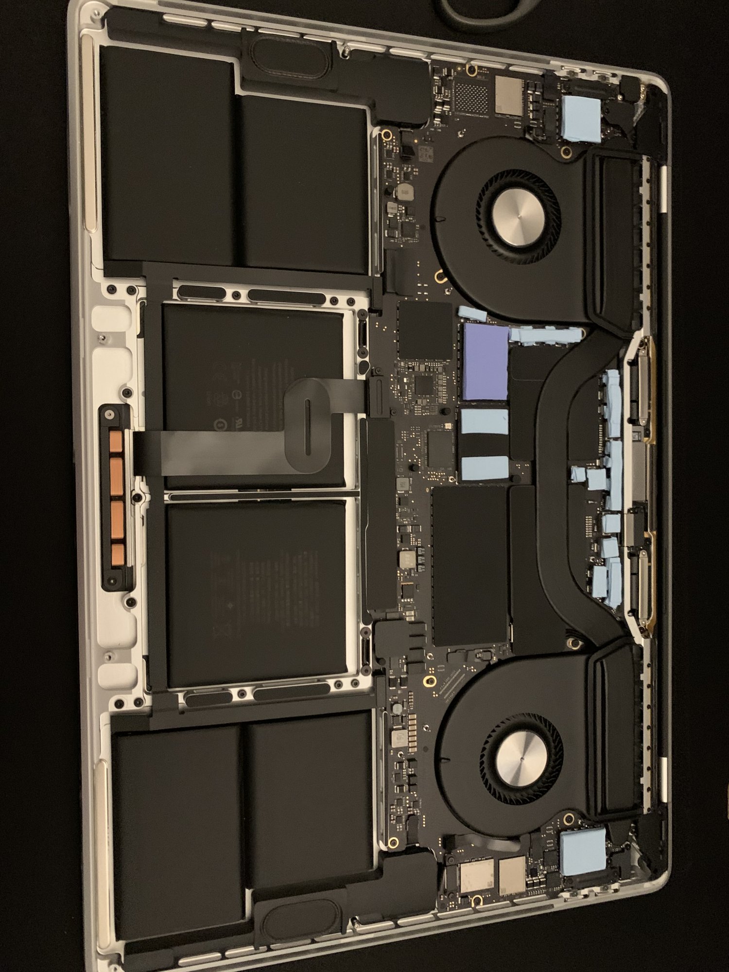

I ended up getting frustrated and doing the VRM cooling mod - where you stack some thermal pads on the VRMs so that they reach and dissipate their heat into the bottom shell. These are the chips delivering power to the GPU and CPU and are typically cooled on desktop setups and thicker gaming oriented notebooks.
No more fan when the monitor (Dell P2715Q 4K60hz via Displayport) is connected, and even when I have Photoshop, After Effects, Premiere, and Safari open simultaneously working on assets passing through all of them I'm only seeing a constant ~70% fan and more often seeing 3ghz+ clocks rather than the ~1.8ghz it'd settle into previously.
Still obviously getting the high radeon high side draw but this mod seemed to attack the cooling/efficiency aspect of that. Only downside is the bottom gets a little hotter in that area, but that's never bothered me with these. They already get hot from the factory.
I have tried the VRM mod.
It works and lowered idle temperature even when external monitor is connected using 18w.
With the mod, the idle temperature drop 3-5 degrees, making the fan quieter during idle.

It's the thunderbolt controllers heating up - I attached thermal pads from those to the bottom of the case, and voila problem sorted (I have 5500m)
Hi Jamalien, when you attached thermal pad for the thunderbolt controller, do you also attach thermal pad for the VRM as well?
Haven't been following this thread, but I see people recently saying that it's the gpu causing the fans spinning up (no it isn't?). It's the thunderbolt controllers heating up - I attached thermal pads from those to the bottom of the case, and voila problem sorted (I have 5500m)
do you have a photo of the thunderbolt controllers with the thermal pads or is there a photo of the internals that you can point towards the thunderbolt controllers?
I've just ordered some thermal pads that I intend to apply.
The thunderbolt controllers and VRM seem to be the cause of issues. I think the last couple of updates for BigSur changed how the internals work, which has messed up the machine when connected to external displays.
I have now also padded the both thunderbolt controllers as well as the Video Ram, and also the VRM.
I cannot believe, the result is further improvement. Fan is much quieter both idle and under load, even with external monitors and open lid.

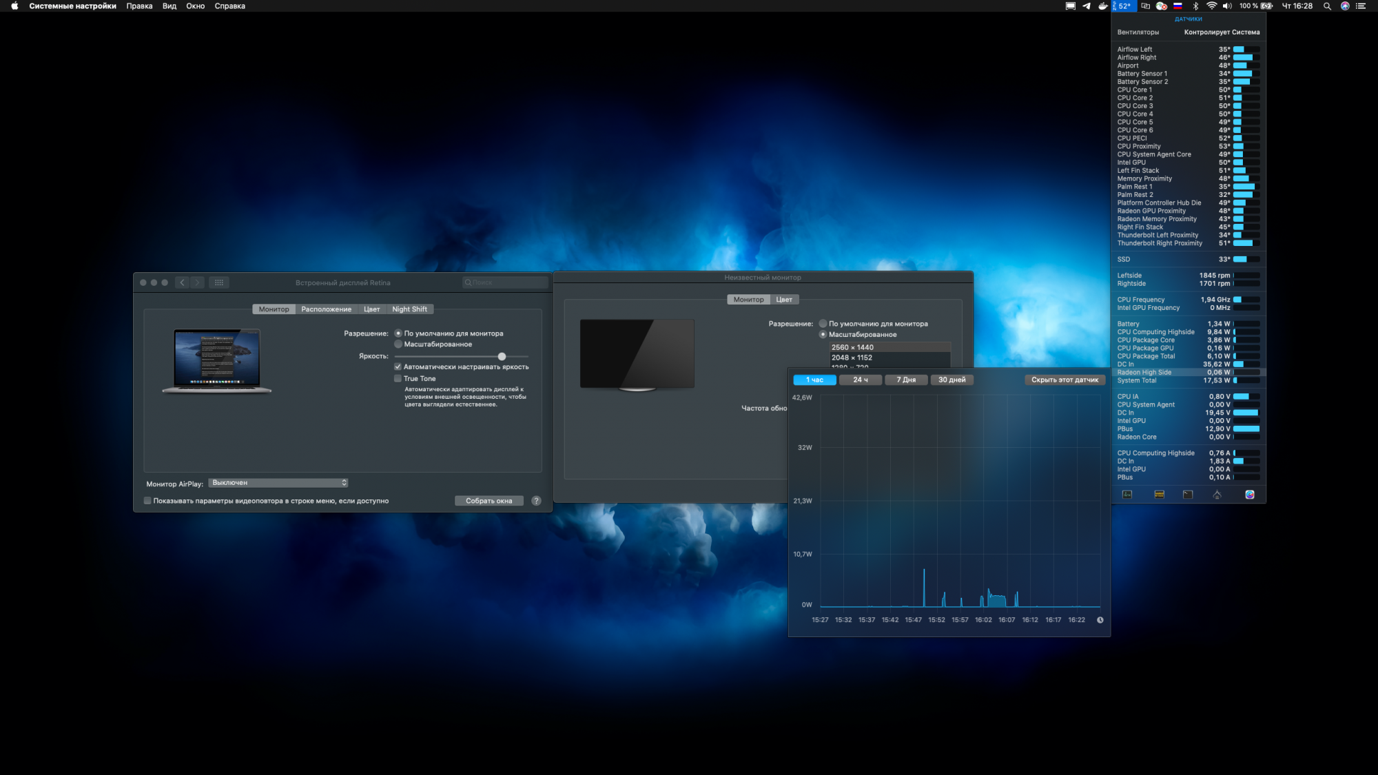

I fixed the problem with overheating with the Dell D6000 dock station which was using DisplayLink. Everything is fine, but HiDPI mode is not working, even with SwitchResX or RDM. Guys from DisplayLink know about it, and maybe they fix it in new versions of their driver.

It is good to know you are making progress with your method. Maybe I will also try it out. So, no heating at all when operating your MBP with open lid while connecting to external monitor?
Very busy atm but I’ll take a pic and do some testing with & without soon. Kelvincht’s response p much sums up my experience though
And no, I didn’t do the VRMs. My thinking was that they get preposterously hot compared to the thunderbolt controllers, so didn’t want them sharing the same heatsink! Also I thought that the VRM’s don’t have any direct or proximity temp sensors, so thought that any throttling or fan-ramp due to VRM temps was based on a predicted thermal profile, i.e. something that adding thermal pads wouldn’t fix. Maybe I’m ignorant tho
(e.g. maybe the VRM’s are well thermally connected to the nearby GPU and CPU, whereby VRM thermal pads would def make a difference)

No-no. MBP is not even using AMD GPU, it's converting video via CPU and sending them over USB. You can read about DisplayLink technology
The DisplayLink network graphics technology is composed of Virtual Graphics Card (VGC) software that is installed on a PC and a Hardware Rendering Engine (HRE) embedded or connected to a display device. The DisplayLink VGC software is based on a proprietary adaptive graphics technology. The VGC software runs on a Windows, macOS, or Linux host PC and takes information from the graphics adapter and compresses the changes to the display from the last update and sends it over any standard network including USB, Wireless USB, Ethernet, and Wi-Fi. After receiving the data, the HRE then transforms it back into pixels to be displayed on the monitor. While the basic network graphics technology can be used on a variety of network interfaces (Ethernet, and Wi-Fi), DisplayLink has to date only designed products around USB 2.0, USB 3.0, and Wireless USB connectivity.

I have tested in a few days and decided to remove the padding for the GPU RAM (VRAM). VRAM Generate too much heat and it could feed the heat back to VRM and Thunderbolt controller via the backplate.

Where would you advise to apply padding on the 15" 2019 machine?
