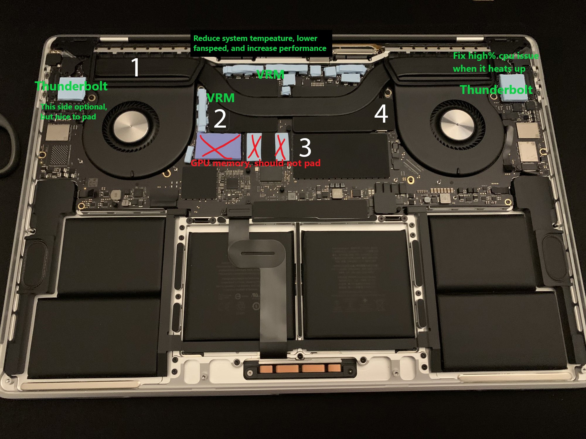

I have now also padded the both thunderbolt controllers as well as the Video Ram, and also the VRM.
I cannot believe, the result is further improvement. Fan is much quieter both idle and under load, even with external monitors and open lid.View attachment 1754821

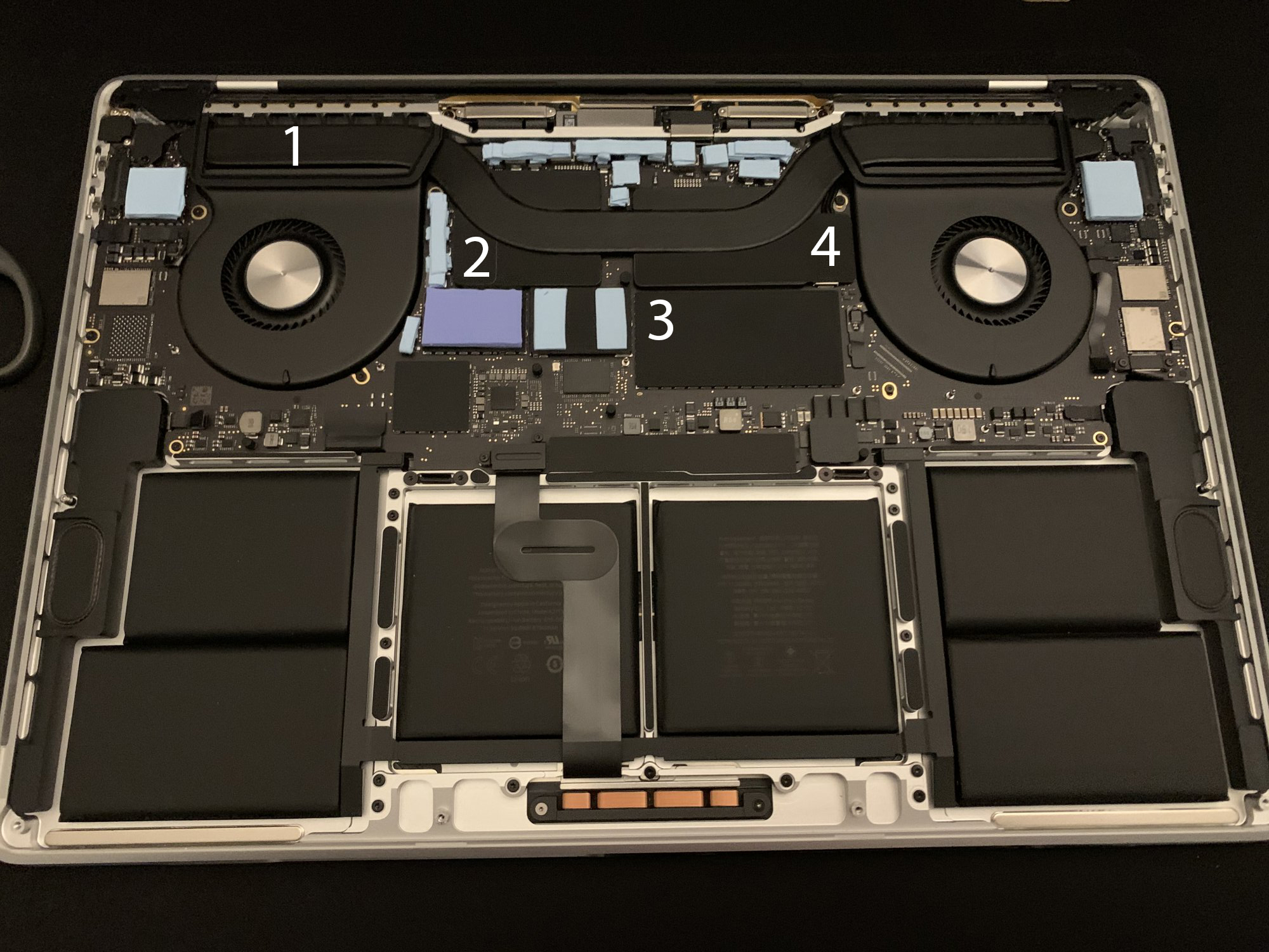

I have applied several pads and it's helping. I now want to add more because summer items are coming.
Can you please share your thoughts about padding these 4 areas in addition to what you have done?
Padding these wouldn't help
1. Is the heatsink and shouldn't be padded as it would heat up the backplate too much and make every other padding worse than it is
2. is part of the GPU. Should not be padded
3. Is the RAM and doesn't need cooling.
4 is part of the CPU and also shouldn't be padded.

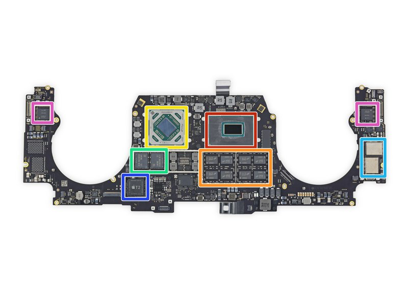

For reference: The picture from iFixit's teardown of the 16".
Also: The black tape on the components is a heat shield. It keeps heat inside. so padding on top on the black insulation is pretty inefficient. But if you remove it, your warranty will be void for sure.

Why do you not want to pad the GPU and CPU? The GPU is the major offender here, so in theory we should pad it first, no?
Because their heat is already dissipated by the heatsink. The bottom plate can only soak up and dissipate a certain amount of heat. If you now connect the GPU or CPU to it via thermal pads, this heat would also heat up the VRMs as the bottom plate will become hotter and hotter and transfers heat back to the VRMs.

My final padding removes 2 and 3 (GPU memory) because they generate too much heat to the black-plate, and the heat transfer back to the VRM and TB.
