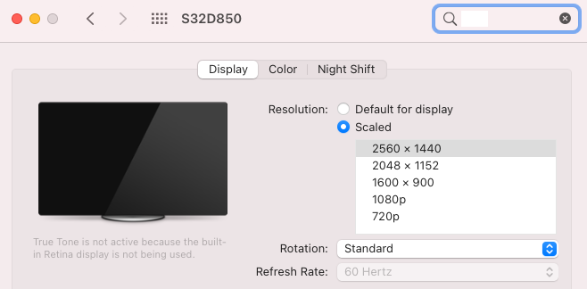

SOLVED by 1440p HiDPI: MacBook Pro 16" is HOT & NOISY with an external monitor​
anyone tried this?
Nothing new and already stated by various people in this thread. I run my 24" 2K monitor in 2048x1152 HiDPI in Big Sur and get the following Radeon High Side values in clamshell mode:
- 2560x1140 (native): 17-18W
- 2048x1152 HiDPI: 5W
But that applies only to clamshell mode. I can just encourage everybody with a intel Mac and 1440p monitor to try HiDPI mode. The difference is night and day and it looks much better.
