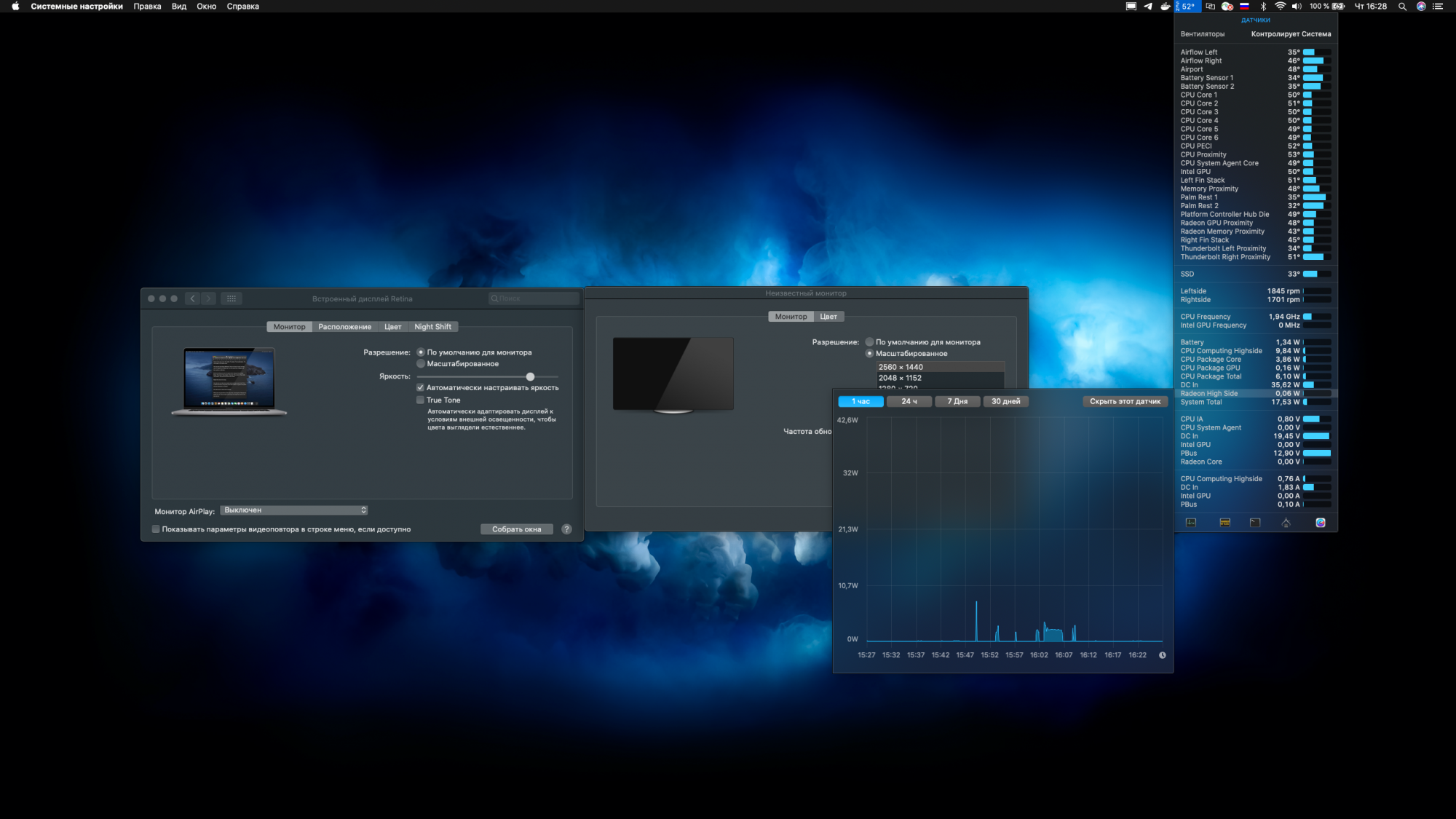

I fixed the problem with overheating with the Dell D6000 dock station which was using DisplayLink. Everything is fine, but HiDPI mode is not working, even with SwitchResX or RDM. Guys from DisplayLink know about it, and maybe they fix it in new versions of their driver.View attachment 1755256
I have the same setup as you with the Dell D6000. I'm using a little utility called Display Menu to control resolutions on my monitors. I have access to the HiDPI resolutions in this way. Hope it can help.
Hmm, I tried every software to fix it, but it just shows my Dell UP2616D in mac settings like 'unknown display' without any HiDPI resolutions((. Same with HDMI and DP.
I have the same issue, do you think this would be solved with the Silicon Valley processors?

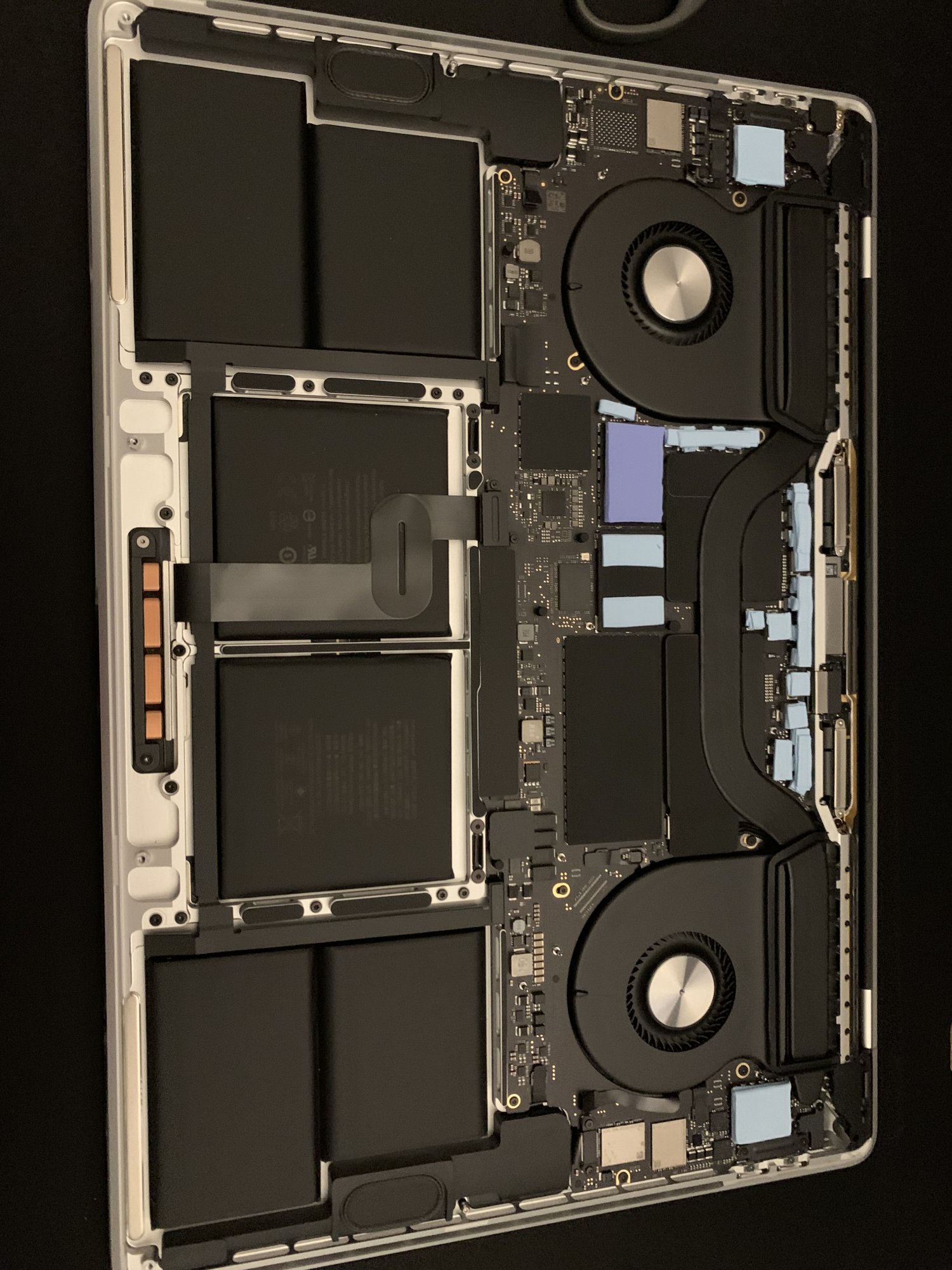

I have now also padded the both thunderbolt controllers as well as the Video Ram, and also the VRM.
I cannot believe, the result is further improvement. Fan is much quieter both idle and under load, even with external monitors and open lid.
I cannot believe, the result is further improvement. Fan is much quieter both idle and under load, even with external monitors and open lid.View attachment 1754821
Would you mind sharing how much the temperatures has improved after applying the thermal pads?
Thanks,
Tom
Thanks,
Tom
Heatsink temperature fully warmed up during idle with 2 external 4k monitors and lid open.
No mod = 66C, fan comes up all the time
with VRM mod = 61C, quiet during idle, fan comes up for light load
with VRM mod + thunderbolt = 61C, fan comes up with heavy load
with VRM mod + thunderbolt + small fan under back plate = 57C, fan comes up only with sustained heavy load

The recommendation is try not to use anything more than 6 W/mK because it would make the backplate too hot and potentially over heat some parts.
Both 1.5mm and 1mm works. 1mm you need 3-4 layers, where 1.5mm you only need 2-3 layers. If you have a choice go for 1.5mm.
What W/mK did you use?
And what if we use 3mm instead of 1.5mm thickness?
Reactions: Yurk
I used Arctic Thermal Pads with exactly 6 W/mK.
They work pretty good especially with my little printed standoffs that allow better cooling of the bottom plate.
