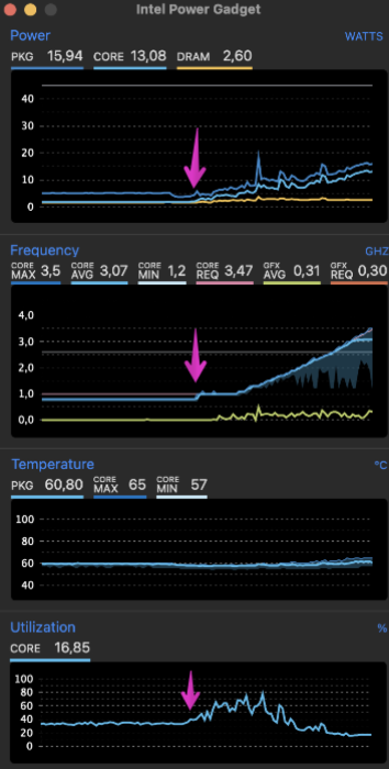

Hi,
I was about to open a new thread talking about how pissed I am with my MacBook Pro 16" 32 GB RAM. But I see my problem have been discussed here a lot.
I can't believe I can't use this expensive machine with my 32" 4K external display and Google Meet. As soon as I launch Google Meet, the computer becomes unusable.
This is what happens when I close the Google Meet window (pink arrow indicates when I turn off Meet):
MacBook Pro 16%22 32 GB: very poor performance with external monitor (screenshots inside) : ma...png
Things start to go back to normal.
So I guess since I'm stuck with the Radeon Pro 5300M, I only have 2 options:
1. Buy an eGPU (expensive and inconvenient)
2. Sell my MacBook and get another one with a 5500M
Is that right? Thanks!

No, 5500M doesn't help either. Only 5600M is the option. :-(
Reactions: jagooch
Thanks for the clarification! I just took a look at the 5600M upgrade price: 1.000 USD (in Spain). This is NUTS!!
I would have to sell my current MBP (3 months old).
However, I'd lose some money on that. So, being able to use the computer when running Google meet would cost me around 1.500 USD. INSANE!
I'm stuck with having to buy an eGPU. I'm going to start looking for the cheapest option, since I don't need it for gaming or heavy stuff.

I tried the eGPU route with the 16". It works well except for the extra costs and the extra noise...though significantly quieter than the 16" MBP on its own. For audio production, depending on your set up, that could be a problem, or not. It was an issue for me. There are also fan upgrades that make eGPUs quieter than the one I bought (and returned).
Buying a 5500M will be WORSE.
5600M (ka-ching !!) will be much better. If you need a 16" Intel machine, this is the only one *I* would consider.
My two cents...if you don't have specific Intel based needs. Get any M1 machine or wait for the upcoming machines in the Fall.
