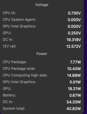

I tried the HDPI fix and the monterey beta and neither seem to work for me (set low power for battery and plugged in mode) - both still have the GPU at 18w on idle.
I tried to reset NVRAM however got some errors due to find my mac not being disabled by the old owner - would this be causing any issues?
This is on a 4gb 5500m with 3840x1200 res widescreen via usb-c or hdmi. As soon as I unplug and use the laptop in normal mode it drops gpu down to 2w or less so its definitely an issue of it spooling up when connected to my monitor...

So I have done a fresh install of Monterey Beta 5, set the power and battery modes to low power and it makes zero difference for me when connected to my external display. Still sits at 17w-18w, if I unplug the mac it goes down to 0.1w for the radeon. In Windows with bootcamp drivers the radeon sits at 4w with the external display so i'm not sure why it isn't changing with beta 5.

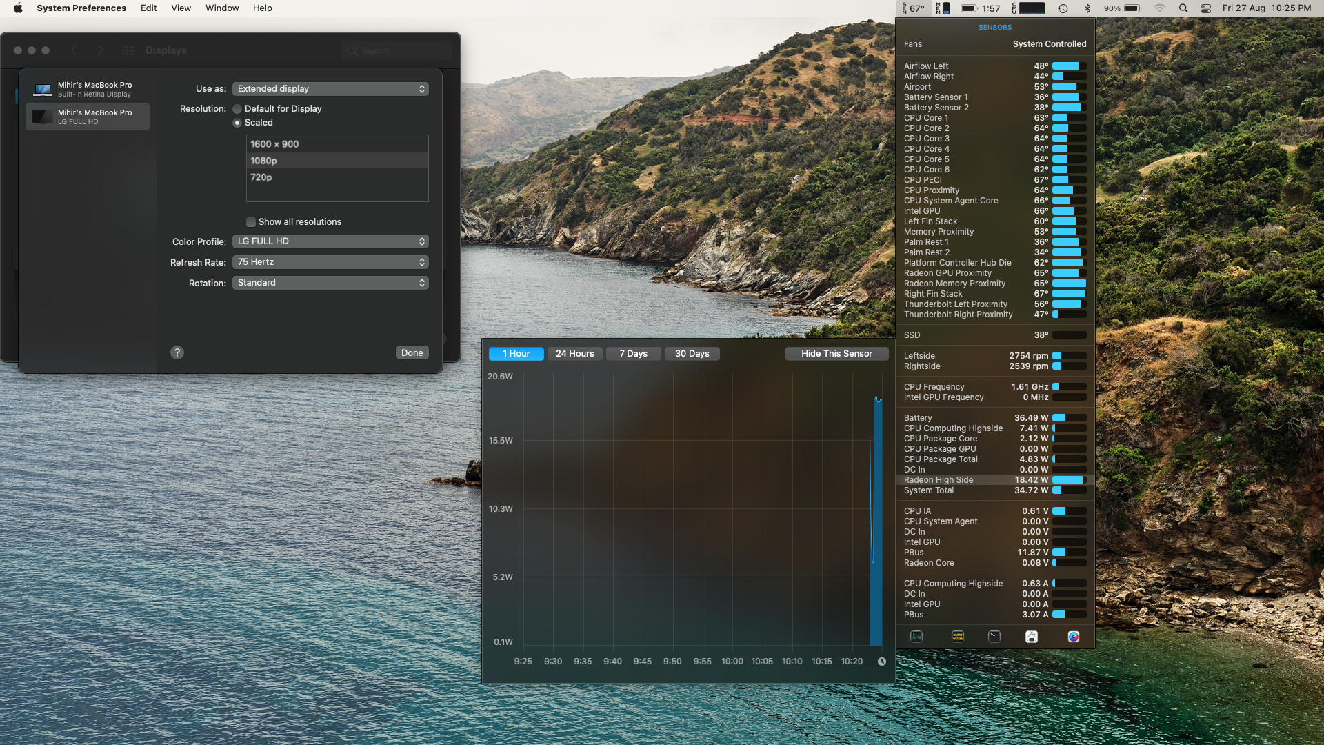

Nope, it doesn't. I tried a 1440p 144Hz monitor at a friend's place. On Monterey Beta 5,
Low Power Mode On: Internal 60Hz + External 1440p 144Hz consumed 18W.
I also own an LG 1080p 75Hz monitor.
Low Power Mode On: Internal 60Hz + External 1080p 75Hz consumed 18W again.
However, with the same monitor:
Low Power Mode: Internal 60Hz + External 1080p 60Hz consumed 5W.
