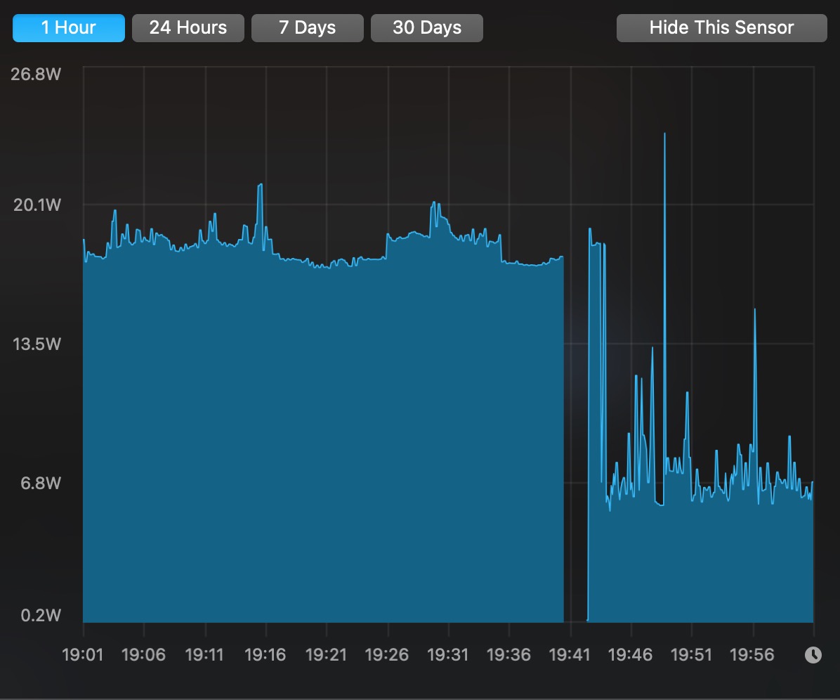

I would like to thank everyone here, who gave an information about one-key-hdpi script. Now my MacBook Pro (16" with 5500M) is quiet as a normal machine when using elder 27" 2011 2560x1440 iMac as an external screen (in target display mode). The last thing to do — clean the MBP from inside, since there's some dust is seen thru vents.
You all may see, what happened with a consumption for Radeon:

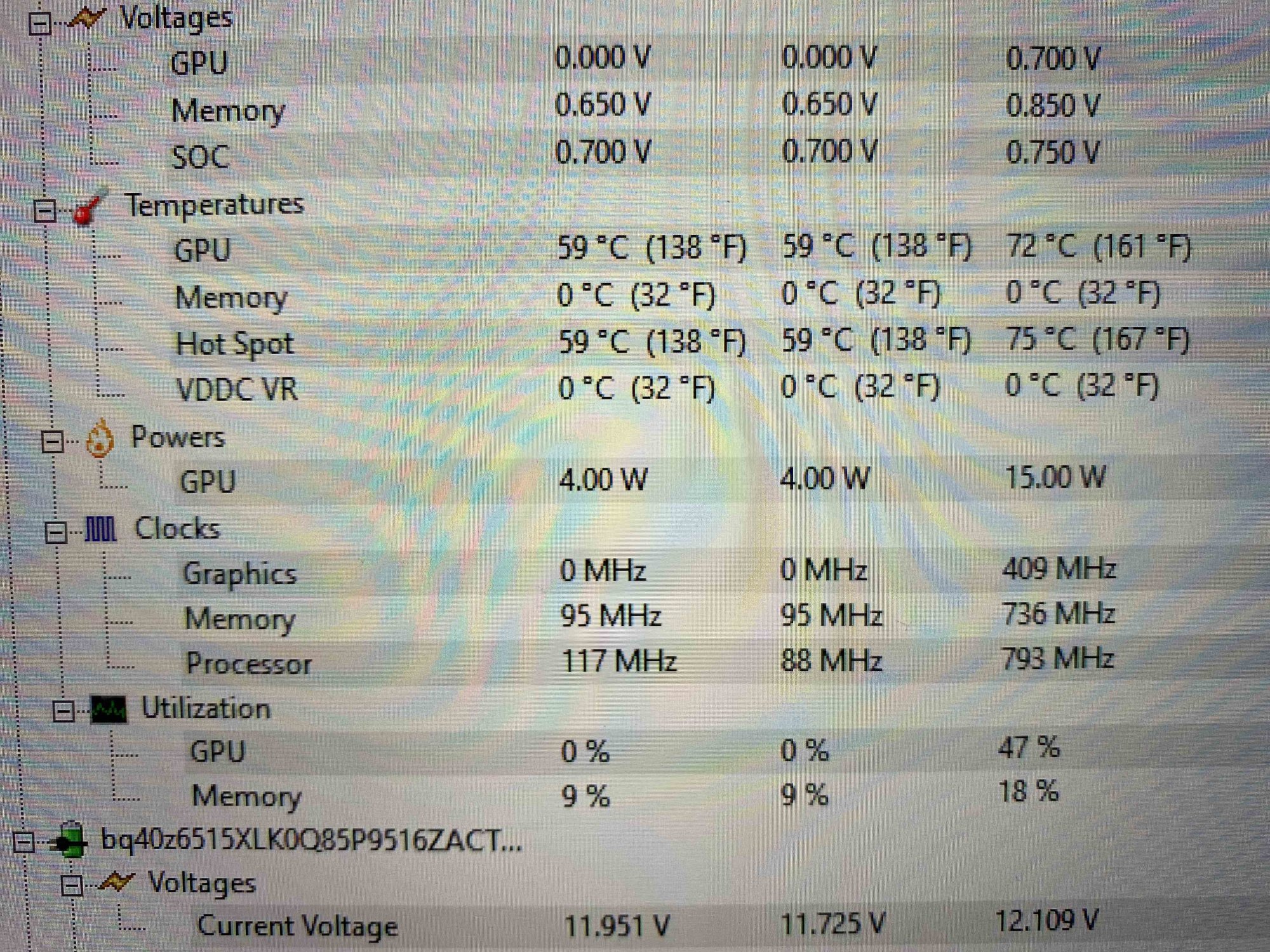

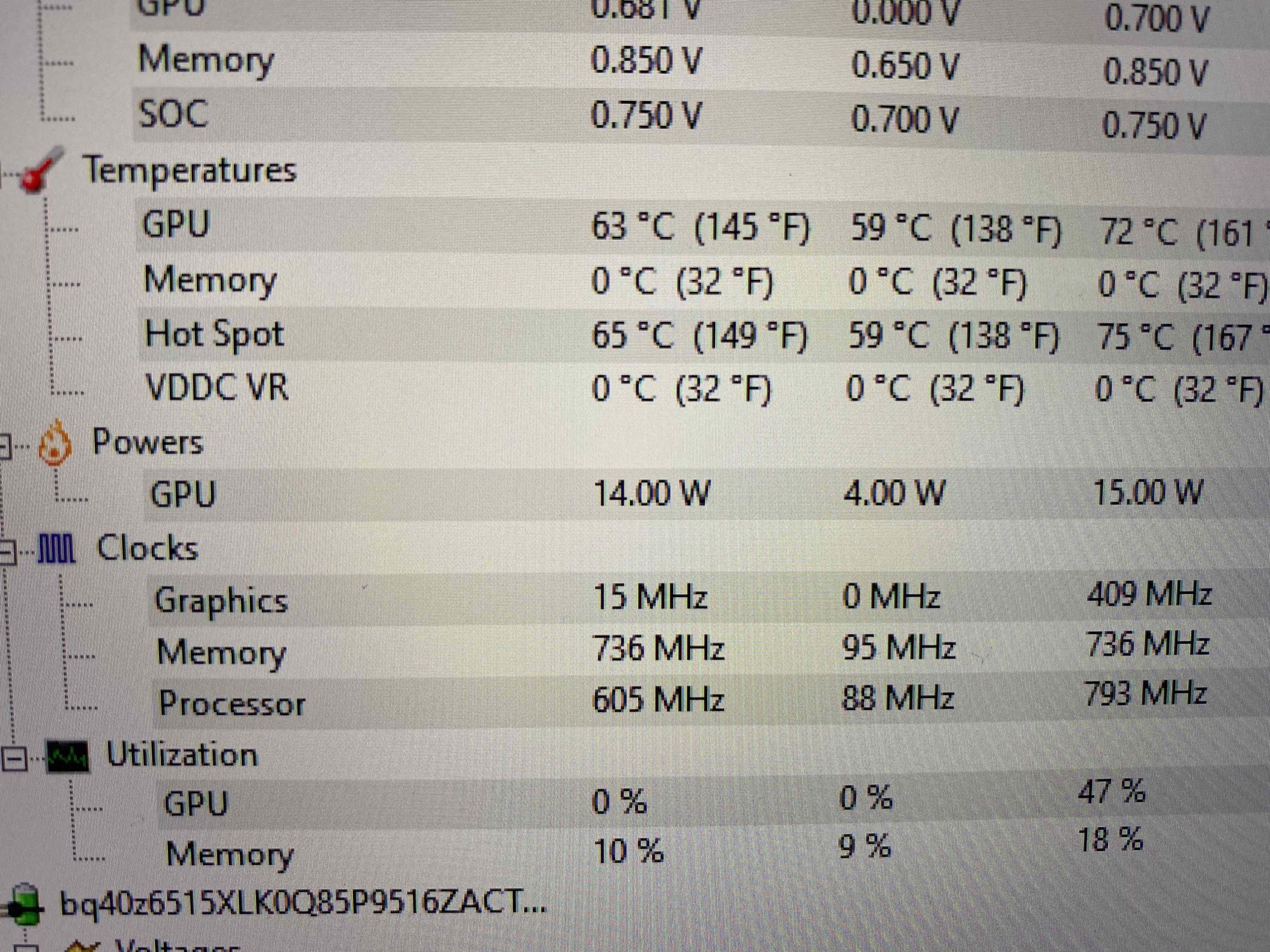

I was wondering about Bootcamp but it seems the problem exists there too, so I guess this is AMD drivers issue?
4W without external display:
14-15W with one external display
It's not 18W like on MacOS but fans still kicks in as soon as I connect display.

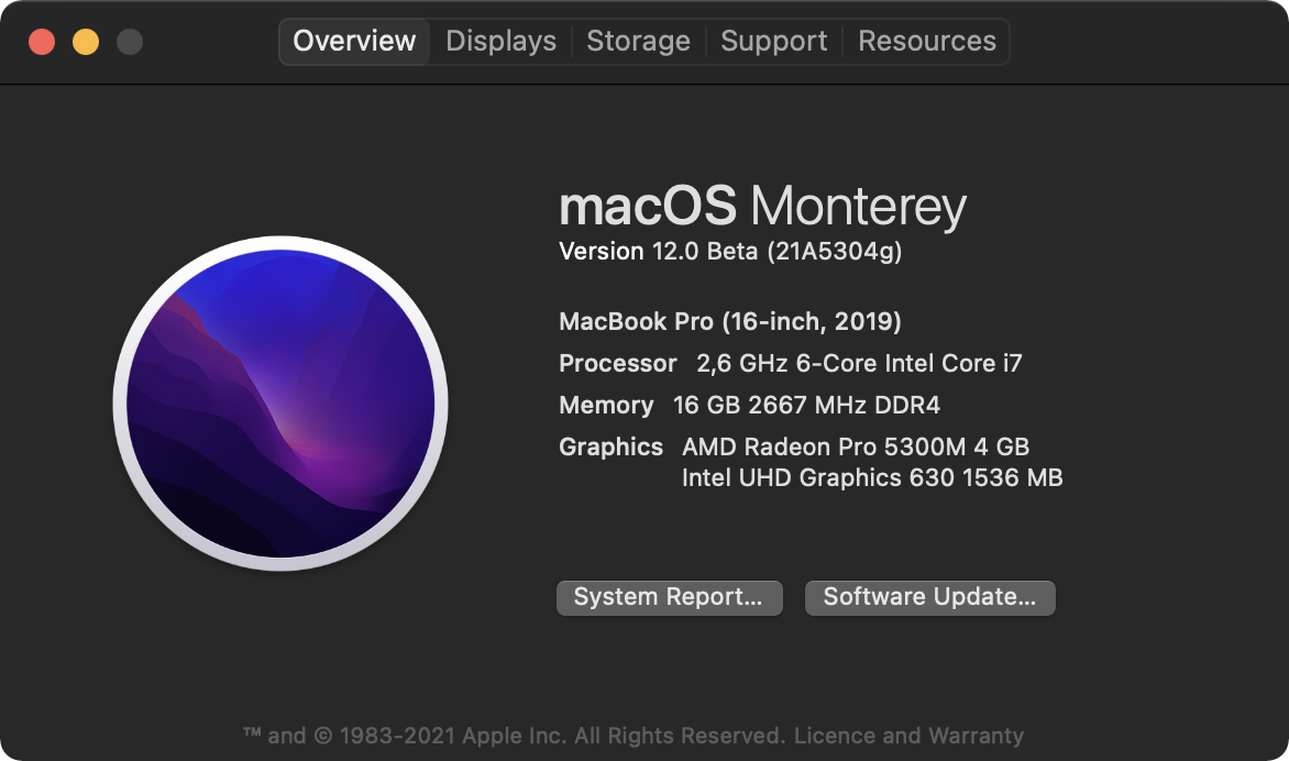

It looks like issue with external displays has been fixed in one of the macOS Monterey Beta (with low power mode)
5300M

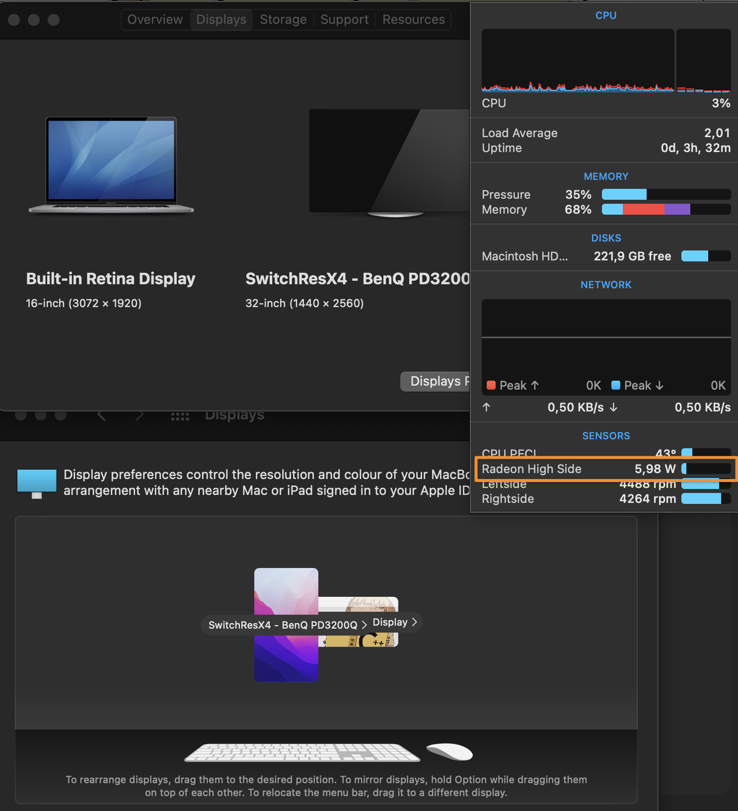

I have two monitors: BenQ PD3200Q (2K, 60hz) and AOC Q32G1WG4 (2k, 144hz).
Currently on macOS Monterey Beta 5 (21A5304g) i have about 14W with 1-2 external monitors connected
But also if i turn on the new «Low Power Mode» in settings I get about 7W.
The problem only occurs when changing the refresh rate other than 60 hertz (i get 18W+).

I did some tests with different connection combinations
P.S. SwitchResX figured in monitor name, but it not used
