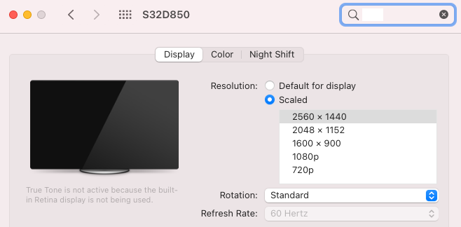

TLDR: My 2019 Macbook Pro 16" 5300M gets hot and noisy when connected to a 2560x1440p60 monitor, even when idle and the lid is closed. This post outlines a partial solution that enables silent operation.
The 2019 MacBook Pro 16" with base 5300M GPU has a problem.
If you connect models with this specific GPU to an external monitor with an extremely specific (but common) resolution, many users report that their MacBook gets really hot and the fans spin up really loudly, even if they close the screen lid.
Specifically, many users report extremely loud fans when connected to 2560x1440p60 monitors. The problem is with this specific resolution and 5300M GPU combination. Tons of users report no problems when using 1080p or 4K monitors or with the upgraded 5600M GPUs.
The solution to this problem, however, is just force enabling HiDPI mode for the monitor (instructions later). Unfortunately though, this solution requires the MacBook lid to be closed. I haven’t found any solution that fixes the problem while also keeping the lid open.
DISCLAIMER: This article only considers a 2019 MacBook Pro 16" on Big Sur 11.5.1 with 5300M graphics connected to a single external 32 inch 2560x1440p60 display. If you have a different setup, no guarantee this will work, since this issue might be a bug with exactly this GPU/resolution combination. I’ve seen many reports of no issues on the 5600M.
Before, when connected to a 32 inch 1440p monitor, my MacBook Pro 16 inch reports 18–20W of power draw from the GPU. This is regardless of whether or not the Macbook lid is closed.
Code:
% system_profiler SPDisplaysDataType  | grep -C1 Resolution
S32D850:
Resolution: 2560 x 1440 (QHD/WQHD)
UI Looks like: 2560 x 1440 @ 60.00Hz

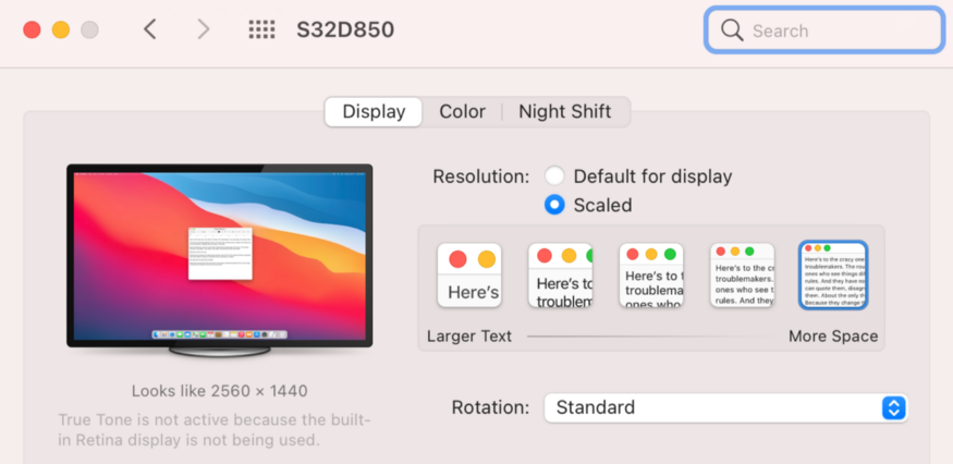

I switched to “Scaled” for demonstration purposes, but I typically just use “Default for Display”.
When I look at the GPU power draw, I see:
Source screenshot from the free Stats app was 2560x1440. The equivalent statistic on iStat Menus is Radeon High Side.
This is insane power draw for a laptop at idle. It doesn’t take long for all this extra power to heat up the laptop and cause the fans to start roaring, even with nothing running, just idle.
Moreover, I noticed that after 50 battery cycles my battery health is already at 90%.

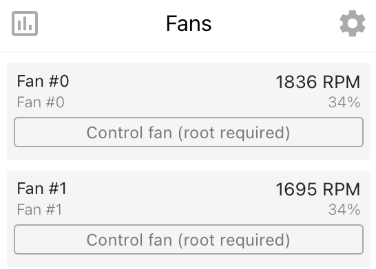

Rocketing fans at nearly 100%
But if you force enable HiDPI mode (instructions later) for your external monitor while the lid is closed, this is what happens:
For demonstration purposes, when you look at “Scaled”, you get HiDPI options. When I actually use it, I use “Default for Display”
Code:
S32D850:
Resolution: 5120 x 2880 (5K/UHD+)
Now when I look at the GPU power draw, I see:
Source screenshot was 5120x2880, due to HiDPI.
What exactly is HiDPI mode? Well, it’s basically forcing macOS to internally render at 2x resolution. So in the case of a 2560x1440p monitor, macOS is internally rendering at 5120x2880p. (Which happens to be the resolution of the 27" iMac). You can tell, since the new screenshots are twice as sharp.
Now the MacBook is drawing a much more reasonable 6W and stays silent during normal operation, as it should! Now it feels like a Pro machine!
Seeing as how it makes no sense that rendering at 2x resolution cause 1/3 of the power draw, this is most likely a GPU driver bug on Apple or AMD’s end, and a temporary solution could be force enabling HiDPI mode for 1440p monitors in the next release of macOS.
Note, these power draw settings only work if you keep the MacBook lid closed.
Moreover, I noticed that my battery health stayed the same after 50 more cycles with this fix applied.
Basically silent fans

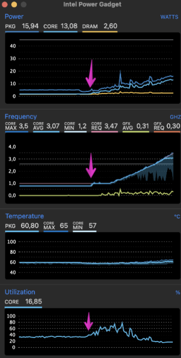

Hi,
I was about to open a new thread talking about how pissed I am with my MacBook Pro 16" 32 GB RAM. But I see my problem have been discussed here a lot.
I can't believe I can't use this expensive machine with my 32" 4K external display and Google Meet. As soon as I launch Google Meet, the computer becomes unusable.
This is what happens when I close the Google Meet window (pink arrow indicates when I turn off Meet):
Things start to go back to normal.
So I guess since I'm stuck with the Radeon Pro 5300M, I only have 2 options:
1. Buy an eGPU (expensive and inconvenient)
2. Sell my MacBook and get another one with a 5500M
Is that right? Thanks!

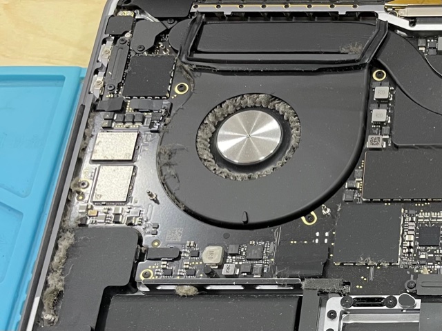

There are many people here like me who ran their MBP16 for 1 year+ with fans at full blast almost constantly.
Yesterday, I paid 50$ to have someone open mine (8Core 2.4Ghz, 5500). It was worth it. FYI, I bought it in Nov 2019 and it ran almost permanently the entire time with egpu and 3 monitors.
Lots of dirt and 'cotton-candy' build-up removed AND they helped me apply the VRM mod for free. I am glad, as backplate removal and reapplication are quite tricky.
Result: It runs at almost double speed now. Fans are now noiceably lower. At full blast the vented air stream also feels now really strong.
My biggest problem were the complex scenes I run with OBS that even with eGPU would get my MBP to throttle.
Now, there is no throttling at all, and it runs under high load at above 3Ghz most of the time. I am impressed!
The last thing I am going to experiment with is to get a Kraken X water-cooled plate that I will press directly against the hottest spot at the backplate, where the VRM mods are. This should help to dissipate the heat even faster an better.
I also have to be a more careful in general now, as the thermal pads created a slight bulge and a few mm of an opening behind, where I can actually see the thermal pads. It's now even more dangerous to get it anywhere near water.
So, if you had your MBP16 for more than a year and it runs full fans most of the time, consider getting it cleaned at least. It likely looks like mine inside (most sides similar, btw).
Code:
S32D850:
