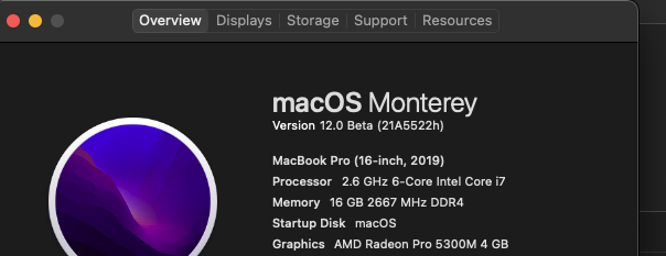

I am inclined to install the beta 7 of monterey but a question to the ones using it: is it stable? I heard from many that is at least as stable as big sur is, so I was wondering if it is really usable on a day to day basis..
I suggest you to install beta on seperate drive partition. That's exactly what I've done. I still use Catalina for my everyday work and video editing, but I've got beta installed on seperate partition and I'm still able to choose which one I want to boot in when starting the mac.

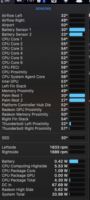

I am also using it with termal mod. Fan noise is OK I think but most annoying issue is poor battery life with open lid. Every time I want to watch full length movie (approx 2 hours) via connected TV, I need to plug my power brick. Otherwise my battery drains too fast. Of course I can turn off lid while watching movie on TV but -as a Cinema student-, I need to control player during the movie.

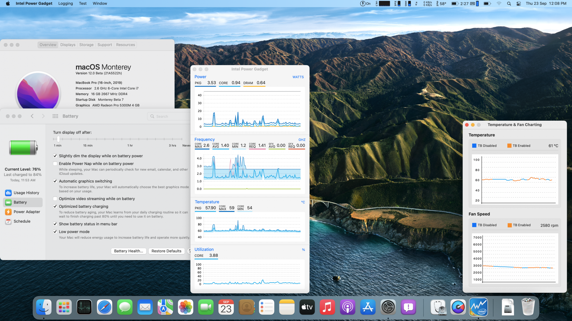

Monterey Beta 7
MBP display and 1080p monitor at 60hz getting 5-6 watts with low power mode.
I think this is because GPU clock is reduced.
Normally my CPU temps are 60-65C but with Beta 7 and low power mode its decreased by 10C
and my temps are 50-55C.
In the name of science, I tried using the Turbo Boost Switcher app in Low Power Mode (Monterey Beta 7) to check if it'd allow me to maximize CPU while keeping GPU at ~6W. Here's my findings:

Looks like 7 Beta has "re-fixed" the low power mode GPU throttling. Back down to around 8w to 10w when enabled and 16w when disabled.
Running 16" 2019 Radeon 5500M 8gb
