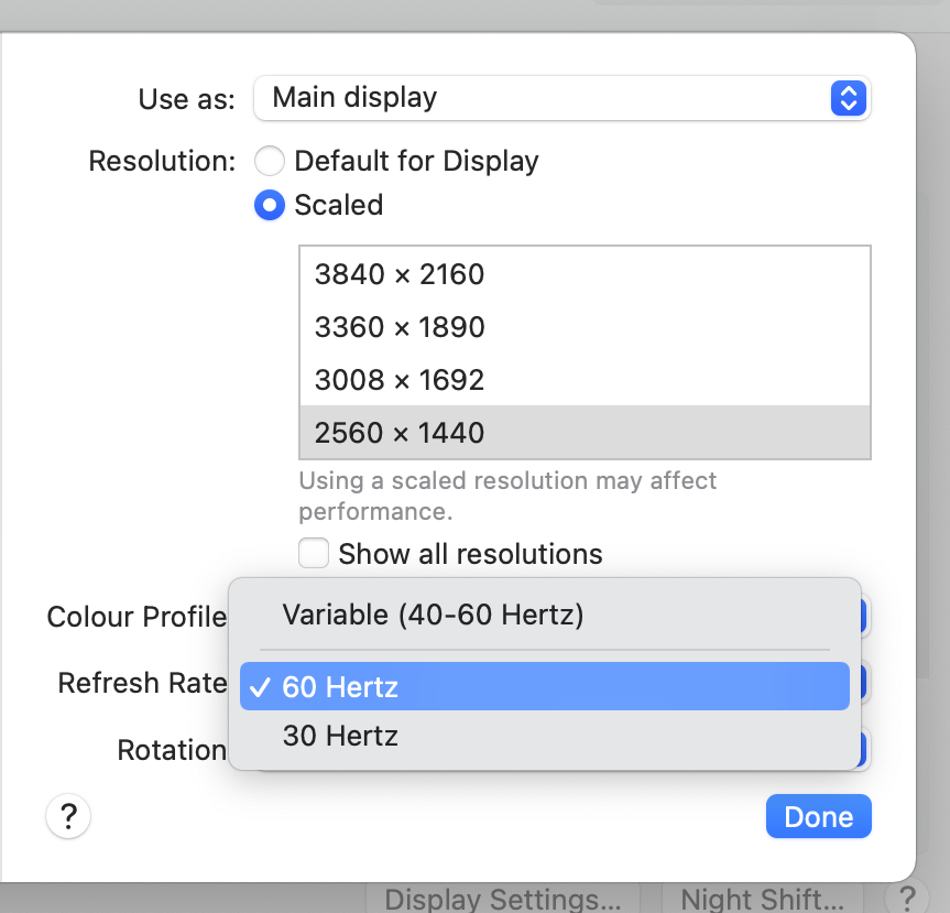

Is there a tutorial somewhere on how to open the machine & clean the fans? I've done it plenty of times on other machines, but the MBP is a different story from your average Windows machine. I mainly need to know what screw drivers to use.
Using 60Hertz on both monitors. What is freesync / vrr?
Free sync / VRR is variable refresh rate. For me if I used Variable refresh rate the temps would be as bad as before and if I set it to strictly 60 the temps and fan noise were much better. It’s worth double checking since in my case Variable was set by default for some reason.

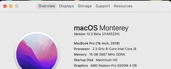

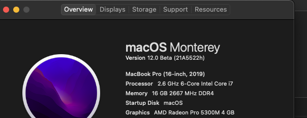

Just installed Monterey on i9-5500 and the temps are as bad as they were. Has not helped my machine :(
hi! i have the same model and problem has gone (radeon high side is about 5-10W)
1. check that you have installed all updates to beta 7
2. it works better in "low battery mode" - try to activate it (System settings - battery - power saving mode)
