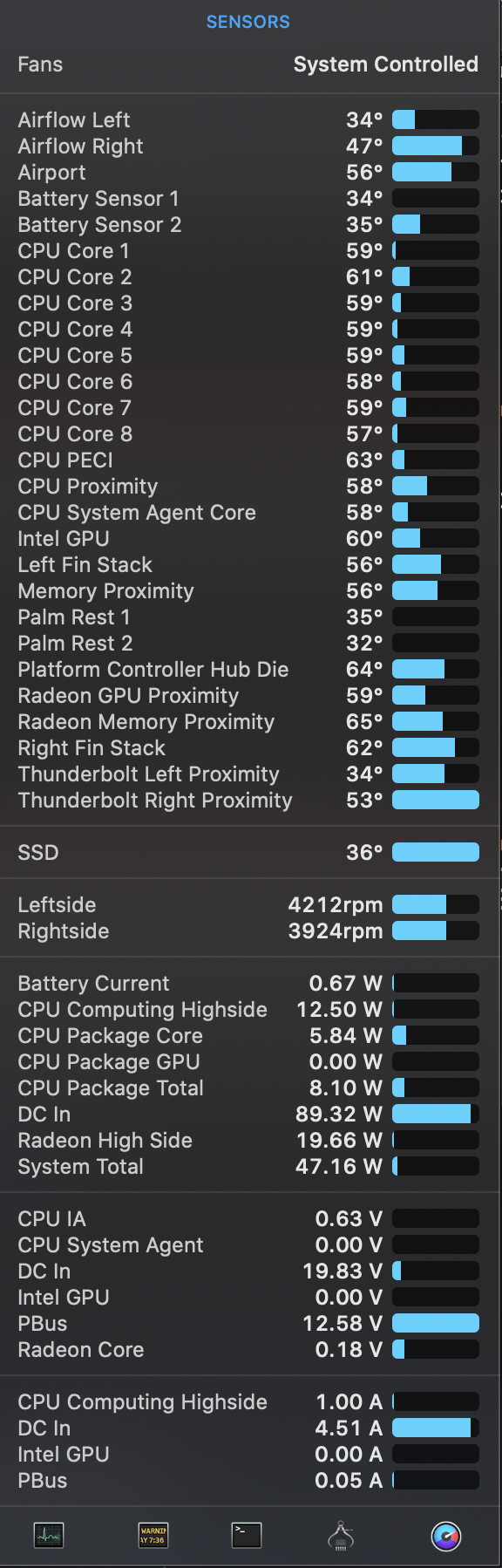

# 10.15.4 Beta 4 (19E250c)
  • Radeon High Side: ~19-20 W

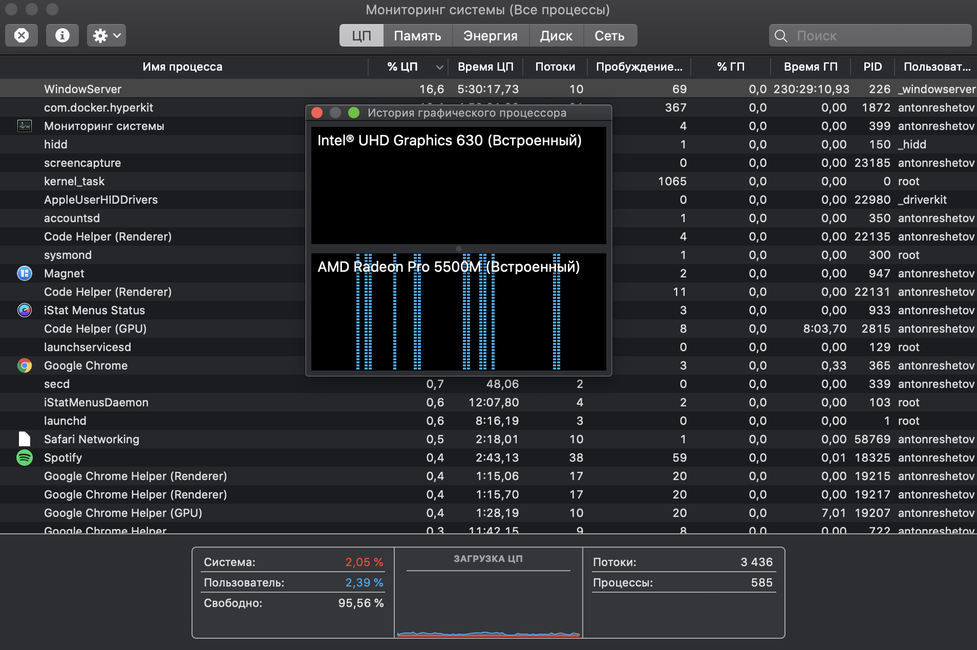

One more data point. I have just tested on the viewing of pages in Chrome and noticed that if the page has any animation or DOM renderer, the peaks are 0-100. There is no half-value or otherwise. And as soon as this happens, the fans are gradually gaining momentum. In addition, the CPU time does not correspond to the GPU time.
