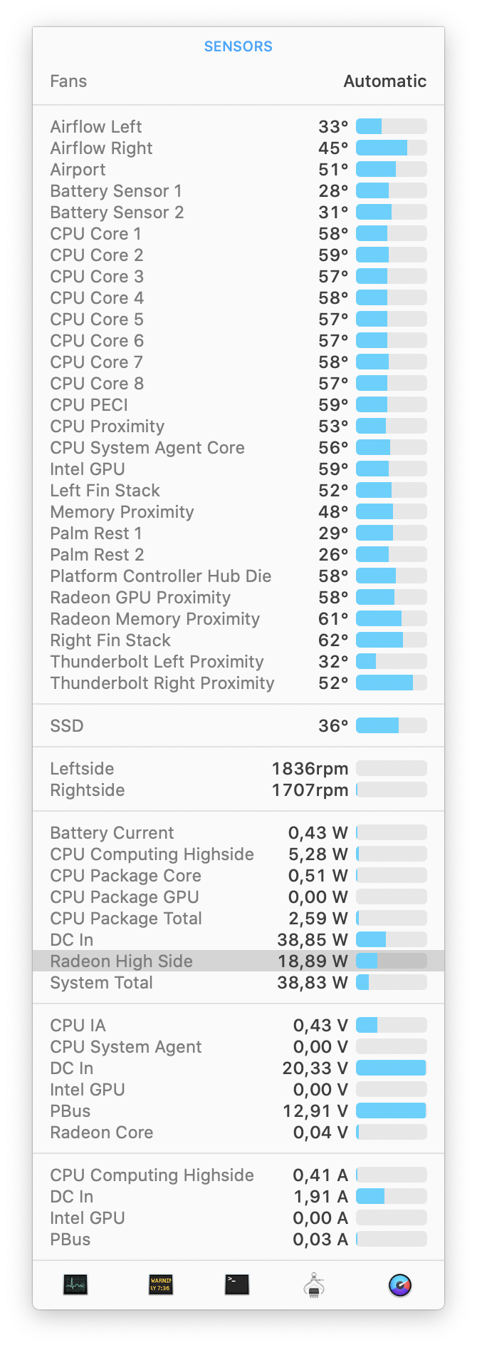

So I'm on 10.15.5 beta (19F53f) and I went from over 19 watts Radeon high side all the time to 7.87 watts. The only setting I've changed is in SwitchResX I went to a non HiDPI setting. I use two external displays and have never seen it draw less than 19 watts until today.

I have a Dell U2518D and it still pulls 18W in clamshell mode. 2560*1440 @60 HZ with HDMI cable connecting through the Twelve South StayGo hub. My usb-c to hdmi and usb-c to DP cables are on the way, and will test if that makes a difference.
So I just updated to 10.15.4. Seems like the heating issue is getting better for me. I'm still connecting through a hub, but now the temperature barely gets over 60, while GPU is still consuming 18-20W, and I'm not even in clamshell mode. Before the update, the same power consumption will instantly drive the heat to the mid 70s.

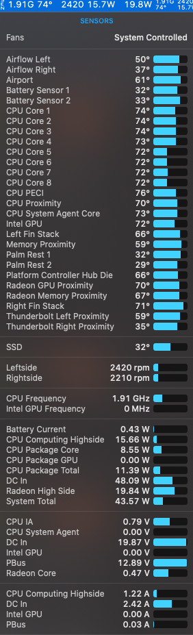

They didn't fix a thing, all the symptoms of flawed drivers are still there, I still get 18W with:
  • 2560x1440 60Hz USB-C > Displayport Cable - Clamshell
  • 2560x1440 60Hz USB-C > Displayport Cable - Open Lid
  • 2560x1440 60Hz USB-C Hub > HDMI Cable - Clamshell
  • 2560x1440 60Hz USB-C Hub > HDMI Cable - Open Lid
Tested on 10.15.4 Supplemental, 10.15.5 Beta 1. Kext versions haven't been touched since last year. As said in previous posts my only way to get it down to 5W is actually using the direct USB-C > Displayport Cable and upping frequency to 85-100-120-144Hz which is not an option on most monitor. Reports of 10.15.5 Beta 1 in the previous posts are flawed since disabling HiDpi through SwitchResX actually lowers resolution and is not suitable for most monitors.
We won't give users hope and Apple a rest on this issue.
Confirm, not a single change on latest macOS.
Yep, no change here with supplemental update, at least in laptop open mode - 19.x W for Radeon, in 3840x1600 on an LG 38"
