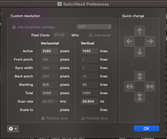

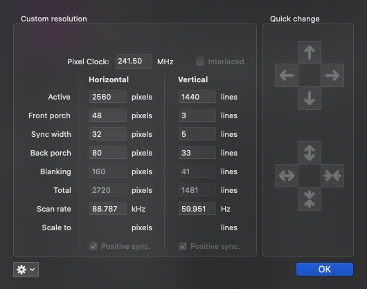

Sure, I checked the "use simplified settings" box and tested all options from the dropdown. The one in the screenshot, "GTF", is the only one that worked. I'm attaching a screenshot of the default settings as shown by SwitchResX vs the GTF settings. I don't know exactly why these settings bring it back to 6-7W but it worked for me.
GTF - 6-7W:
Default Settings - 18W:

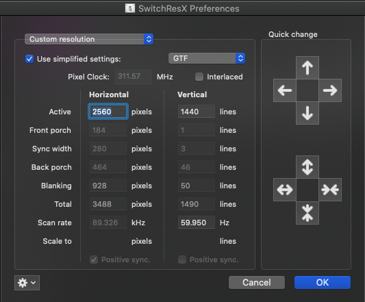

It is heart pain to see and hear my new (yes refurbished. but its new for me) mac fan spinning crazy.
With HDMI cable through Baseus usb c hub, draw 18+W by Radeon High Side, regardless of clamshell mode or not.
I tried one another brand of usb c hub also. Still the same issue.
Then I tried SwitchResX method as a few suggested in this thread started from page 75.
But it is not working for me.
Then I started seeing Displayport solutions in this thread.
So I bought a Displayport to usb c cable.
Now it draw only 5+W by Radeon when using clamshell mode.
Once laptop monitor open, it immediately raise to 18+W.
After close lid again, waited like 10 minutes, but it is not dropping back to 5+W.
So I restarted the mac in clamshell mode and it drop back to 5+W.
After play around with Displays setting from System Preferences, 18+W issue come back.
Then found out that SwitchResX also plays a role to make this remedy works.
This is the setting that works;
And for extra touch, I disabled the cpu turbo boost also.
