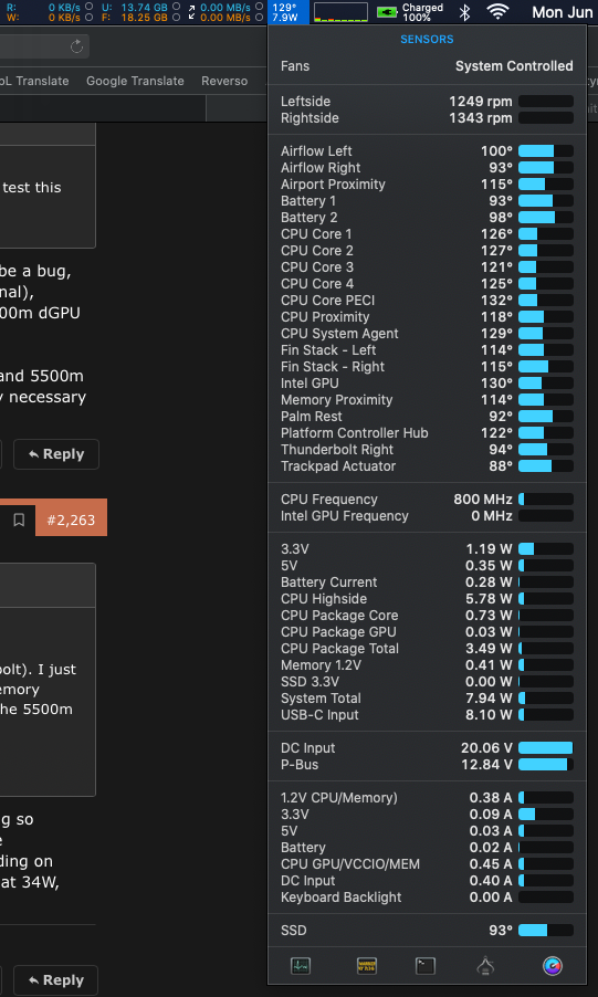

I mean my base i7 goes 100 celcius in a matter of seconds when I'm on external screen WHICH means that the throttling will kick in and there goes my fast macbook not to mention that this kind of heat is simply unhealthy to everything around the CPU no matter what anybody states.
Same operation without external screen and I won't even hit 90

Just read what the guy above you wrote about restarting the mac in clam shell vs open and then close the lid.
First case power draw is low, second scenario power draw does not go down even though the screen is off. I will actually test this today and if true then this is 100% software bug.
Will apple will fix it? well that's a whole another story.
The fact that power usage doesn't drop from 18W to 5W on closing the lid after running dual displays may indeed be a bug, but that is in no way "the" bug, which is high power consumption and heat with multiple displays (internal + external), apparently caused by higher power usage (vs last generation 560x dGPU with lower frequency memory, and vs 5600m dGPU with HBM2 faster but lower power memory).
I believe "the" bug is absolutely 100% hardware, and is confirmed by the 5600m, and cannot be fixed for 5300m and 5500m with a software update, assuming the "by design" feature of increased memory speed with dual displays is actually necessary (e.g. to avoid laggy scrolling, as seen in some screen recordings posted earlier).
The BETA does indeed work, thank you!
8 watts on a Dell 34" U3419W ultrawide @ 3440x1440 connected via 1 usb-c cable (this monitor does not have thunderbolt). I just returned my 1 week old 5500m (after trying the SwitchResX stuff and failing) for a 5600m in the hopes that the HBM memory would resolve the heat, and it has. Exactly the same setup with the monitor between the two GPUs, same monitor with the 5500m was 20+w and *heat*.
This is the top i9, 32gb ram, 5600m spec.
1 hour connected to the external display and fans are yet to go above 2000 rpm during normal coding, web browsing, etc. If I compile something they obviously ramp up for a bit but that's totally fine.
HOORAY!!!!
