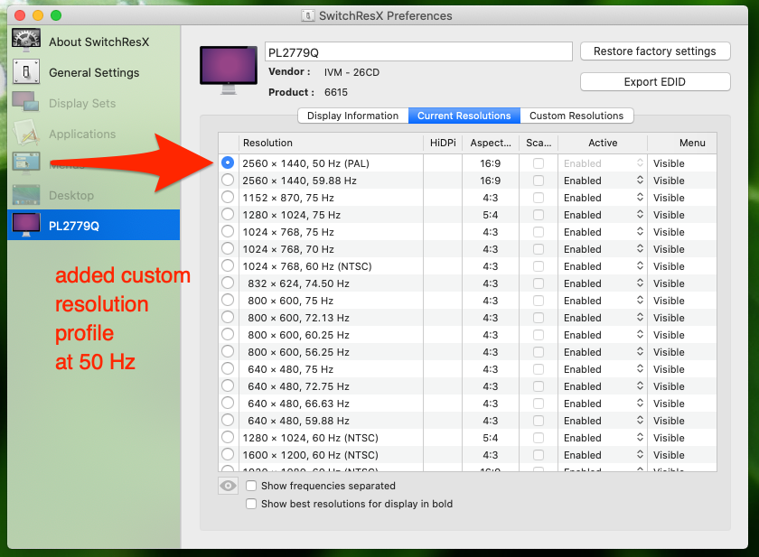

I solved my problem using SwithResX;
Problem definition: When I use my computer (MacBook Pro 16") with my external monitor (Dell U2713HM) my computer's dedicated GPU (AMD Radeon Pro 5300M 4 GB) consumes a lot of power and fans spin constantly.
I use my computer in clamshell mode and connect to my monitor using a USB-C to DisplayPort cable.
Solution: I realized my computer drives the monitor with a weird hertz (59.88).
When I looked at the EDID info of my monitor using SwitchResX, I realized the hertz value should be 59.951.
Monitor Description blocks:
Descriptor #0 - Timing definition:
Mode = 2560 × 1440 @ 59.951Hz
Pixel Clock............. 241.50 MHz Not Interlaced
Horizontal Vertical
Active.................. 2560 pixels 1440 lines
Front Porch............. 48 pixels 3 lines
Sync Width.............. 32 pixels 5 lines
Back Porch.............. 80 pixels 33 lines
Blanking................ 160 pixels 41 lines
Total................... 2720 pixels 1481 lines
Scan Rate............... 88.787 kHz 59.951 Hz
Image Size.............. 597 mm 336 mm
Border.................. 0 pixels 0 lines
I have created three custom resolutions;
2560x1440@59.951
2560x1440@50
2560x1440@60
When I use 2560x1440@50 or 2560x1440@59.951 the fan only spins under heavy load.
So my problem solved, the issue fixed and I am really happy because It worked without a new cable.

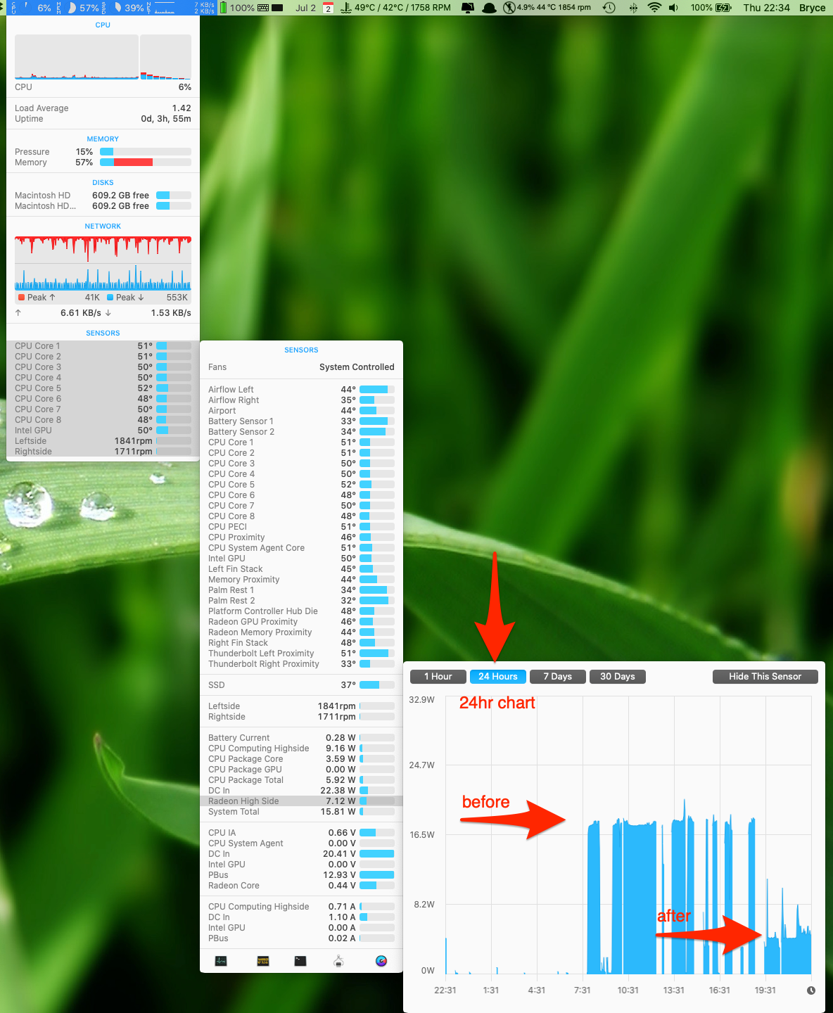

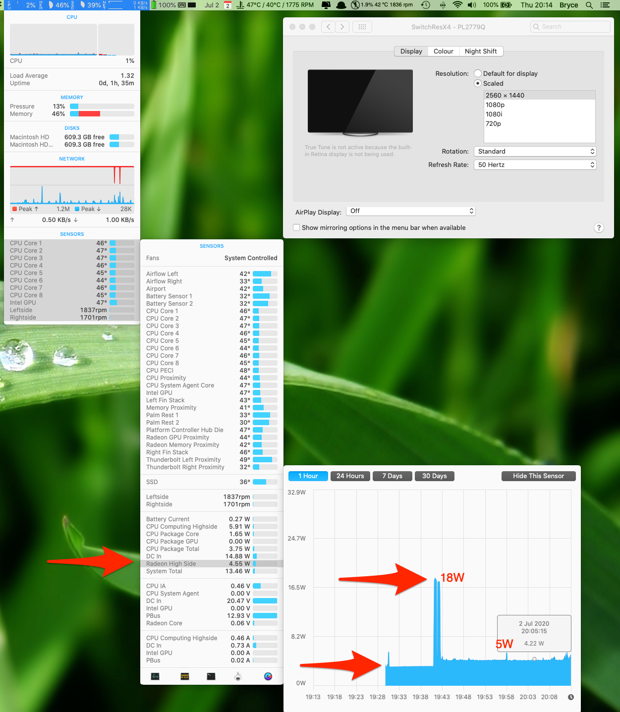

Thanks for pointing me in the right direction! I have also solved the issue with SwitchResX
Had my MBP 16 since Nov 2019 and the fans have always run like jet engines (super hot and loud) when connected to my ext monitor (USB-C to Displayport).... until tonight after implementing the solution suggested above
Radeon High Side would previously sit at 18W in clamshell with ext monitor connected, but now it sits around 5W avg. The MacBook I was ready to sell this morning is now quiet and cool, just like my beloved 2015 MBP 15 was
Hopefully Apple are aware of this thread and will "fix" the issue in a more robust way soon, but in the meantime give this workaround a try

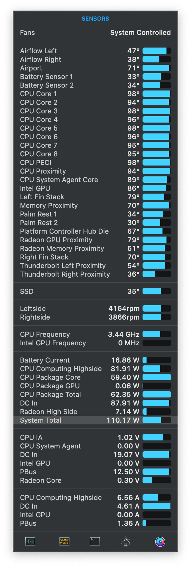

I'd rather try and get work done instead of spending hours a day getting frustrated because Apple refuses to listen to my complaints. I really have tried to do that with the butterfly keys and 4 years later, I've moved on.
And it's not like you don't have options, either. Use an eGPU with your existing setup or buy the 5600M and burn your current 5300M/5500M computer or something.
Nope. Get the Razer Core X or Razer Core X Chroma. It has 100W power delivery to prevent battery drain when you're actually using the MBP for any intensive tasks. Almost all other eGPU enclosures only provide 60W or 87W and the 16" MBP ideally wants at least 94W (what Apple provides in the box).
And yes, even with the dGPU using less power because you have an eGPU attached, the machine can give more power to the CPU increasing CPU performance and still hitting that ~94W total system power draw.
See this screenshot, total system power ~110W while compiling an app in Xcode, with Radeon High Side ~7W with eGPU and external display attached.
Thanks for the info. I went and ordered the Razer Core X today. Annoying I have to go this route to make the machine usable for me. But at least it's a small expense compared to the overall cost of the laptop, so I'll deal with it.
Hopefully Apple are aware of this thread and will "fix" the issue in a more robust way soon, but in the meantime give this workaround a tryView attachment 930066View attachment 930068View attachment 930070
Great work! You posted two images with Radeon High Side, which one is clamshell and which one is open lid?
GLAD IT WORKED. THIS IS WHY I SHARED MY SOLUTION :)
МАN!!! You made my day! Managed to go for 50Ghz for Apple Thunderbolt Display with this hack!!! Now Radeon High Side is ~4W only! No heat, no fans! Need to try get maybe 59Ghz or near. By Default its not working, get only banding and stripes over screen with GTF and 59.951 Hz (naitive).
Reactions: kerembaydogan
Glad It also worked for you, Two of my colleagues solved their problem after I tell them this SwitchResX method. ConnorMac also solved and now you.
I think now I can call it a FIX. At least for some of us.
