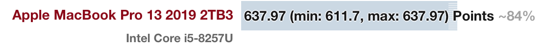

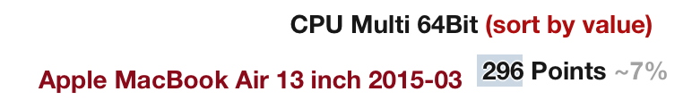

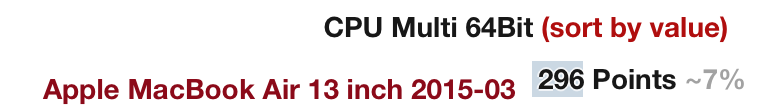

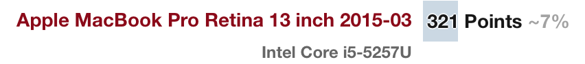

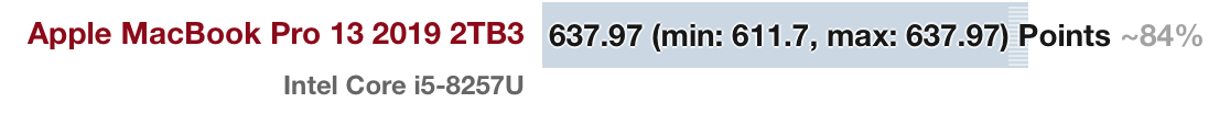

See here for notebookcheck.net's Cinebench 15 results:
I had that MBA and it was awesome. Within 10% of the MBP while being lighter and much cheaper

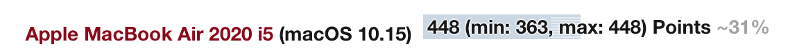

Compare to 2020 MBA vs 2019 MBP 13
A whopping 40% slower when pushed. (I'm comparing 363 vs 611.7 when the MBA is heat soaked from it's less than adequate cooling system
I have the i7 2020 MBA and it's only barely 7% faster than the i5 in Cinebench. Not even close...

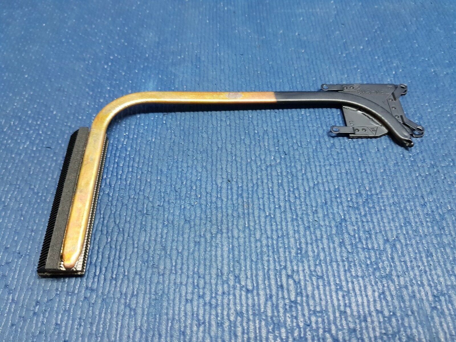

]I have almost achieved the performance of 2020 !! just by improving the cooling. These are the tests, everything else is talking for talking ...
I would take a 2020 MBA with my invention to get the power of a Pro ... at least very close ...

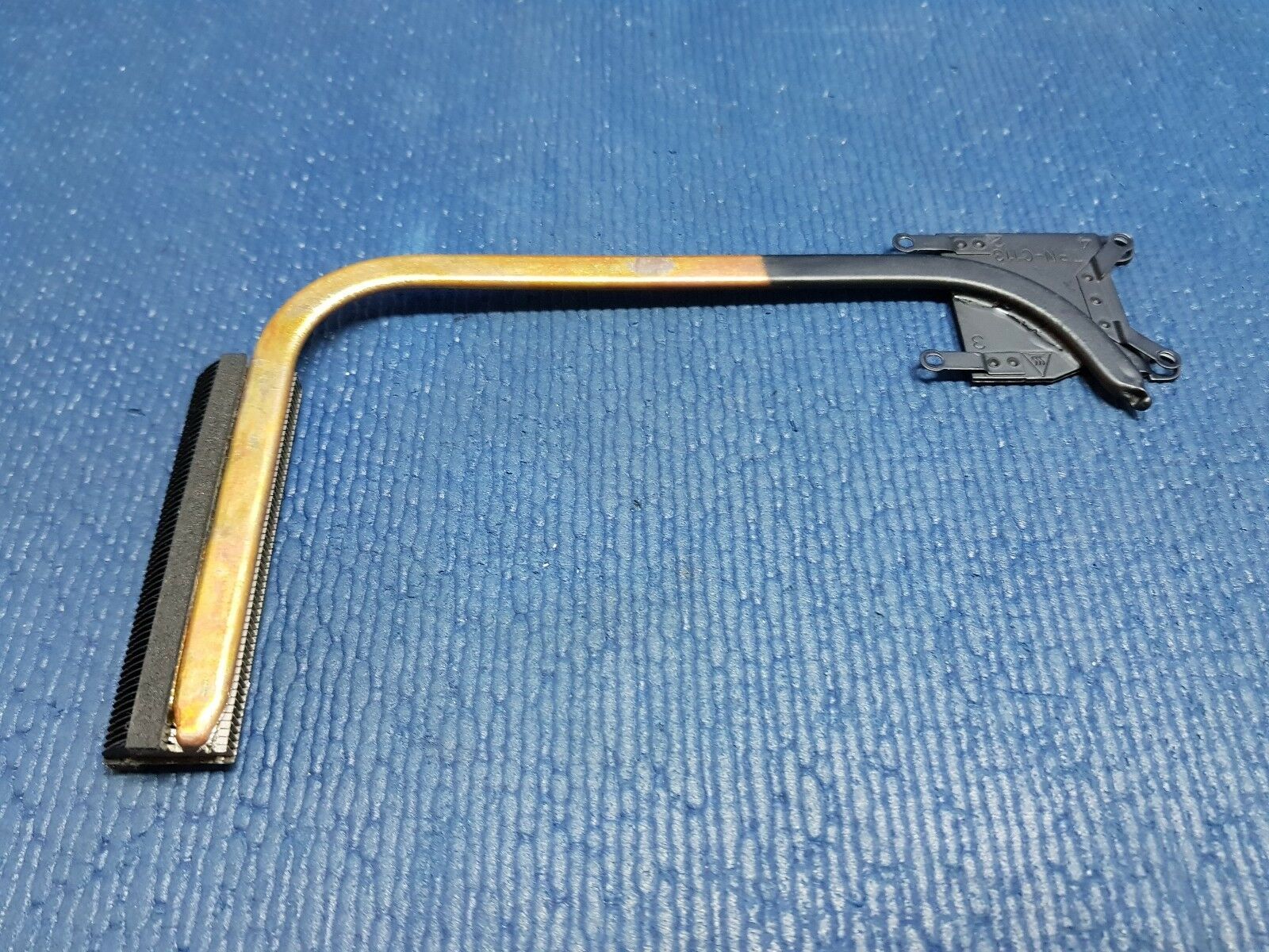

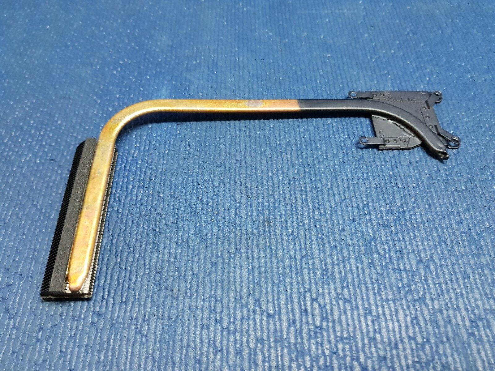

Look how I get bored just buy heatsinks of those small rasperry and I put them to memory and to the T2 ... Also disassemble the cable that passes through the turbine to see if there is room for a small radiator ... when I have all done I will send a letter to Tim Cook saying that he does things like the ass !!!!
If I get something like that to adapt I laugh at the MacBook pro ... always official in turbo mode ...

You need to read what this guy wrote:
"sdimitrov said:
If the Air had better cooling, lots of people (including me) would buy it instead of a Pro model."
Oh wait that is you. Tell yourself to read you.
I don't understand your confusion. Both the things I said are true.
With a better thermal solution:
Users who don't care about performance (1) AND users who need moderate performance (2) would be happier because of reduced noise and heat.
1 would be able to enjoy YouTube and Hangouts without having to listen to the fan. The only cost they would have to pay is 10-50 grams of heat pipe which is 1-4% of the weight of the laptop, and costs around 5-10 dollars.
2 would be able to work, compile, encode and do anything for a long time sustainably, without feeling that the machine is struggling. Keep in mind it's a relatively capable machine, especially the quad-core model (and imagine that without throttling). And yes, it's not as capable as a Pro model of course...
Why I would buy it instead of a Pro model? Because I don't need the full performance the Pro offers, and I want the lightest laptop I can get. Then again, I would be happier buying if I knew it was built well instead of limited intentionally.
Come on, this is becoming ridiculous... I'm done wasting my time 🙂 Cheers to the rational and friendly people here, good luck!

About compromises - none are necessary. Do you know what the weight and size of a heat pipe are? Negligible at this performance class. Placing a heat pipe and moving some of the heatsink material to the fan would add almost no weight, and will take almost no space. Keep in mind that some companies place heat pipes inside smartphones...
Again, the target audience of these machines does not need super high performance. It needs a comfortable machine in any situation.
