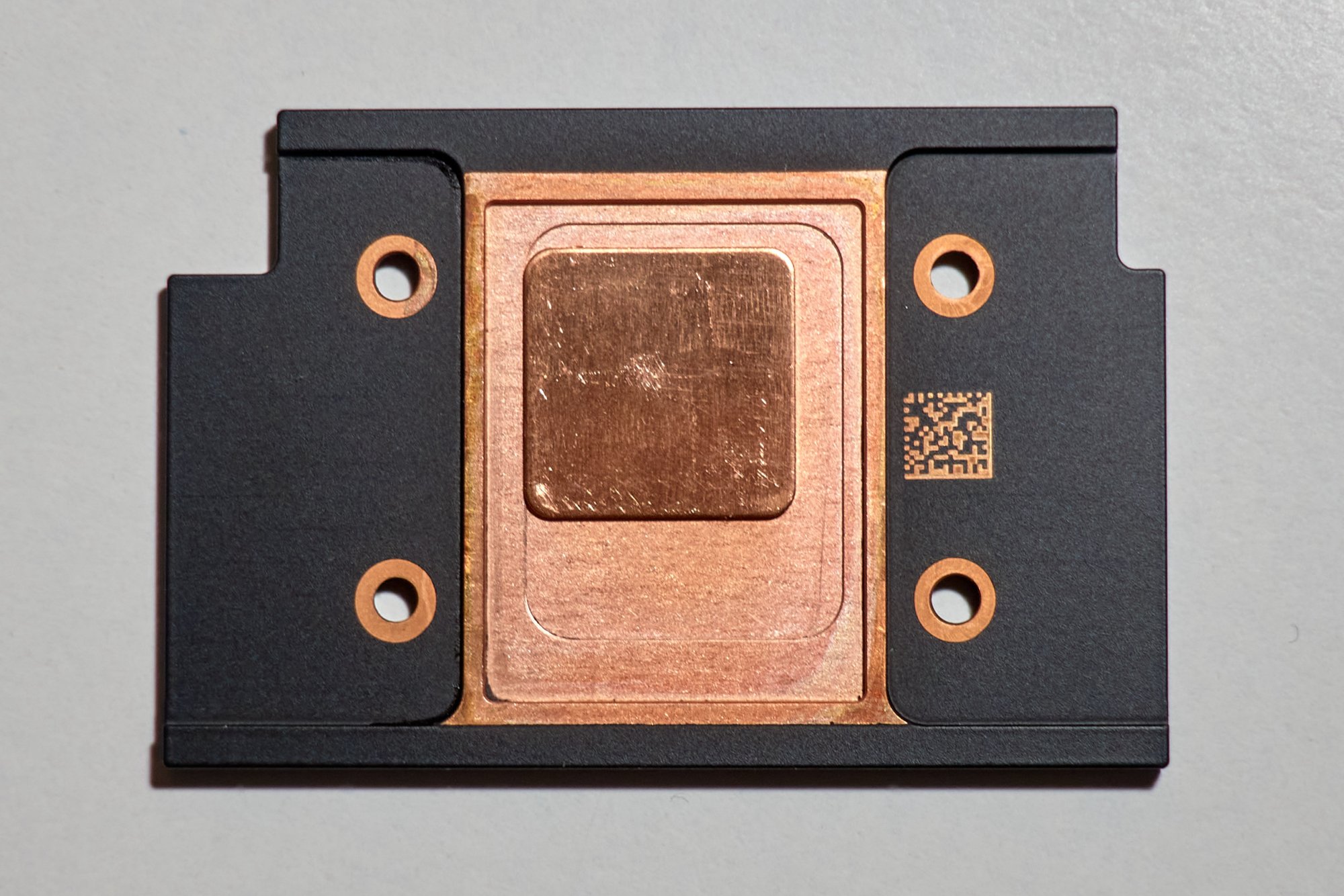

So here's the update for my v2 heatsink mod. For those of you late to the party, read my original mod post first.
I ordered this set of shims from Amazon. The 0.3mm shim turns out to be the best thickness for 2020 heatsink. The set I ordered was only 15x15mm square, which is actually too small, but I was impatient and these were the only ones that were Prime. I had to use two pieces, one for the CPU die and one for the GPU die, cut to size with a regular pair of scissors. The copper is soft enough at this thickness that regular scissors will work, you just have to be careful. Also worth noting: to cut the small piece for the GPU, I didn't make one cut, I made several cuts taking a little off at a time, that way it warps the final piece a minimal amount and you can flatten it back out. I put a thin layer of paste on the dies, then another layer on one side of the shims. The performance in the end is about the same as with my original foil sandwich mod, but the copper shim is the way to go, definitely worth the price of admission.
The dimensions of the dies combined is about 16x12mm, and the milled section of the heatsink is about 22x17mm. A 20x20mm shim would be ideal, and only have to be trimmed on one side. Be sure your shim fits within the milled out section of the heatsink, otherwise you'll end up with another air/paste gap instead of making good metal/metal contact with minimal paste in between.
When applying paste, the new method of application for PC building is to put a small dab in the center, then install the heatsink. This is for modern high-pressure heatsink mounts that area torqued down and put a lot of force on the die, which forces the paste into a thin layer. The Air heatsink mount is just four little screws that don't exert much force, so you need to spread the paste in advance, but you want it as thin as you can get it, less is more in this case.
The attached photos show: an overview of the innards of the 2020 i3 Air; heatsink just after being removed with original foil sandwich mod; closeup of the heatsink showing the milled out section that goes over the dies (I still don't understand why Apple would do this); closeups of the dies and heatsinks with measurements; my two pieces of 0.3mm copper shim in place on the dies; final shots of the paste applied; Geekbench and Cinebench results comparing original stock heatsink, my first mod with the foil sandwich, and v2 mod with the copper shim.

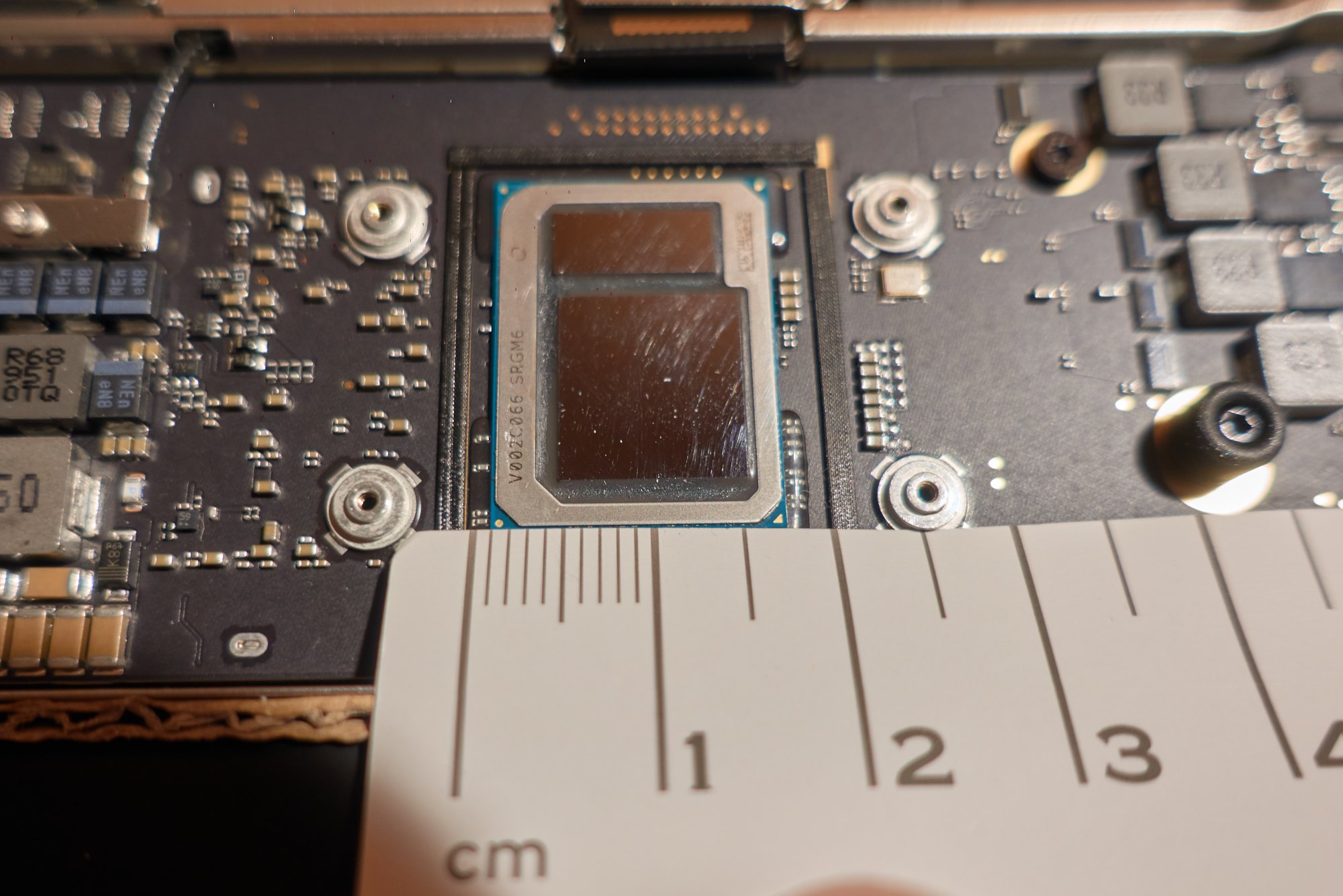

Finally, here are pictures of what was underneath my heat sink!
Processor
The "2 cm" marking is aligned to the inner edge of the heatsink padding:
I should have aligned the "3 cm" marking to the inner edge of the heat sink padding:

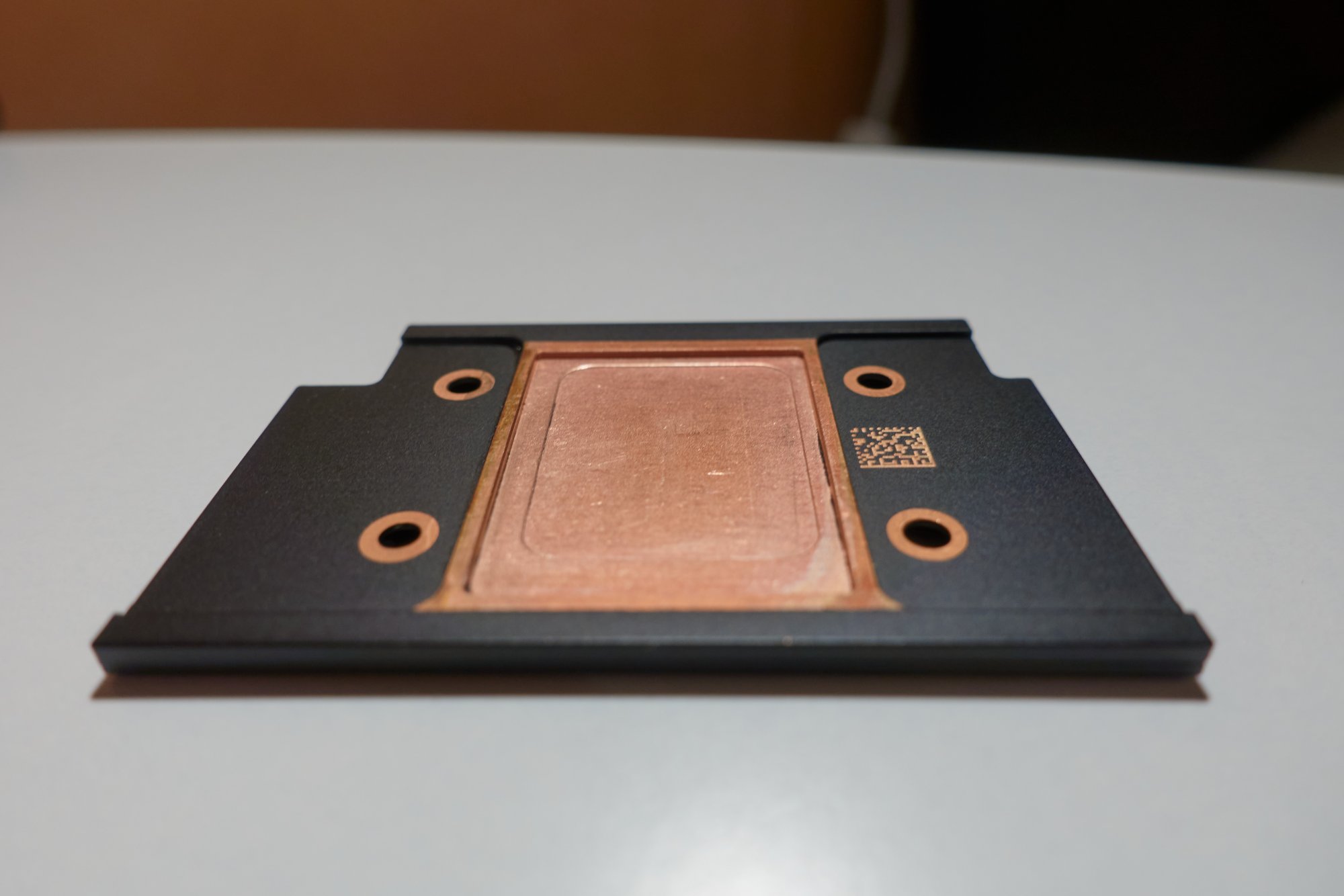

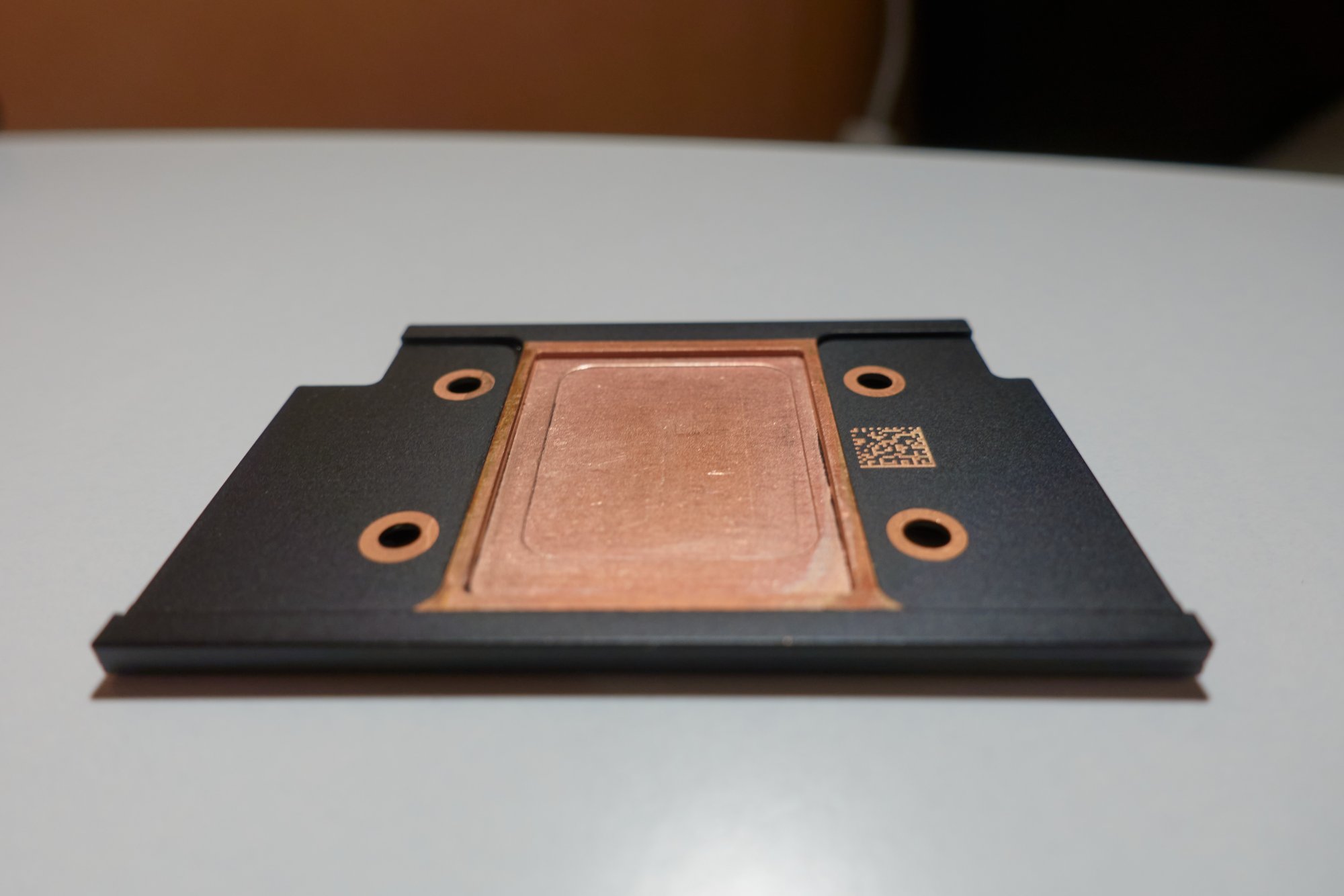

Heat Sink
Underside of the heat sink, featuring a very shallow rounded-rectangle cutout (might be around 0.2 mm in depth):
View attachment 910959 View attachment 910960
The cutout relative to a 15x15 mm copper shim:
View attachment 910961 View attachment 910962
The "2 cm" marking is aligned to the long edge of the cutout:
The "3 cm" marking is aligned to the short edge of the cutout:
To gauge how thick the shims needed to be, I prototyped various shims with paper of different thicknesses. I found that the thickness of a business card was quite good. Unfortunately, the shims I bought were 0.6 mm thick, so I had to spend a few hours slowly filing them down 🤦🏻 In the end, they were thicker than needed, but thin enough for me to screw the heat sink down. The screws are incredibly small and the threaded ends are only around 2 mm in length.
I spread a thin layer of thermal paste onto the heat sink and "pasted" the shims on. This way, I know that the shims will be positioned properly when I lay the heat sink back onto the processor (with another layer of thermal paste).
