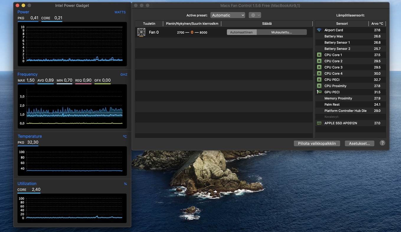

Interesting. I wonder why my temps are so much worse. Chip lottery? What were your idle temps before the mod?
Yep silicon lottery and possibly the older thermal paste you used ? Mine was just opened for this..
Did not take the temps before mods but if i remeber correctly it was 40 something iddleing. I only took the temps under stress.
Yeah bro, @daystar's temps are the lowest I've seen on a 10th gen MBA. Pre-modded 40-ish degrees is crazy cool. I'd say chip lottery as well.

Strange. My i3 is in the rane 40C-50C (usually starts below 40C and then settles between 40C to 50C after a while). Perhaps the ambient temp is different.

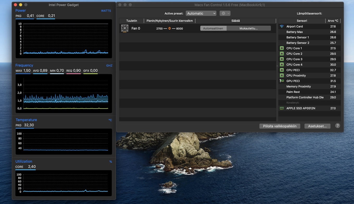

I'm at the start of a highlands Australian winter (-2c outside, 18c in the house).
Firstly: help me, I'm cold. Colder than our mate in Finnish summer! 😂
Secondly: I think it is just a lottery of three factors. Your chip, how much thick black goo they put on your heatsink, and which heatsink your notebook has from a particular production run.

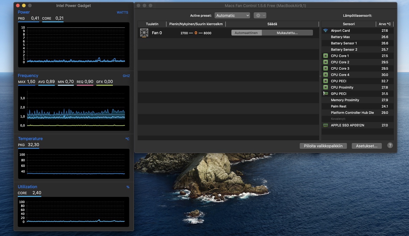

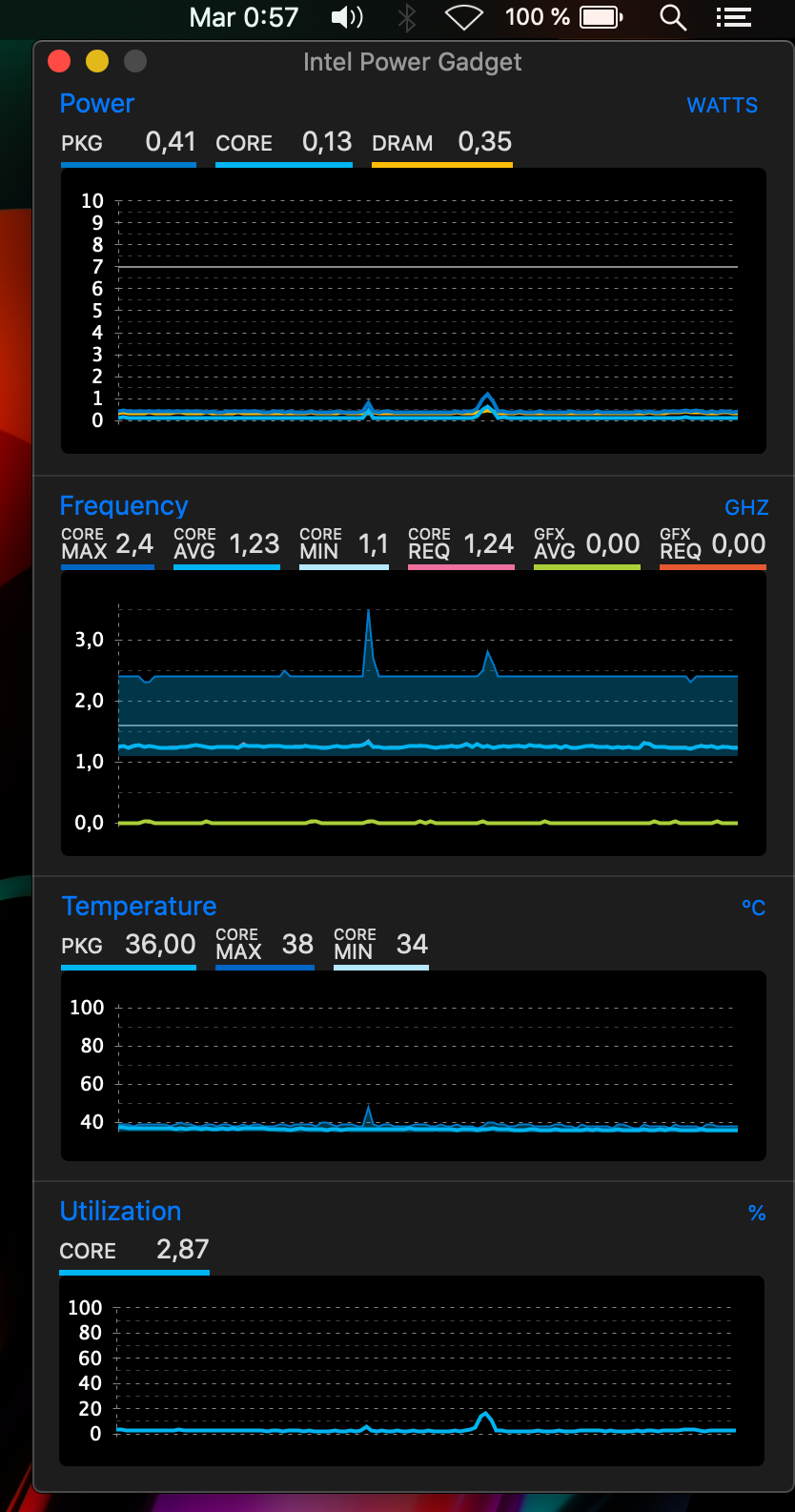

Barcelona 21º out 25º int bed.
Reactions: hmhmmhmmm?

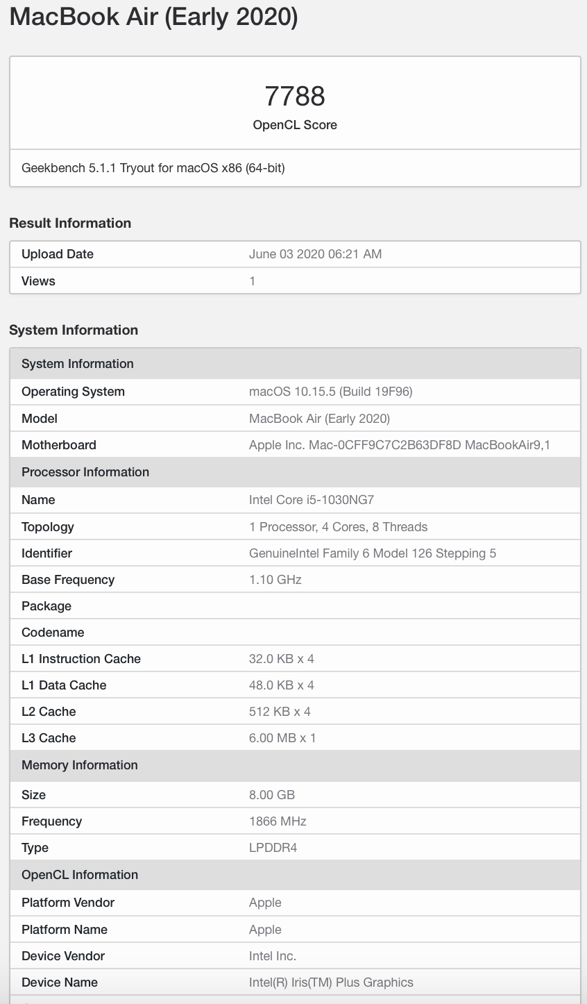

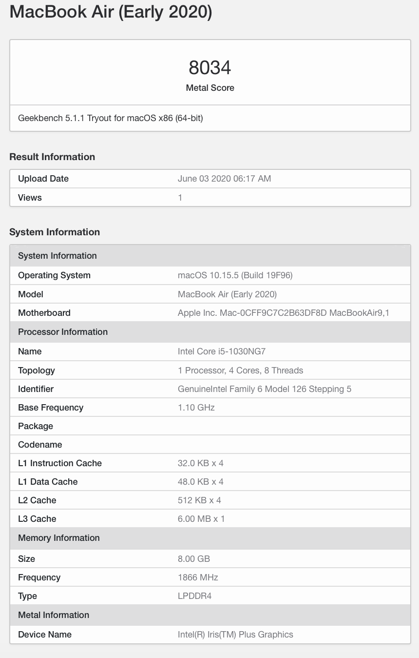

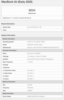

Im wondering why we have so unlike results for OpenCL and Metal. As I have the i5 / 8 / 256 and my non mod scores are almost on level with your mod points.
Singel: 1171
Multi: 2936
Metal: 8034
OpenCL: 7788
Test TypeOriginal (Points)Mod (Points)Improvement
CPU (Single-core)1,2141,2563.5%
CPU (Multi-core)2,9923,88629.9%
Compute (OpenCL)3,8258,525122.9%
Compute (Metal)4,2859,727127.0%
[/QUOTE]
