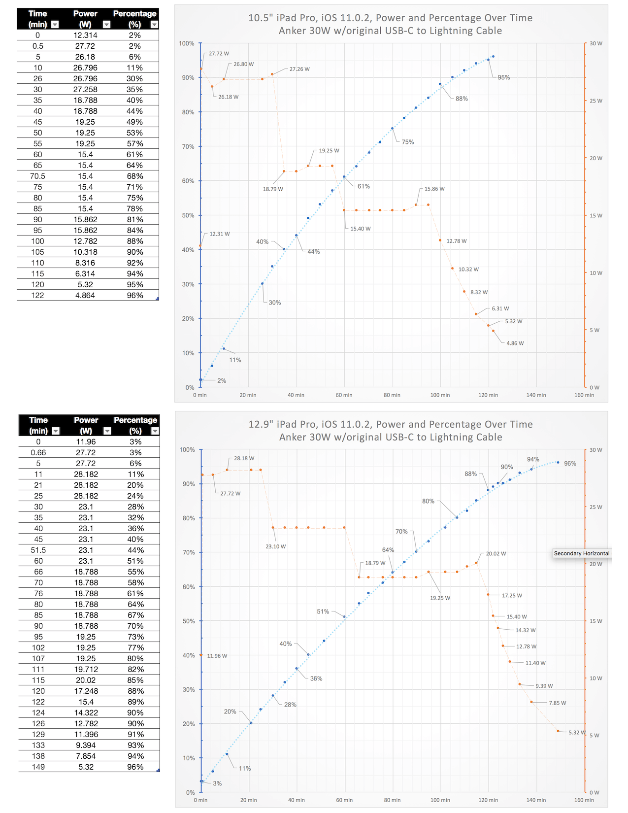

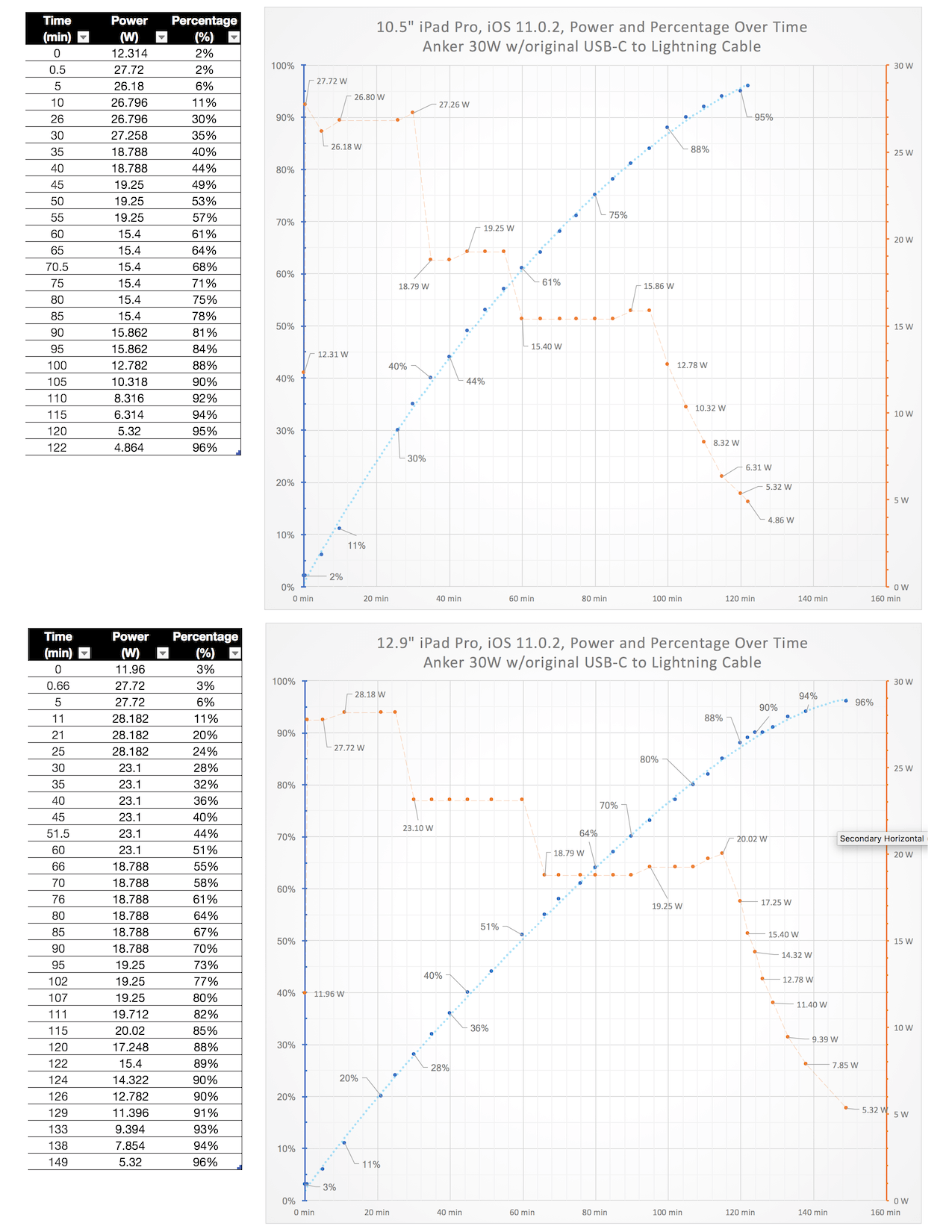

(10/8/2017) tldr; Chart of % gain over minutes for the Anker 30W charger described below, in case you just want to verify that your charger is charging at full speed.
Original post follows:
I finally managed to get my hands on both the 2nd gen iPad Pro 12.9" and the new iPad Pro 10.5", and I figured I'd run some tests on how they perform, both on the original Apple 29W USB-C to Lightning adapter, as well as some third party adapters.
I originally reviewed Anker's original 60W USB-C adapter, which reportedly supplies 29W of power to the 12" MacBook. Unfortunately it wasn't able to fast charge the iPad Pro.
With the new iPad Pros and the passage of time, I hoped that the situation would improve on both sides - Apple and 3rd Party adapters - so that 29W charging would be feasible without having to spend so much on Apple's 29W adapter. I did a quick search on Amazon, and I found 2 that looked promising:
The Aukey is cheaper and comes with an odd USB-C to 2 USB-A adapter, whereas the Anker has a more straightforward design.
Here are the electrical specifications:
